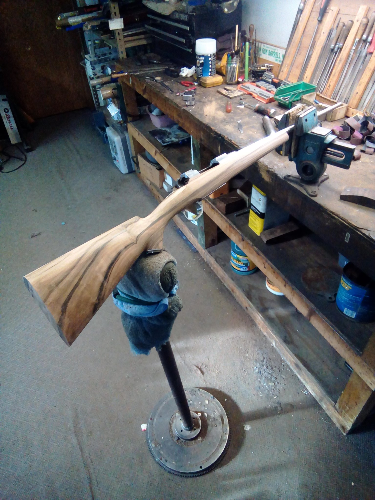

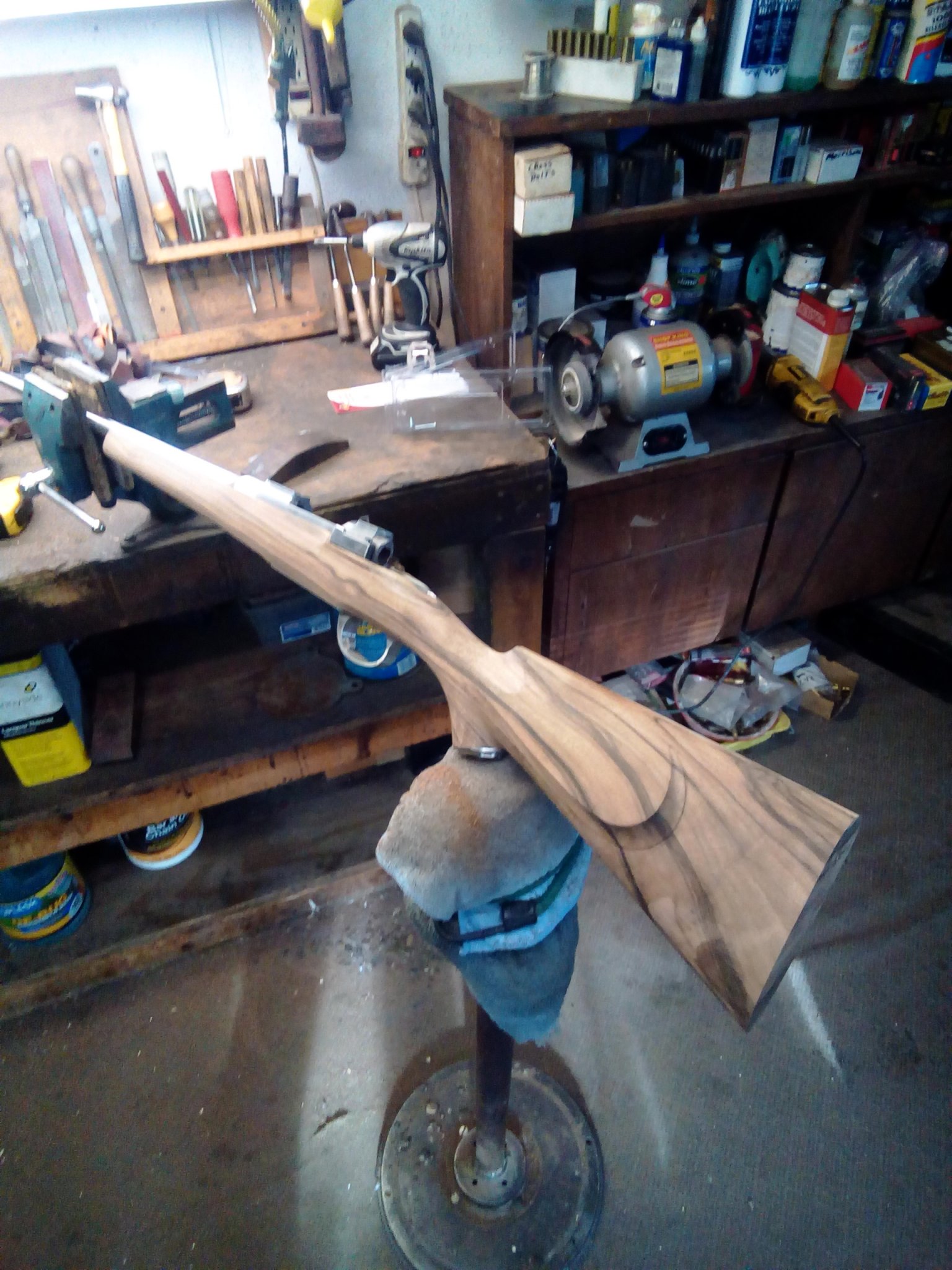

On the flip side of the coin. Here's a small ring 98 with square bridges I'm doing from scratch, 4340 rec. 8620 bolt. Nice stick of old growth California english walnut. Caliber 275 Rigby.
