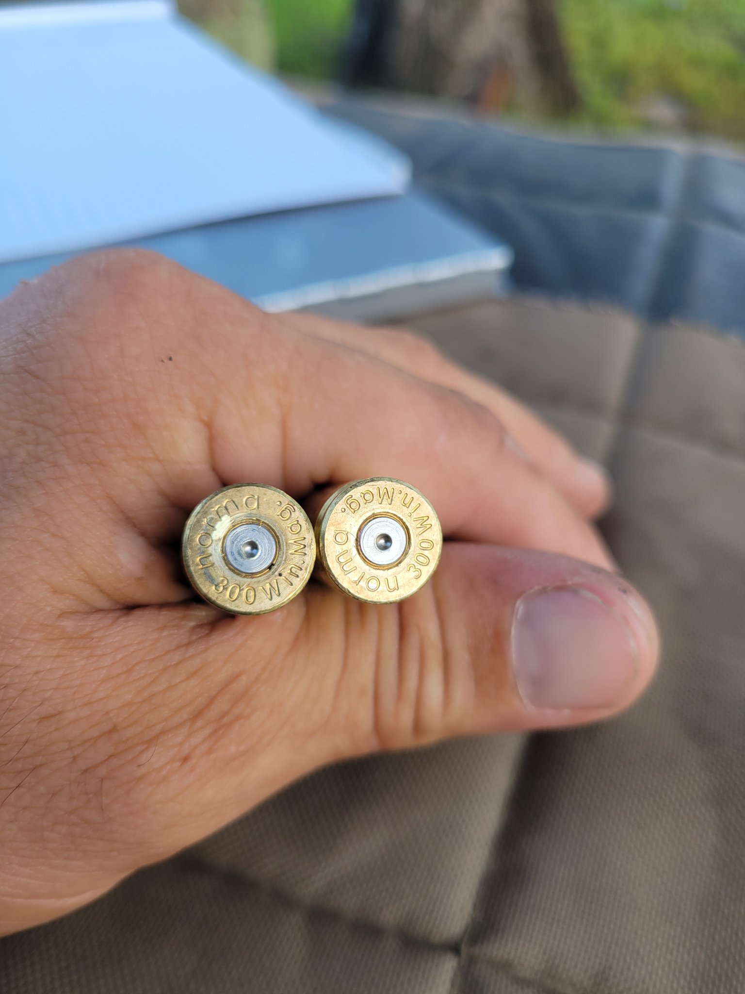

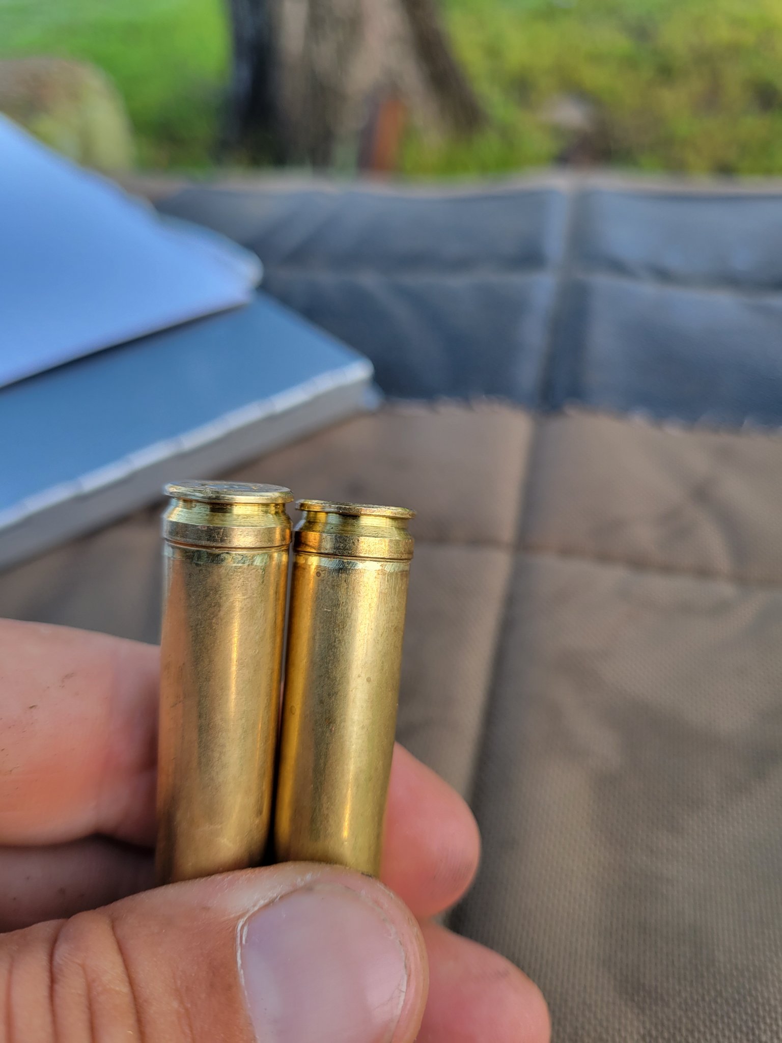

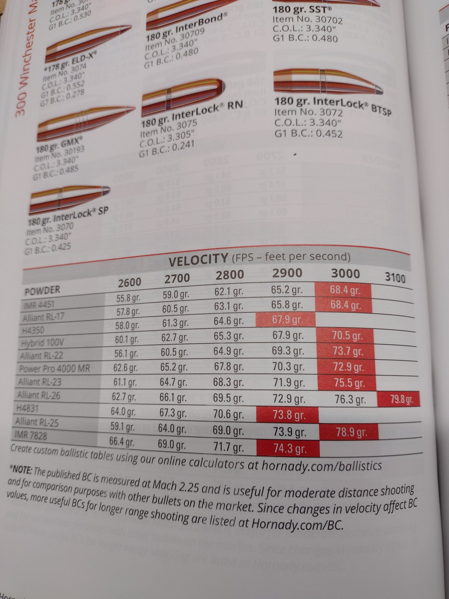

My last attempt was 78.0gr of magpro under a 215 berger hybrid. Book says that's 4.0gr under max and speed was just over 2800 iirc. Pretty much locked it up when I pulled the trigger. Extremely difficult bolt lift and I had to tap the bolt back to extract the fired case.
Was it a fluke ? I don't know let's try another one. Nope, wasn't a fluke. Think I've got a pic of the cases. I'll attach them if I do.
I've used H1000, imr and h4831, h4831sc and imr 7828. And reloader 22 I think. Can't remember for sure on that one. It's been off and on for about eight years with this gun.
