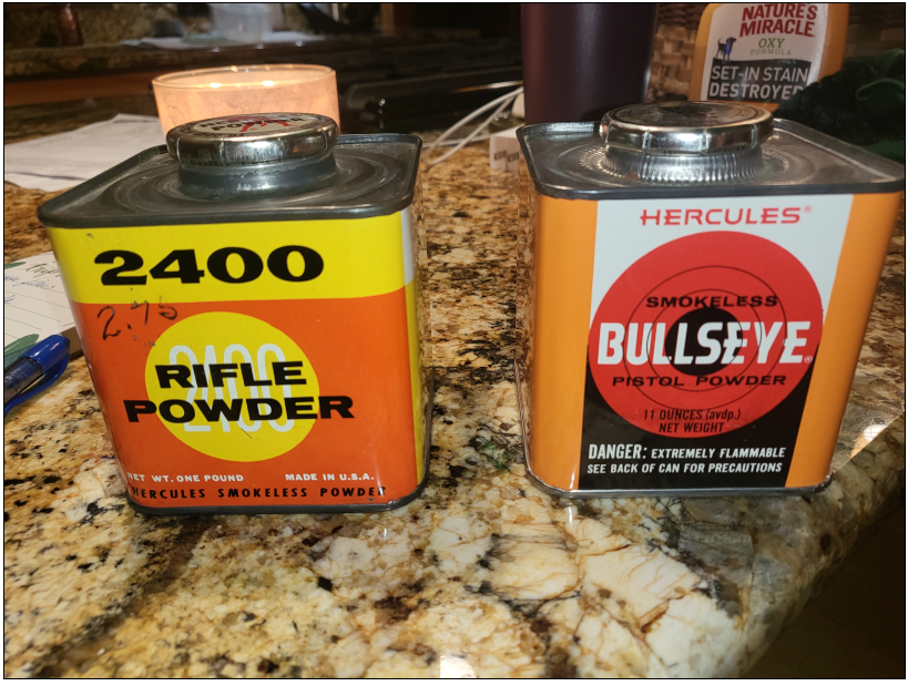

I also have some Dupont 4064 and even these.... that are still sealed and I have no worries at this time about using them. Look at the price on the left can... $2.75!
