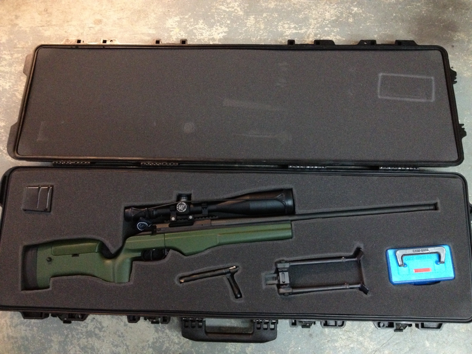

Careful, many on the Hide get very upset when you use the "S" word. Here's a pic on my new stick.
