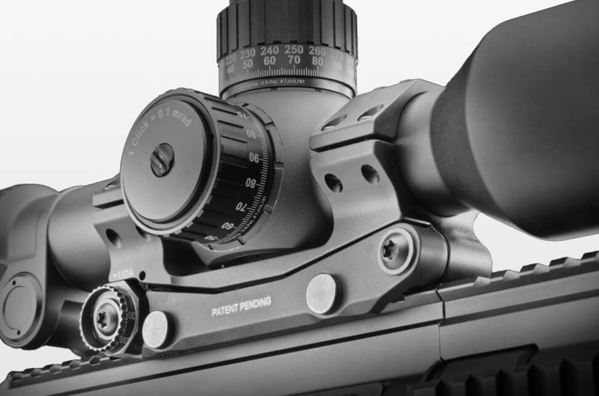

    Any of our International members here have any direct experience with this adjustable mount? I visited the Snipex booth last October during Ukraine Arms expo but did not see this adjustable mount.
    Sincerely, Theis

    The only thing holding me back from this or any of the other adjustable mounts is that I just don’t trust that they will lock up solid.
    I have no experience with any of them but with the amount of effort we all make to ensure our scope is mounted tight, not moving, aligned properly, etc, I just have zero trust that these will not have at least some play.
    Anyone think differently?
    Well when I look at this one, I thought that the further you get from 0 the less sturdy it is. You have a lot of rail behind the fulcrum that could move under recoil.
    The other option is the Ivey Shooting fully adjustable mount. I have one and you can get it in 60 MIL or 200 MOA. Its not cheap but is VERY well made. It comes in 30mm,34mm,35mm and 40mm. I asked and if you request it Steve said he can also do 36mm rings as they never been asked for 36mm rings
    Hi,
    I have some of the same "concerns" and that is why I asked if any of our International members here have direct experience with this mount because per Snipex themselves there is not a single unit in the USA..not even the US office.
    The concern I have in regards to recoil should/could be written off very easy from Snipex....we just need to see them run a super tall target test with the unit mounted on their 14.5mm rifle :)
    Sincerely,
    Theis
    The mechanism is dependent on a pin in a hole. What "lock up" are you referring to?
    Not sure about the question...when I say "I just don’t trust that they will lock up solid" I am referring to it's ability to not move around with a scope mounted on it. It very important, at least to me, that my scope base has zero movement in it. With a device that has tolerances and moving parts, I am sceptical that there is not at least a small amount of movement.
    What fulcrum? A fulcrum is based on a pivot point. Assuming the pin-to-hole fit is fairly tight, once the pin is in the hole there is no pivot point.
    I couldn’t think of any other word to describe what that pin location could be. Might be the wrong adjective but you got my point but the big IF in the thread is if it locks up tight.

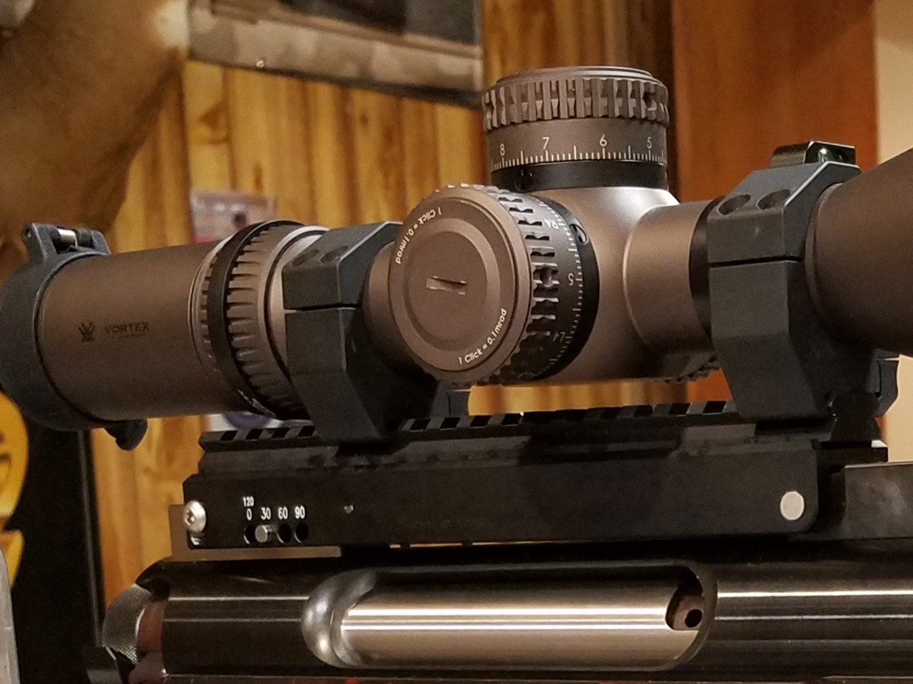

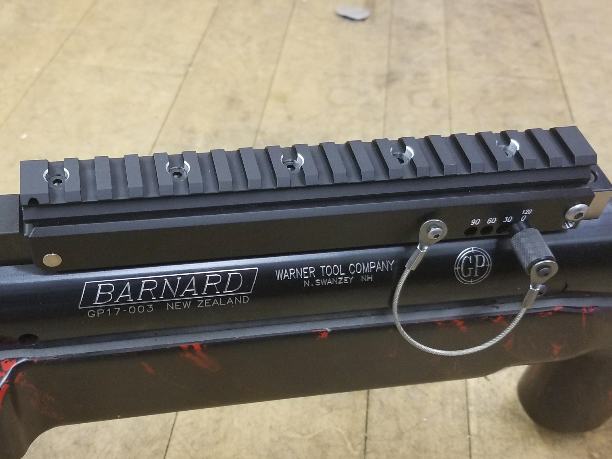

    If anyone is looking for something that is solid, stays tight and very reliable. This model shown has 0 to 120 moa plus add in another 20 moa for the picatinny rail . It has been used cranking out 190+ grains of powder every round and with no regrets - very tight tolerance and cannot move once locked down.
    Made by Warner Tool Company.
    Unless you have an integrated Pic rail, you have tolerances in it. [Even an integrated rail has manufacturing and fit tolerances.] Same with your rings. Normal practice is to secure both with a medium thread locker.
    There are no, intentionally, "moving parts" in any of the solutions so far discussed. "Adjustable" presupposes that the device is "adjusted" to obtain the desired incline. The alternatives are components with MOA or mil built in - the Pic rail and/or rings. So, at this point, seems you are not a prime candidate for acquiring an adjustable scope mount. That is AOK, just not that focused on the thread topic. [Of course the scope has a range of adjustment, as well as being built with tolerances.]
    As far as locking up "tight", it would be informative to know whether either of the pin-in-hole solutions (Snipex and Warner) use tapered pins with threads - used to zero out all tolerance. I spoke with the US rep yesterday and will be doing so again tomorrow (planned) - at which time I will inquire. One shot - how is the Warner pin held in place (retained in the hole)? Thanks.

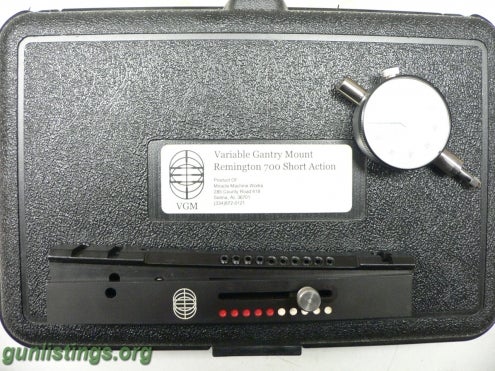

    Theis - the second image is not a VGM, or at least not the same "model". Is the VGM still in production? [Use to be Miracle Machine or something like that who produced them - website long gone.] Actually, looking hard at that second image, hard to say exactly what it is. Please advise. Thanks.

    The cross pin slides in when aligning to desired offset it is easy to start but shows no sign of free play when going in or out. I have not had it try to walkout while shooting and I doubt you could lay the rifle on its side and shake it out. There is also a lock mounted on both sides in the rear that are tightened with a Allen wrench as well after your in the desired offset.
    I’m not saying that this is the only way to go, but just that I am very pleased with what I have seen so far using this compared to a few options that I have witnessed fail on folks while in the heat of the moment at the KO2M and other events. I seen folks throwing a few options out here on this thread and thought it was worth mentioning.
