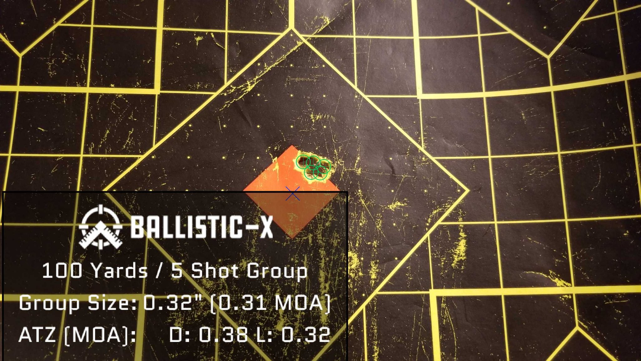

    I see a number of WTB posts for amaxes in various flavors, and am curious if the new (cough) non-melting tip bullets are not shooting as well as the older version? Inquiring minds....
    The 80 ELDs are terrible, keep buying those Amaxes so I can pay less for the ELDs
    178 ELDMs smoke everything else in my AX .308. Heading to the range on Sunday with 100 .223 73 grain and 50 285 .338 ELDMs so will let you know how I get....
    I think it depends on the model / caliber of the ELD series. My wife's .223 bolt gun shoots an 80gr Amax load that is surgically precise on a calm day. Once I saw that Hornady was dropping the 80gr Amax, I picked up some 80gr ELDMs to do load development for. I was eager at first due to the better BC of the new ELDM, but I could never get them to shoot near as good as the prior AMAX. Upon comparing the two bullets, the 80gr ELDM has a more secant nose shape than the older 80gr AMAX, which is probably the reason for the improved BC. It sucks that I can't get the new 80gr ELDM to shoot in her rifle. If Hornady would have just put the non-melting tips on the old 80gr AMAX, we would for sure have had a winner on our hands. The 80gr AMAX was already a top dog with BC as compared to other 80gr offerings on the market, so it really didn't need the change to a finicky secant nose profile. Hey Hornady......Are you listening to this?
    On the other hand, my shooting buddy had a sweetheart 178gr AMAX load for years in his .308. He developed a load with the new 178gr ELDMs that shoots identical .25 MOA groups just like the old 178gr AMAX, with a little more fps to boot. The only physical change we could see between the two bullets is the boatail is longer on the ELDMs with a corresponding shortening of the bearing surface. The nose profile looks to have remained the same on these. I would venture to say that this is why this particular bullet is just as successful as the old 178gr AMAX load was.
