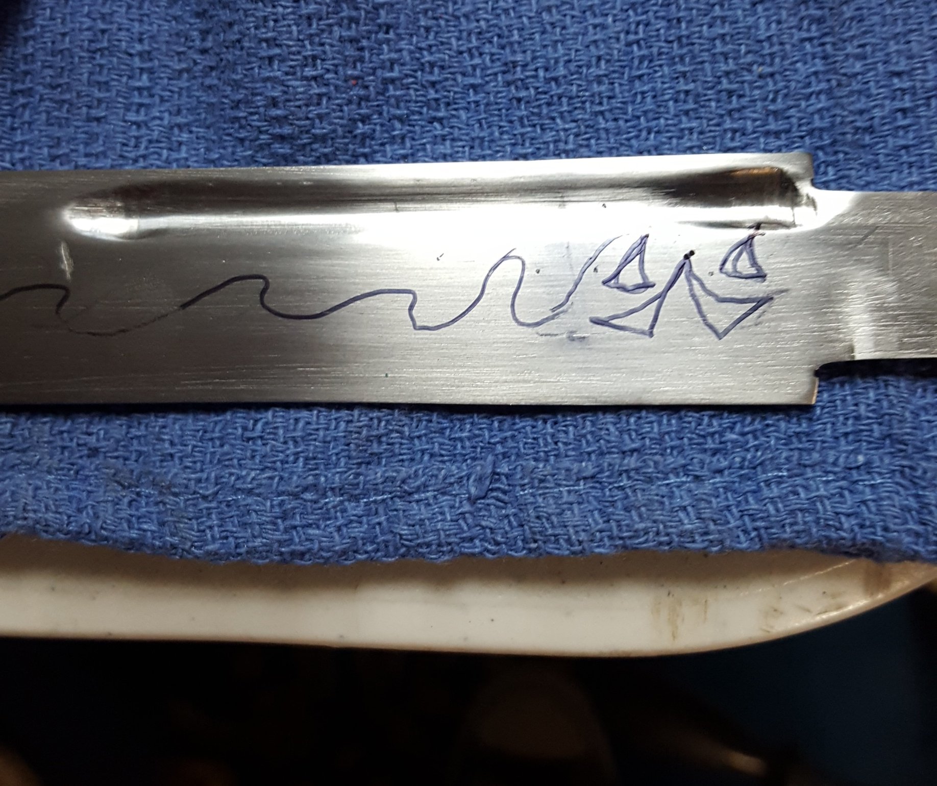

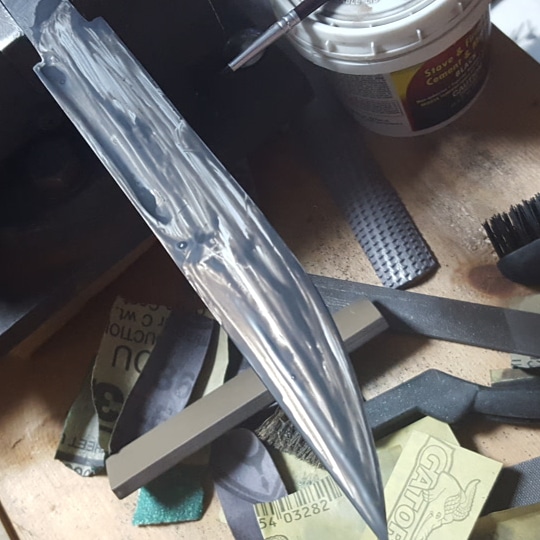

I got deep over my head with the tanto, but I learned. According to Kim, as we are killer grilled teriyaki chicken, the best single tool for stock removal is a belt and disc sander. It makes the part after forging and design way faster...but to my dillitante mistakes, Kim is can awesome mentor.
The big tanto begins the clay process today. Along the hamon line will be my fire kanji, my mark, seared into the metal

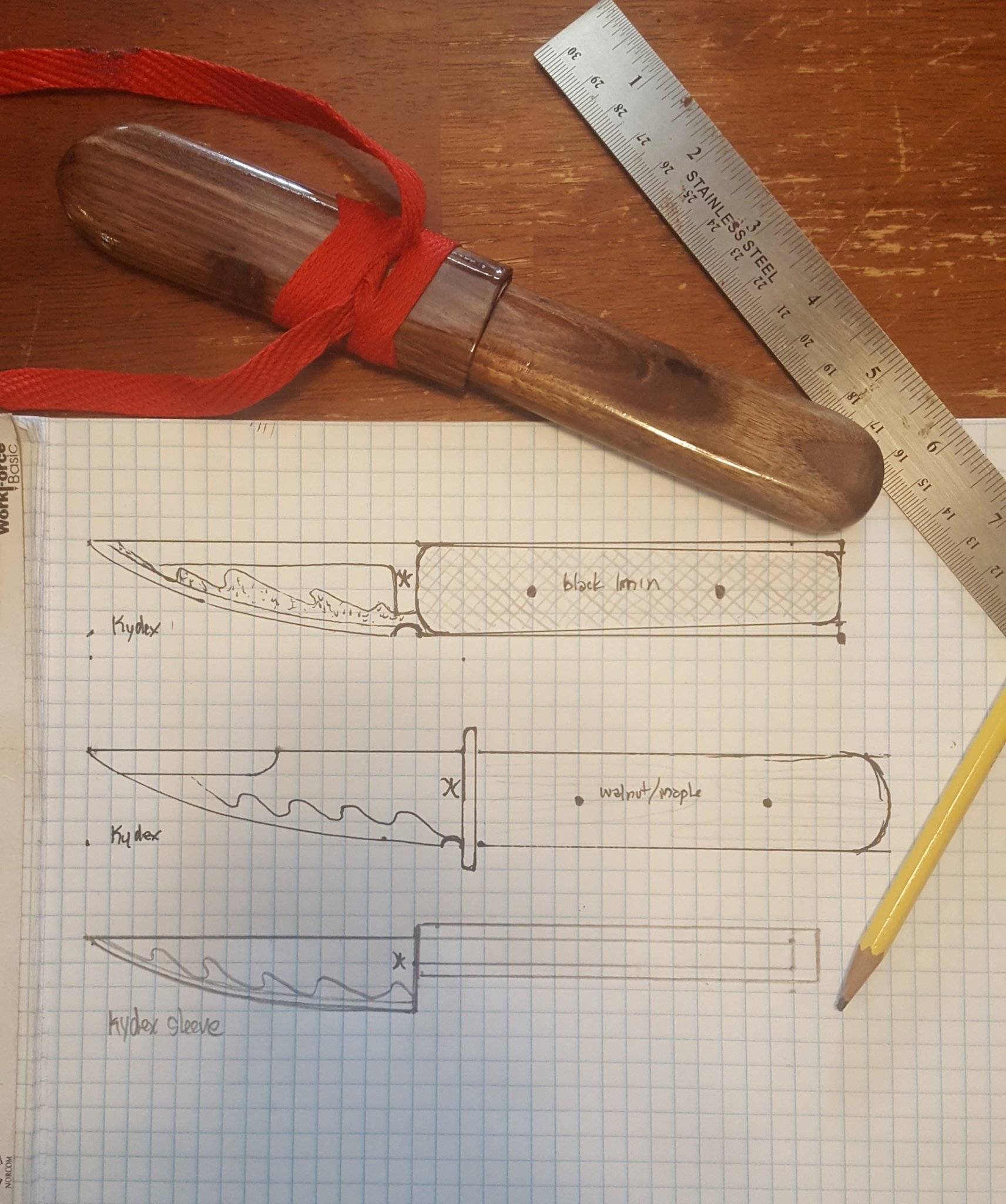

I seriously need to find some good dark wood for these two blades. There is a big flooring company down the road I'm gonna look at.
Found a decent starting level belt/disc sander at harbor freight. I've been thinking on my next knife design already, but as Kim said, bet it's already been done. Me, I don't care too much about that, as this is a path after my 8 - 4 working with people with disabilities. I love doing this becuase it is with my hands, fire, and metal ????

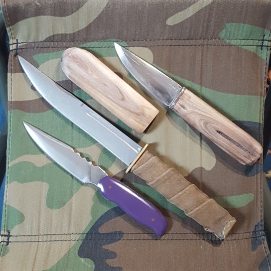

These are a couple of my projects. I made the rookie mistake of starting with S35VN steel. Yeah that was a pain to do by hand. Which is the one in the middle. The other two pieces are O1 steel, and I’ll give it an other go when the season is over. Finally invested on a cheap belt grinder.

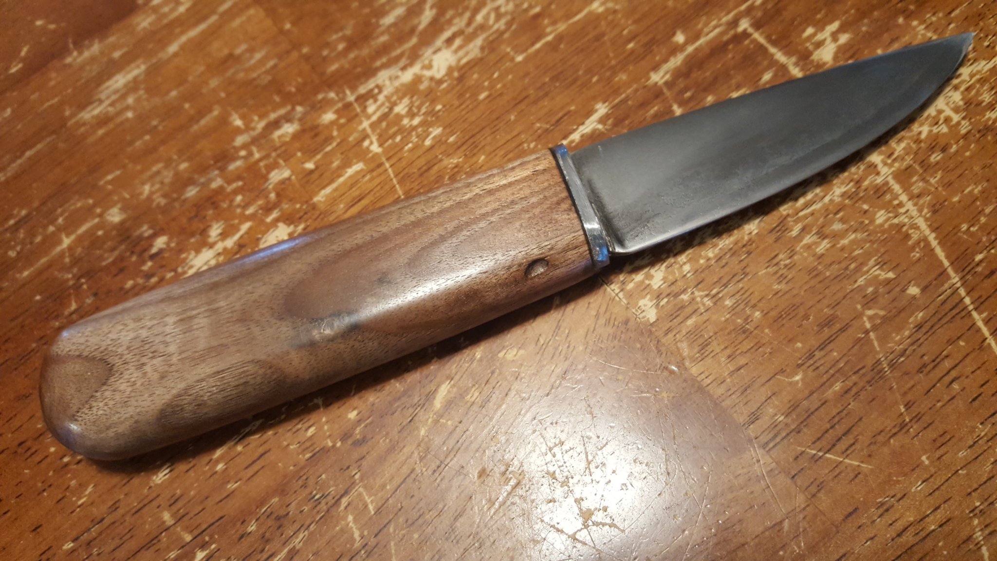

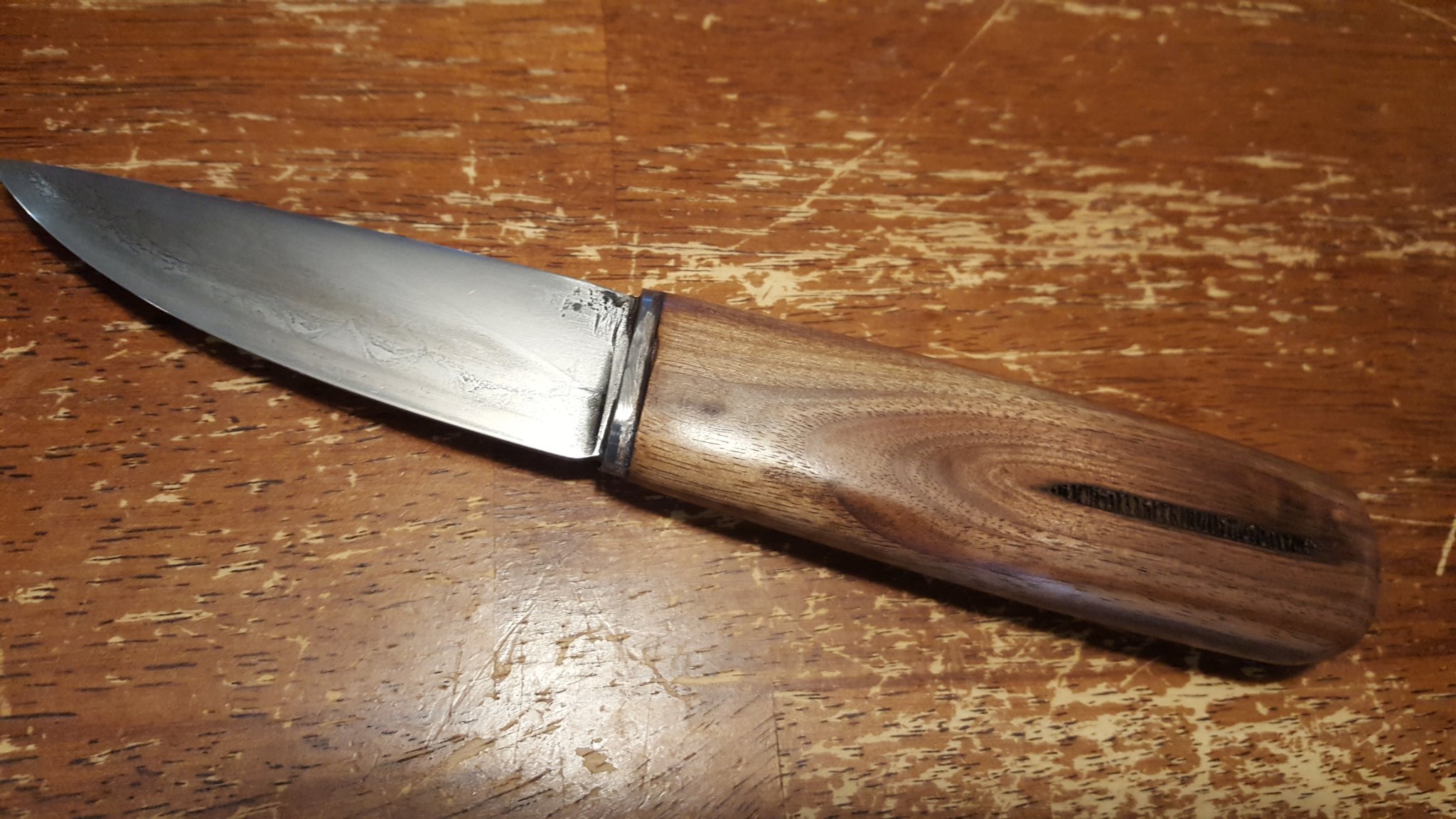

Finally down to a final polish and sharpening of my forged utility tanto! As I took the block of old black walnut, affixed it with some assistance and mentorship from Kim, I started sanding. As I got down to the area where I needed to be, all the flaws in the wood came out. I was close to saying screw it, starting over with another block, then I looked at the forge marks, and other small mistakes I made on this, and said fuck it, it's my first knife from metal through forge through stock removal to completion, AND it IS a utility knife, MY utility knife!
So I applied a bit of polish with the Dremel, applied a nice thin coat of clove oil(Yes, I also made my own Japanese style blade preservative by the old ways), and am now ready t sharpen, and do the final polish, then make a sheath for it!

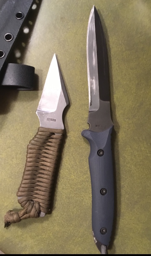

Check out Tim Kipps (J Hue Customs) for handle material. I have a couple Breed knives myself and love them. Good work.
