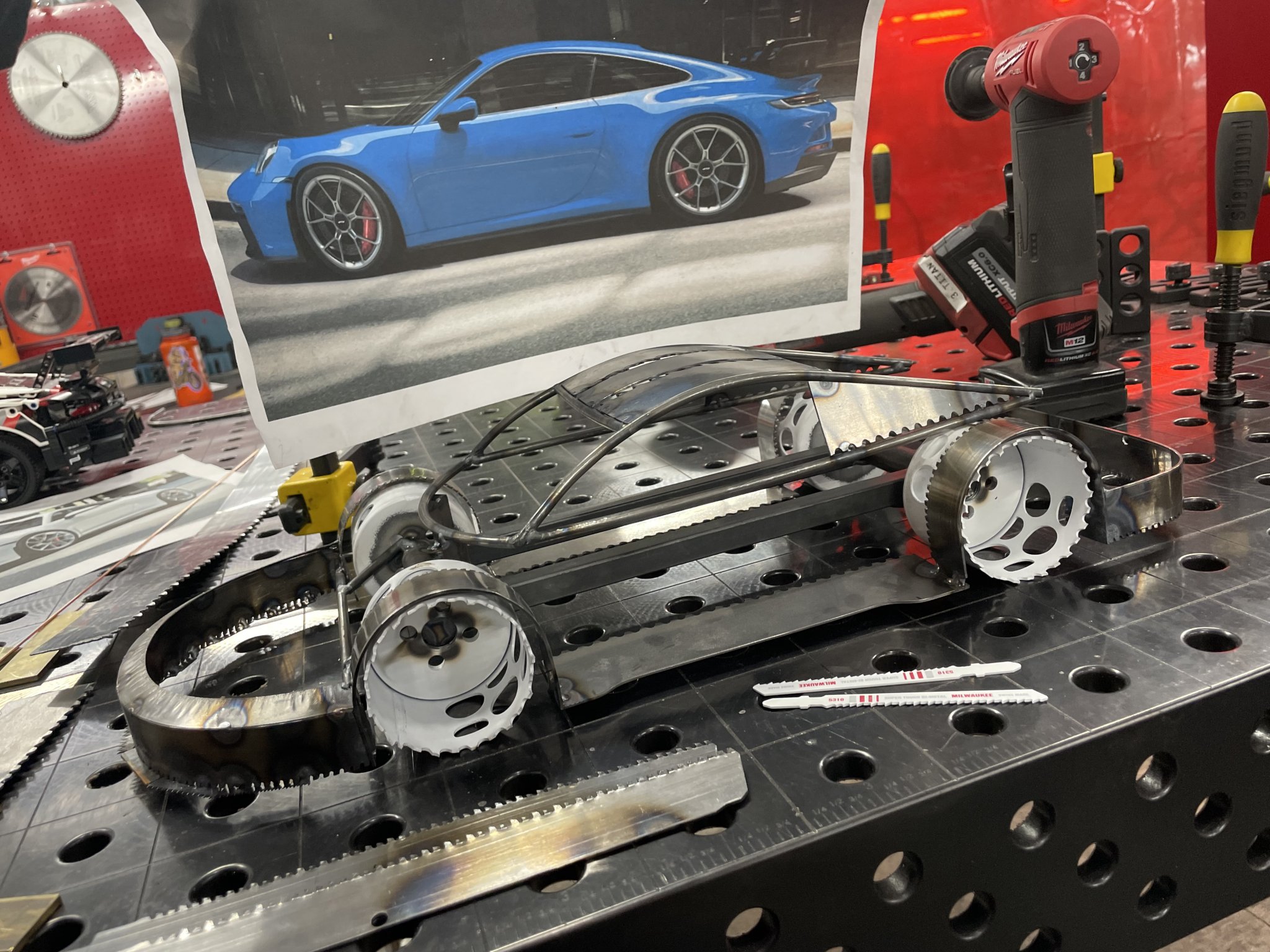

So I build a Porsche.............
Stache
Forklift certified
Dec 18, 2020
59
141
Wisconsin
I work for a not to be named tool company in Milwaukee, WI. I was recently tasked with making a replica of a Porshe 911 GT3 as a going away present for an exec at work. I am not an artist, shit I can barely write my own name legibly, so how the hell was I going to make this?
There's a catch of course. I was to use material and components that we use in the manufacturing of our accessories, and finished products to do it.
That would be the band we use to make hole saws, sawzall blades, and what not. I started with big pictures that I scaled to make a rough mock up out of modeling clay. Didn't take a picture of course. These are the tools I used:

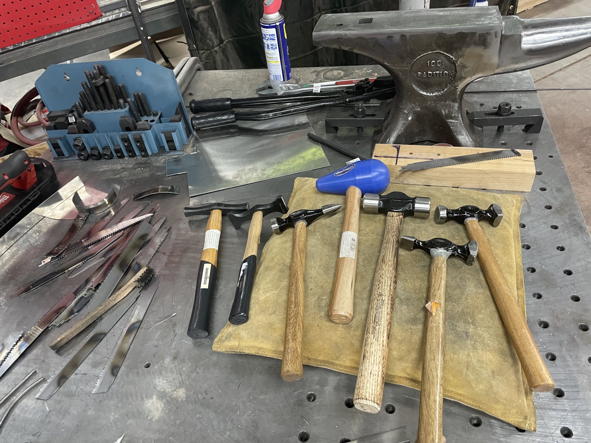

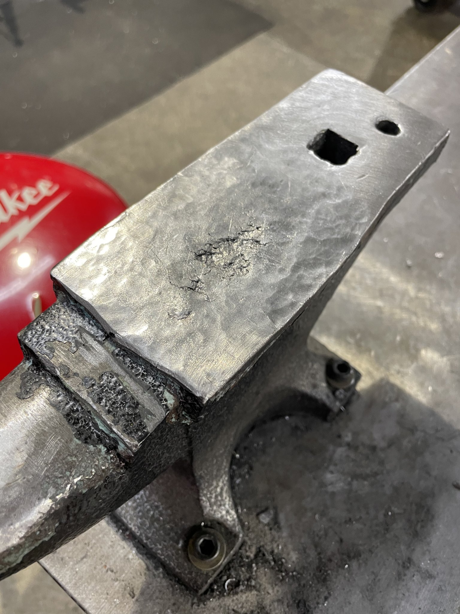

Note: I had to buy a new anvil in the middle of this because I beat a hole in the cheap Harbor Freight one we use for light shit in the tool room.
Worked out a frame of some kind with some hole saws and bar stock. Fresh band was used to shape wheel wells and 5/16" rod was used to for the roof frame.
Sawsall band made up the bumpers along with porta band blade and OMT blades that I cut and welded as the skirting.
From there I spent the next 14 days pounding the ever living shit out of cold d6a shaping the farings, fenders, doors, hood, on and on and so forth....
This was some orn'ry metal. The second you gave it heat it durned hard af and there was no more shaping it. It just cracked and split as soon as you hit it. Another neat thing is that you could shrink it but not stretch it. Any where I stretched it, it tore and split.

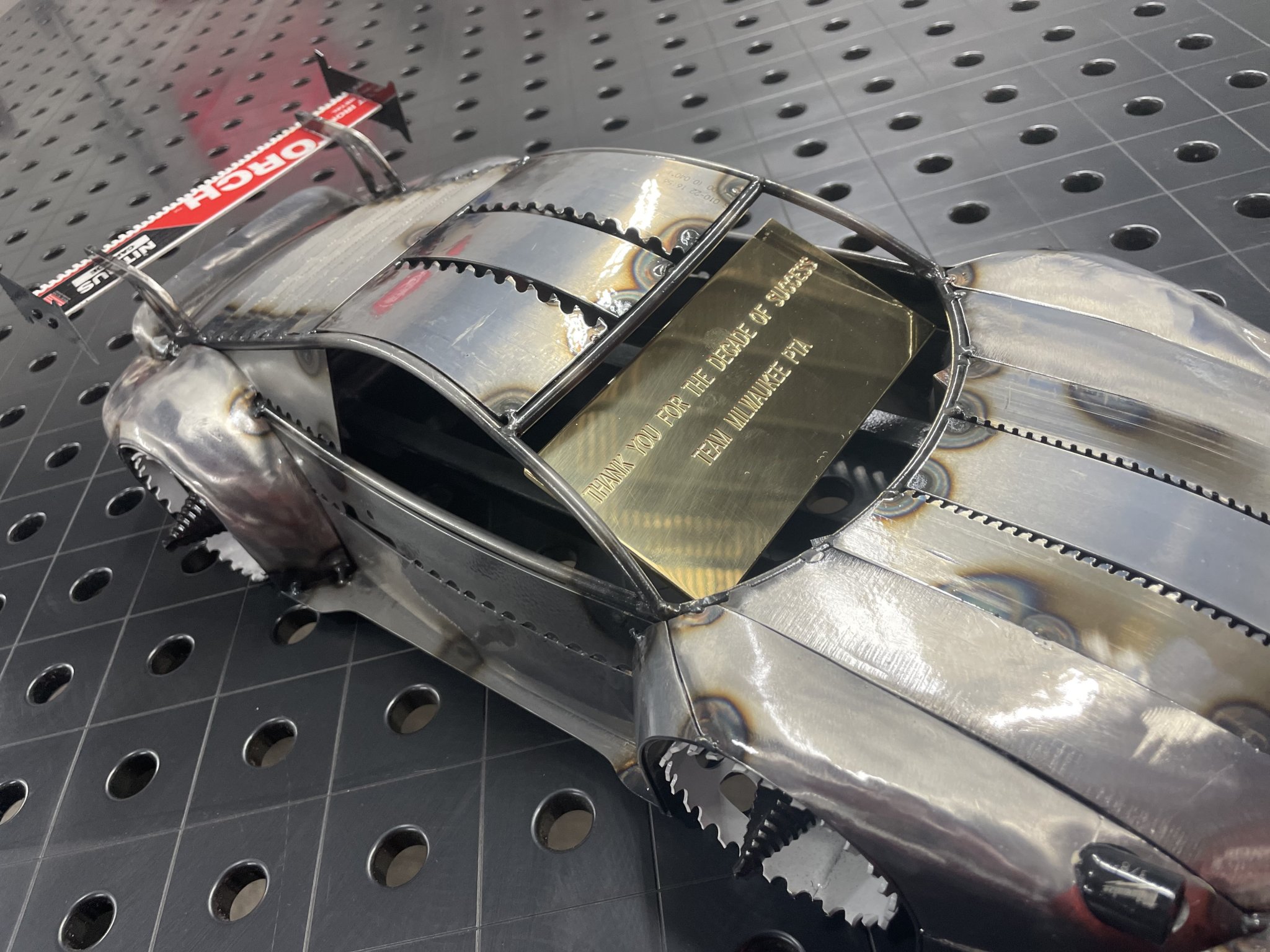

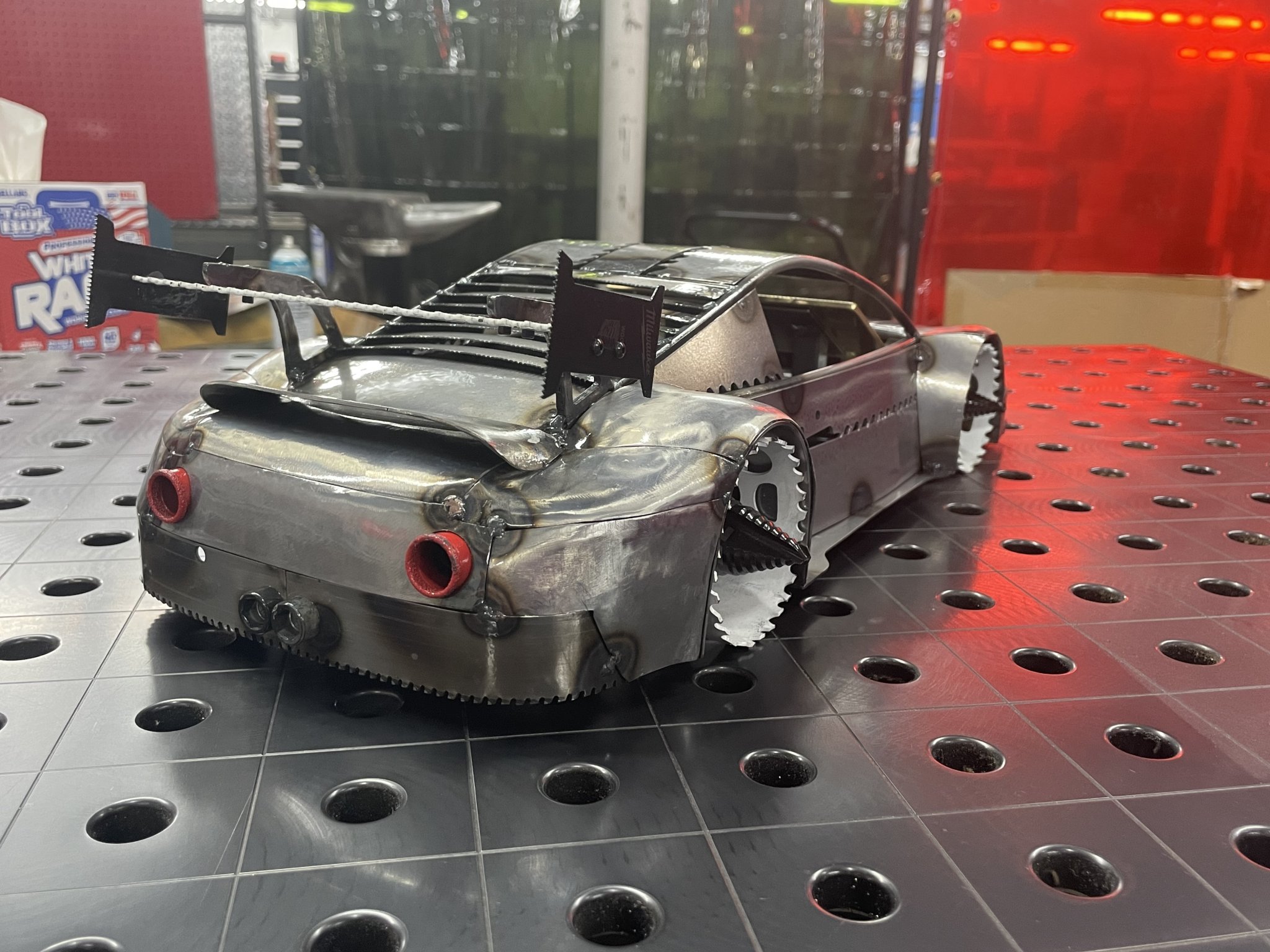

But anyway, here's the finished deal.
I think it turned out killer considering it was all done without a planishing hammer or english wheel.
Thoughts?

As a fanatical model maker and miniaturist, I can say you hit it out of the park!!!
Very cool!!! Beautiful work!!!
Sirhr
Absolutely freaking awesome!
I guarantee that will be on his desk, or displayed prominantly in his library, man cave, or some place important for the rest of his life. Very, very cool. I’ll bet he gets choked up when its presented. If not, I guarantee he’ll cry his eyes out that night looking at it.
Thoughts?
Fucking awesome. Kind of think a bit of paint would have helped with the welding marks, but wow...that really is awesome.
Hope he likes it.
That’s awesome, job well done. Could you do one of these next? It’d be much easier, it’s essentially a box on wheels
I’m only half joking…
Hope he likes it.
I was definitely thinking that but they wanted it to have the heat discoloration and exposed welds. I couldn’t help but wonder what it would look like with some filler and proper body work 🤔
