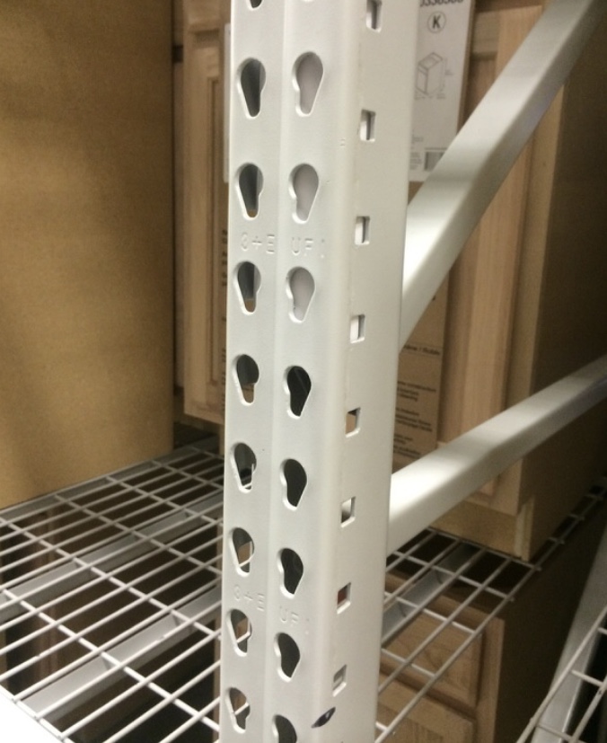

Thank God! Who wants their handguard to look like the shelving from Home Depot??
