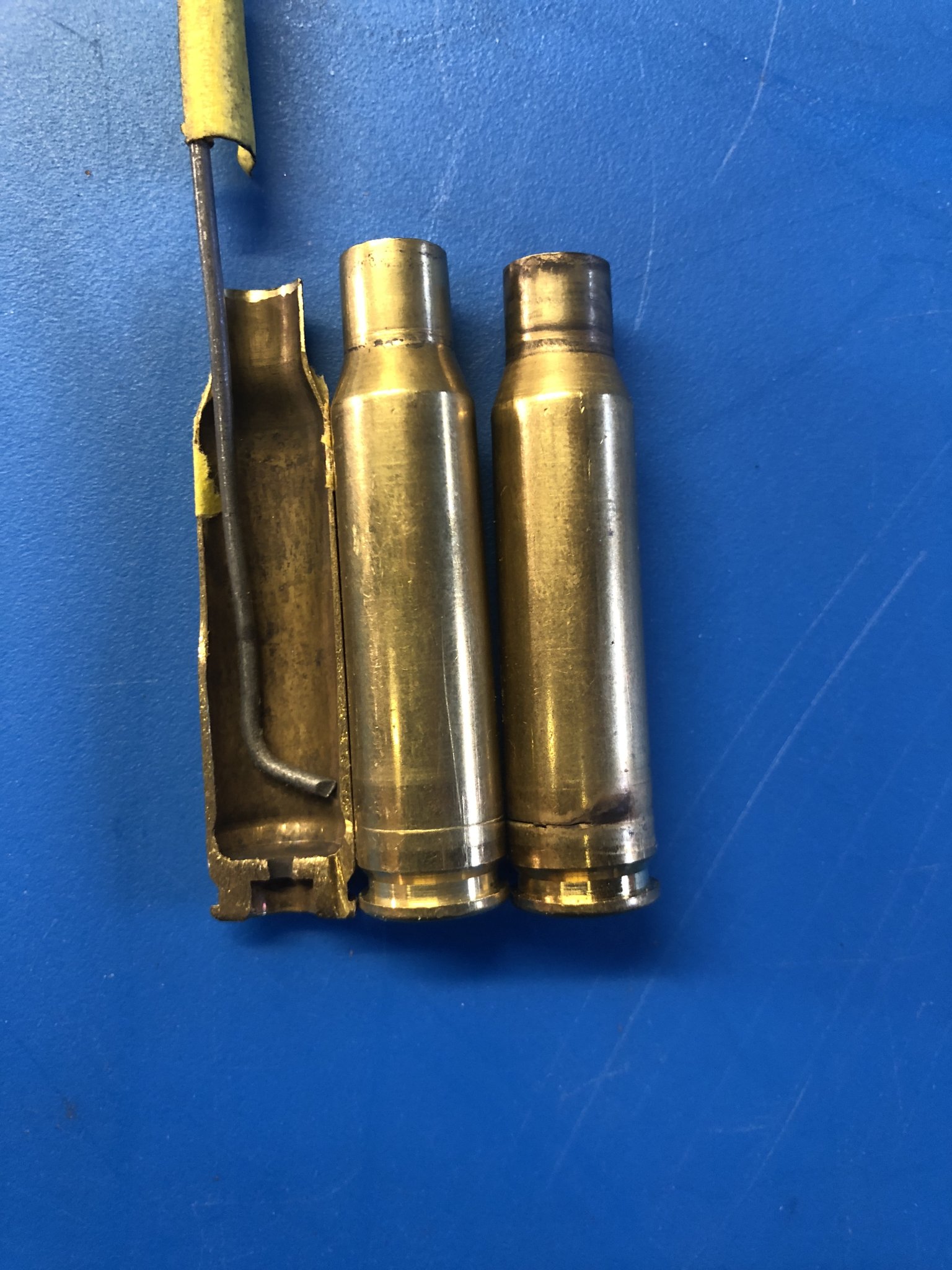

Make sure you mark your brass because if you fired it, it will certainly start to have a premature thin spot about an .124-.25 inch up from the inside of the base causing case head separation.
If it’s hard or brass like Lapua, it may now die in just a few firings. While you can look for signs outside the brass, you should make a tool and look for a ridge inside the case by feel. It will save you some grief and shows up before the outside starts looking like the images to the right.
