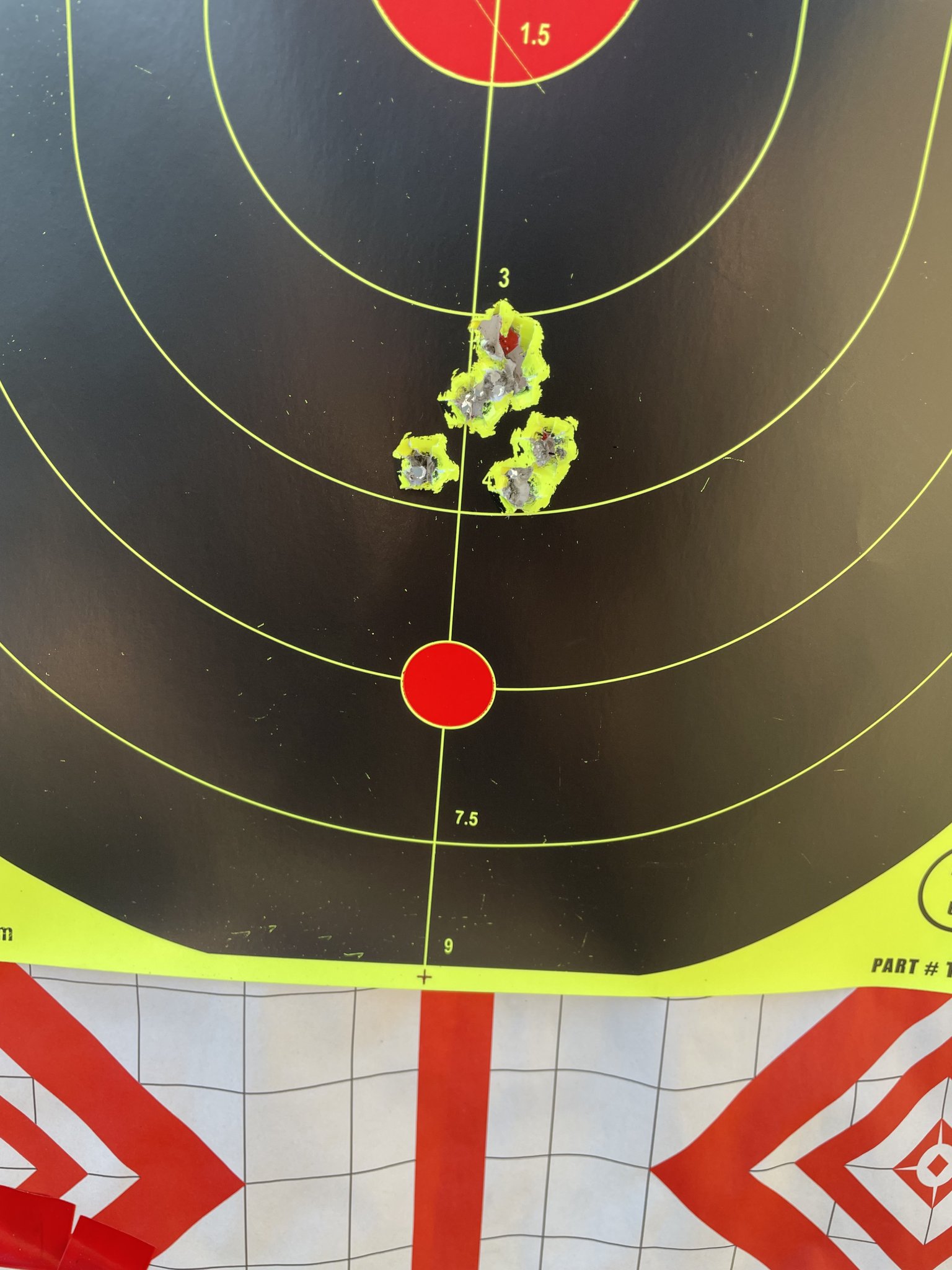

I’ve done a fair amount of load development in my Tavor 7 and found that it really likes Hornady 155 HPBT match projectiles. This is the same projectile that’s in the Hornady steel match 155’s. If you reload you will find that these will give you great results. I’m loading at 2.79 COAL and anywhere from 44-45 grains varget. The best spots I have found for accuracy are at a velocity of 2550 and 2600. For my gun the 2600 node is a bit on the hot side. I don’t group test at 200, but it will reliably shoot 1” groups at 100. The most I’ve shot as a group is 7 rounds. I run mine suppressed and it is a soft shooting rifle. I don’t run it like a battle rifle so I can’t tell you much about what happens when it gets really hot, but I’ve not had a single malfunction from it.
