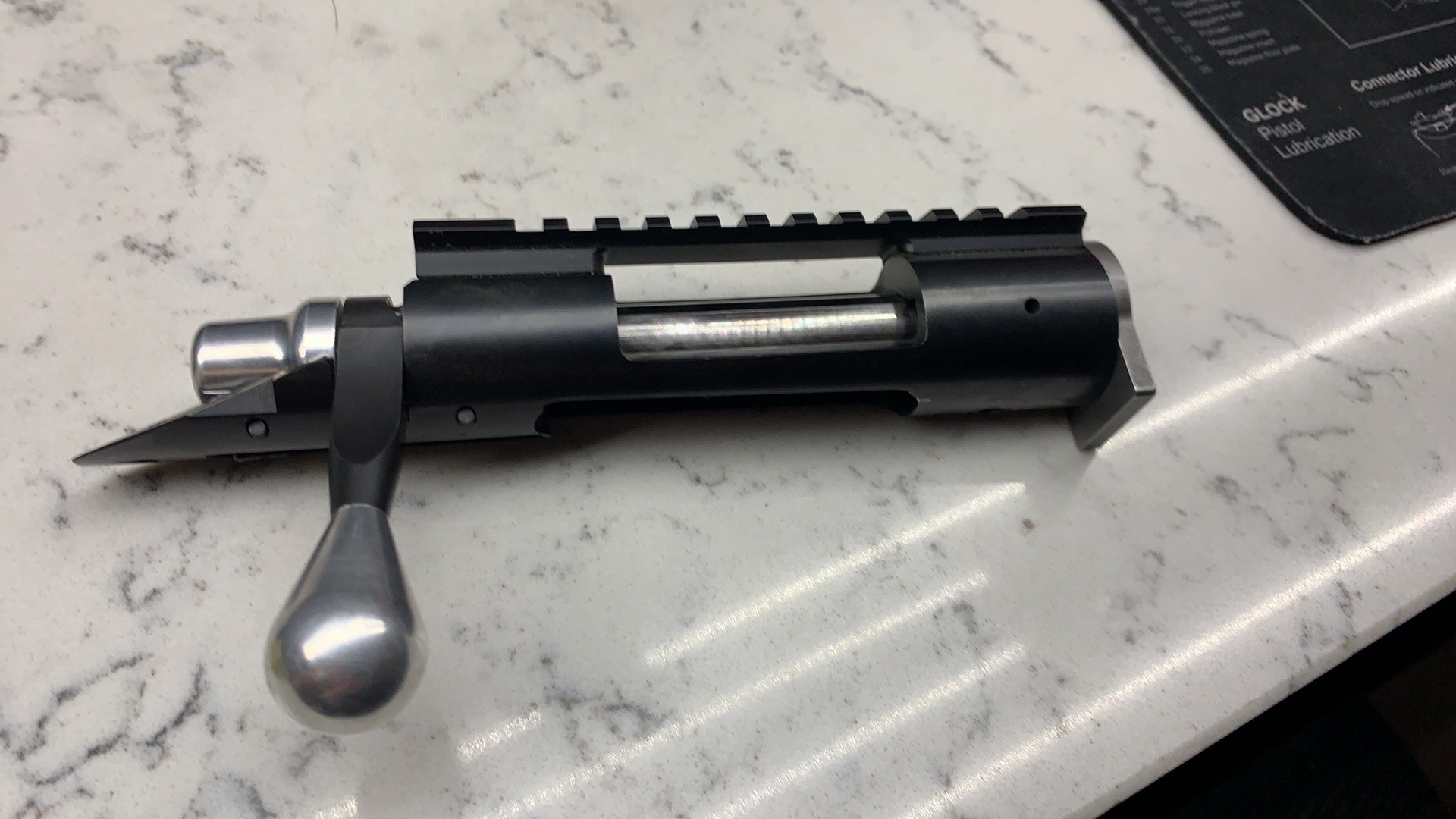

SOLD Rem700 PTG Trued action w/PTG bolt
LE life saver
Dec 18, 2018
264
27
Short action, standard bolt face. Shot about 450 rounds of 308 through in. Comes with recoil lug $500
Reactions: Farmerboy78
Who trued, and is there a list of what exactly was done?
from the PTG Website:
This kit contains the following items:
  • 1 - RH Blued Remington Action for a Short Action Remington 700, Trued
  • 1 - RH PTG bolt with threaded handle, Blueprinted (.705 OD +/- .002)
  • 1 - X-Mark Pro Trigger (Externally Adjustable)
This combo is designed for off-the-shelf factory Remington rifles
  • Raceway is opened using a PTG guided raceway reamer
  • A PTG Remington Gen II receiver reamer is used to put I.D to proper diameter and to center line, true receiver lugs, and make receiver lugs and action face parallel.
  • A PTG piloted tap mandrel is used to chase the threads making them more true to center line.
  • A PTG bolt is fitted to the action, and the face of the bolt is trued while in the action.
Reactions: LE life saver
