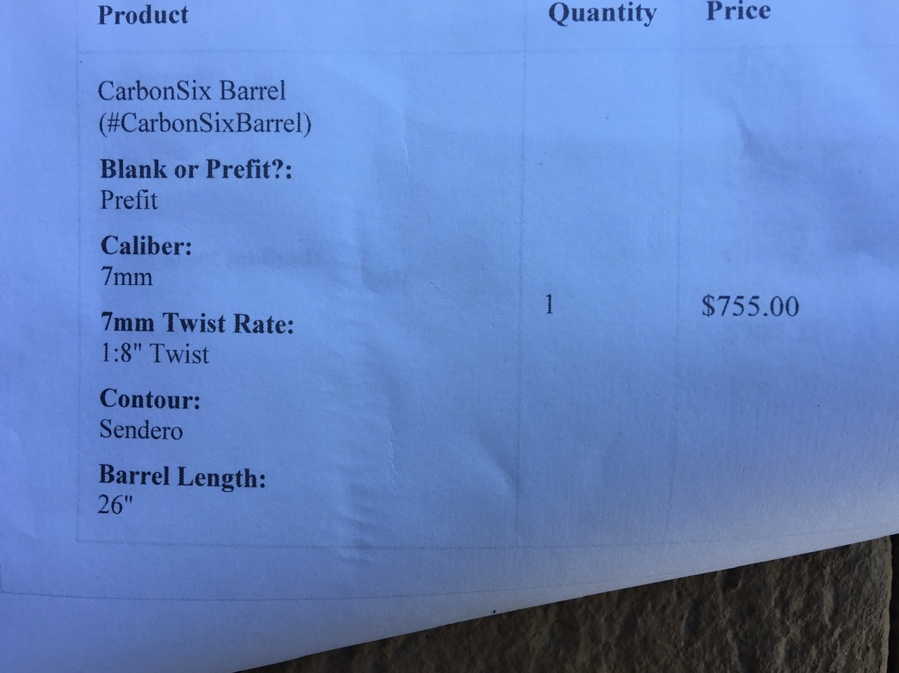

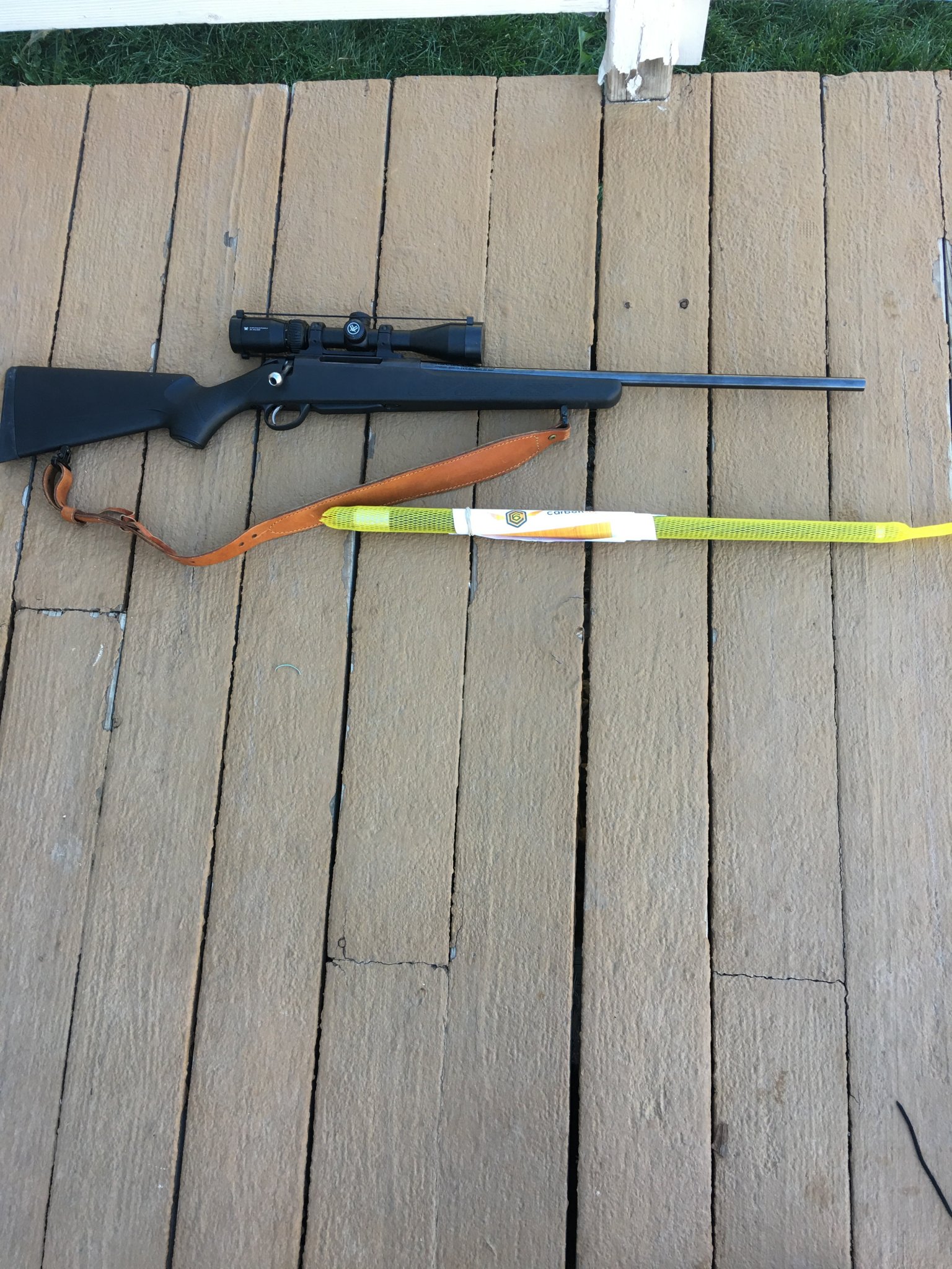

    I was planning to build a do-all long range hunter with this but plans change with kids, lol. Would also be sweet for comps like the Satterlee Nightforce ELR or Precision Hunter series. 700 Rem Mag performance with less recoil and no annoying belt. Hornady is now making 280 AI brass and factory ammo, it’s one of the most under rated cartridges out there.
    SOLD , brand new in box. Threaded 5/8-24.
    Carbon Fiber pre-fit in Sendero profile.
    Trades would only be Proof or Carbon Six blanks or Bighorn pre-fits.
