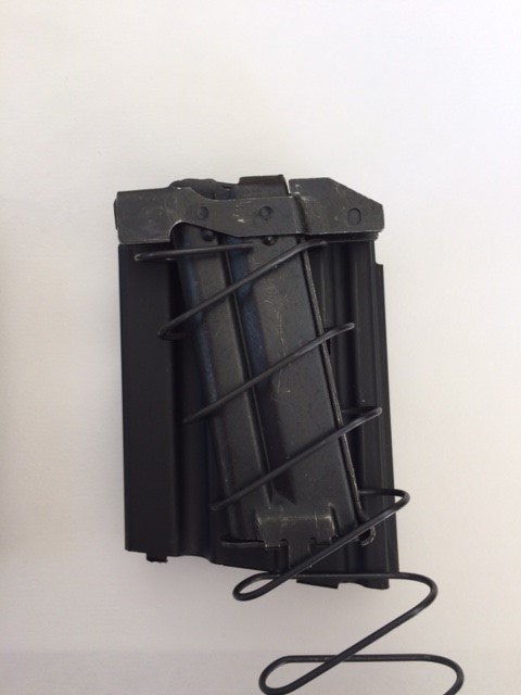

Because of frequent misfeeds using the Compass Lake 22LR inserts in 20 round Colt straight AR15 magazines with a Compass Lake 22 upper conversion and a Compass Lake lower, I came up with the following solution after trying a number of different brands of magazines and even removing the follower. The insert seemed to be under undue pressure and was rigidly held in position in the magazine. It did not appear to be adjusting itself to the internal configuration of the receiver and forward path of the receiver/bolt assembly. I considered that this “locked down” position was not allowing a smooth pickup and forward carry into the chamber.

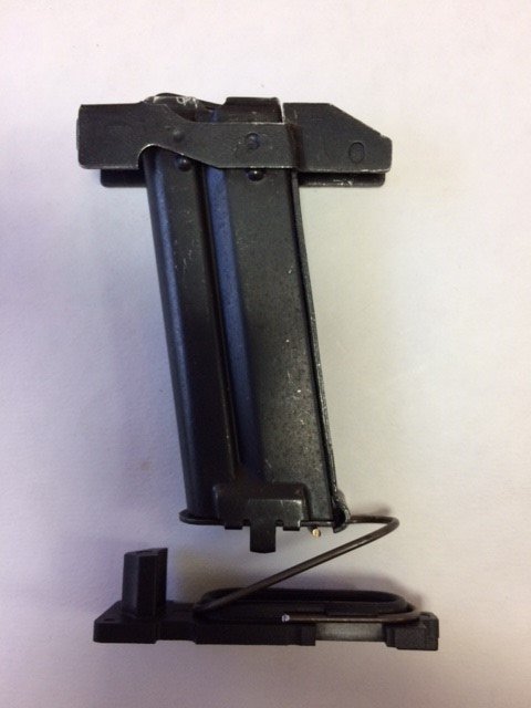

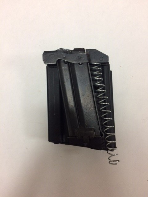

I decided to reduce the AR15 spring tension. I loosened the bottom plate and let part of the spring extend out the bottom of the mag while held in place by the partially inserted bottom plate. At about 10 or 12 “legs” of spring trapped in the magazine, the magazine started feeding with noticeably fewer miss feeds. With 6 and 8 “legs” of spring there were no misfeeds. Four spring legs was too short and the follower was too unstable even with the 22 insert in place. I measured tension on the 22 insert in place with a Warner gauge. It was 34 ounces with 6 legs of spring. I cut the spring to this length. (See picture) Thus far there have been no misfeeds in 400 rounds.

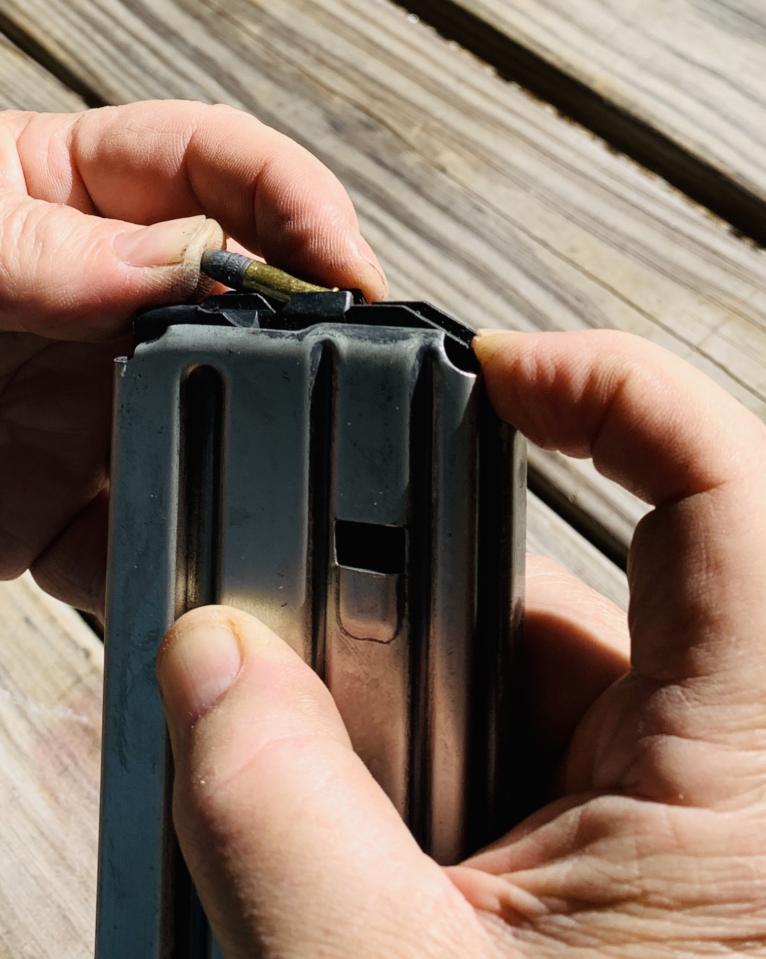

Because the insert is fairly loose, I have to brace it with my index finger (See picture showing finger position) as I load the last 5 or so rounds of the 10 it holds. I also make sure the load insert is positioned so it moves freely when I press straight down with 34 ounces of pressure with my finger. (See picture of this press and picture showing position of loaded cartridge)
I know that there are other solutions to the misfeed problem with M261 inserts and that the reasons I had with misfeeds are not the same for everyone. This is just another solution to try. Please give feedback if you use this and cover any modifications and improvements and even what didn’t work. I would welcome other ideas about what accounts for the misfeed problem. 630882E4-CAA4-466D-B612-A328FFF143D5.jpeg7C251351-F8A4-44A3-B8D7-26A98AFBB102.jpeg3E67D89F-A6C8-4F57-A3C4-0F5CAFF0967D.jpeg13354E06-D707-4D49-A0FE-C594E457E159.jpeg

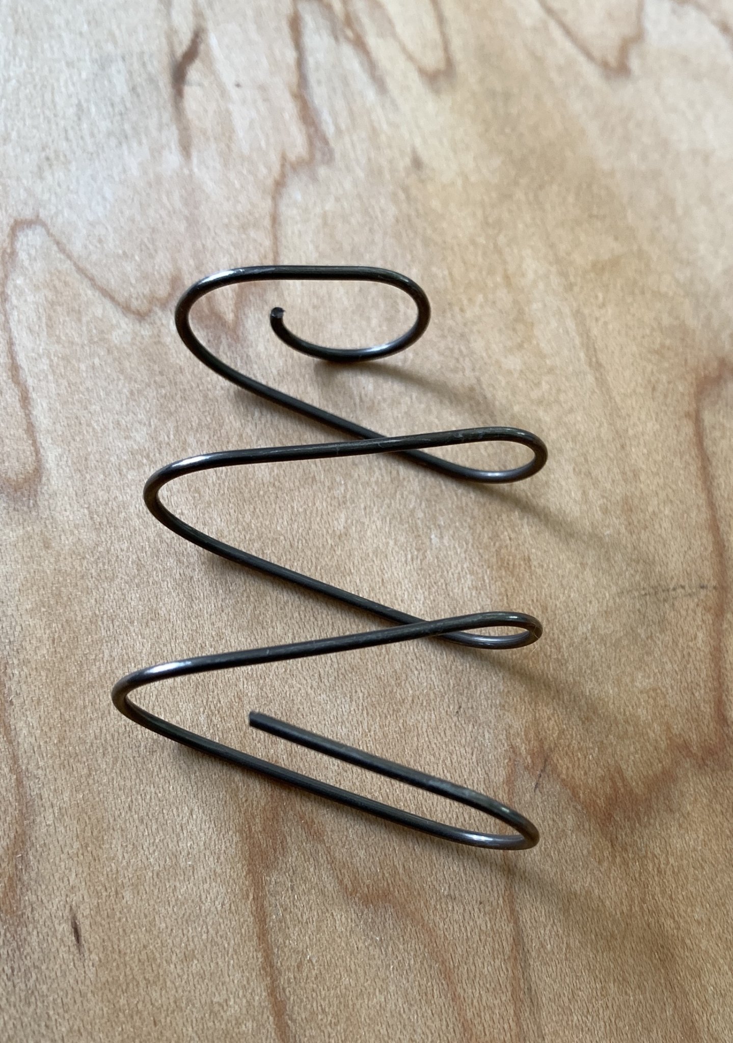

This picture shows both pieces of the original AR15 spring and the cut and bend of the bottom part proximal to
where the cut was made so it conforms to the angle of the bottom plate.
Next picture shows the shortened spring and other parts that make up the final assembly.

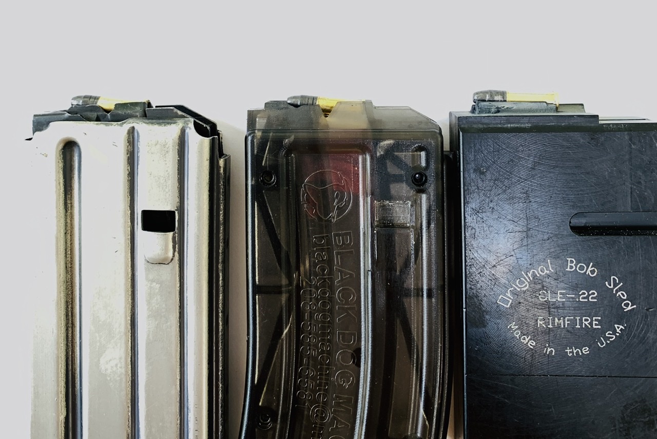

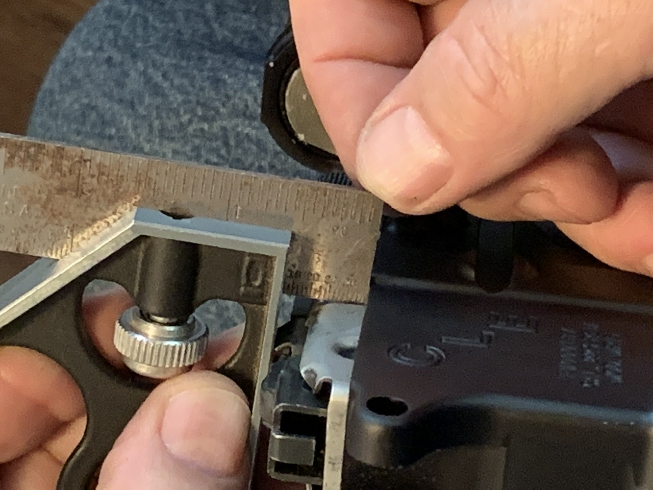

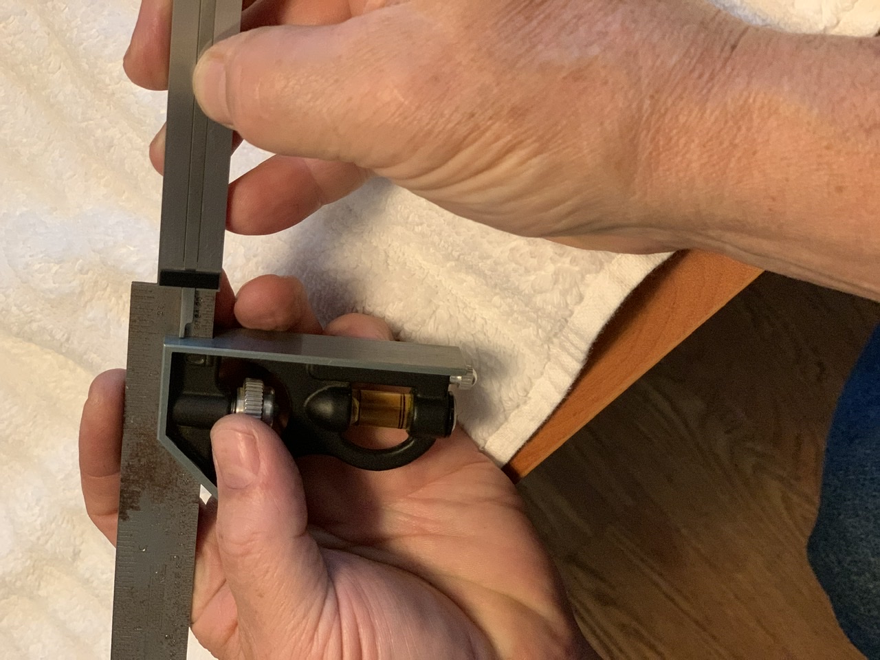

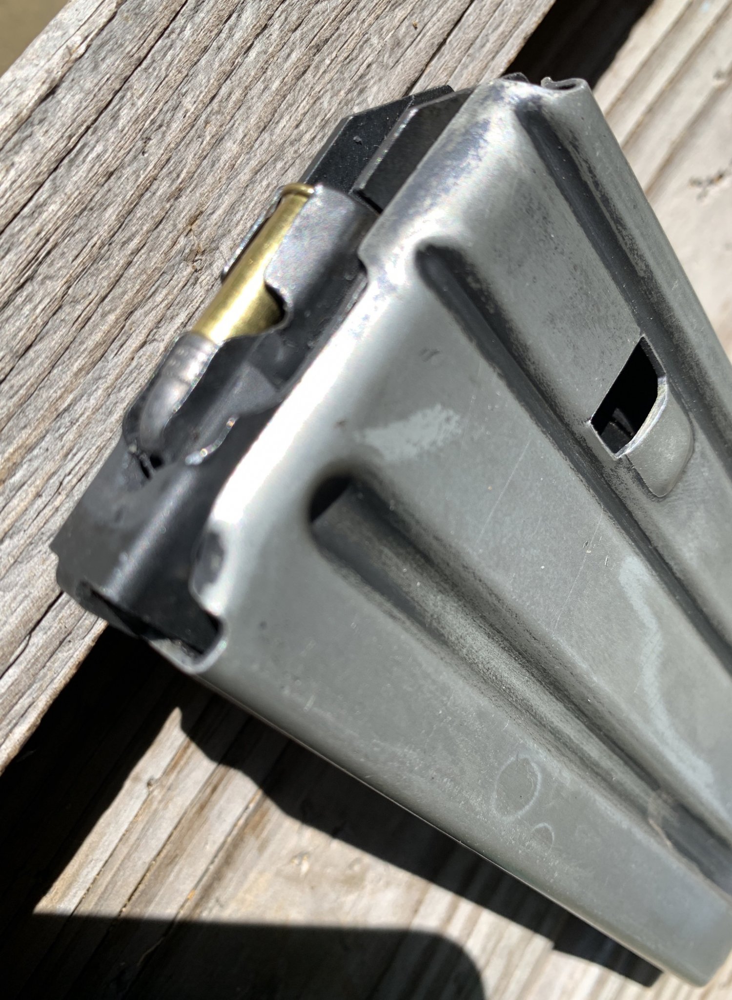

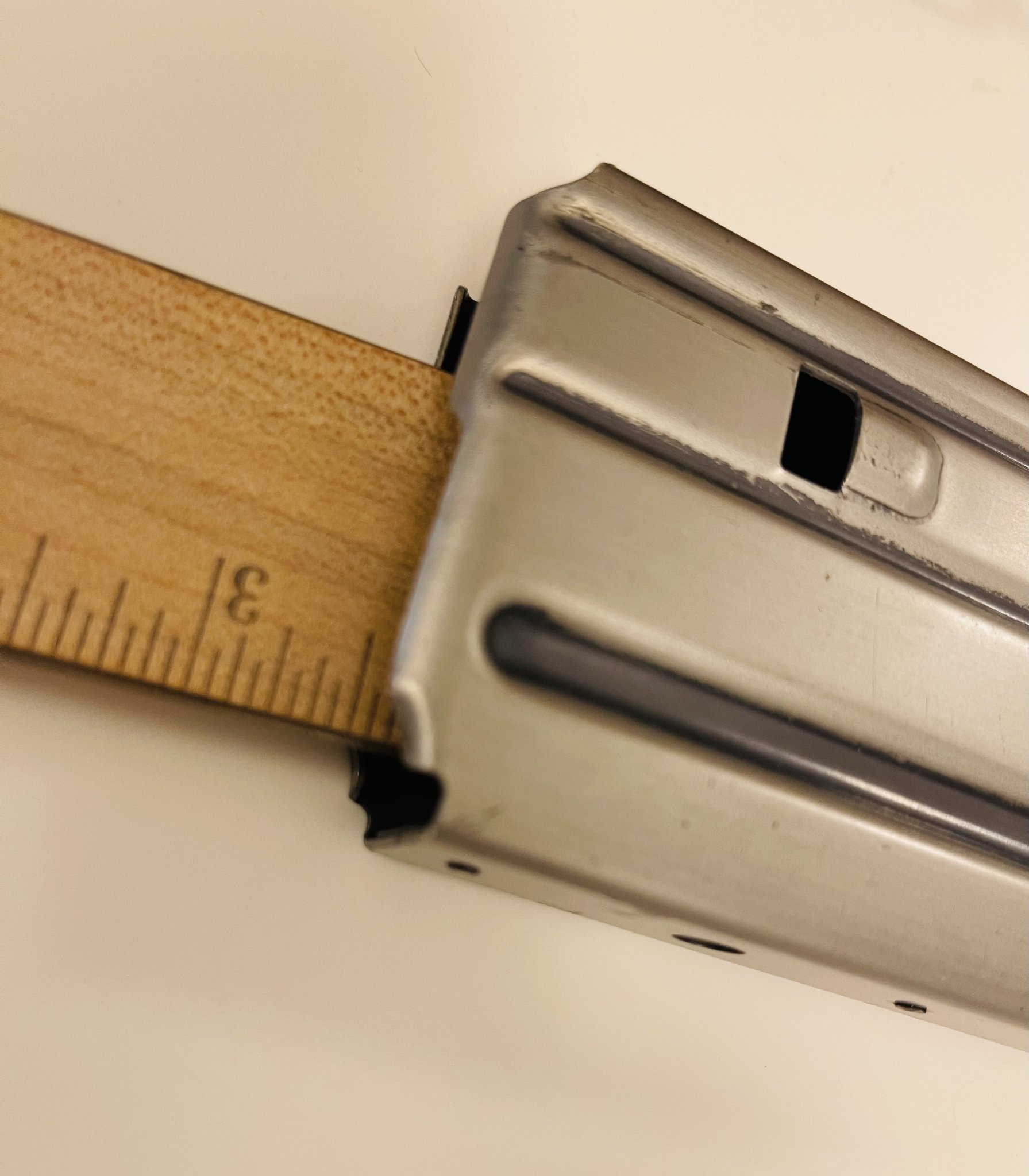

I just measured the seating depth with the mags in the receiver to see if I needed to modify the opening for the magazine catch. I’ll post the reference points I used for measurements of the mags in place in the receiver in case anyone else wants to measure and compare with what I did. I used the top edge of the receiver for one point. For the other point I used a 6” combo square with the flat of the handle resting across the rear flat lip segment the holds the 22 cartridge and then slid the blade down so it rested on the receiver top edge. See the following picture:
I then measured the blade with a micrometer to get the height above the receiver edge.
The depth recorded for the receiver edge to top of rear lip for the AR15 mag with M261 insert was 0.560”. The same measurement using the mag with the shortened spring as previously described with the insert lip assembly “pushed down“ the way it seats with 34 ounces of pressure against the bolt was 0.481”. Since I know this mag feeds ok, this was my reference point for a correct seating depth. I next made the same measure for the BlackDog M261 mag. It was 0.530. The following picture shows that mag in place:
I tried it in both a CLE receiver and Colt SP1 and it was the same. Note this is the mag that presses up against the bolt and will not let it close completely. This is 0.049” higher than the known 0.481 that does feed. I’ll now switch to a new reply because of space.

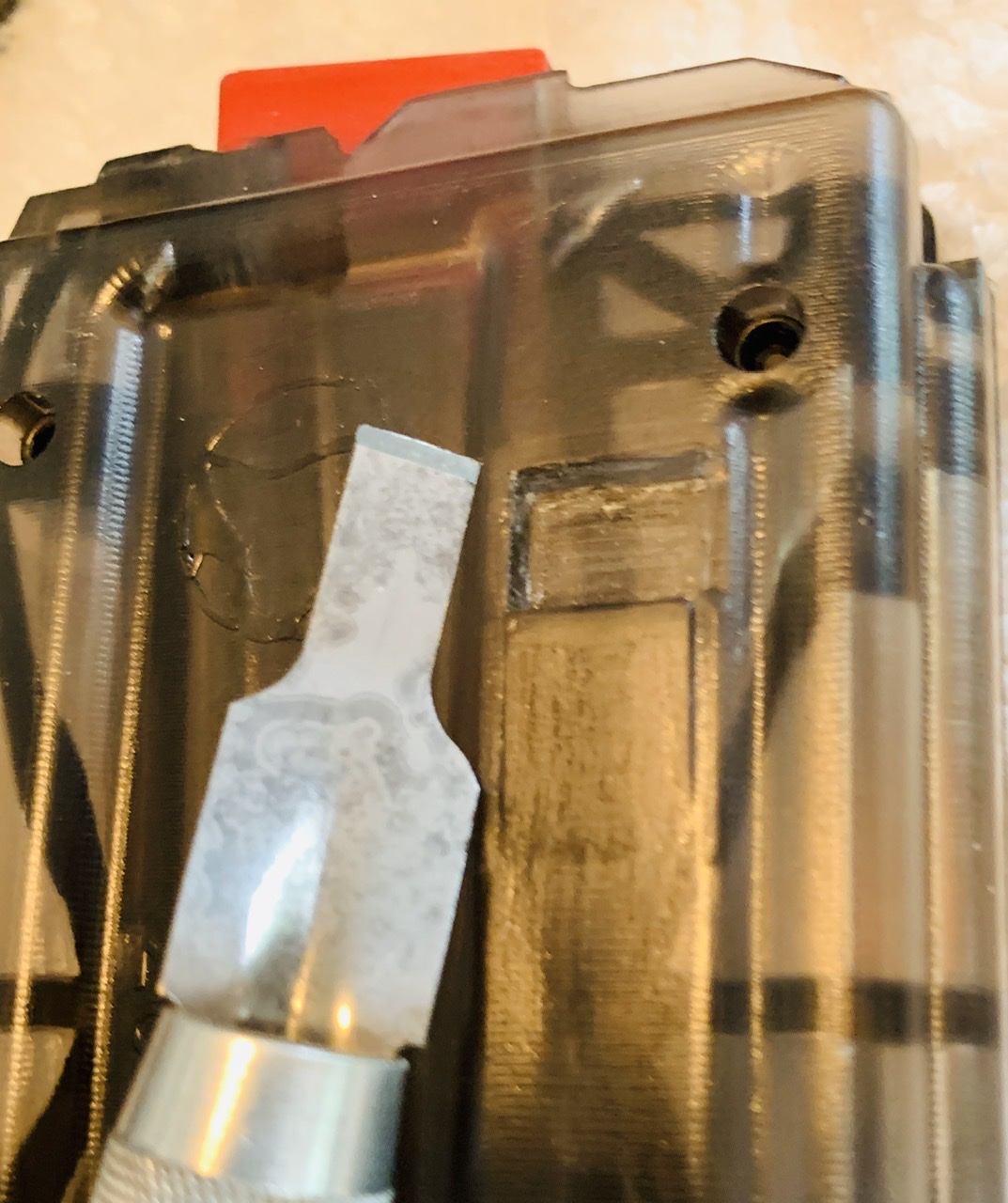

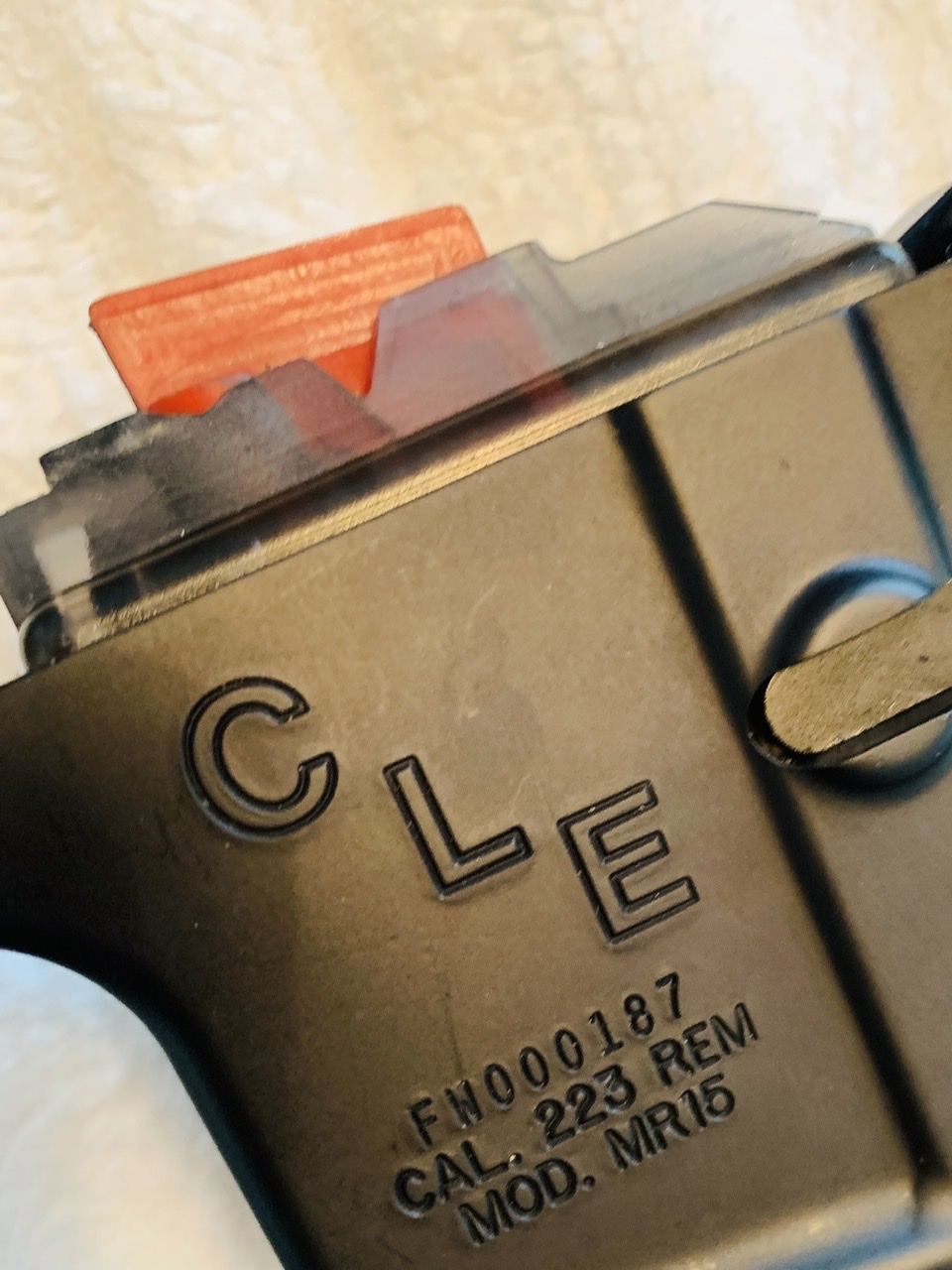

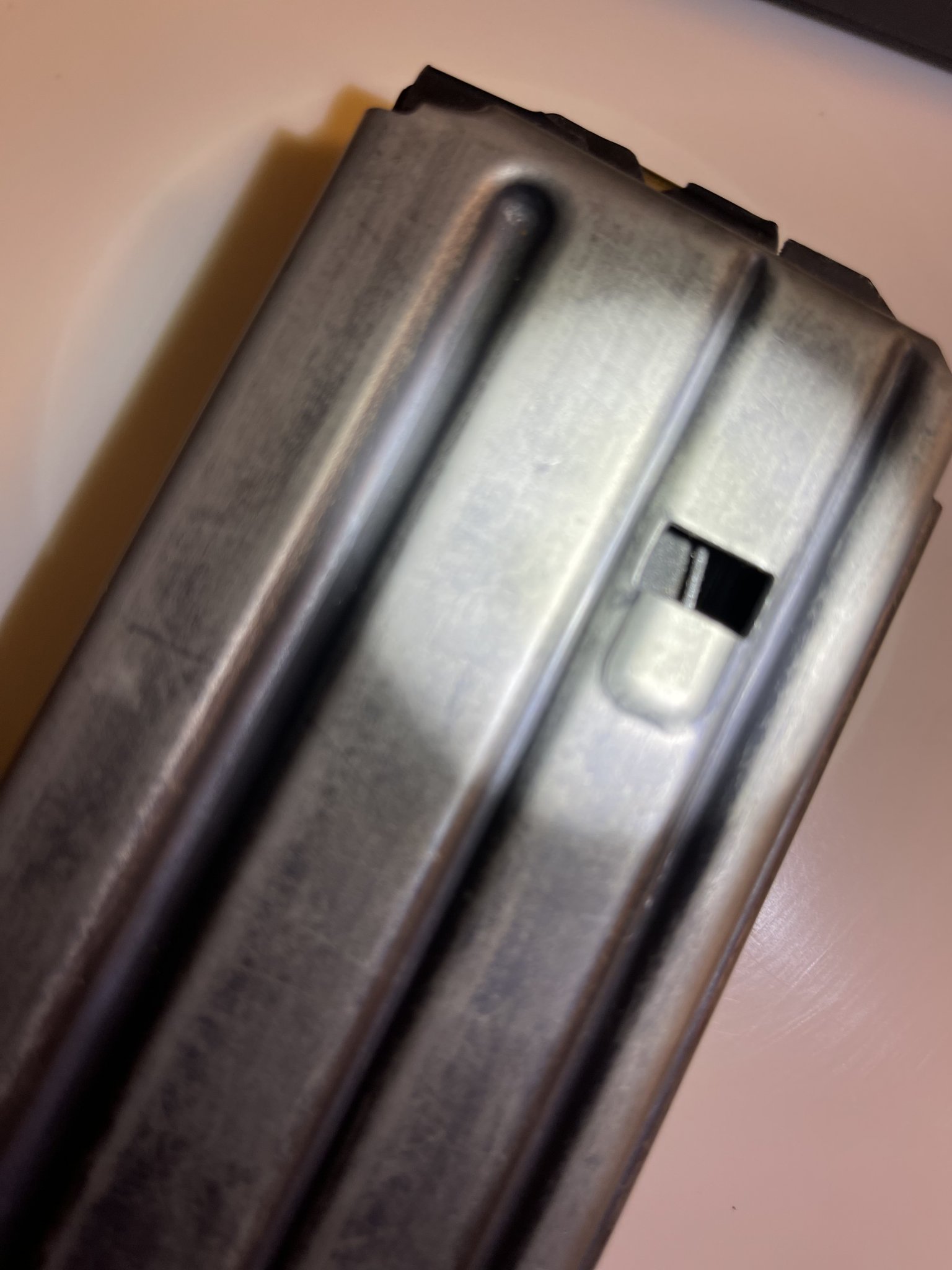

Next I removed 50 thousandths of an inch from the top of the mag catch opening in the Black Dog M261 mag using a X-ACTO chisel blade.
Here is the mag in place. The depth now measures 0.475”, almost the same as for the insert with shortened spring while pressed down simulating the bolt riding riding over it.
I didn’t plan on this being a teaser but by the time I finished it was too late to go to the range! I’ll go in the morning and try both the mag catch opening modified BlackDog mag. I’ll also recheck for function the shortened spring 34 ounce M261 insert assembly and the unmodified M261 insert in a mag with standard spring that takes 5 pound 4 ounces to depress that misfeeds so frequently by either crushing the cartridge or failing to feed straight in.

I would take some epoxy and fill in the lower part of the hole so any pressure on the bottom of the mag won't raise it. But I'd try it first and make sure it's fixed before you go to the epoxy.

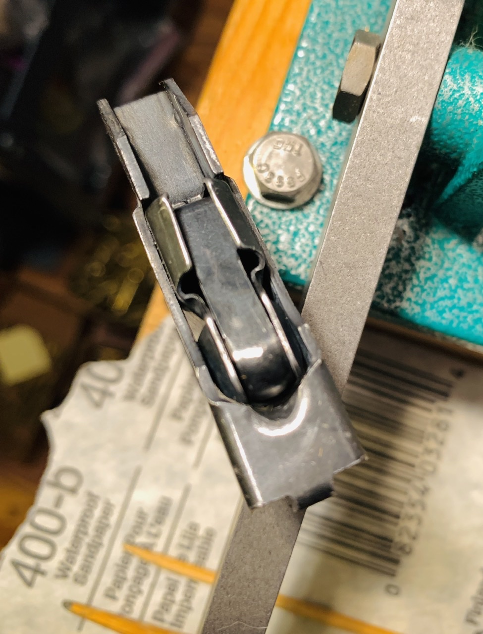

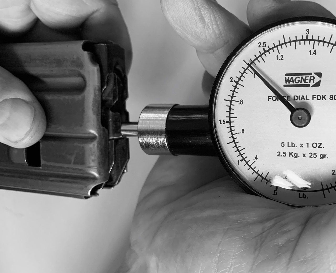

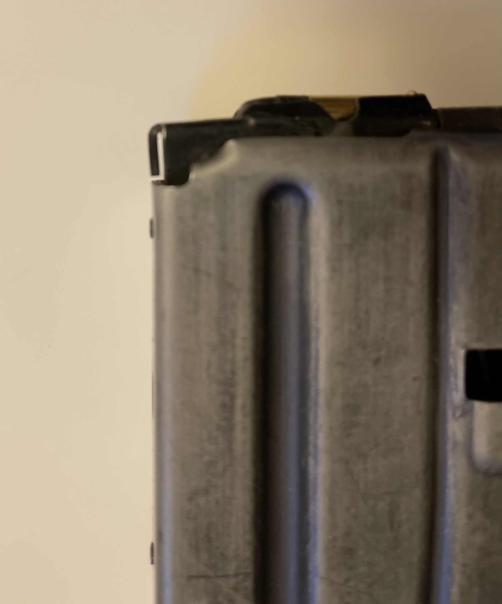

Now that I have made this modification in a number of magazines, I need to point out another variable to consider when deciding how much spring to cut off. Not all springs have equal force. If there is too much force, i.e. the spring is too long, feed problems can occur.
Measuring with a Wagner gauge, the optimum pressure, after reassembly and insertion of the 22LR adapter is in the range of 2 to 2-1/2 pounds. This is the force necessary to depress the insert the 3/32 of a inch or so necessary for it to be stopped from further travel by the magazine frame. (Of course when force is released, the insert springs back).
The attached photo shows the placement for the measurement.

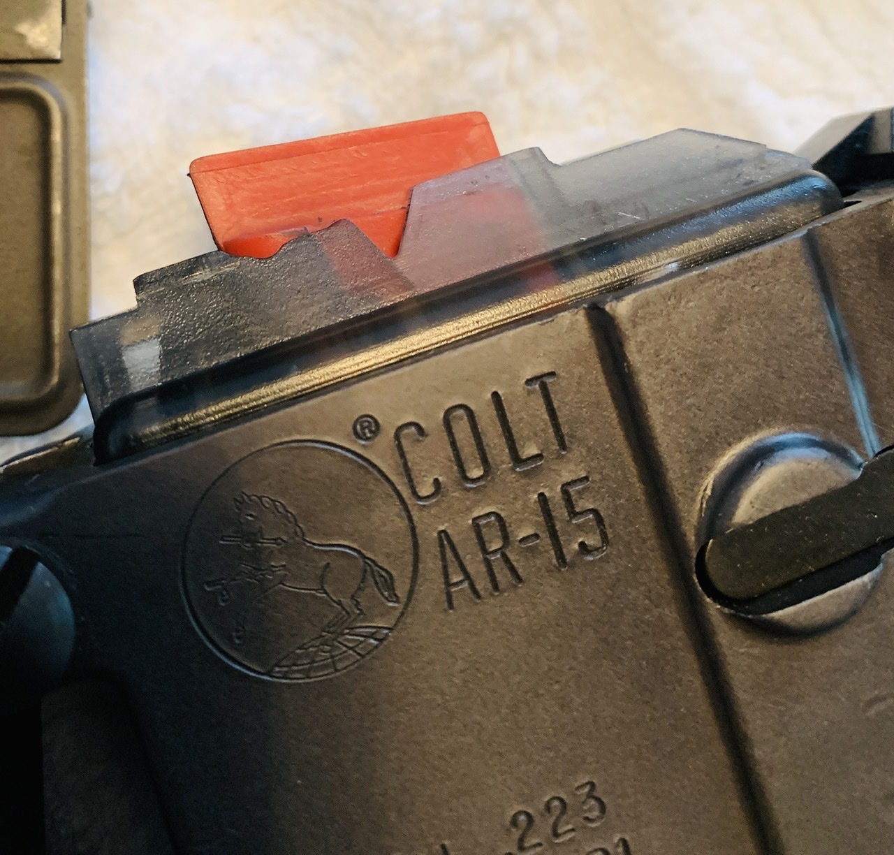

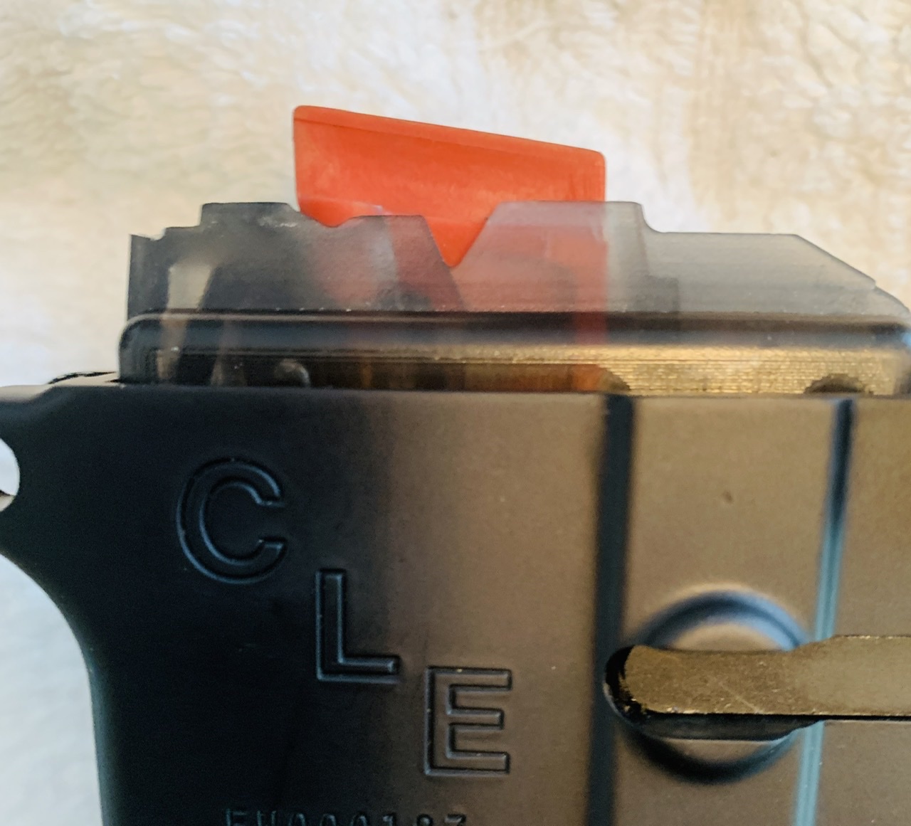

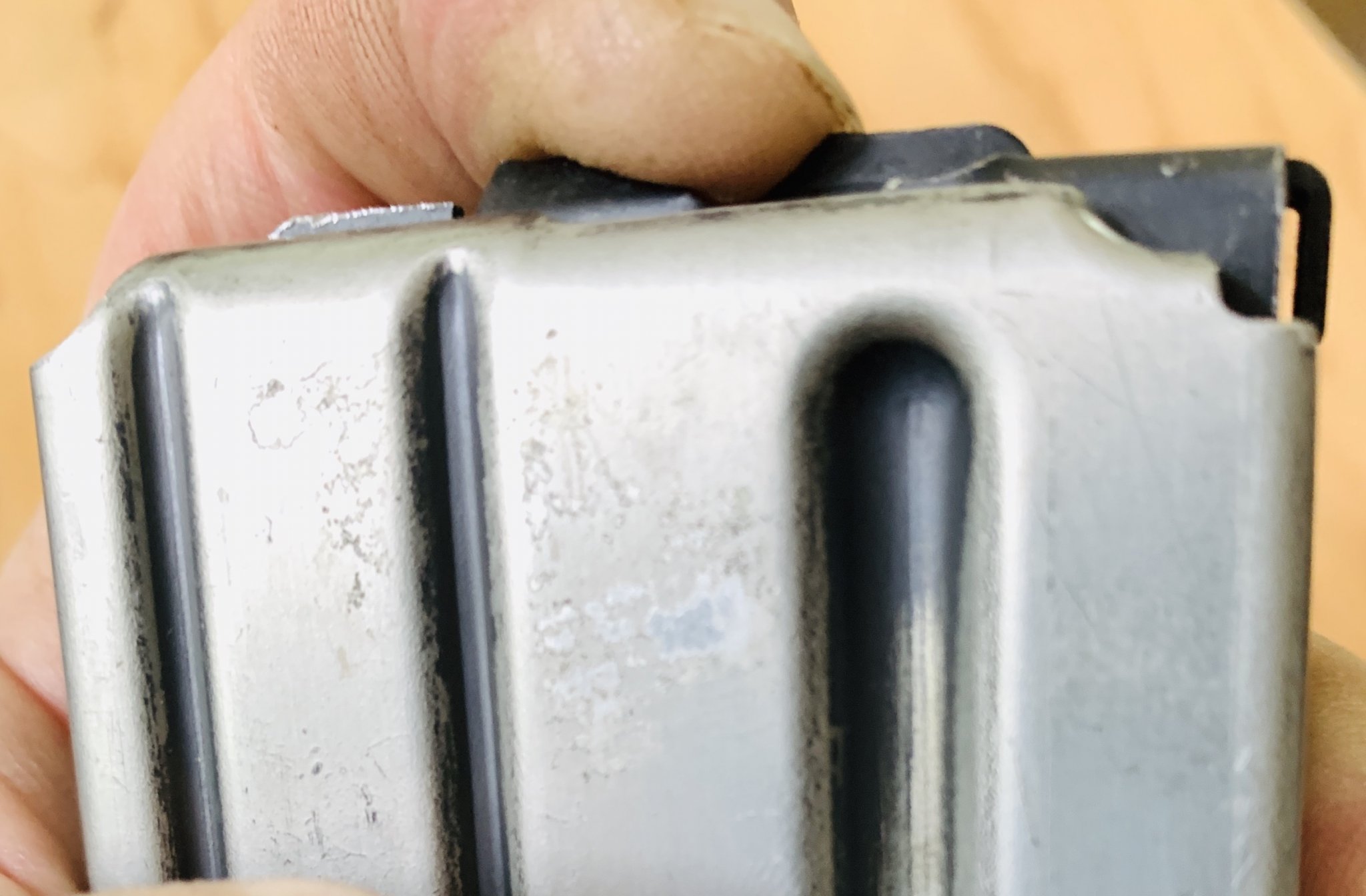

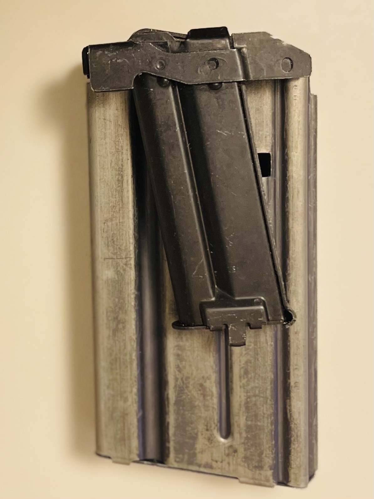

Let’s see if these pictures help. The first picture shows the position of the front tab. It is in line with the front of the mag. I took the picture so it would show this correctly and without distortion.
The middle picture shows the angle of the insert within the mag through the catch opening.
The third picture shows a insert laid on the mag showing the position of the insert within the mag.
I can add other views or explanation as needed and if I’m not addressing the right point.

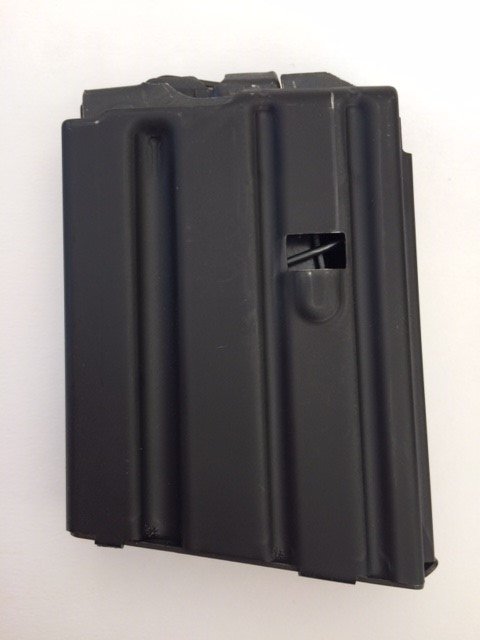

I bought three of the Black Dog M261 mags a couple of years ago, hoping that they'd work in my CLE 22RF upper and be reliable enough to allow me to use this rifle while I'm out at night with my dog - we see enough coyotes & racoons around the house at night so that I wouldn't think of letting her out to go do her business before going to bed without me along to be her 'bodyguard'. I bought the CLE machined match grade Douglas bbl and modified M261 from CLE, then put an upper together using Aero Precision parts, including a floating handguard with rails at 12:00, 3:00, 6:00, and 9:00, and have a TK16 LED flashlight in a picatinny rail mount and a pressure switch replacing the tail cap so my left hand can easily turn the light on if I need to take a shot at a predator threatening Bea-dog. Unfortunately, the BD mags haven't worked well at all - but some of the mods made by MLCM24 gave me some ideas that may make them usable after all. It's not that I don't have enough of the M261 insert mags to work, but they're more of a PITA to load than the BD mags are.
This is the 2nd dedicated 22RF CLE upper I've owned - bought the 1st one as an assembled upper from CLE back in the late '90s while I was still in the hunt for leg points for the Distinguished Rifleman Badge, but sold it to a friend who was also shooting leg matches after I legged-out in 2001. That 1st upper was very accurate, and mostly trouble-free, but I've had a few issues with this one that I put together myself. Had one round fire out of battery, which blew the extractor out of the boltface. I wasn't able to find it, so had to order in spares from CLE. It just hasn't been as trouble free as the one Frank put together for me, and because I've got too many other irons in the fire (including several precision 22RF bolt rifle projects on Stiller 2500XR, 40X & Vudoo V-22 repeaters, V-22S single shot, and now a Vudoo Three-60 action that I need to barrel), this AR22 just doesn't get enough attention. So when a thread like this one comes along, I pay attention and file the information away for future use. So thanks to both MLCM24 & Hellbender for the info!

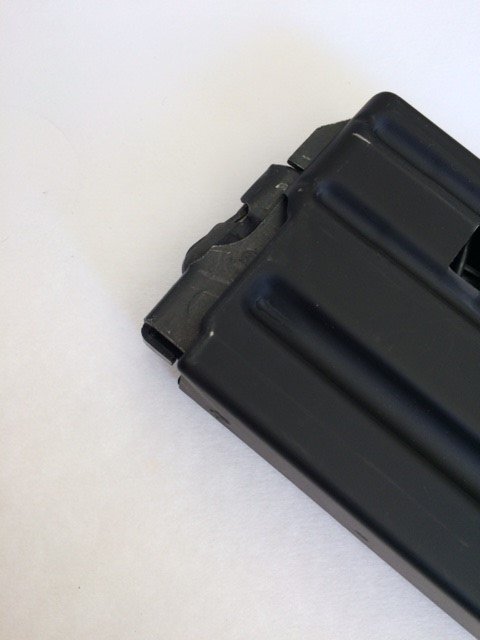

Here's the relative size of the insert and 10rd magazines. Hopefully you can see where the insert is being held to the rear, instead of the forward edge of the magazine. I think I'm going to start by polishing up the rough edges on the feed lips, and trying to bend the bottom coils of the spring so as to lean the insert forward instead of back.
If I try to go with 20rd magazine's I'll have to do something like put a cross pin in below the top "wings" of the insert, but above the follower. That should would allow it to float normally, but prevent their being used to feed ammo normally, which would keep me legal. Ideally I can find a shop that does mag blocking already to do it for me. If not I can buy blocked mags and modify them. So long as I pin the top side before removing the capacity limiter I stay legal here.
It would probably be more cost effective to buy the blackdogs, and sell my inserts. But I enjoy a bit of a challenge, and prefer the look and feel of the metal magazines.
I agree. The short magazine is too short to be workable.

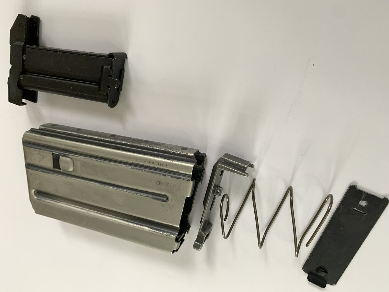

Here’s a measurement to consider. When I used a 20 round magazine and cut the spring down, with the follower simply resting on the spring, there is just under 2-1/2” clearance left for the insert before any spring tension comes into play. See picture.
Do you know how much clearance is above the follower when it hits the block for 10 rounds? Hopefully the spring can be cut so there is about 2-1/2” clearance and the follower is still above the block. My concern is that with 2-1/2” clearance, 12 or 13 rounds of 223 will need to load before spring tension is engaged (I loaded this many in a mag with cut down spring and insert removed). You may need to try less spring cut down than I am using. Anyway, another variable to consider.
You are correct about the length of the insert being to long to fit on top of the follower in a blocked magazine. It would need to be a set up dedicated specifically to these inserts, rather than something I could use for 223 as well.

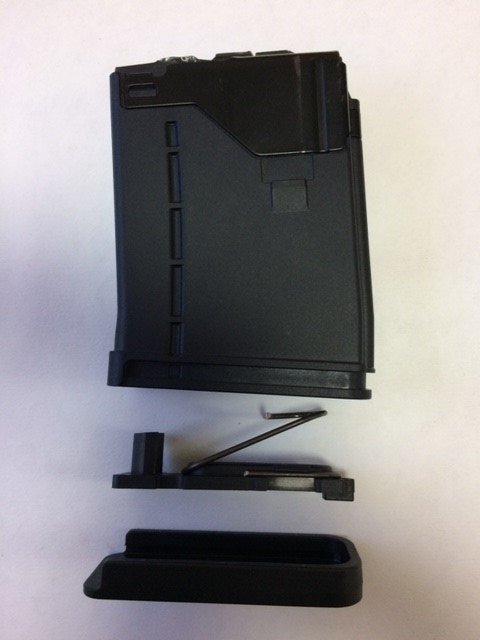

I did have an idea yesterday evening which I think will work with my short magazines. I realized that the reason the insert was being pushed to the back was because the front edge of the spring was bumping into the ribs in the magazine. I removed the normal mag spring, and instead installed a round spring with guide rod into the back of the magazine. It’s not quite as stable as when it’s locked into a mag with a follower, but it does sit at the forward edge of the magazine now, and floats against the bottom of the bolt group like it should.
Ran 30 rds each through two different mags today. I had some (3) failure to feeds on rounds one, (2x) or two (1x), and one failure to eject. But after that they ran the remaining rounds without a hickup. I think that if I were paying more attention to making sure the mag is seated correctly, and the first round is at the right angle it would stop jamming that first round as well. I will try to find a spring that fits a little better. I believe that will help as well. The two I used were made by taking a tension spring, stretching it out into a compression spring, and crushing the top coil to fit inside the insert. Not pretty, but functional.
One up side to this, is that it's really easy to remove the insert for loading. I've always found it a struggle to load all ten rounds with the insert wanting to push down into the magazine or flop around side to side. With the round spring I just slip it out, load it, and pop it back in.
All in all I think this was a success, and a good starting place for anyone else who wants to give these a try, but is limited to reduced capacity magazines.

Update-I spent most of my morning playing around with this project. I came to the realization that a better solution may have been sitting in front of my face the whole time. When I first got this upper I dismissed Pmags as an option almost immediately. Pmags are too narrow to accept the insert without binding, and I didn't want to file out the interior to make them fit. This might actually be a reasonable option if one were to either file the inserts rather than the mags, or just thin out the mag walls enough to fit though. Pmags have tighter spacing between the feed lips, so they would do really well at keeping the insert centered in line with the bore.
Lancer L5's on the other hand are shaped more like a standard metal magazine, and the insert drops right in. I took an extra mag spring, cut it down to a single coil, bent a leg into it, and clipped that onto the Lancer mag base plate. It's a really good combination. The insert has a little bit of "float" still so that it rides on the bolt group, but it also bottoms out on the mag base plate, keeping it in position for loading. I'll have to get back out to the range to verify, but everything feels very promising so far.
Shot the Lancer mag conversion this morning and feel that it's the best option for my low capacity magazine situation. Slightly better feeding than the metal mag But that may be attributable to my having a better understanding of some of the first round jams.- I found that having the bullet nose slightly up for the first round works more reliably than counting on the insert ramp to lift it.
It's also easier to load cartridges into the insert in the short Lancer than in the short metal mag, or standard capacity (30 rd) metal mags I have.
For me I think this will be what I stick with going forward. If anyone else is interested in trying this, and the description of my spring mods are unclear, feel free to PM me, I'll gladly help out if I can.
