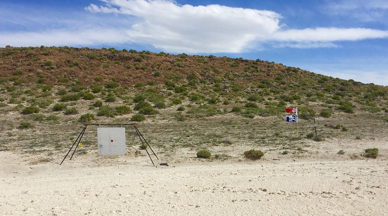

we set ours up on a 4'x4' piece of 5/8s" plywood with the center cut then set up an IPSC target 10' to one side and slightly behind as a sigther target but i get what your saying.

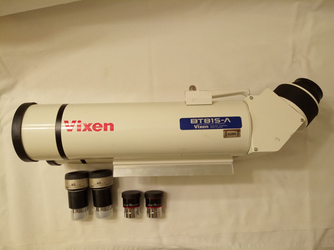

A really nice spotting scope like a Kowa prominar certainly helps on those tough days.

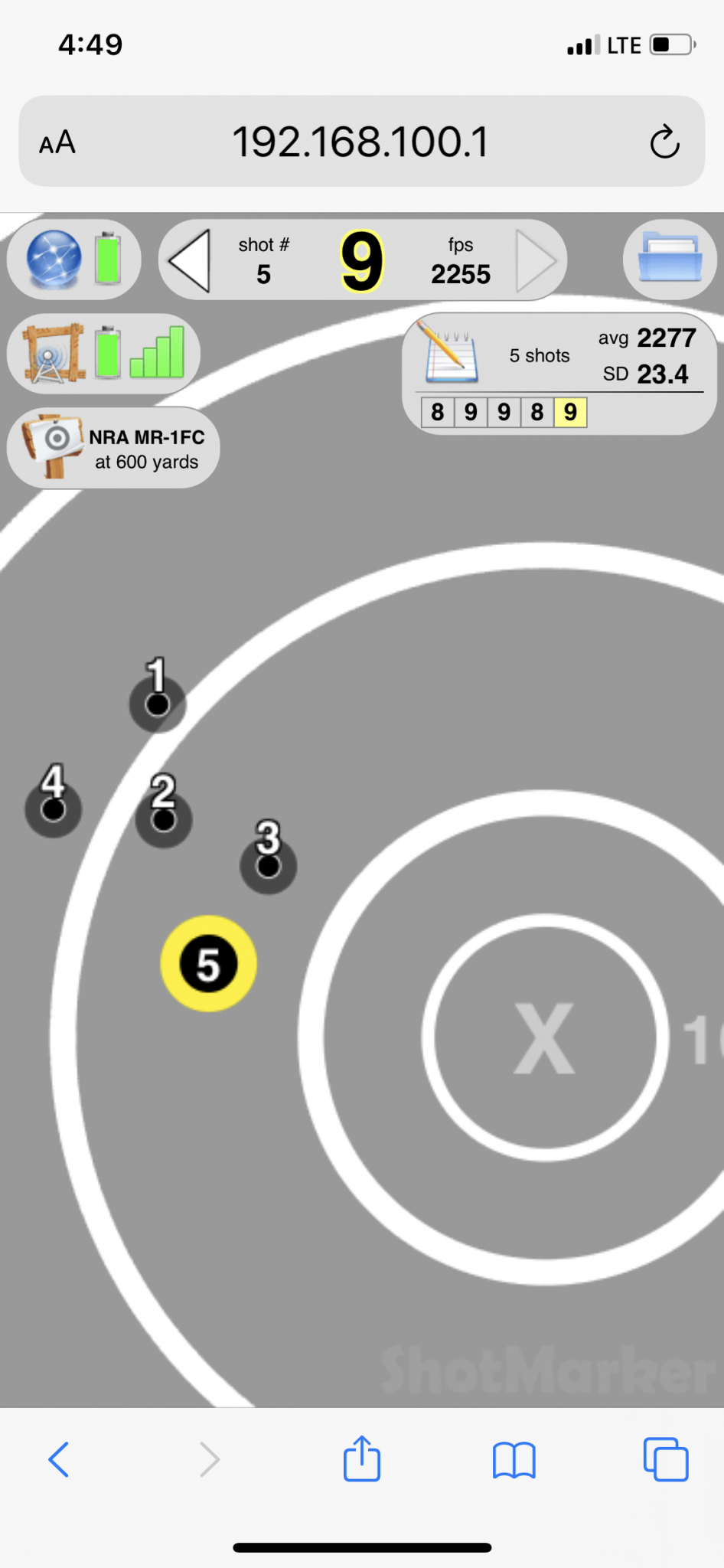

I mentioned the shot marker because it would allow you to have a much larger targets than is feasible with steel making the spotting of misses easier as you would have more hits. But it only works as long as the bullets are supersonic as mentioned.

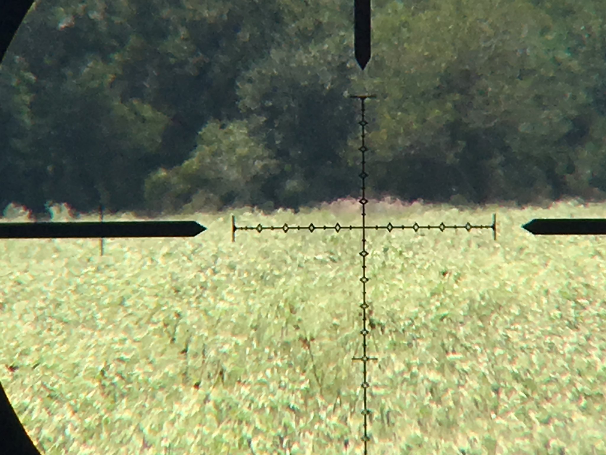

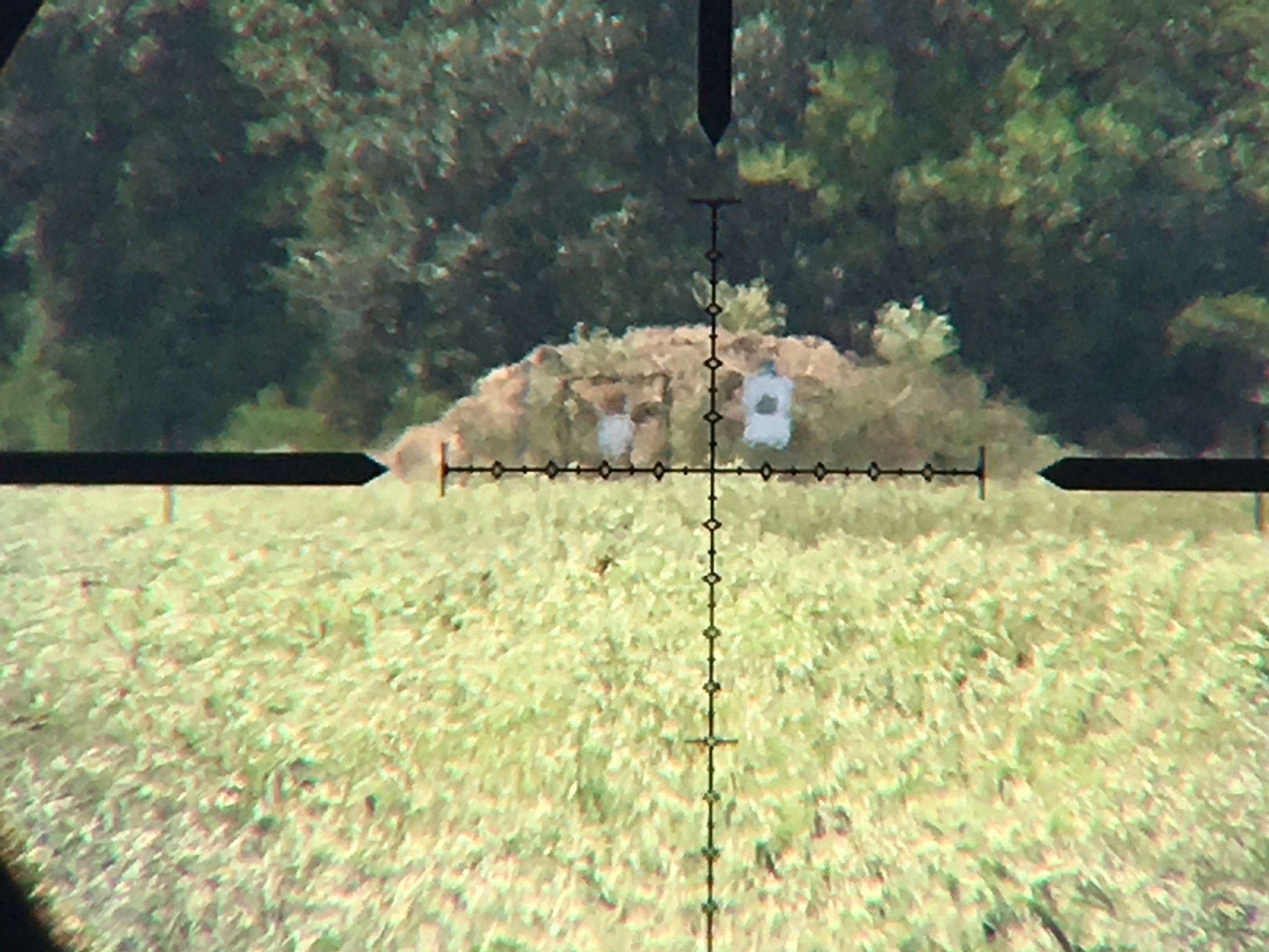

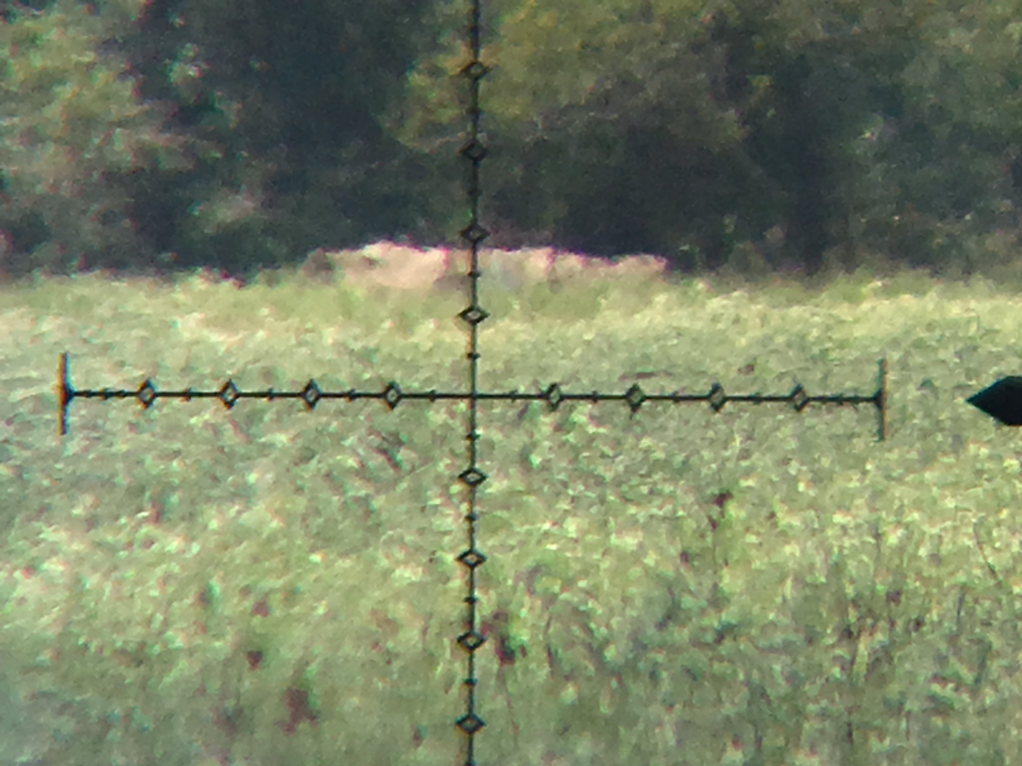

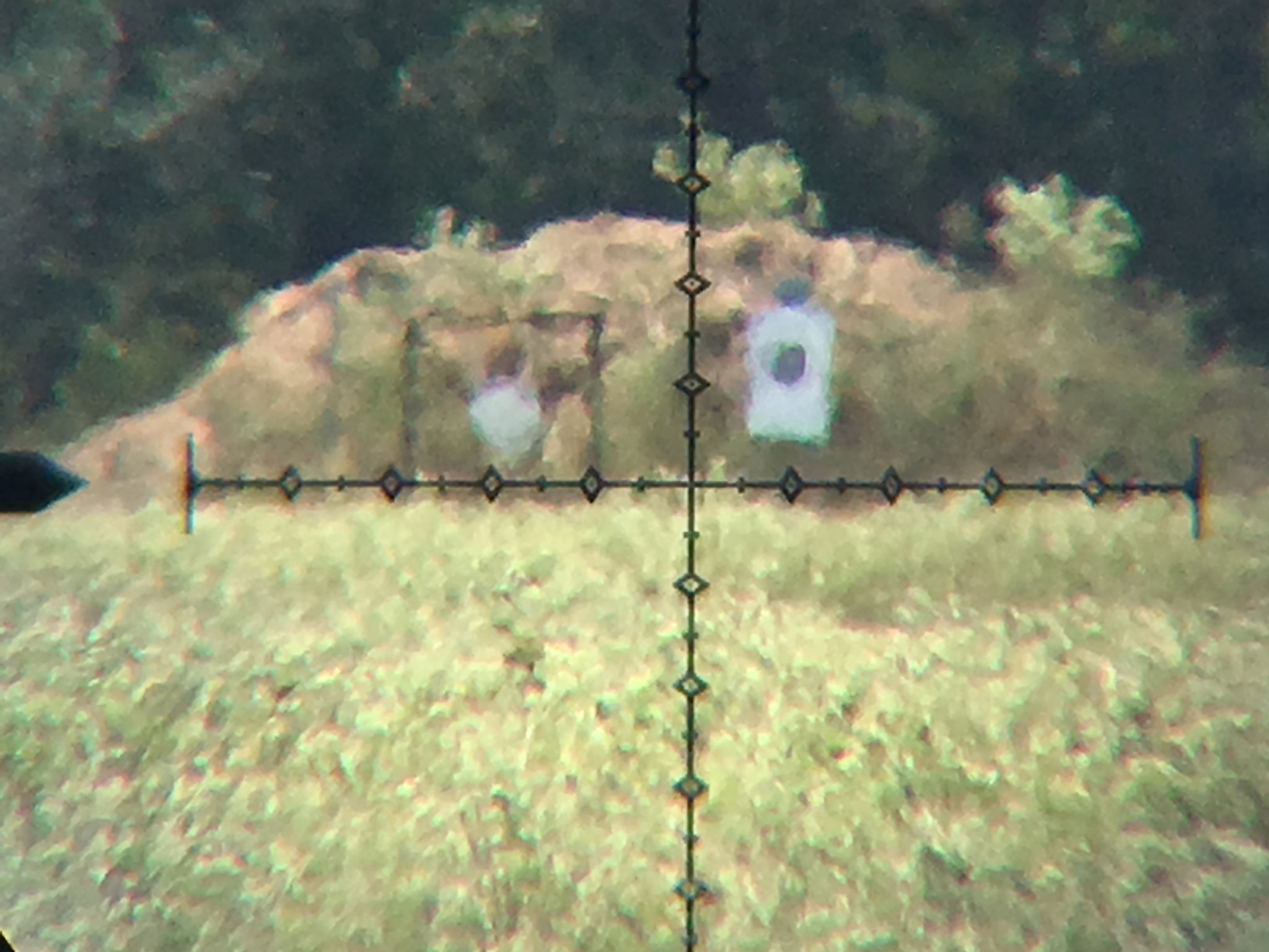

I live in a similar climate to the OP. There are times where I cant shoot at 750 much less further due to mirage being so bad I couldn’t tell a hit from a miss on painted steel. The target moves so badly it looks like it is hit without shooting if it can even be seen. If the wind is good, you can hear the hit. If not then I don’t shoot. On those days, pretty much most of the summer, its early morning shooting.
750 on 20x
750 on 10x
500 on 20x
500 on 10x
Reactions: Milo 2.5
I'm of the opinion that where you impact on a target is harder to control the farther out you shoot. Shooting 1700 yards + is a challenge unto itself. Unless you are loading ammunition with singe digit ES and SD of under 5 with bullets able to handle transonic/subsonic well, shooting in perfect conditions and are a very good shooter, where you hit on the target becomes less important than just getting a hit.
750 on 20x
750 on 10x
500 on 20x
500 on 10x

Magnetospeed worked well at 1820 for 6.5cr and 308. Yep 308. Lol. He hit I’m a witness.
