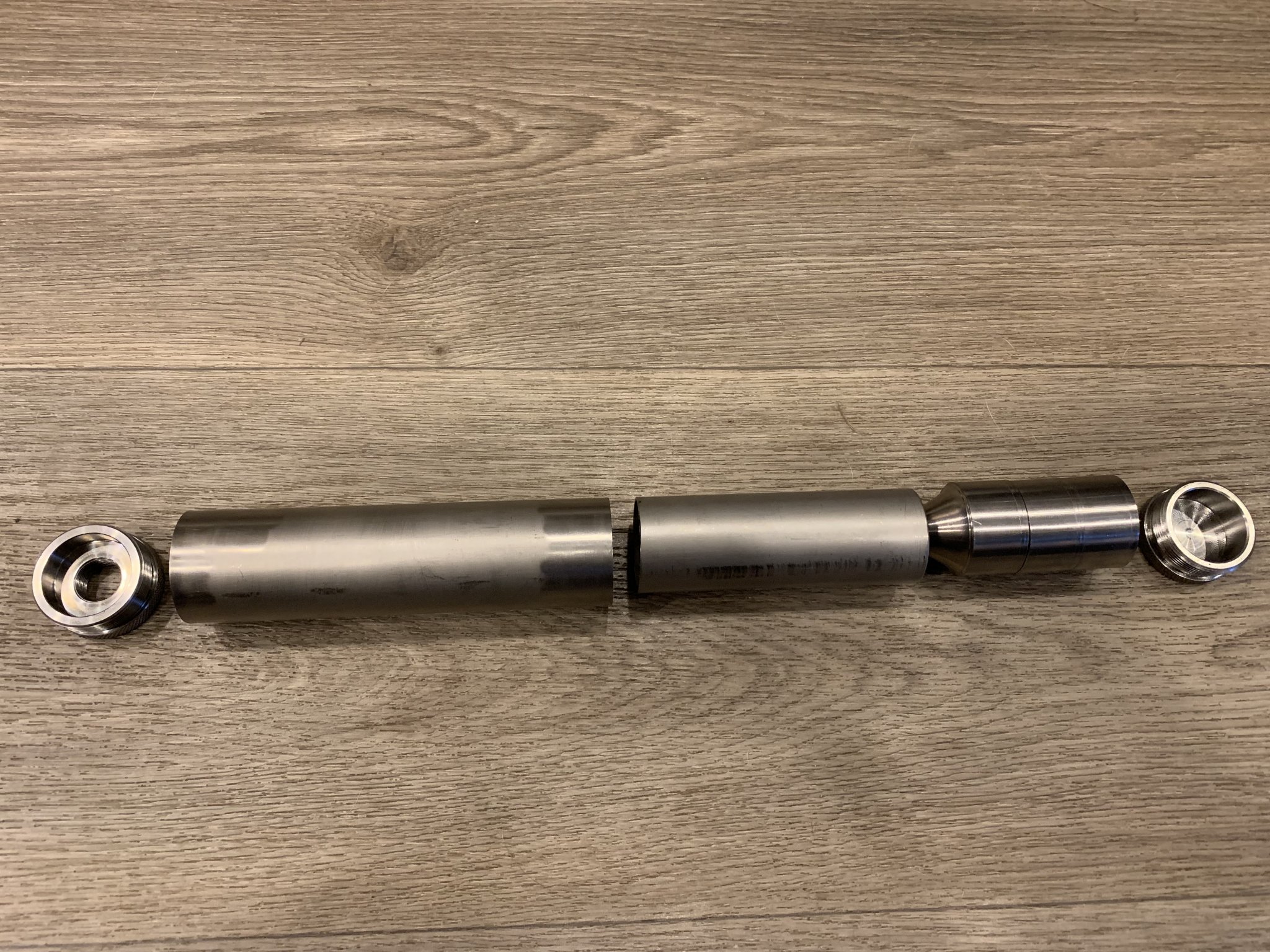

    So a few guys have been asking about a lighter, all titanium solvent trap that they can get a form 1 approval to punch a hole through. Full Disclaimer!!! Don’t put a hole in anything without an approved form1! I’m not implying it and Solventtrapsdirect cannot and will not discuss it with you.
    I set out to build a light suppressor for my 358win. It’s sat pretty lonely in the back of the safe ever since I’ve went suppressor only shooting. I asked tbac over the years to make me a 358 capable 7” can but they’ve never been about to make it happen due to work load mostly. No knock against them, being too busy to do one off stuff is really a good thing! But, it left a hole in my suppressor group. I’ve since fixed that by getting a 6” solvent trap and dry storage cups from solventtrapsdirect.com I went with 3 cups to be made into baffles and a expansion chamber using their spacer tube.

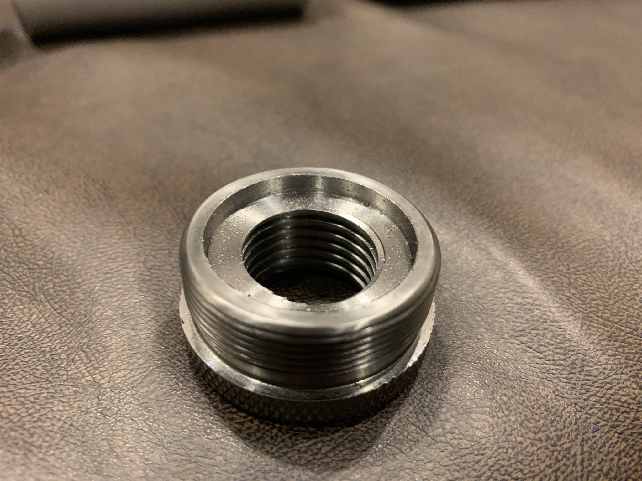

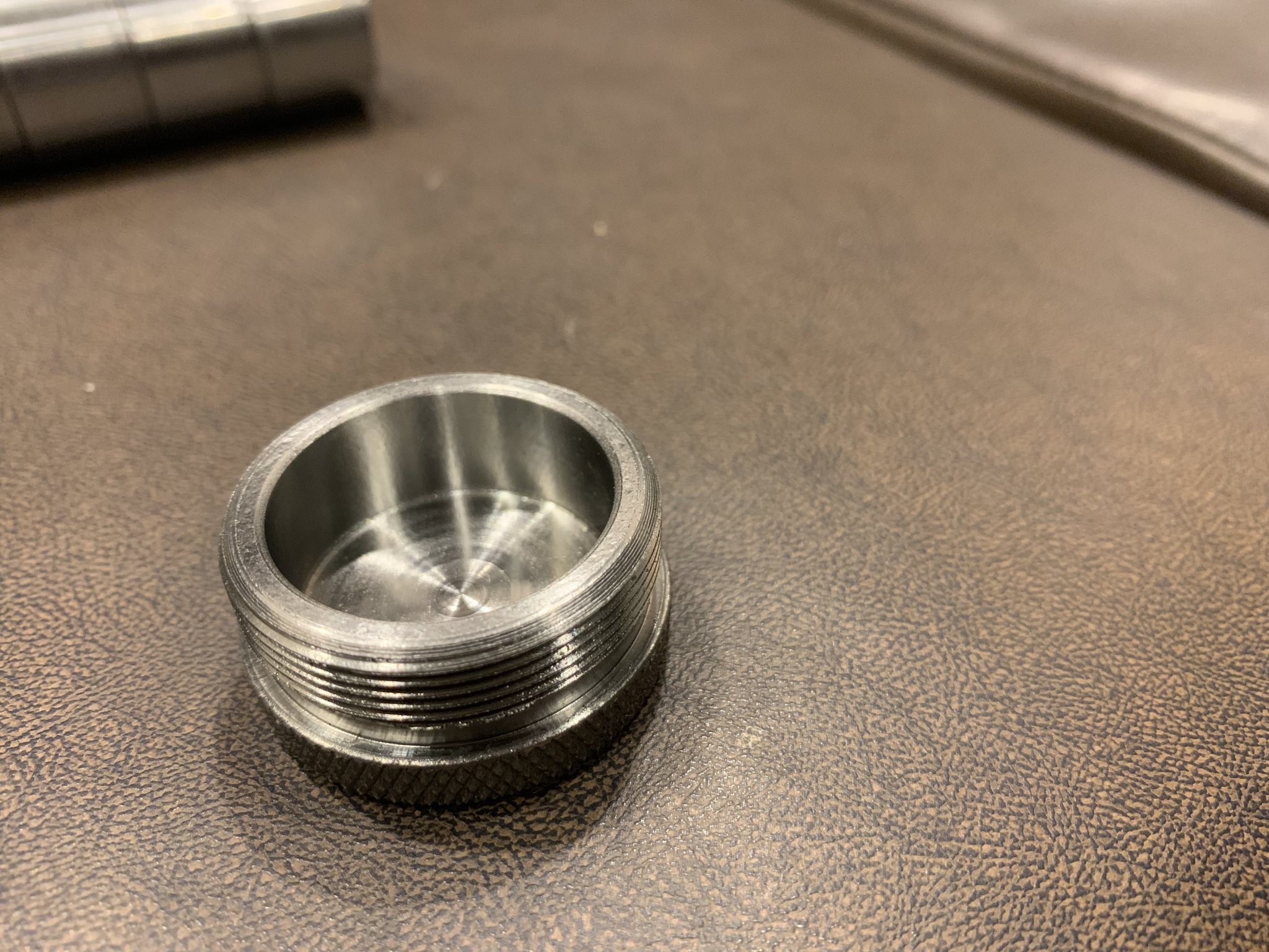

    I used their 5/8-24 thread protector as the rear cap, cut the spacer tube to a length that made a crush fit when fully assembled and used their end cap as well. All the parts were sourced from them.
    The tube is medical grade 9 and the cups and caps are grade 5. Pretty top notch materials are used.

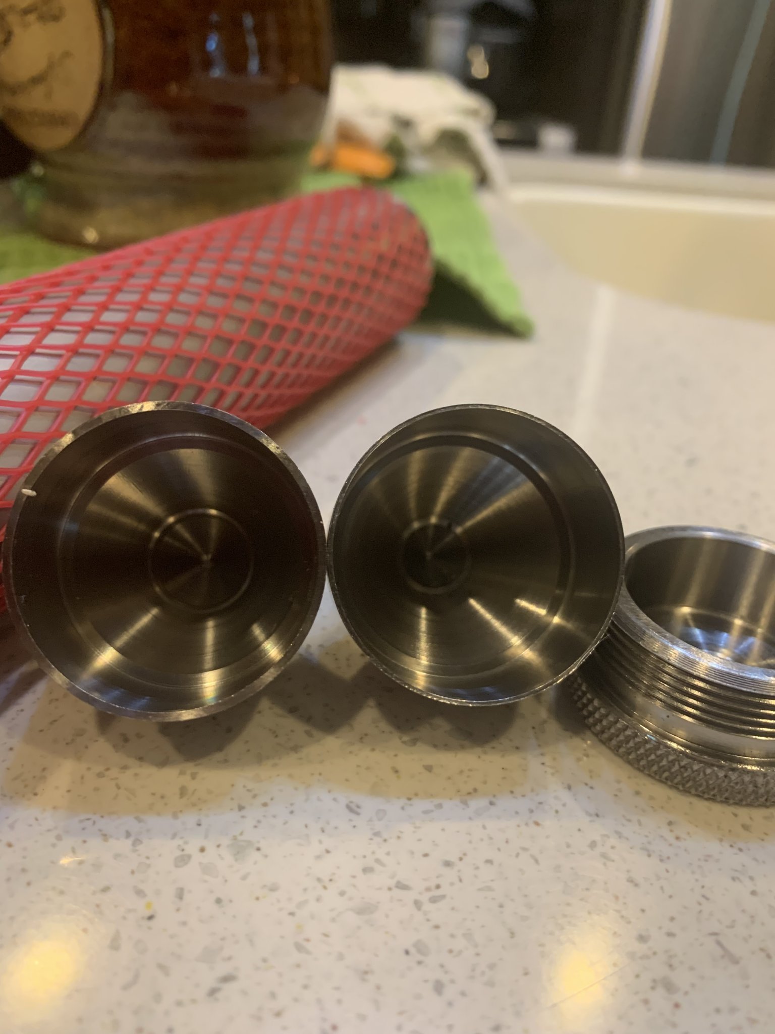

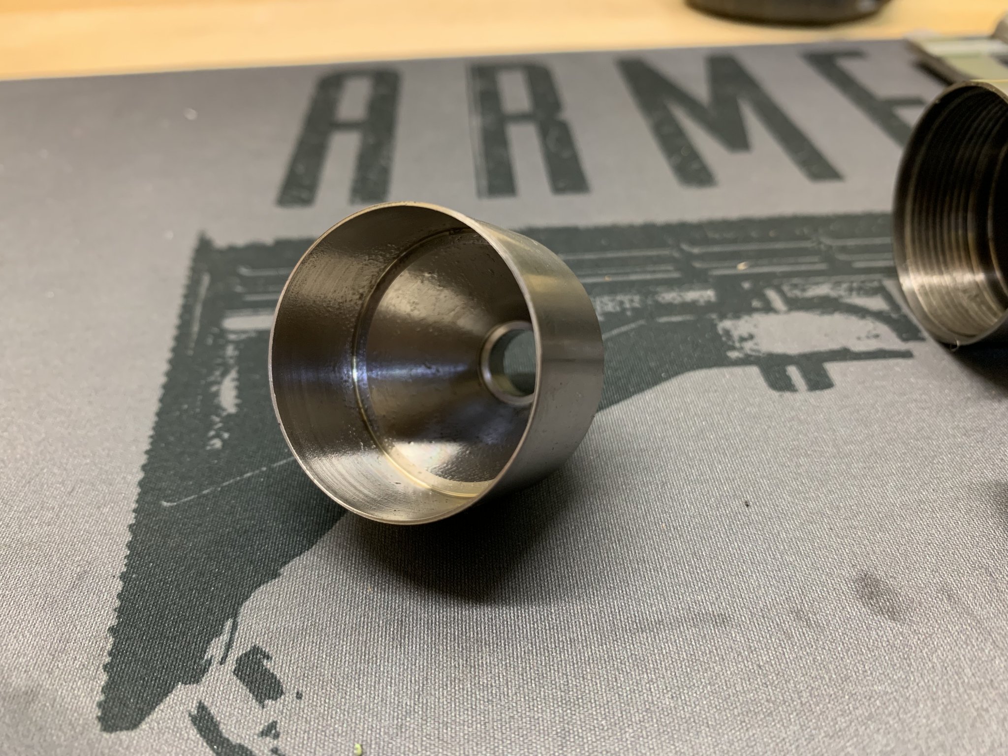

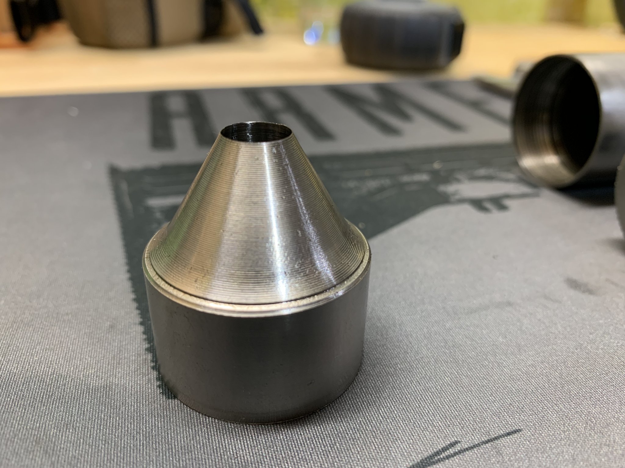

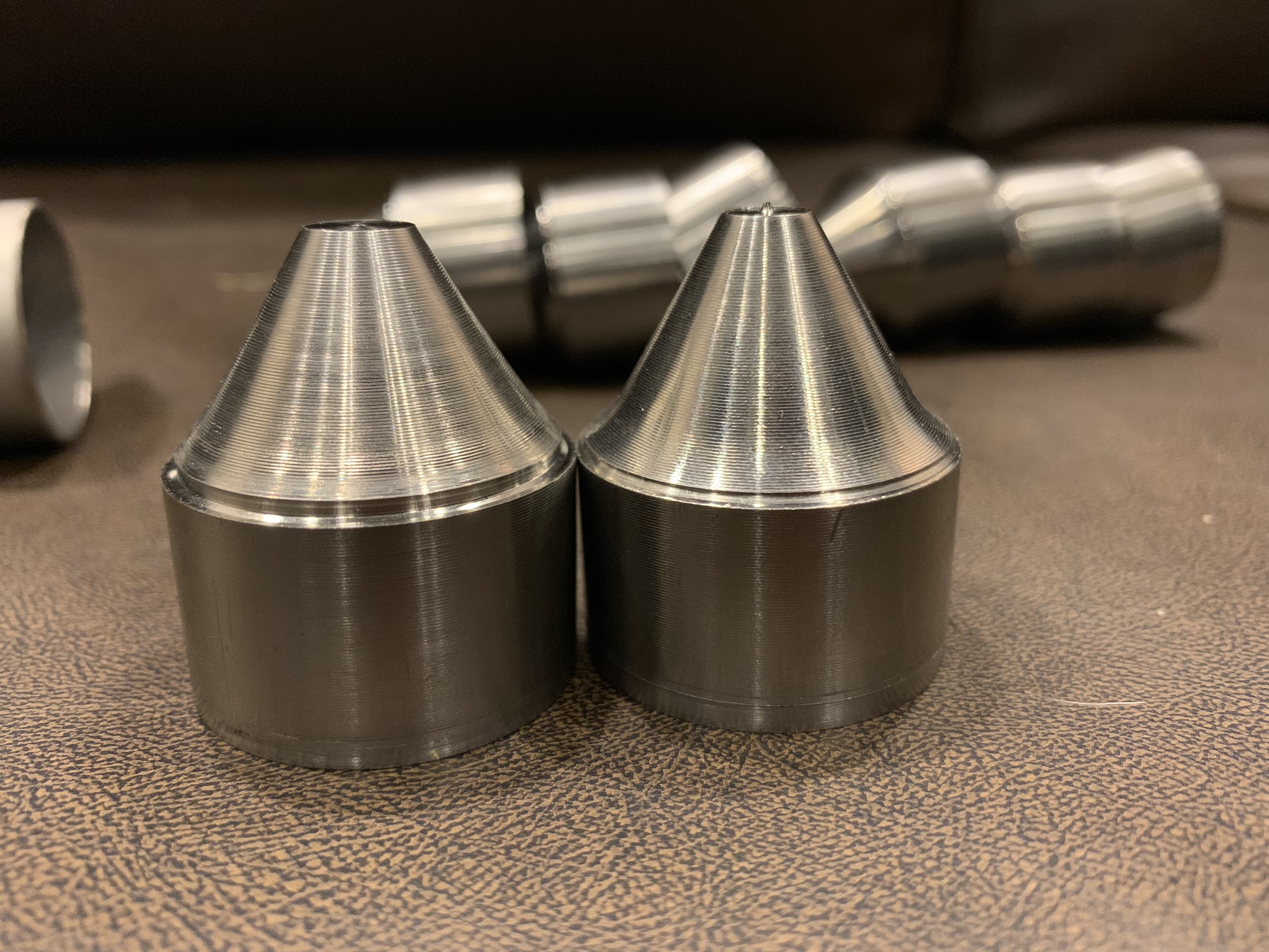

    The dry storage cups that were made into baffles are a simple 60 degree cone with a skirt. With a quality cobalt drill bit I was able to drill the hole with easy using lots of lube, lots of pressure and low speed. Doing it this way make it cut almost like aluminum in nice big perfect curls. I used my lathe but it can easily be done on a drill press from the back side of the cup. When I ordered the cups, I was planning on 2 builds and ordered a couple too few. I reordered and the second set was quite a bit thicker.
    After calling and talking to the owner, she explained that the thicker ones are the newer style as she felt the thinner ones might not be what people are after. If you order now, you will receive the thicker cups I am told. There is also some variation from cup to cup within the 2 lots that I have. I’m not sure what would cause this, seeing as everything in don’t on one CNC lathe but it’s there. It hasn’t cause any problem that I’ve been able to tell accuracy wise.

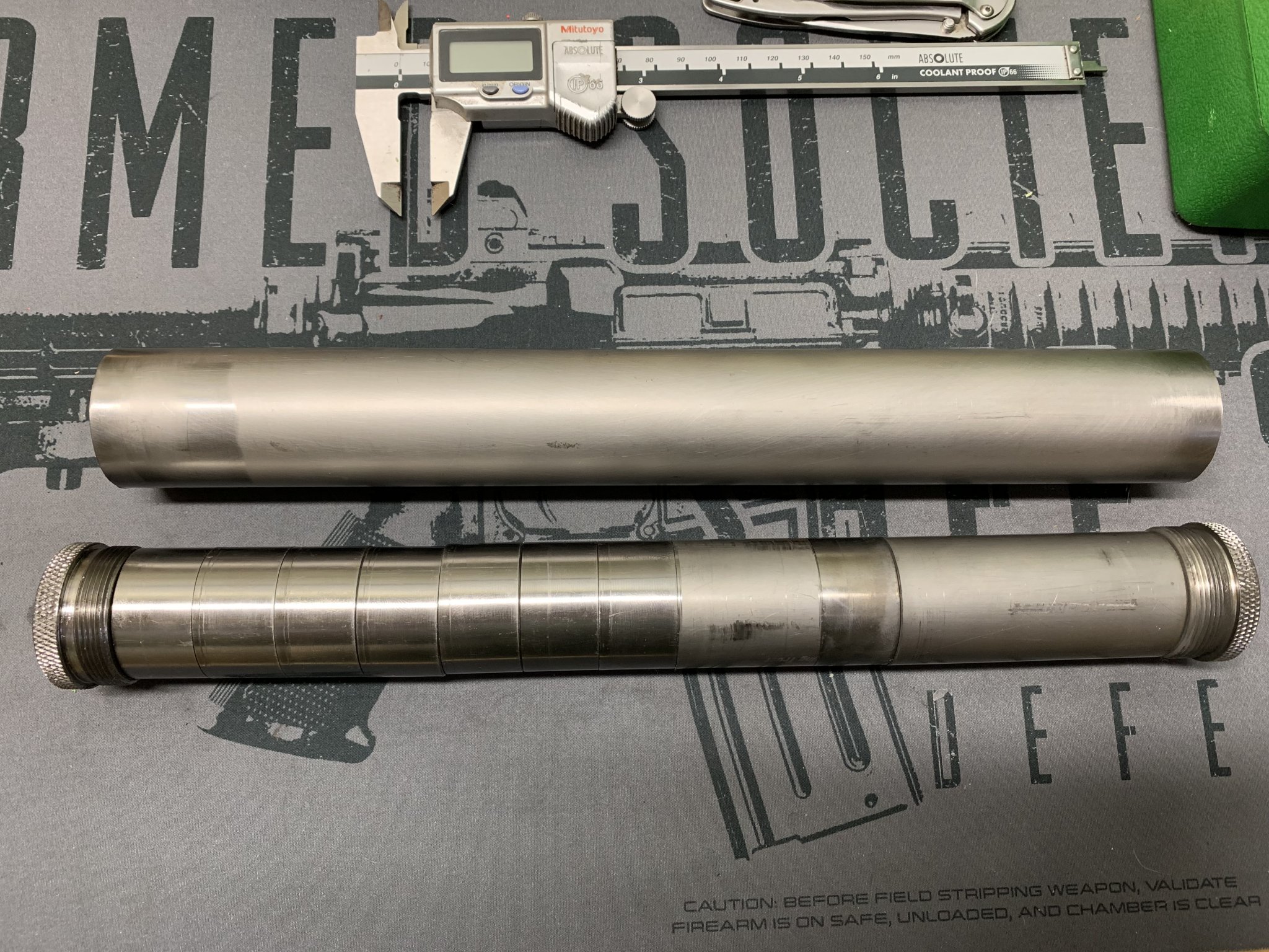

    The front cap is a little thicker than I think it needs to be but a guy could thin it down if you wanted to shave a little more weight. My 6” with the 3 baffles weights about 12oz. I have a 12” with 8 baffles and it’s about 20oz.

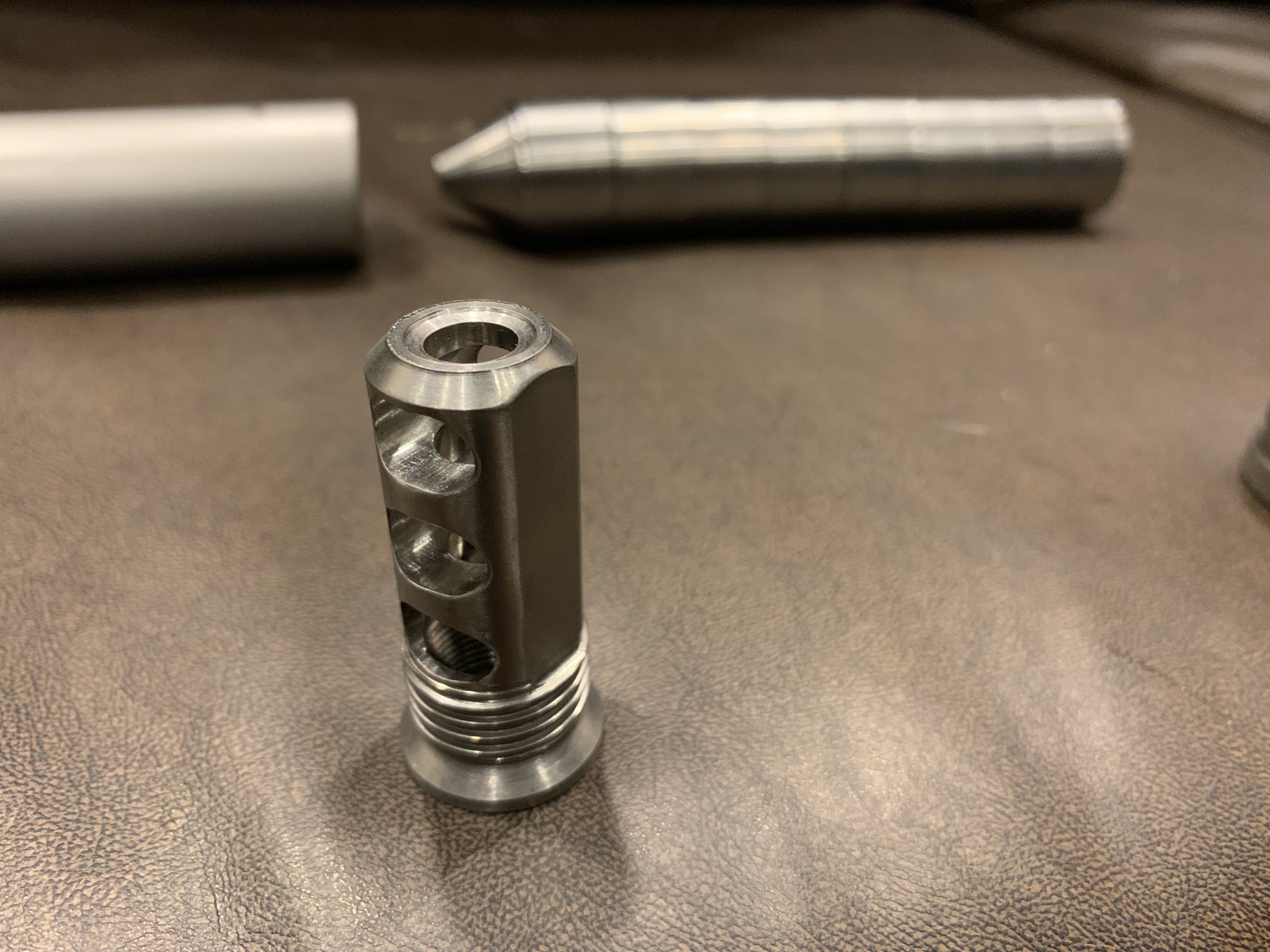

    On the 12” I opted to use their qd setup. That was because I would be using it on smaller caliber stuff and figure a little more baffling from the brake couldn’t hurt. The brake is titanium as well and is super light
    Something to note. Their 5/8-24 rear cap is thinner than .600” at the threads. That means there are some exposed threads inside the trap. They can catch some carbon and cause a little problem but the rear cap is removable from the tube so yo can clean the threads. I talked with the owner about this and she is going to see about changing it to the industry standard of .600”. She said they also currently off the caps as blanks if a guy wanted to do something now or in a thread pitch that they don’t offer. That isn’t on the website so you would have to call.

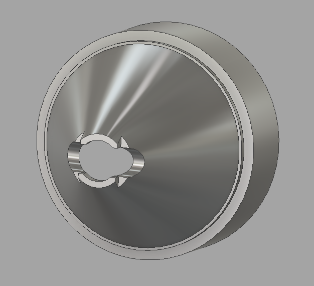

    Clipping is the term for when the cone it notched at the point?
    400rds? hurry up slow poke.:ROFLMAO:
    Reactions: Geno C.
    That’s correct. It helps to disrupt the gasses more than just stripping them through a hole.

    Want to share a pic of your baffles? Did you clip all of them or not?
    They shoot great and when things shoot great I don’t take them apart until they don’t shoot great lol. I think they call it the double symmetrical clip or something like that. There is a guy that sells 3d printed templates and it’s pretty easy if you take your time. They look pretty much like this. Mine are a bit bigger because I made them big enough for 30 cal. I clipped all baffles and on my own reasoning used a fairly large blast chamber. Some of my clips ended up a hair larger than others and I put those first to allow more gas through to expand to subsequent chambers.

    I clipped the baffles on my homemade suppressor last night and went out and tested it today. Holy smokes did it make a huge difference. Completely changes the tone and if I were a betting man I'd say it knocked another 10 decibels off the percussion of the gun versus just drilling holes in the baffles.
    Reactions: Geno C.
    clipping the baffles adds turbulence to the gas flow throughout the length of the suppressor. it keeps the hot gases inside the suppressor longer to cool inside the suppressor which reduces sound level. At least, this is what I've been able to learn from research. I'm definitely not an expert though, and I'm sure there is someone on here that is far more knowledgeable on this subject that I.
    I used a drill press with a jig and a vise and a couple end mills. A 1/4" end mill and a 1/4" round end mill. This is a pretty good video on how to build the jig and do the clipping. Hopefully it's ok to link to Youtube videos here. I'm still kind of a noob here so if it's not ok I'm sorry and let me know and I'll remove it.
    P.S. if you use the end mills to do it, you want that drill press spinning as fast as it will possible spin. the smaller the bit, the faster the press needs to spin.
    P.s.s. I should also add that in all the research I've done, it appears that a guy shouldn't clip the blast baffle and the very last baffle as it can have a adverse effect on accuracy and performance.
