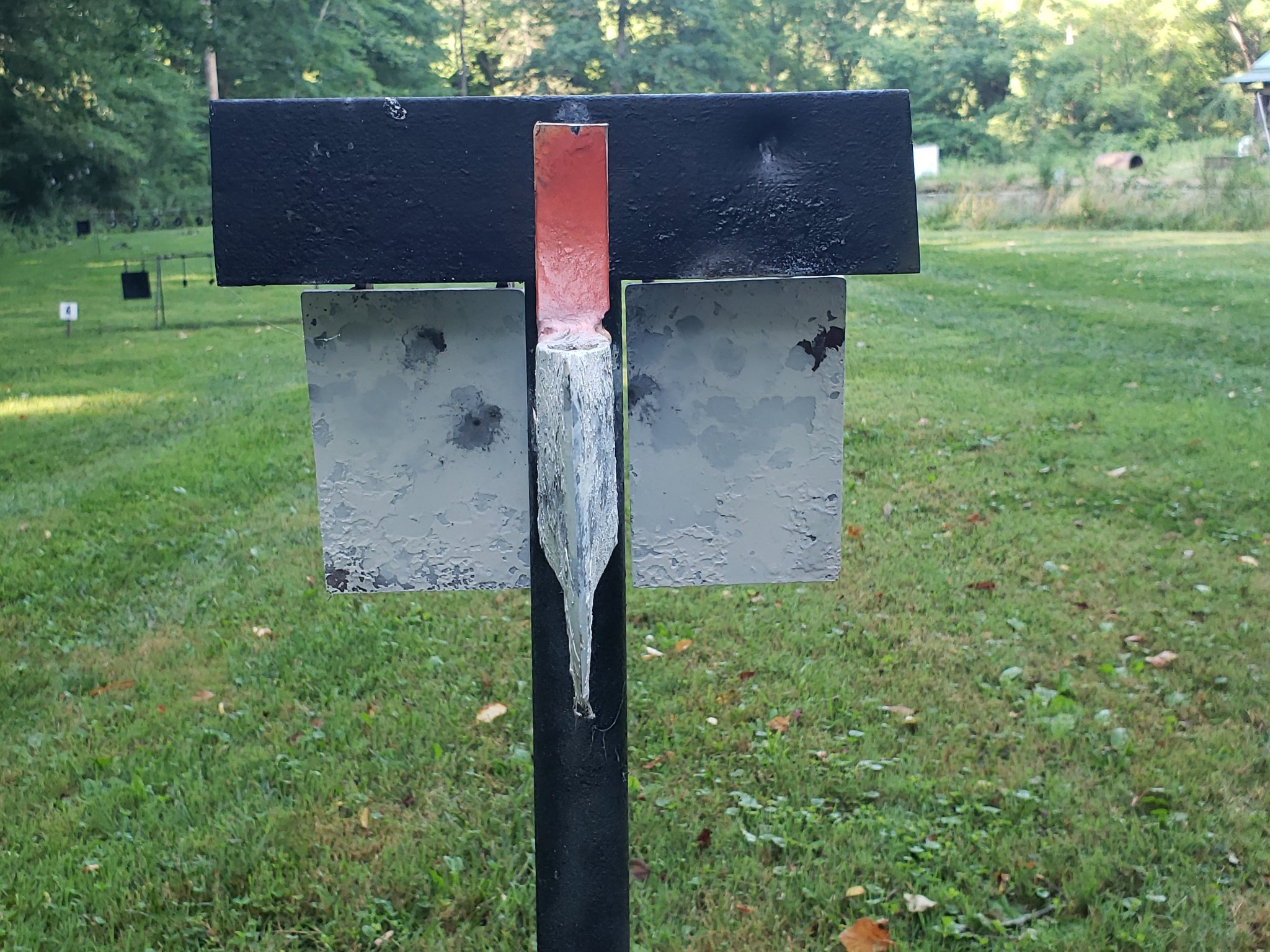

I had never tried any high end ammo in it but had some Lapua SLR range and tweaked it a bit to get a good 50 yard zero. A buddy that had never seen it before but is a very good shooter was offered the chance to try it out. His first shot was barely off center of the .200 hole in the sighter plate at 50 yard, his next shot perfectly centered it and squeezed part thru. He moved over and shot the last 3 little targets on the humbler rack at 50 yards. They were 3/8", 5/16" and 1/4". Good hits and not barely nicking them. It only holds 5 shots so he reloaded and I had him swing over to the "split the bullet" rack at 50 yards. His first shot went just barely left of the edge, next shot barely right and the 3rd shot split it cleanly. Picture below on that one.

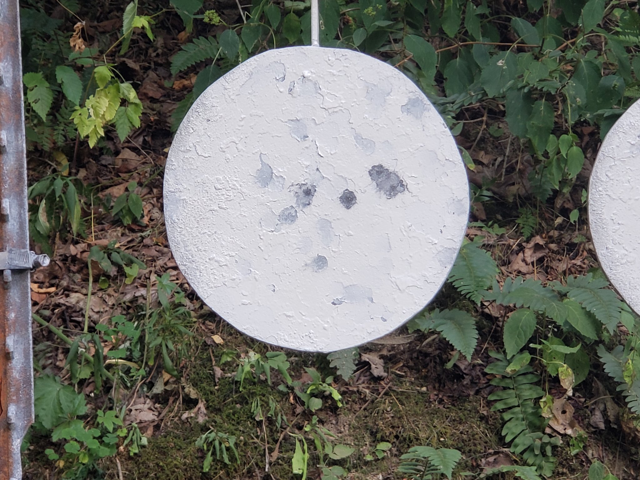

Later on Sunday after most shooters left I loaded 5 in the chamber and dialed 23 minutes and asked Chris to spot the 10" plate at 197 yards. Figured I'd be on the plate but not sure where. Still a little bit of breeze but barely moving the flag tape. Pretty good hit, second shot a tiny bit right of that one but still perfect elevation. The next 3 piled into the group on the right but still nearly perfect elevation. I doubt the total verticle spread is 1 1/2" but closer to probably 1". Could not believe it but it really likes the Lapua SLR.

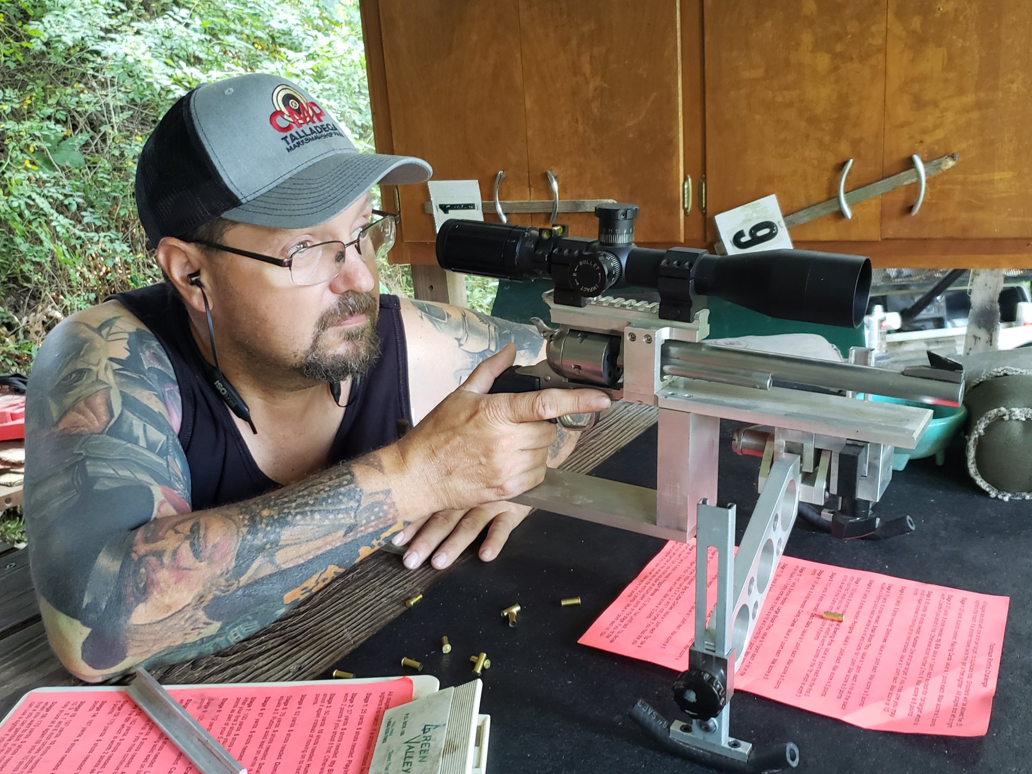

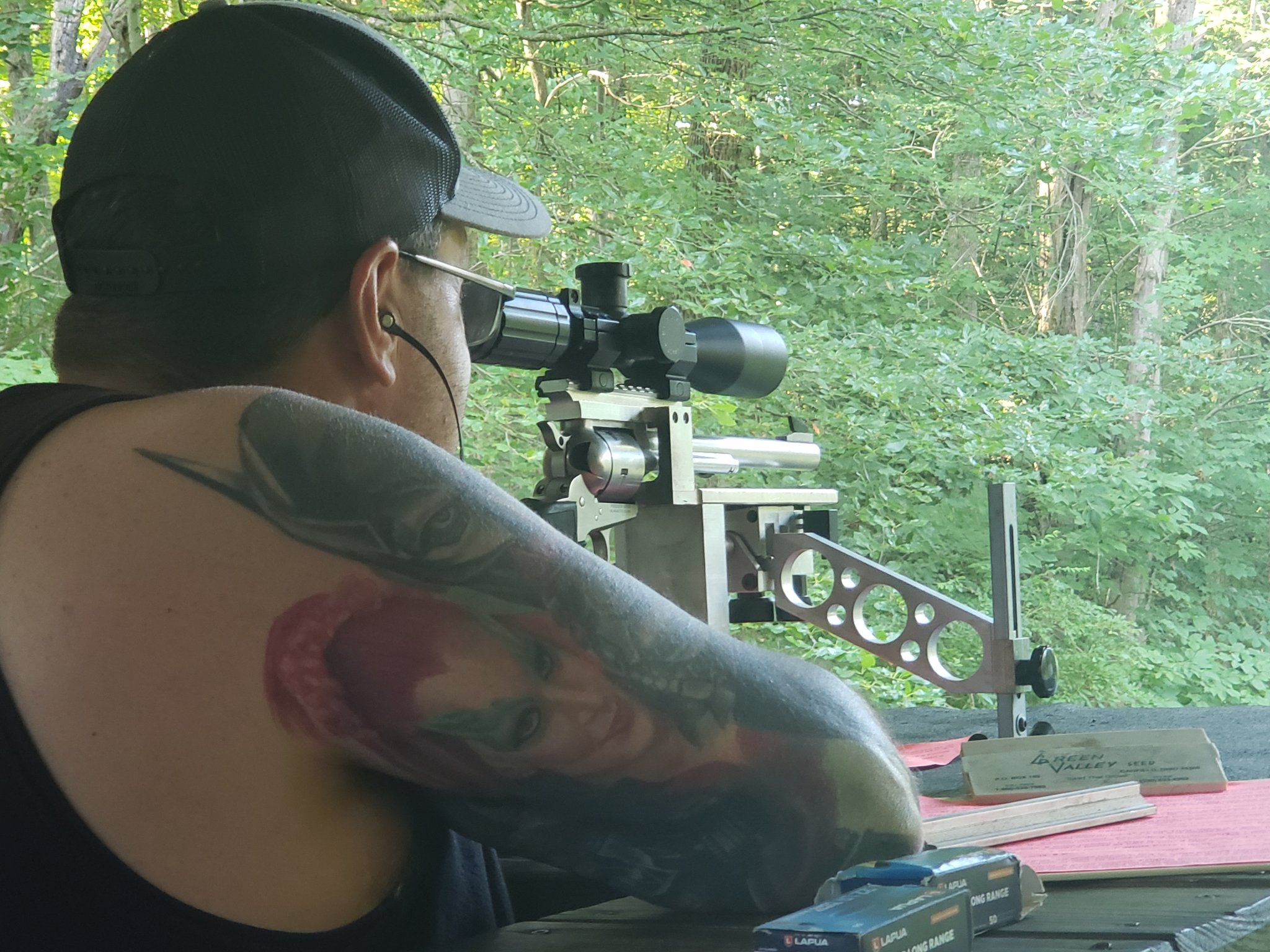

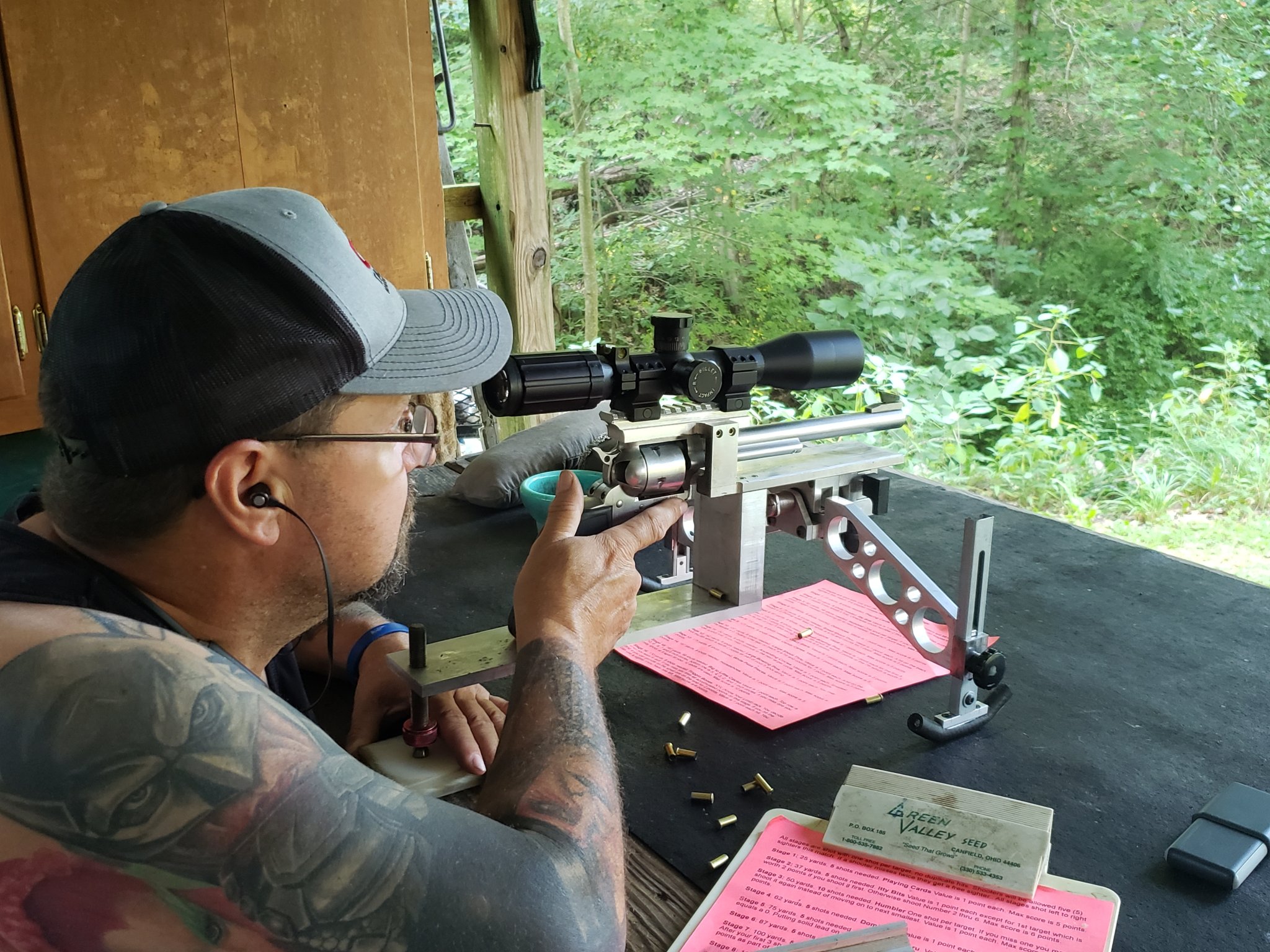

It has the match chamber and has to have each round seated with a rod, you just can't push hard enough to get them seated to turn the cylinder using your fingers. OH, guess I didn't mention this was a 10" Freedom Arms model 83 silhouette 22lr revolver in a cobbed together contraption that lets me use a bipod on the front and a monopod on the rear. I know, stand on your hind legs and shoot it like a man,this was built for seeing what its capabilities are.

OK, some pictures of my contraption, first 3 are Bill Moran shooting the little humbler and splitting the bullet on the axe than my 5 shots at 197 yards.

It's very sensitive like any handgun as to shooter input, that is why I built the contraption. It's scary accurate, not sure if it'll run with my custom Exemplar but looking forward to some new testing with Lapua.
