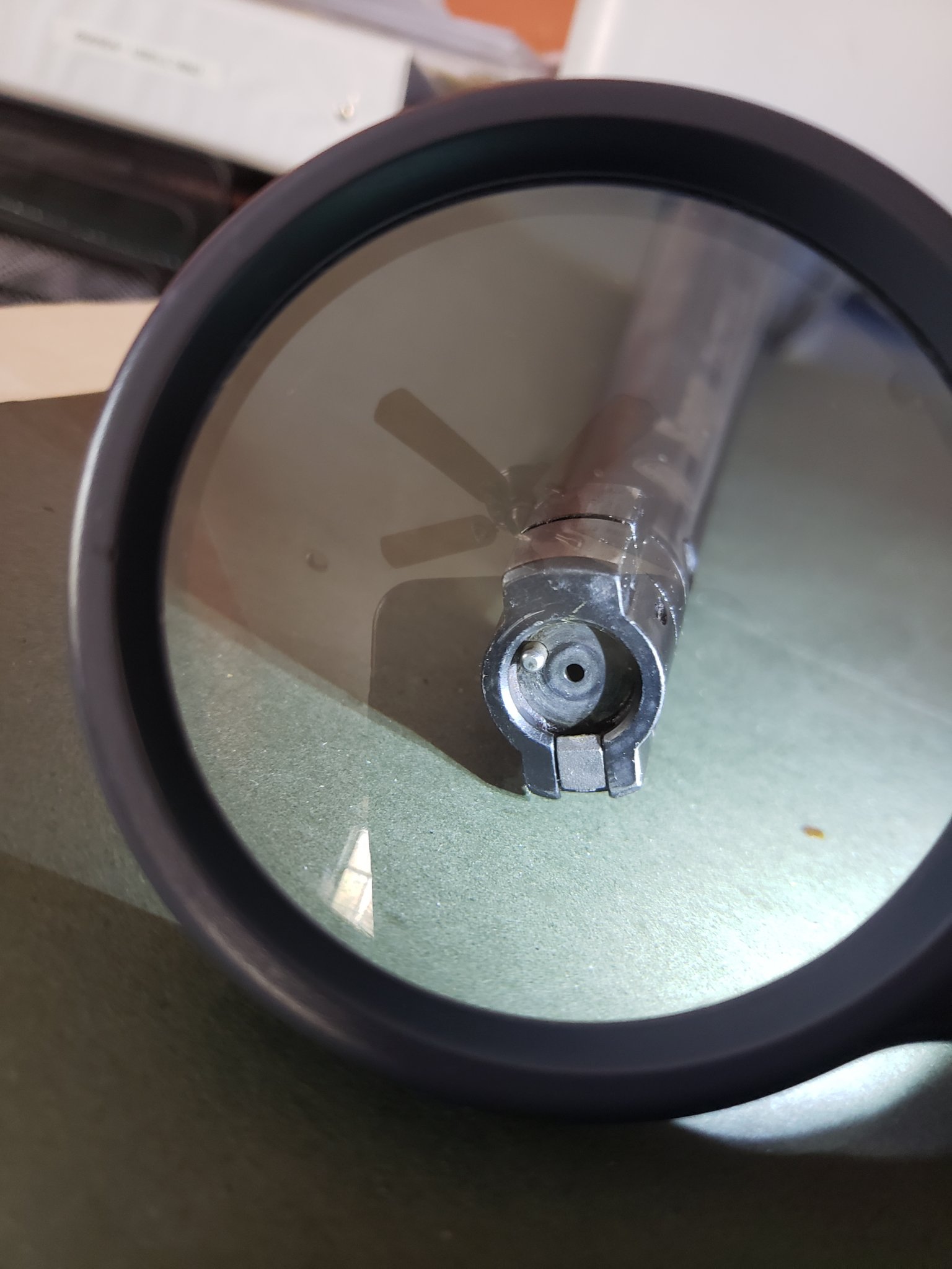

Loong time ago I purchased a Savage 110FP (long action) in 308. With the crummy factory trigger and not-so-good stock it still was sub MOA shooter. I have about 1500 rounds down range and until recently, never an issue. I had the trigger worked on and it is a nice crisp break and I bedded a McMillian stock and she's a forever keeper. I never shot it a ton as I have other rifles that take my range time. I started my 13-year-old son at the bench with this rifle and this is where the issues appeared.
The issue is a complete failure to extract. I've tried GMM as well as my own loads and same deal. Whether a complete round or fired round, brass remains in the chamber. It came on quick and was not a gradual fail to extract.
Pics are hard to demonstrate but I have one posted below of the bolt face.
I ran brake cleaner and swabbed out the face as much as I could. Suggestions on where to go from here? I have medium capabilities and some tools. Extractor replacement along with spring? Anyone have a link to a good video if that is the route? Can't think of anything else. Chamber looks a ok and it still shoots excellent, just wont extract.
If it matters, the extractor does not appear to be brass but I could be wrong.
Thanks in advance for the help.

Does the extractor slide f you press on it? Have you tried taking it apart and checking the individual pieces? Id like to see what the backside of the extractor lip looks like, could be rounded off and no longer grabbing sufficiently.

It slides in toward the center, push down a bit and inward.
I manually pushed it down and inward and it moved forward. No play side to side. I sprayed it with brake cleaner and worked it a bit and it will now extract. Granted this is not a fired round but it's grabbing. Is it possible it was dirty and unable to move forward to grab the cartridge rim?
I'll test it at the range next week and see how it does.
