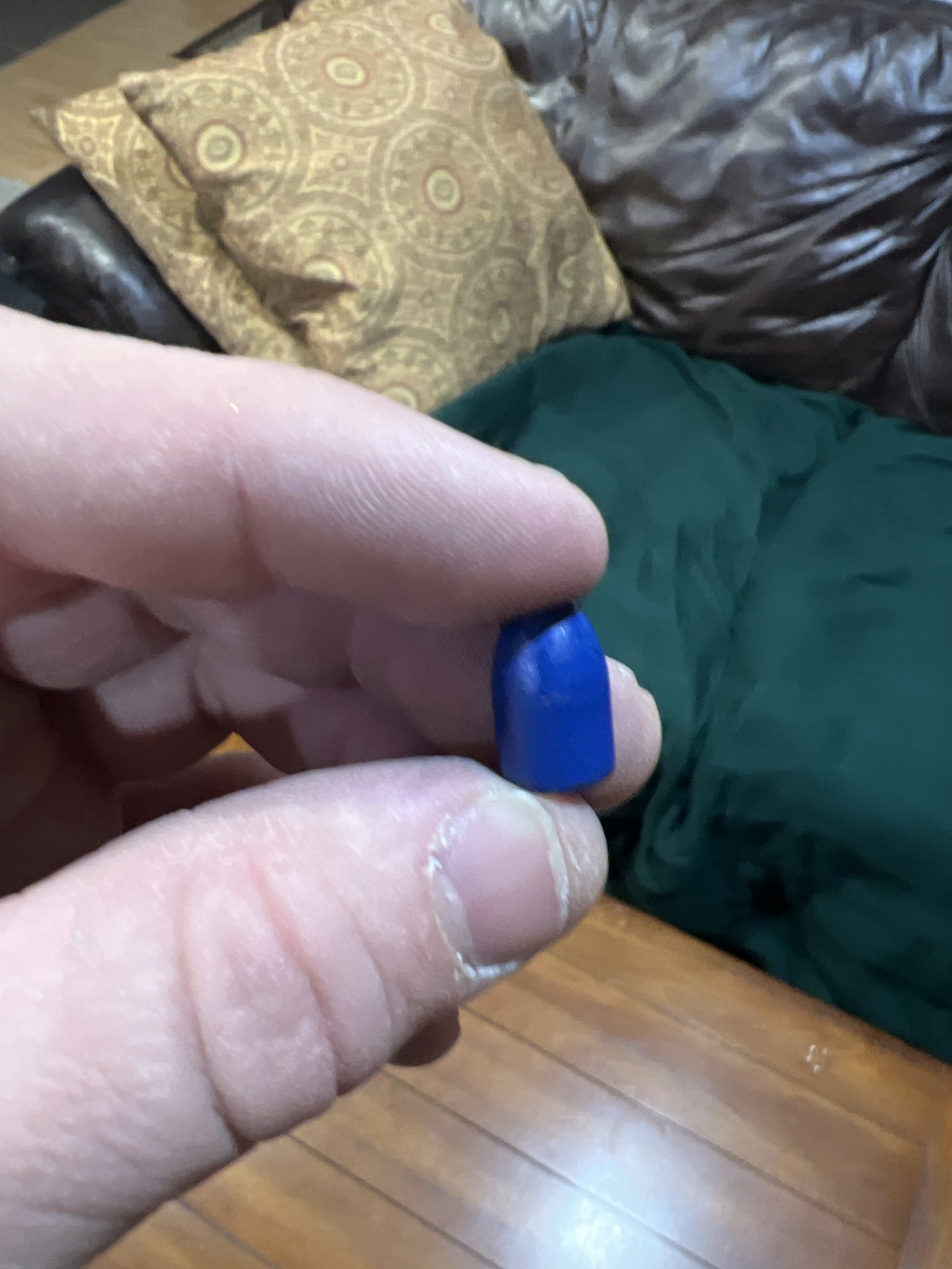

So I have been attempting to set up my reloading press for reloading 40 S&W.
My setup as is:
RCBS Pro 2000
Station 1: Size and De-prime die
Station 2: Powder measure with expander flare/bell. I have this set to flare/bell to .030" above bullet diameter. So .43 after this station.
Station 3: Lock out die (Not set up yet)
Station 4: Bullet feeder (Not set up yet)
Station 5: Crimp/ Seat die

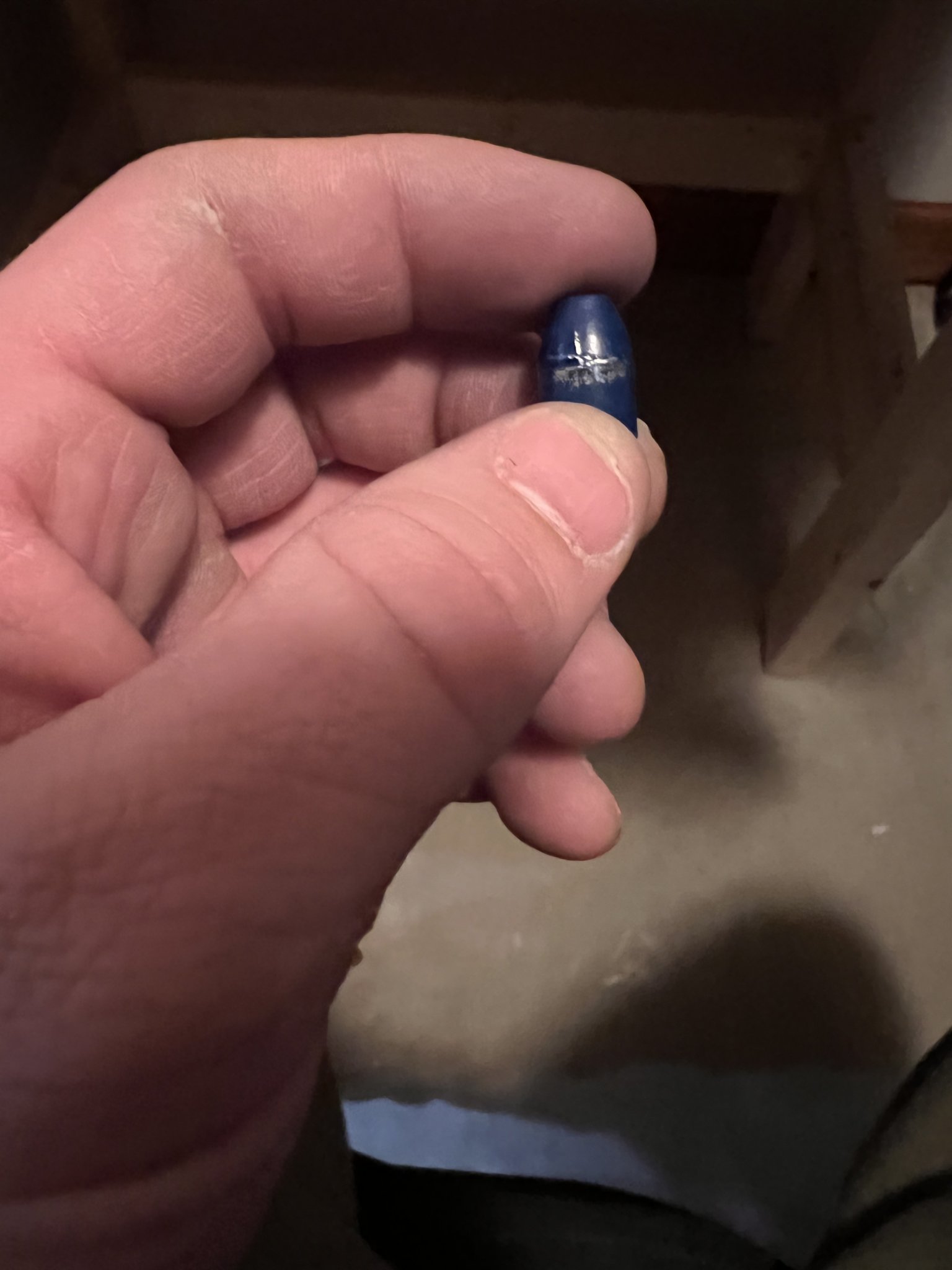

The problem I am having comes with my last station (Station 5). The instructions for the die say to put a sized case in shell holder, raise the ram, then screw the die down until you feel a slight resistance, then turn away from case mouth a full turn. Ok. I do this. Then it says to lower the seating plug until you get desired COAL. However, the seating plug is already as low as I can go, and I am no where near the COAL that I want. What am I doing wrong?
I have been trying new things to get it to work, but no luck. I have even tried not flare/bell the case using the same method, but no luck, as explained here:

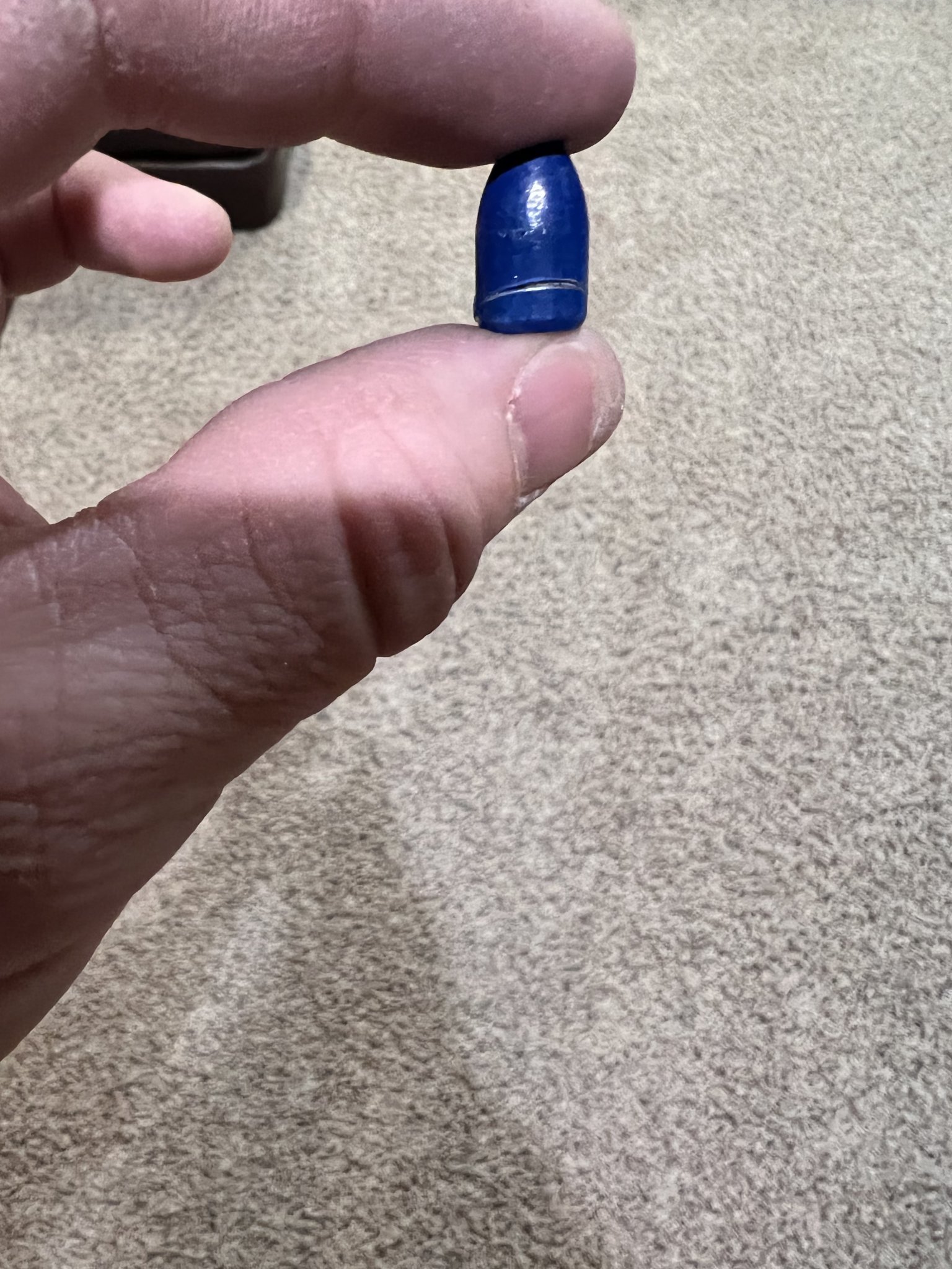

The next steps say that when you receive the desired COAL unscrew the seat plug to avoid bullet contact when adjusting seater die body. Screw the seater die body down until you feel firm resistance. However, when I get to this step, there is already firm resistance.
I am using 180 grain blue bullets, and on the website it says the perfect amount of crimp and expansion none of the coating will come off. Well, the coating is coming off.
Anything?
Thank you very much.
Goat
I think "slight resistance" is the problem here.
Obviously the seater plug needs to be lower.....now how do you want to go about that ?
If you have any ideas, please share. I screw the die down to until I feel resistance then screw one full turn in reverse as per the instructions. When doing it this way, the seater plug can be in all the way and I won't get the COAL I am trying to achieve.
With the seater die body backed off, first seat the bullet to your desired coal, then back off the seater stem and screw the die down until you feel slight resistance. Then you screw the seater stem to touch the bullet. It is far better to do this in 2 steps, with a dedicated seater die and a separate crimp die. RCBS dies have two seater stems. Use the correct one for your bullet.

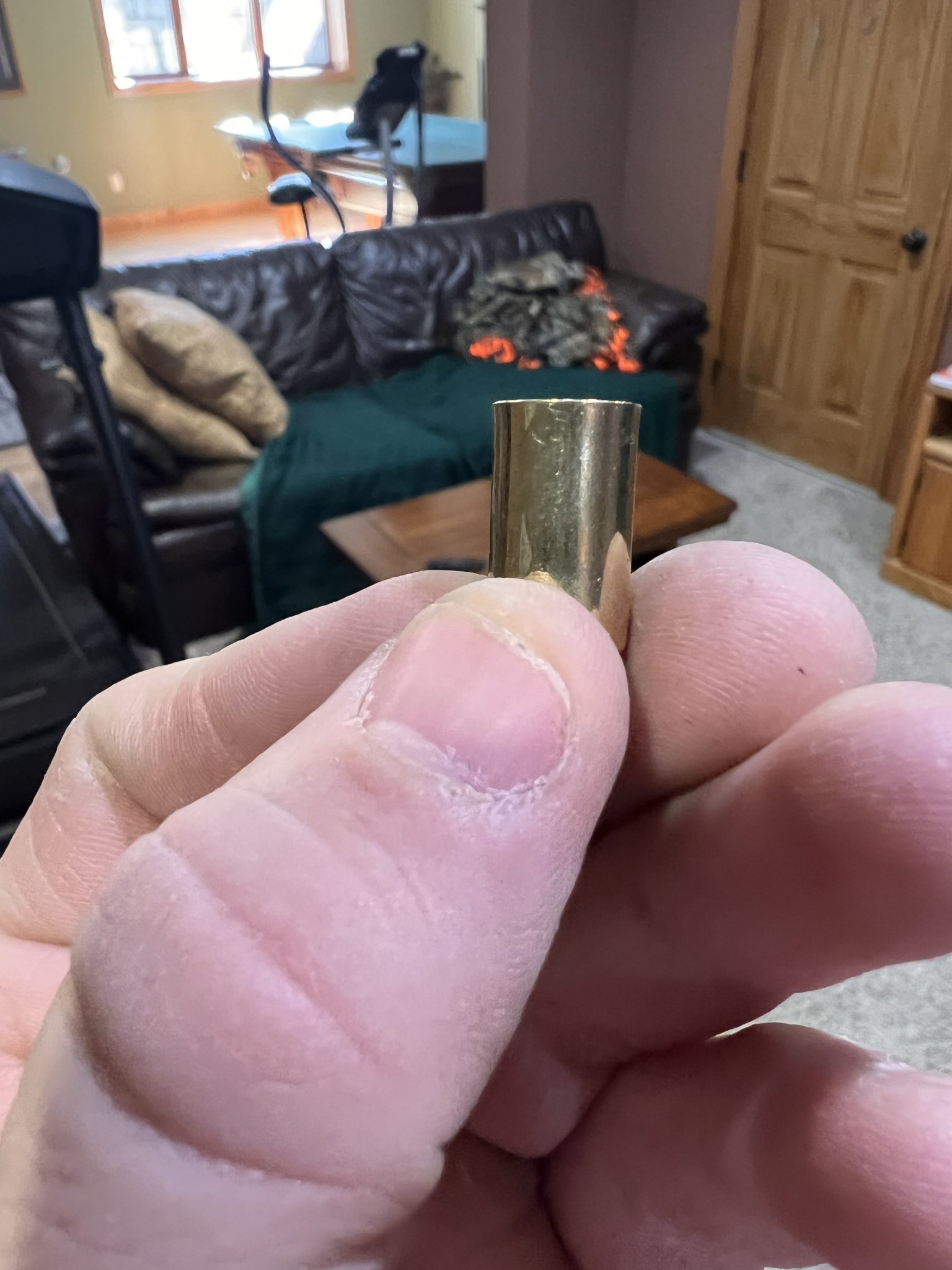

With the expander die, adjust the expander to flare the case mouth enough so it doesn’t scrape the bullet.
Reactions: greentick
As for crimp
I only run enough to undue the flare.
Run an empty case up the seater Flare die to see what it’s really doing.
If you have a lot of flare you’ll feel resistance quite early.
I generally seat and crimp in separate operations whenever possible.
I am flaring out to .030" above bullet diameter. So after this step, case mouth should be at .43.
There are 2 possibilities that I see. Either the die is not screwed down far enough or the seater stem is too short. So....
Maybe the resistance you are feeling before you back the the die off one turn is not the actual resistance of the case mouth, but some other friction in the system. With the ram up, I would turn the die in until you get firm resistance against the case mouth and then back off one turn.
If the seater stem is too short, then you just need a longer one. Maybe they put the wrong one in your die set.
Good luck.

So I’ve got to a crimp that can fit into my barrel, but not the case gauge.
I'd back off the flare some, it may chamber, but you now need an excessive crimp to fit in a gauge. Too much crimp raises pressures.

So, I’ll get clean ones with no scrapes at all. Then I’ll do more just to verify, and I get scrapes like these. Also, I’ve got it so the cartridge will fit and fall out of my barrel freely, but not fit the case gauge. I’m loading them out to 1.128 currently. I figure I would start there.
Any of you know why the scrapes are like that and not doing it every time?

Then there isn't a way to eliminate the issue that you are having without going to jacketed bullets.
You have to seat first and then crimp on the next stage.
Thank you for the replay. So using coated bullets, I’m not going to eliminate the scraping, unless I seat and crimp in two different stations? Should I eliminate the lockout die so I can have a bullet feeder?
Should I just go buy a Dillon? Lol
It's called the plonk test for a reason. The loaded round should drop into the barrel (out of the gun) with a plonk and fall out when you turn the barrel muzzle up. Excessive flare will fail this test. A bullet loaded too long will as well. Check your overall length.
Don't worry about it not fitting the case gauge unless you're planning on firing the round out of the case gauge, not the barrel.
I second the separate seating and flare removal steps. I do not call it crimping since coated bullets should not be crimped.
For years now I'm using coated bullets and seat/crimp on the same die, using an old School RCBS piggyback (grandpa of the Pro2000). Flare just enough to start the projectile base in the mouth. Crimp just enough to pass the plonk test. Sometimes if the projectiles don't sit perfectly straight as the go up into the seating die they may shave a little coating material.
Thank you all for the responses. You guys were great help. I have it at a point where the cartridge fits in my barrel but not the case gauge. I have also got rid of the scraping of the coating as well. Thank you. Literally, it took a while but I think I got it. I may go buy a Dillon 750. My good friend has one and does not use a powder check anymore because of how accurate it is. He instead uses a mirror that he has hooked up to look inside the case as he is reloading.
Goat
You don’t get any scrapes at all? Not even where the crimp is at on the bullet?
ALWAYS seat and crimp in 2 seperate operations. I bought a seperate taper crimp die for every caliber I load on the Dillon 550b.
You can accomplish the seat/crimp seperately by seating the bullets with the crimp die backed off. then run all the loaded rounds through the crimp die with the seater plug backed off several rounds or completely removed.
Like somebody else said, I've never seen case mouth measurements used during the belling of the case mouth. Just make it look similar to a blunderbuss barrel. Test bullet fit manually until it's just right.
The expander will enter the case for a good distance until it reaches the point where it actually bells the case mouth. Once it reaches that point the adjustment will be very sensitive. You have to bell the case enough for a bullet to start without belling the case TOO much. This requires much trial and error. Expect to ruin a few cases until you get it just right.
WhatsupDoc told you the best way to adjust the crimp/seat die. You CANNOT rely on a case that has already been expanded/belled for the adjustment of the crimp die. The belled case will scrape the sides of the die as it enters the die and will give you the false indication of "resistance".
