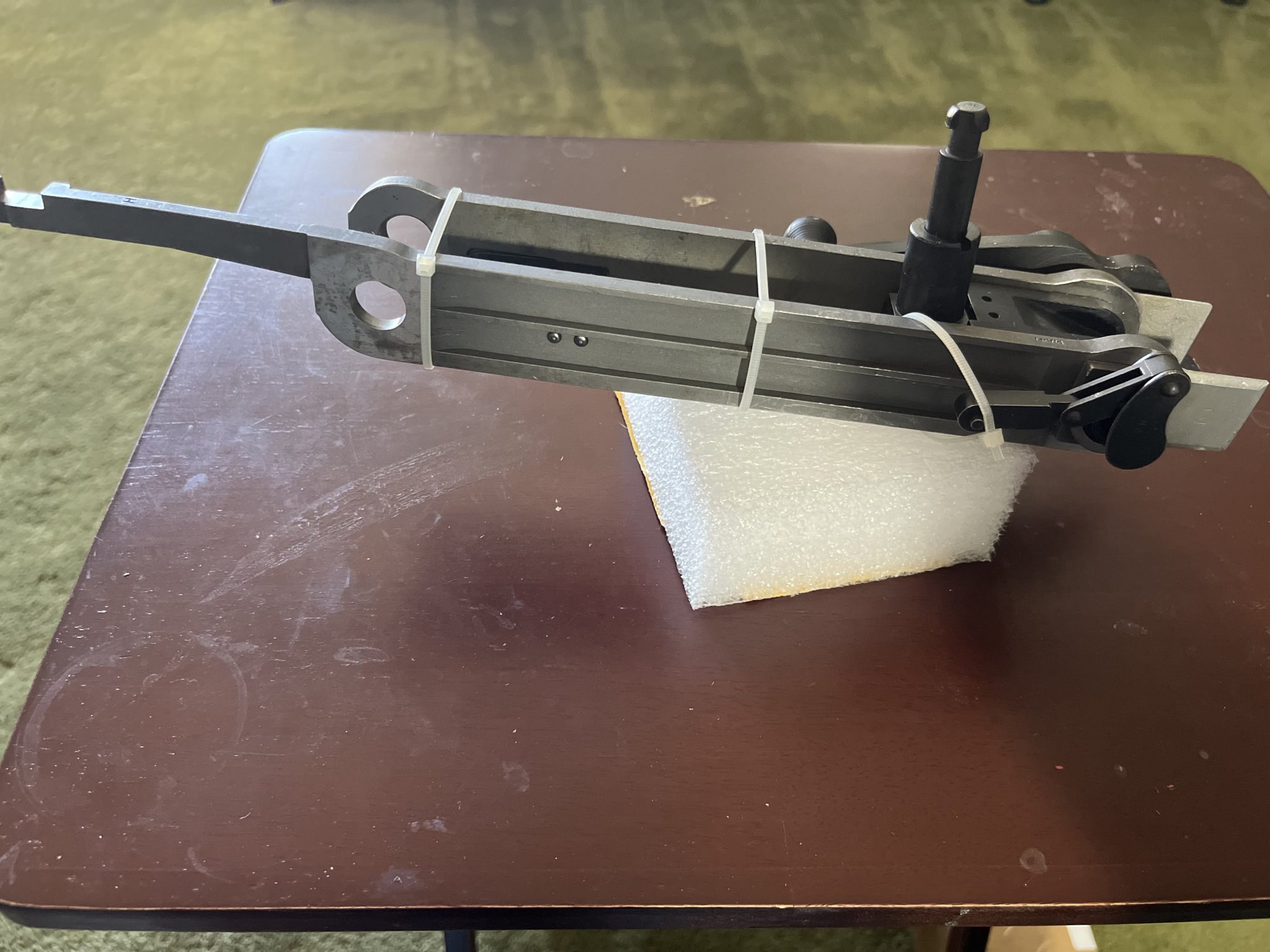

Just picked this up… the lock is there, no trigger pack. How can this be built into a semi auto legally?

I have one that is semi. Bought as a complete parts kit. That looks like an IMA display unit? They really pull the guts out of them... so you may be missing more than you think.

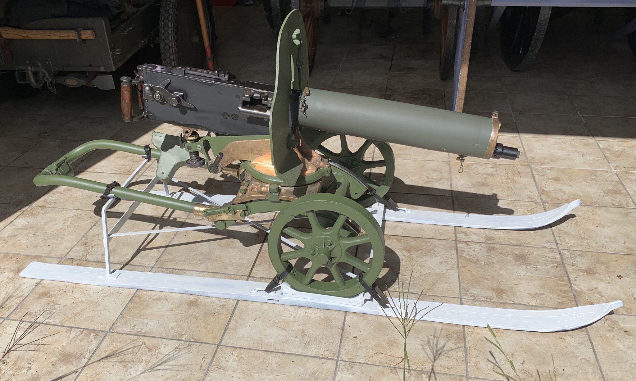

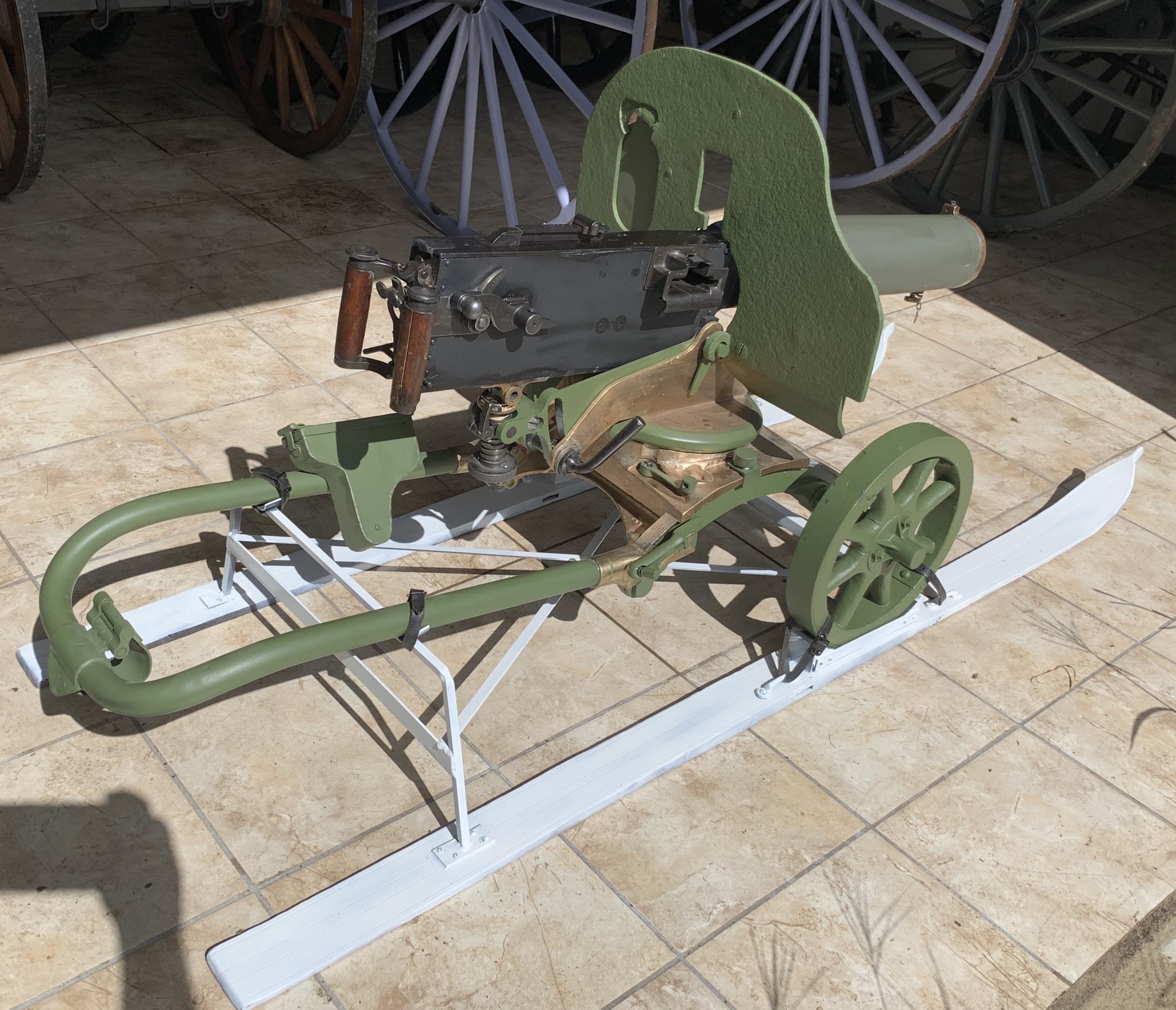

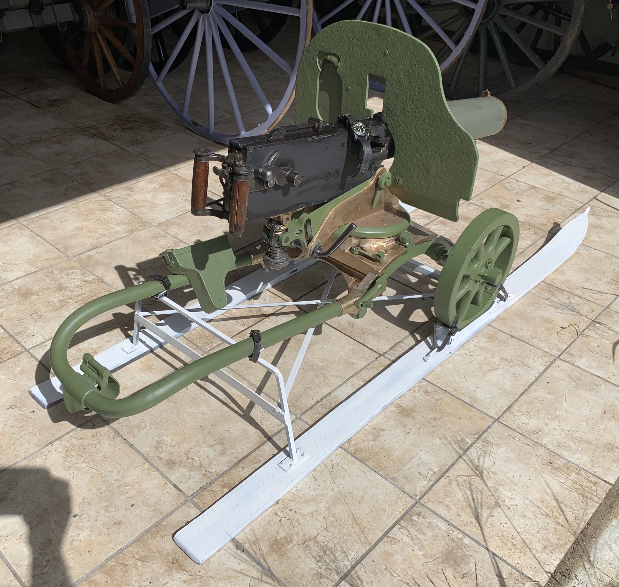

They are a hoot. Mine is Imperial (pre 1917) and has some battle scars for sure. Somewhere in Vintage are pictures of it and the Ski mount I built for it.
