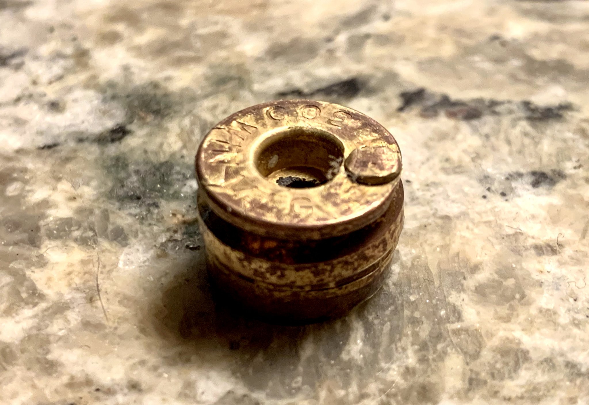

    Found this laying in the dirt next to my firing position today at the range. Check out that brass flow into the ejector port... Good God! Pressure and headspace much?
    Obviously it’s slightly weathered, so it must have been over the summer perhaps. That couldn’t have turned out well. Even the extractor groove is visible to the left across "WIN" (ironically). The primer pocket also got "crimped".
    The rim and belt have a weird wave to them also.
    Yikes good grief depending must’ve crunched powder on that one? holy shit! ?

    Went to the range with a friend who just bought a new 300 Win Mag. He brought several different boxes of ammo to see which would shoot best. I was shooting in the lane next to him and heard a crazy loud shot from his lane.
    We could barely get the action open and the case wouldn't eject. We finally got it out with a cleaning rod. The head was partially separated and the body was swollen. The ejector mark was similar to the picture in the OP. IIRC it was a Hornady 180 grain for hunting.
    About thirty years ago I was shooting an IHMSA match next to a guy using an XP100 chambered in 7BR. After the first shot, I saw him sit up and start swearing while trying to open the bolt. He finally used a hammer to lift the bolt, but couldn't extract the case. Our local gunsmith was able to remove the bolt with the case head "welded" to the bolt-face. He machined the brass way and checked headspace which was within spec. He returned it to the owner and recommended he never fire it again.
    The shooter never mentioned what happened and continued to shoot the XP.
    I always made it a point to be a couple positions away from him, but he never had an issue with the gun.

    I had a guy show me a 300 Win Mag case that he fired from a 300 Weatherby. There was very little neck left. He said that he has always shot them. He then showed me a half used box that all looked the same way.
    There was no convincing him that he was risking serious injury.

    Not that big of a deal. Not advisable, but not much concern either. I've loaded 7rm brass in 30cal and fired it from a win mag.
    I believe the reloading session went something like this....”dude, you should try using pistol powder”

    I once shot with a guy that at the 600 yd line that had a severe head separation that sent his mag flying and gave him a bloody nose. After he got cleaned up we moved to the 1000 yd range and on his first shot he drilled the x ring! I’ll bet that wasn’t the story of the op story
    I have seen a pistol primer in a rifle case do exactly that. Shooting buddy some how got pistol primers mixed into rifle primer storage container. He never checked the box he pulled out and loaded 50 rounds. First 2 went boom the 3rd went BOOOOOOOM and scared both of us. After reviewing his loading process we discovered the empty primer tray in trash. He was lucky to have only a bloody nose and powder burned hand.

    I would have thought a pistol primer would have produced a lighter load or less reliable ignition. Weird.

    Post incident reading leads me to believe the pistol primer did not provide complete ignition of the charge and there was a second burn after the bullet started moving causing the pressure spike. Rifle primers burn hotter and have thicker cup to handle higher pressure and charge size. It is something I think about everytime I start working at the bench.

    Outside of using too fast of a powder/charge or a barrel obstruction - what chambers would a 300WM round chamber in (we can’t assume the shooter was using a 300WM chamber) but still be supported enough to fire? Don‘t think a 7mm Rem Mag would.
    I haven’t put much research into this question, obviously.
    It would also fire in ultra mags. I could see a smaller than 30 bore causing it.
    But if I hade to take a guess, I'd guess something around 4895 or faster.
