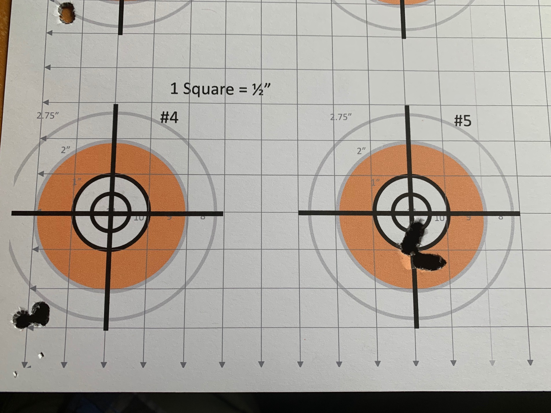

    Gun is an AR in 6 ARC 22" 7 twist.
    Bullets are PVA 100gr Seneca's suppose to have 7T min to stabilize, but I suspect it also needs 2850+ in addition to the twist rate.
    Range is 100y.
    First picture is 5 rounds, 1st is in the center of the target and was single loaded. The next 4 to the right are mag fed. Load length 2.370, speed 2733.
    They're obviously unstable. How can something so unstable group so tight??? Makes no sense.
    I figured this was some freak occurrence & yet it did it again.

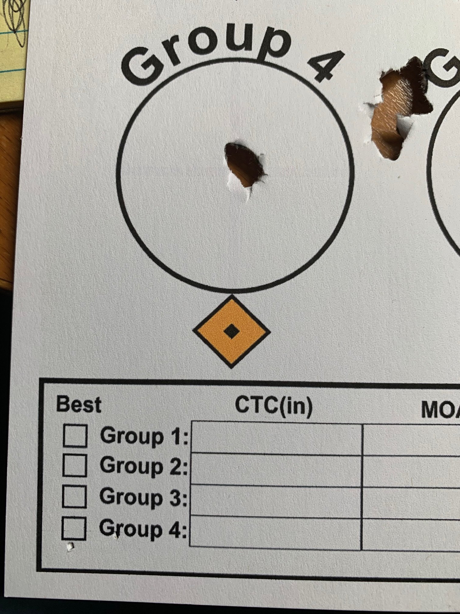

    Next range trip I loaded a little longer and hotter. 2.410 x 3 in Hornady brass over magneto @ 2770. With the magneto on 1 hole was round and 2 were triangular, group was Yuge.
    Then I tried a repeat of the previous which was from Lapua Brass that has +.002 neck diameter. This at the same new load as the previous 3, this time no Magneto. Target below right is 3 rounds. I don't know if 1 was stable and passed through the other hole or if 2 triangles somehow lined up, but its definitely 3 shots.
    Left hand groups are Berger 109's @ 2730
    I've only shot 18 of these total & the 2 groups pictured (5 rd & 3rd both from the tight neck Lapua brass) are the only groups shot without the magneto.
    I just don't understand how something this unstable can possibly group this tight.
    I've had unstable loads with 85.5 Berger's in 224 Valk & they did exactly what I'd expect, shotgun groups in the 4"- 6" range.
    Ideas anyone? Theories/Conspiracy theories, I don't care.
    Talk to me Goose!
    Seriously I'd like to know how the hell tumbling bullets can hold under moa groups.

    My guess would be that since you are at the minimum twist rate and a bit slow on velocity, your projos are unstable but not tumbling.
    This is making them yaw and impact at angles but they aren't outright flipping all over the place
    and deflecting randomly which would result in the massive groups you expect.
