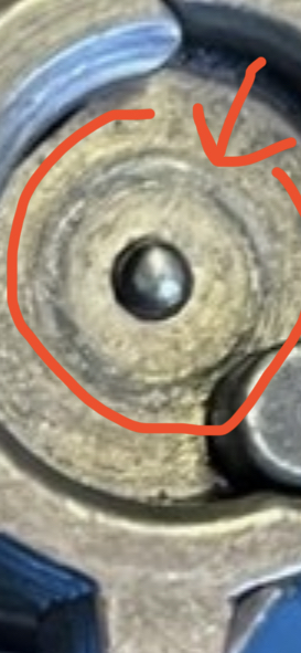

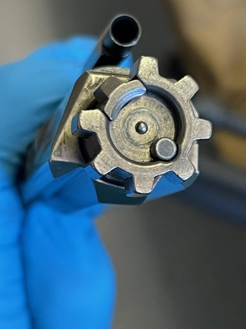

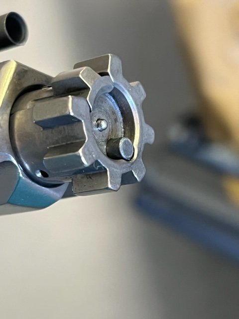

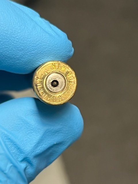

I need some help with an issue on a .308 build. I have a rifle that generally performs well. Recently I began noticing 2 things. 1..... the ejected brass is very dirty, and 2.....after some firing the BCG locks up and no matter how hard I pull on the charging handle I cannot get it to budge. I thought maybe the rifle it is over-gassed and hence so dirty and fouled that the cam pin is too fouled to move and the bolt face then cannot turn to unlock from the barrel.

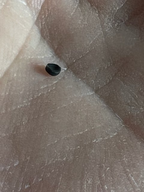

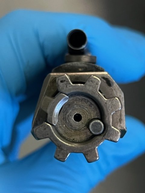

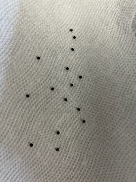

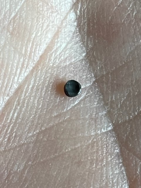

When I took it apart to clean it, 15 of these little fellows fella's out of the bolt.....I am unsure what these are. I am firing Hornady Black 80971 rounds....not my own shitty reloads or anything like that.... 308 Win 168 gr A-MAX® Hornady BLACK® - Hornady Manufacturing, Inc
So my brilliant idea is putting an adjustable gas block on.....which I have done. But in cleaning the weapon before re-assembling it, I saw these things fall out of the bolt. I am sure their presence is what is causing the rifle to lock up.....
Any idea what these are and any idea what may be causing this?
Any help is appreciated.
Reactions: CoriolisEffect
Yep, 100% the primer cup. Look at the primers in the cases you've already fired. They'll have the center punched out. I had this problem with the supposedly high pressure Toolcraft bolt in my 6.5 AR10. I switched to the high pressure JP bolt, and the problem went away
It would help if you would list some details on the barrel mfg., length, gas system length and gas port diameter if you can. Also the BCG mfg, and model.
With that many pierced primers, your bolt and firing pin might be toast, but I would still clean it up and check headspace with a field gauge. I would also measure the firing pin protrusion, pin tip diameter and the diameter of the bolt's pin orifice. I would imagine there is gas cutting damage, so the measurements might just be a post mortem.
Was it the double ejector Toolcraft bolt? Those are the high pressure small firing pin bolts. I use them with no issues.
OP
You are piercing primers. If you have 15 pieces that came out of BCG, high probability you’ll have etched / damaged tip of firing pin, will need to be replaced to prevent continued piercing of primers.
I did not, the rifle performed fine until it didn't. And I fired at least at least 15.
Well, I guess I am just used to looking at my brass all the time. If you didn't and the gun ran fine then I can see that.
Definitely check out your bolt and firing pin situation. They may be fine but they may have some damage. Need to figure out why that happens of course. There are several here that are legit experts at AR's and can definitely get to the bottom of it with you.

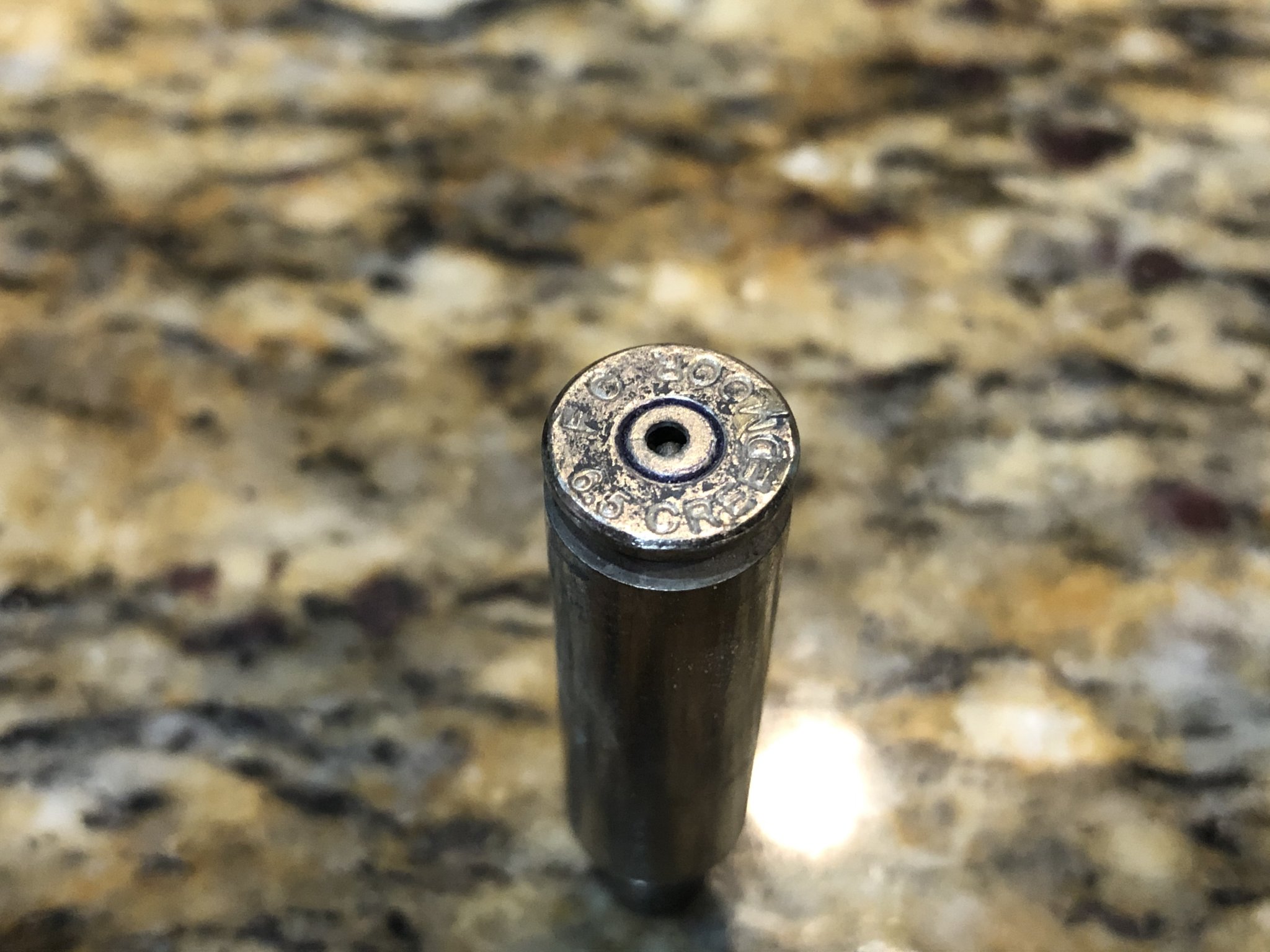

I'm interested to see what it looks like. I think I've only ever popped a primer once myself, and that was with an overcharged or messed up factory round that they recalled. That was also a lot more than just a popped primer, came close to blowing my rifle up.
It's a good practice to check the brass for pressure signs the first couple of rounds, but I had always assume factory ammo to be "no risk" but that really just isn't thr case. Good learning experience without any serious outcomes. Hopefully your bolt and fp is OK, be interested to see that and the brass when you get a chance.

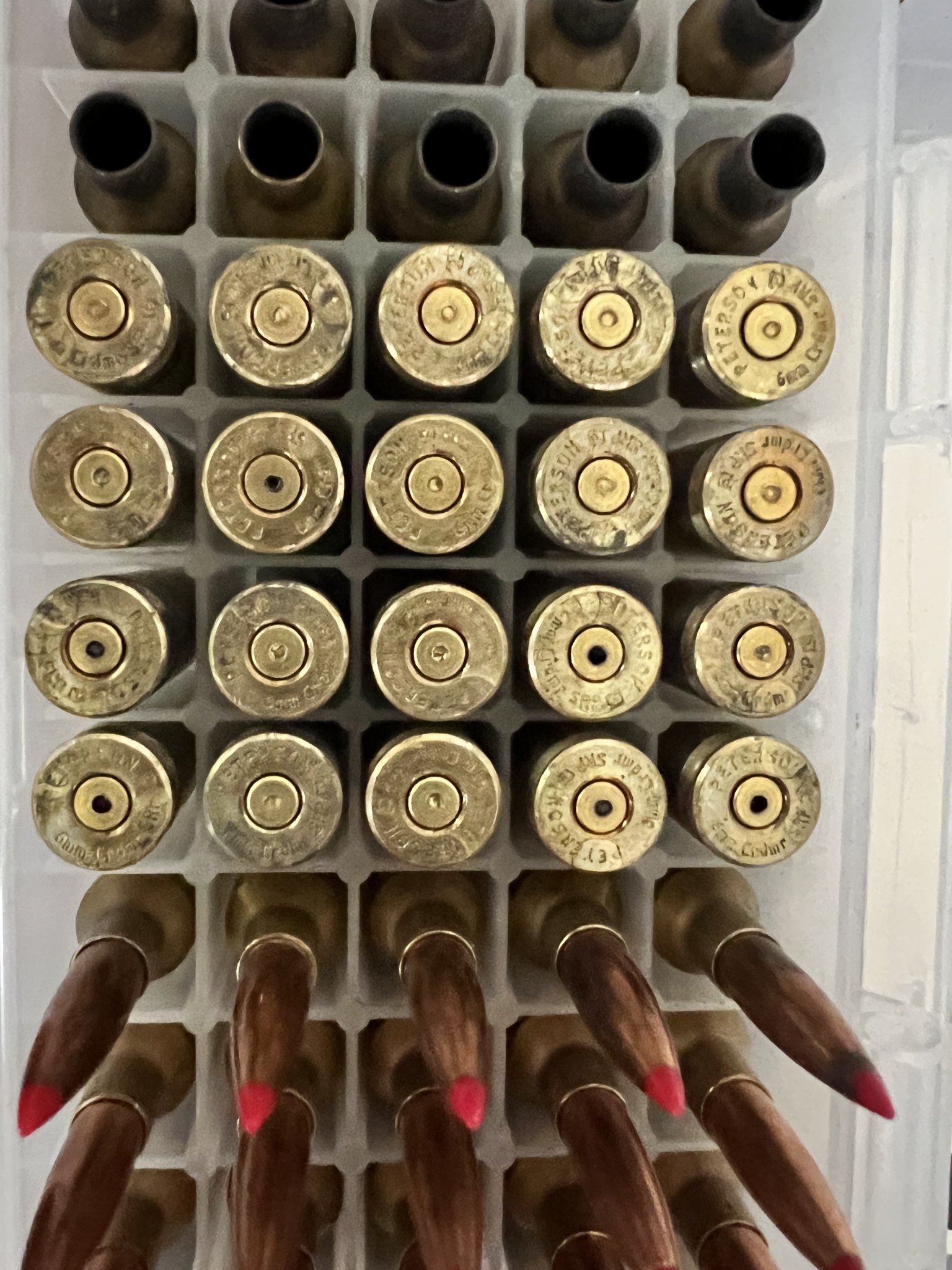

A friend gave me a whole bunch of once fired brass from his 6.5cm large frame. There were some nickel plated federal that didn’t play well with his rifle. He never knew he was piercing primers. The hole doesn’t go all the way through the primer.
This is not popping primers, popping primers is when the primer has been removed from the case.
This is the firing pin piercing the primer and the pressure pushing the punched out primer cup "disk" back into
It may take a magnifying glass or camera with macro capability to see the pin/bolt face damage.
That many cookie cutter pieces in the bolt and the tip just has to be all cut up.
Once the tip is damaged it will pierce every primer (until it burns away).
Yes, we would like to see a pic.
I posted a pix. I reviewed the firing pin under a lighted magnifying glass and it shows no signs nor can my fingers discern any anomalies.

I put an adjustable block on and fired at least 20 rounds yesterday......reviewing each spent case. I saw no popped primers. Going back today.

Strangely today as I would test fire and adjust the gas to allow for proper action, it would fire Hornady 80971 ok as I was ramping up the gas......once I got the gas tuned to work the action properly....it would eject spent rounds.....strip and feed the next round....lock the bolt open on the empty magazine.....this worked for other ammo without popping the primer but would consistently pop the primer on all the Hornady rounds....
Same behavior mine had.
