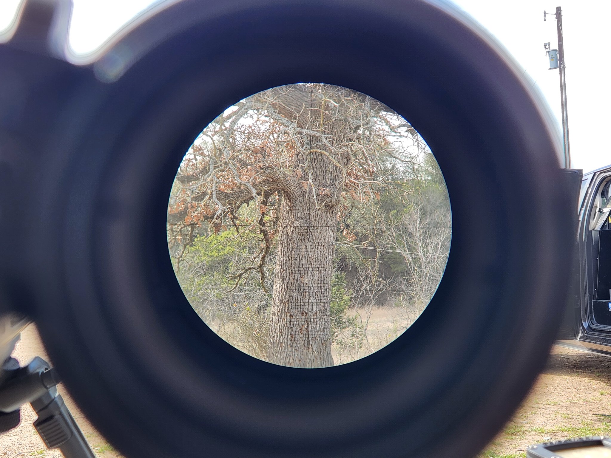

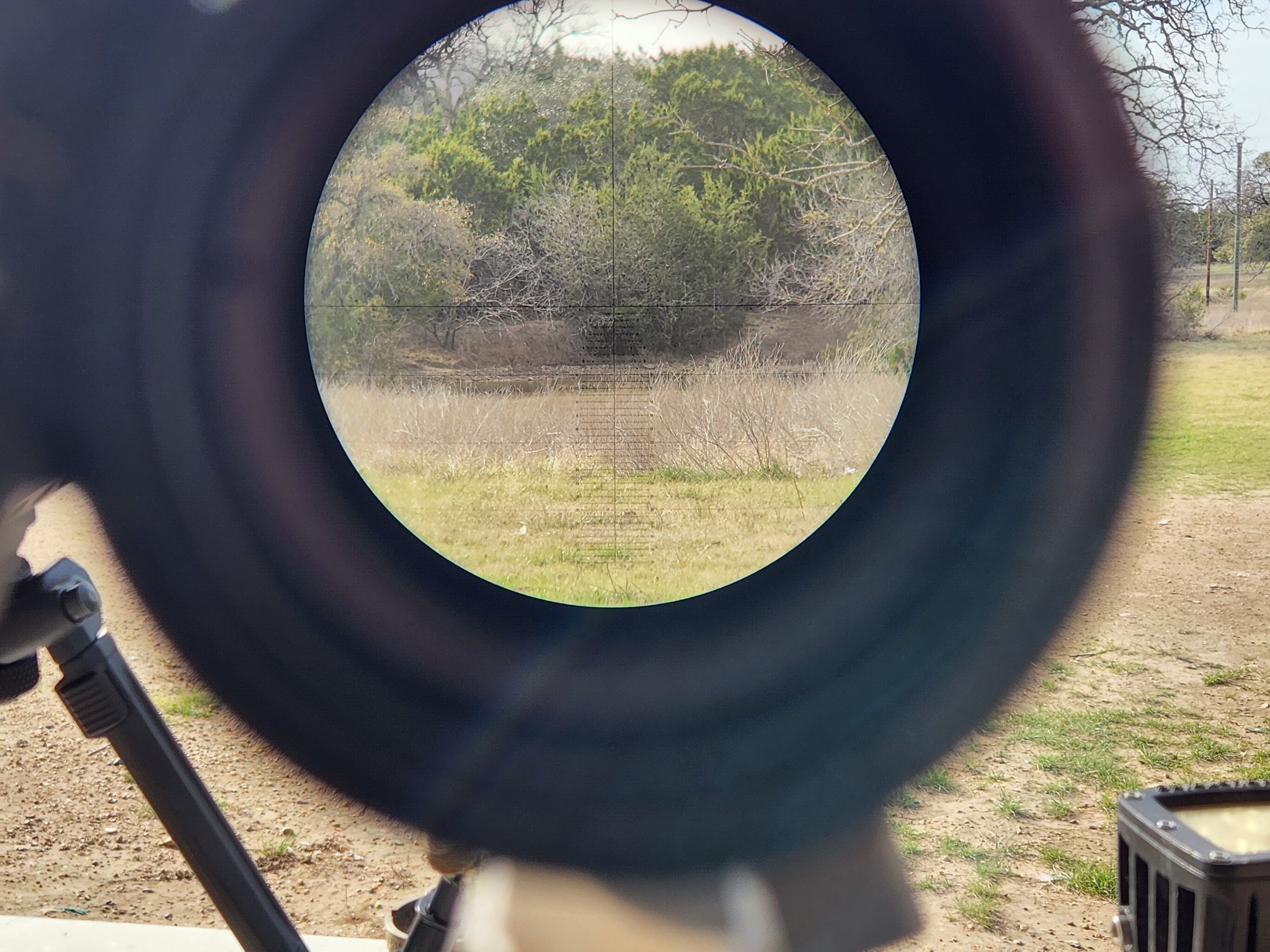

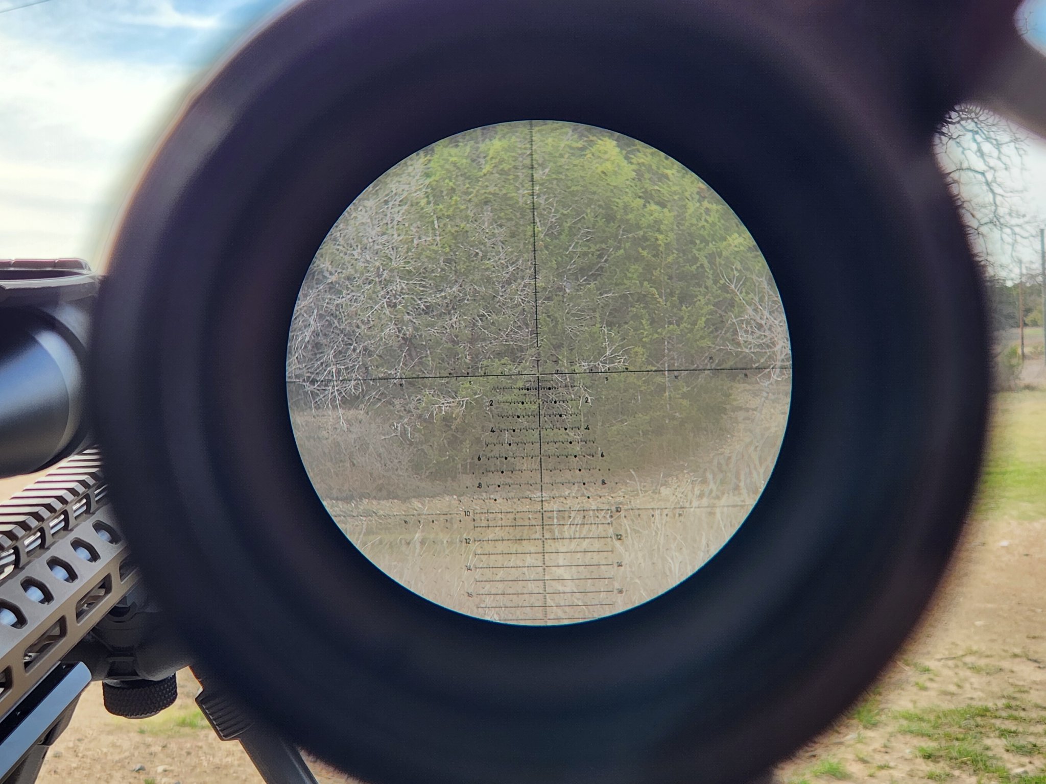

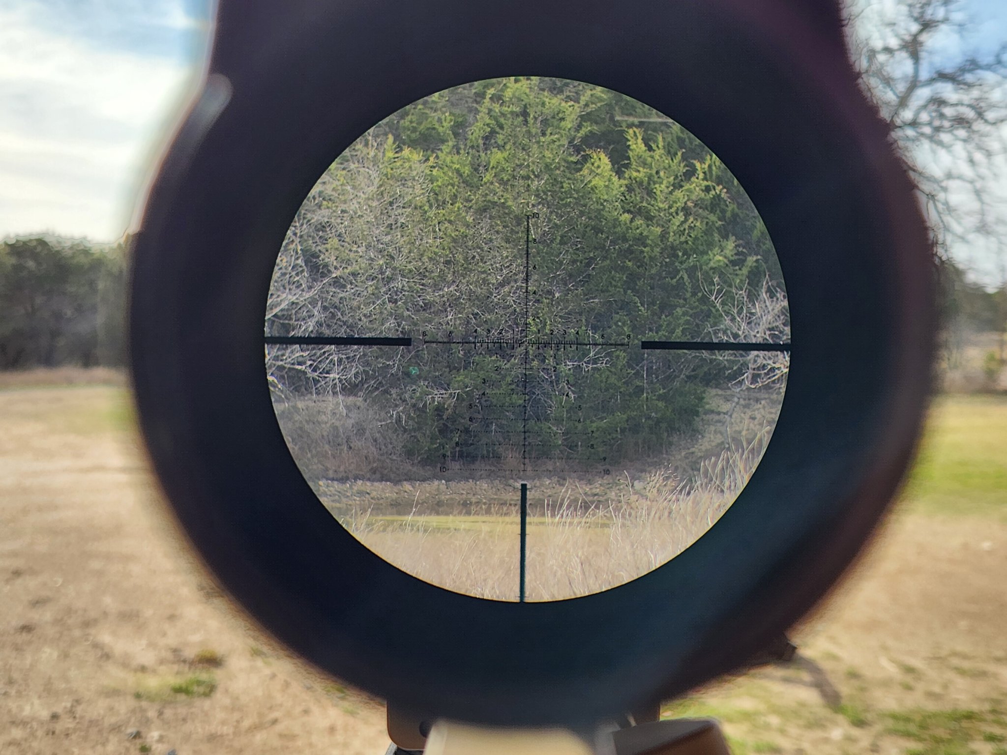

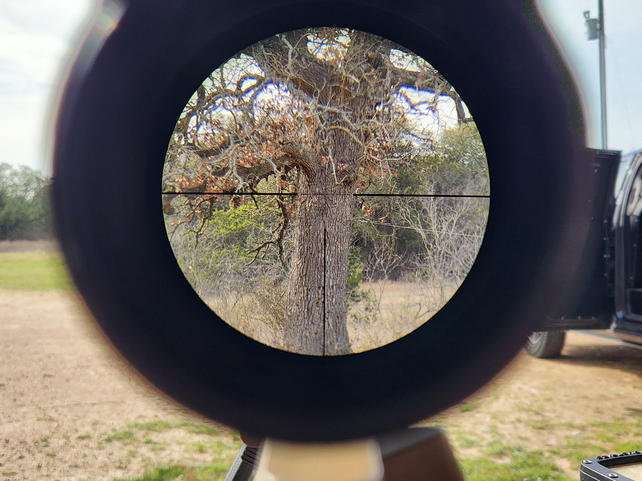

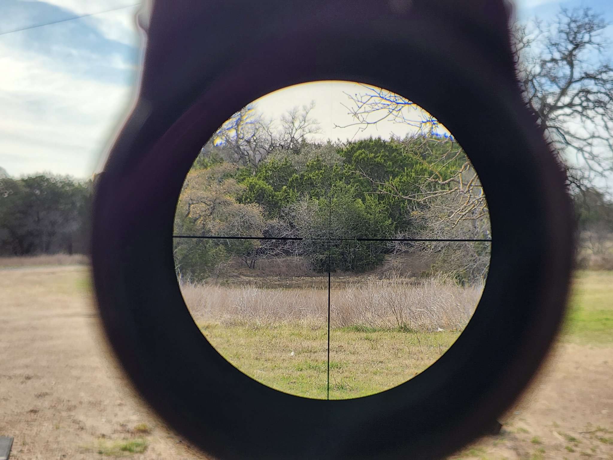

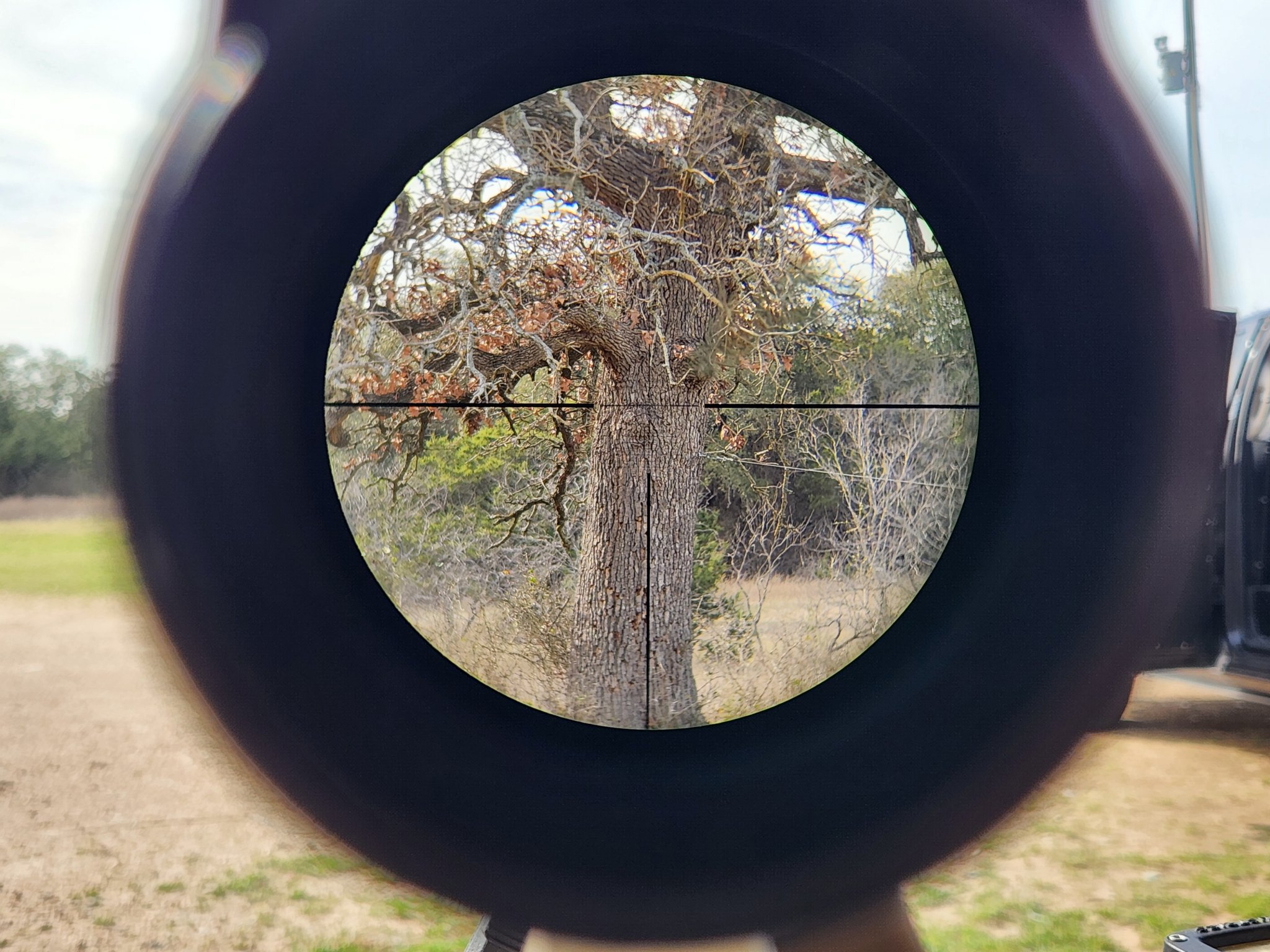

Ive recently been going down a rabbit hole in reference to the best MPVO for my work gun. I have made comments to some that actually surprised me with how much Im really liking my Vortex Strike Eagle 3-18. I now have 2 of them. I just recently started comparing it to my NF ATACR 4-16 F1 T3 and i am disapointed in what im seeing. I have included photos to compare.
Ive noticed that my ATACR seems to have what appears to be a haze. I took both of these scopes an set them side by side. I then set both to matching power settings of both 4x, and then 10x to compare and take photos. The haze looks much worse to my eye, but can be seen in the photos as well, its just not as apparent. Both optics were zoomed into their max mag, side focus set, and then dialed back to the 4x before photos were taken. Same with 10x.
First photo in each(1,3,5) comparison is the SE, Second photo in each(2,4,6) is the NF ATACR F1
Are the new SE 3-18 really this good, or have I gotten use to a NF that is cloudy/ hazy?
Has anyone else experienced this, or should i contact NF and see about sending it back? This thing tracks incredibly well as it should, but optically i have to say that i am a little disapointed as i compare it to other options.

Is the diopter and parallax set correctly? If you don't know ...chances are that is it.
Seal could have broke and it lost the N2 purge. Happens but I would make sure it's not something easy before sending it in.
Sorry, should have said that the diopter is set correctly.
Parallax set at 4 and 10x separate does the same thing. Not sure how that would remove the haze. But I tried it anyways.

That looks crappy. Hopefully NF takes care of that because that’s a really terrible image.

OP this is first and foremost gargage photography...:D
Hahaha. That's what it looks like!
Compare it to the other photos. Same settings, etc. I tried to make everything as equal as possible. Both lenses cleaned. Same time of day. Optics literally on the table side by side. Aimed at the same location as close as possible for equal comparison. Parallax set correctly on both. Magnification on same setting. Camera on same settings on both, etc.
I never claimed to be a photographer. Just aimed at what was in front of me while sitting to do some side by side with other optics from the front porch. Honestly i was only interested in seeing if my camera would pick up what my eye was seeing to make sure it wasn't a vision issue with my eyes.
I don't have a digiscope or some sort of slide on collar so I have to hold the camera by hand.
But those are as equal comparisons as I could get.
Glad you enjoyed them! 🤣
Just remember .... Cav scouts are infantry that are too smart to hump. Make sure to remind the instructors in your class. Especially if you ever make it to Camp Robinson at the B4 school. Death before dismount.

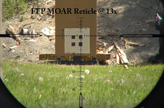

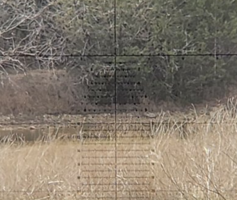

The reticle clarity is going to be the baseline, since its often clearest thing in the scope.
eg, here we get a decent-ish reticle, and but there's washout and lack of sharpness in the reticle,
and of course this is also proportionally seen in the image quality.
But nevertheless, you can use an image like this. Especially in a/b testing, since the 'b'
sample should show similar reticle quality if the image taking/method is consistent.
Reactions: 19dsniper
NB. None of this is to excuse any poor performance of the Glass. Having a better a/b test I'm sure would still show what you want to show. It will just provide mosre substance for discussion, and more clues as to what's happening. Cheers.

Ahhh.. I see what you guys are referring to. I will attempt to retake some photos in my free (haha) time.
The haze is still visible, but i definitely see what you are talking about. I may pull plout my canon dslr and see if there is a better way to get some more consistent results.
