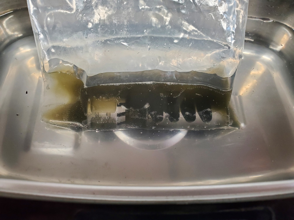

For those that dont know. Fill the tub with plain water. Place your part to be cleaned in a plastic bag with the desired solution.
Now you don't need a whole tank full of solution and contains the mess in a bag.
Edit to add: Keep in mind not all plastic bags can handle any chemical so test it first.

This (y)(y)(y) Saves on cleaning solution ;)
And, I have been told that using distilled water in the tank prevents mineral buildup on the transducer and extends the life of the machine.
Plus it allows me to use small amounts of chemicals one would not normally use in a more controlled manner. Like acids and flammable liquids.

I use 500ml pyrex beakers to clean my rifle brass in my ultrasonic cleaner. I can stand 40 pieces of 6.5 or .308 brass primer pockets up in the beaker and they hold each other up for the whole cleaning time. Saves a lot of solution for sure. I fill my tank up with water and just use my brass concentrate in the beakers.
