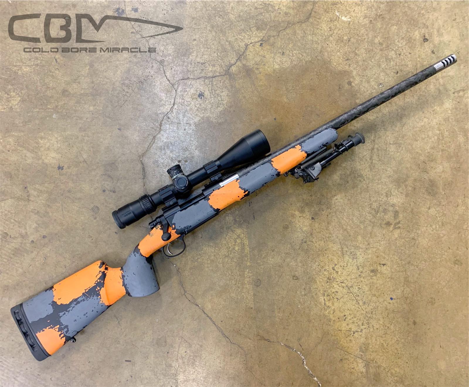

I just built my cousin a rifle that is just like what you are looking for, its a 24" 7SAUM with carbon fancies.
Hope this helps make up your mind.
