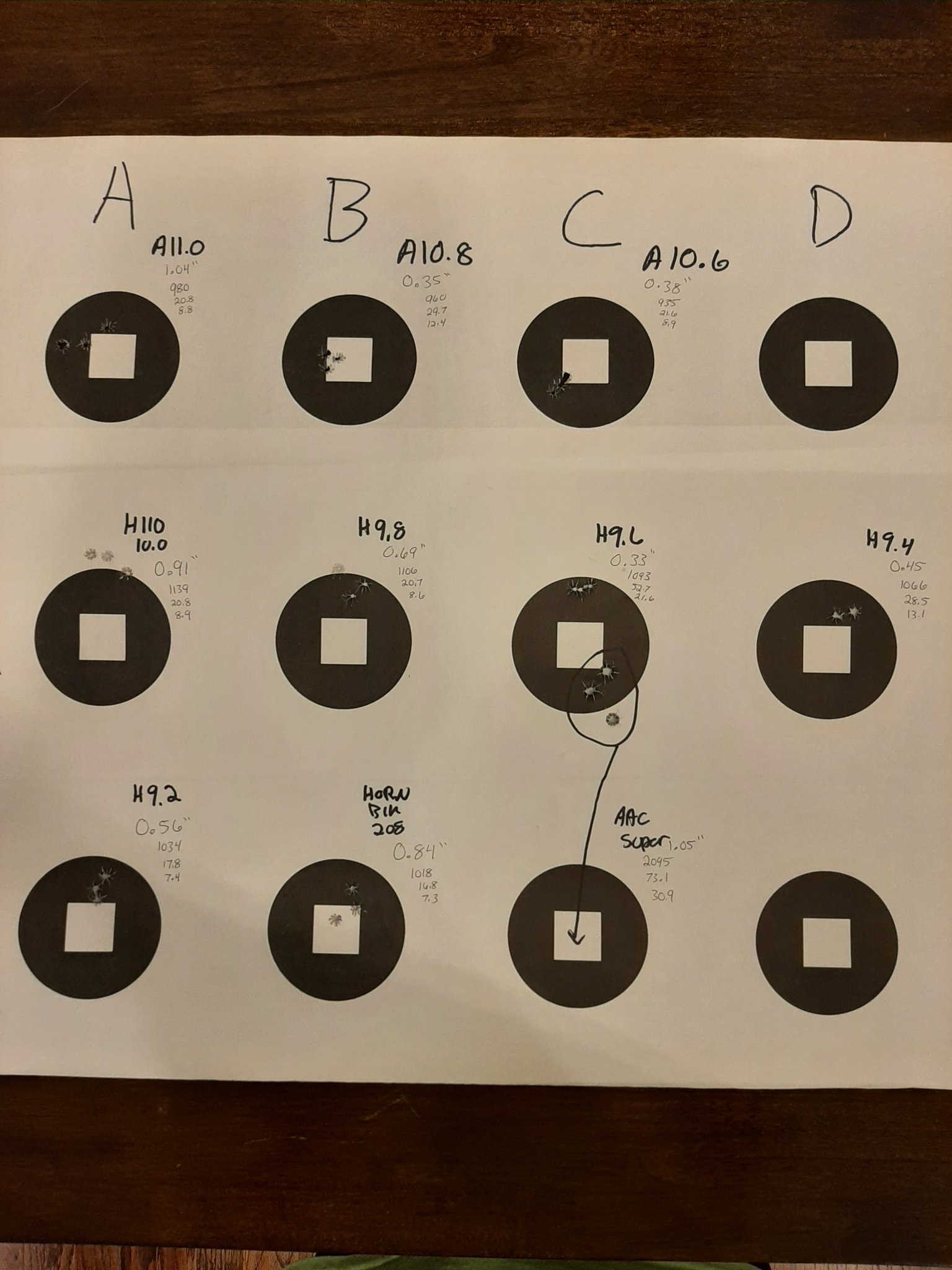

    Circling back to this for anyone ever searching.
    Messed with a1680 and got a load that worked but it is incredibly dirty. 11.5gr under a 220gr was giving me 1150ish so I dropped it and picked up some h110 that had a better burn percentage at the charge weights.
    Below are the results with a 1-4 steiner p4xi at 50yrds. Got a few good loads here so going to load up some more and test at 100. Factory hornady black 208 gave me 5" groups at 100 so I think I'll be in the 2ish moa range with one of the good loads.
    Having said all of that...I did open the gas port from .083 to .095 to get it to function 100% with subsonic loads. For reference the hornady black 208 wouldn't even cycle enough to pick up the next round. This is with a standard bcg and carbine buffer/spring. After enlarging it cycles fine and loacks back after last round. Even with the handloads it locked and cycled with all of the ones below.
    Good to see you have figured out a good load!
    I have found that the Hornady 208gr A-Max subs won't cycle on my rifle at all (10.5" 300BLK Rosco Mfg Bloodline Barrel, OCL Hydrogen L 7.62 suppressor and JP H2 buffer). Gas port from Mfr @ 0.0850") and the SupArms AGB wide open. I even took the time to compare each box for Lot# and tried four different lot #'s...to no avail. My gut tells me that Hornady changed the powder and the performance IS NOT what at the original specification.
    My rifle will run like a mad man with S&B 200gr subs, Winchester SuperSuppressed 200gr OpenTip subs or Fiocchi Range Dynamics 220gr subs.
    I will use the remaining boxes of Hornady 208gr A-Max that I have as range plinkers. lol
    Use care with the H110 load. That powder doesn't like unfilled space. While it doesn't give trouble all the time I've seen some unexplained issues often enough that I dumped that powder many years ago. If you can fill the case nearly full it is an excellent powder. A friend uses it in his 500 Leinbaugh and his 458 Leinbaugh but for subs I'd find something else. You can find info on the various loading boards if you look for H110 excess pressure issues.
    Yes, the 1680 is a bit dirty but its very consistent, cycles the actions when other powders don't without turning gas ports into huge openings and we've run it for a long time without cleaning to see if it causes any trouble with all the various subs we load. It has never been a problem except to guys that can't stand a bit of scum on their rifles. 300BO, 338 BR, 510 whisper all love it, its accurate, reliable and used to be available. Not so sure now.
