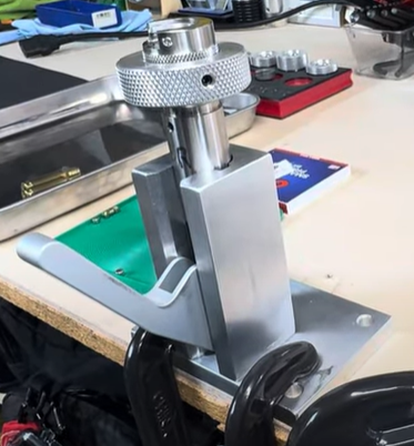

All I will add, is there is a cottage shop fellow who makes a stand/holder for the Sinclair tool at essentially bench mounts the tool.
I think Bryan Z recently showed it in a YT video as part of his brass priming series. If I can find it without a lot of fuss I will link it here.
The fellow that makes the stand is Todd Criswell who is a BR competitor and fellow Hoosier.
Here is a snapshot of the tool stand.
Funny you mention this video. I am the designer and manufacturer of that RPG tool laying on his bench (next to the Sinclair/Criswell setup) which he uses for sorting rim thickness, measuring pocket depths, measuring seated primers, etc. Bryan has tested this primer seating topic as well and tends to agree that the optimal window for seating depth generally allows a 0.002-0.003" tolerance for variation (or +/-0.0015" of mean).
If you watch enough of his videos, you'll hear my name come up every so often (Bench Addict / Justin Nehring). Small world, lol. He'll be doing a video on the RPG tool in just a few more days.

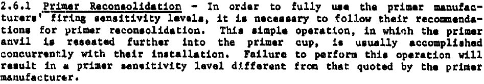

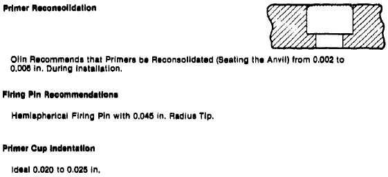

And then there is the second kind where the burden is on the reloader because the feet sit proud and are not meant to be driven flush with the cup.
When the anvil feet sit proud of the cup, the responsibility for "crush" is up to the user. The dimensions are not such that they are intended to be crushed to get the feet flush. The ideal values are on the order of 0.002" - 0.006" for typical ones, so say on average you are targeting 0.004" +/- 0.002" crush or reconsolidation. (Some other brands used to run 0.002" - 0.004")
When I used to specifically test primers on a test stand, you would all agree with the manufacturer's recommendations for seating, and the door opens for trouble when you are outside of their intended range.
When I have tested my own ammo it does show an effect on target, and on the chrono, but we would all probably agree the "good window" shouldn't be too difficult to hit if you are paying attention to your brass inspection.
My own pet peeve is that they do not publish these dimensions or recommendations to the consumer right on the packages. It would end a lot of arguments but once again I am left shaking my head. There really isn't much direct information in the public domain, and that is a shame. YMMV
