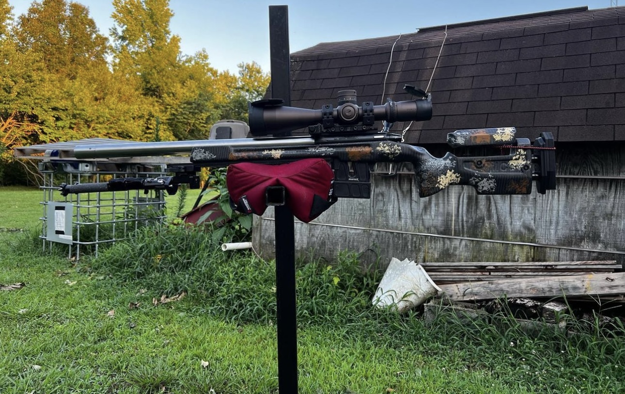

Listen to these fine upstanding citizens.
If I could, I’d get the scope this high. Only I’d use two of them lol
Reactions: Glassaholic
Forgot about that experiment! Now if they would put two scopes on there for binocular vision and then angle them back so I could shoot in my lawn chair recliner…
