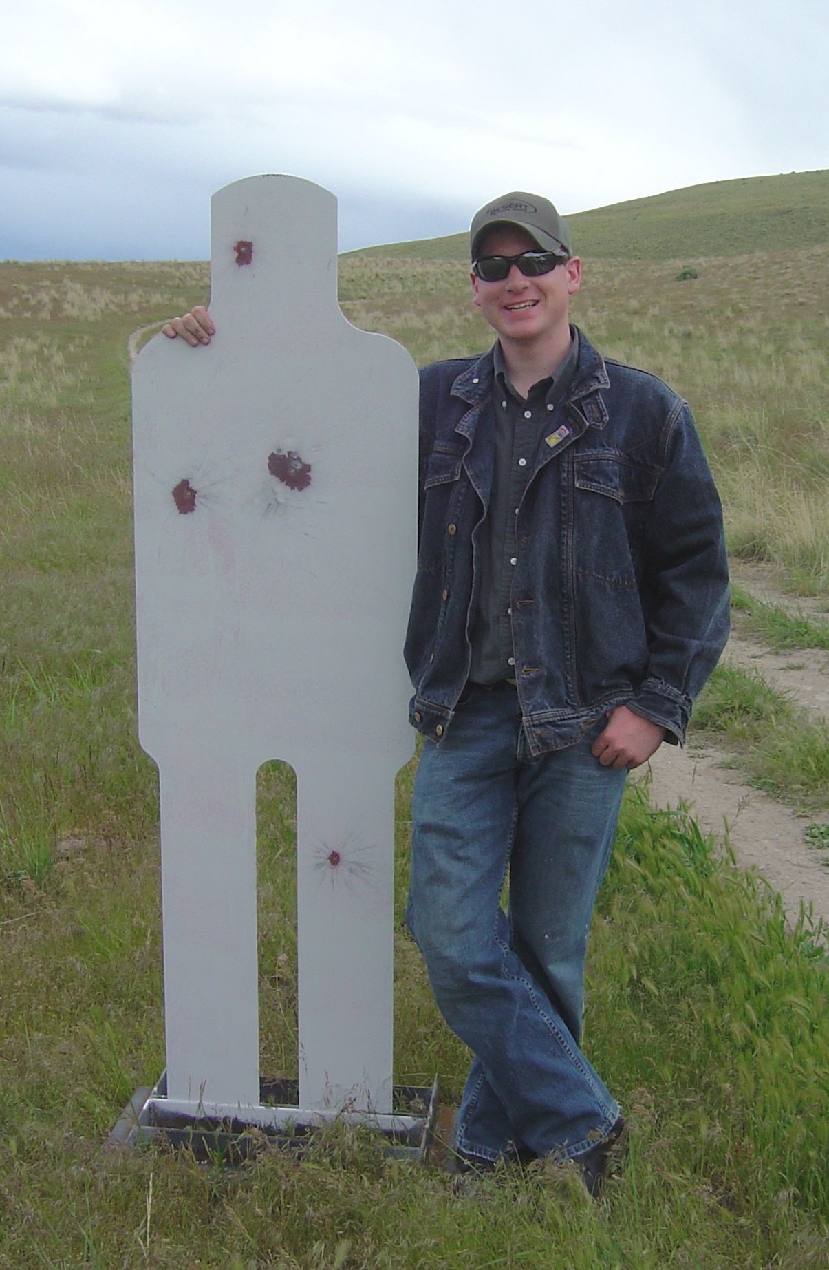

Heads are generally 10"x10" ( 1/4 Meter or 250). Mid-line (spine) to edge is 1/4 Meter or 250. Edge-to-edge is 1/2 Meter or 500.

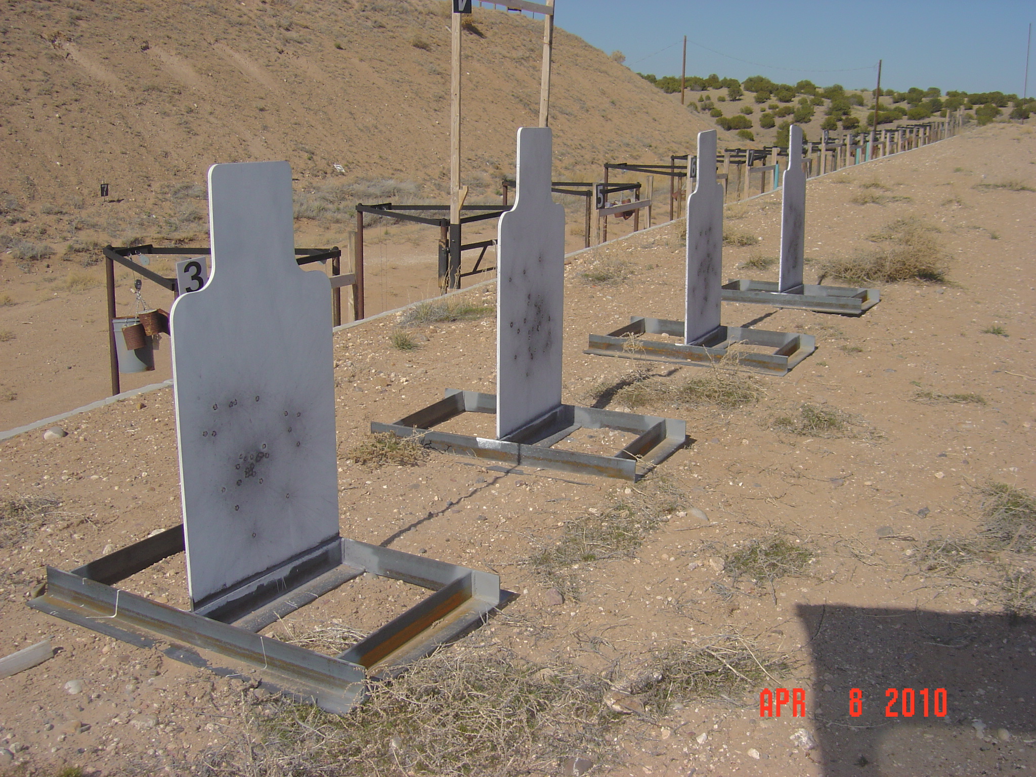

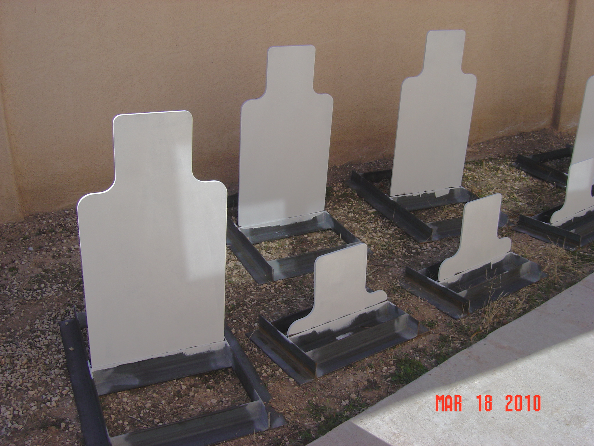

I have two of Ryan's 1/2" water-cut AR500 E-types on 4x4 stands that laugh at M2 .50 cal rounds at 500 yards. I had 3/8" targets and angle iron stands made at steel yards in Albuquerque and Salt Lake City.

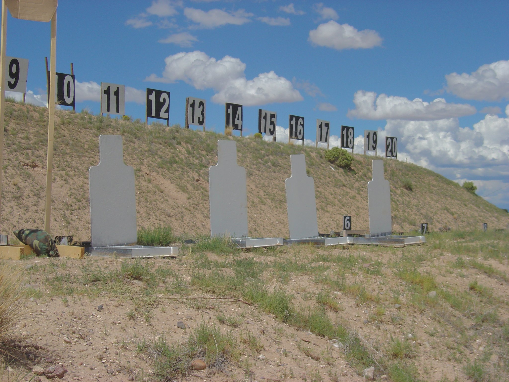

When I build steel farms I'll usually put the 5'10" (1.8 Meters or 1800) silhouettes at 1,000 and beyond -- blow a range call and you can still catch a leg hit and adjust-record your DOPE. Order 5'7" (1.7 Meter or 1700) targets if you need scaled Chinaman-sized E-types.

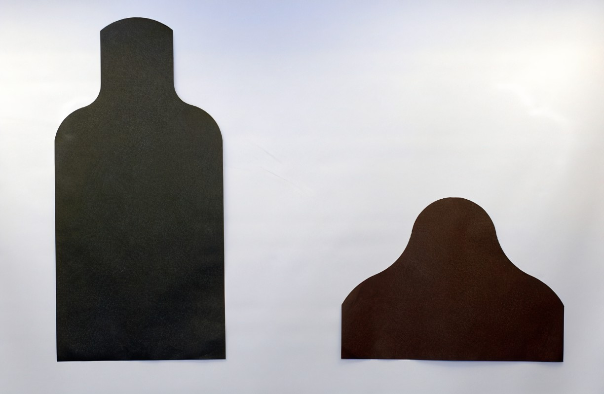

I don't believe the "E" really stands for anything, it's simply one of the designations the military used for silhouette targets, there's an "E-Type Silhouette" (Full torso) and a "F-Type Silhouette" (Head and shoulders). It doesn't have to do with electronic anything, it's a reference to a particular target shape.
The ALT C qualification target shows both types for reference.
