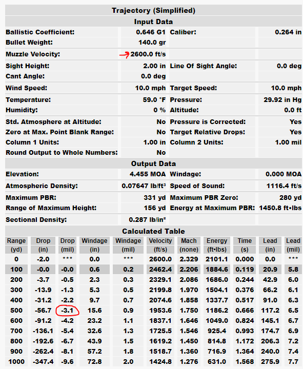

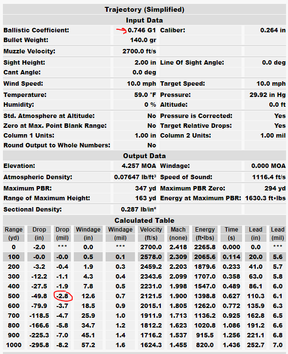

JBM ballistics trajectory simplified https://jbmballistics.com/cgi-bin/jbmtraj_simp-5.1.cgi
Adjust velocity inside 600 to make the calculator line up there and then adjust the bc to get it to line up further out past that.
A standard 6.5 creed
VS a super version of that bullet, basically no change, 2" or a tenth of a mil only.
VS 100 fps which has twice the effect.
Speed is most critical.
