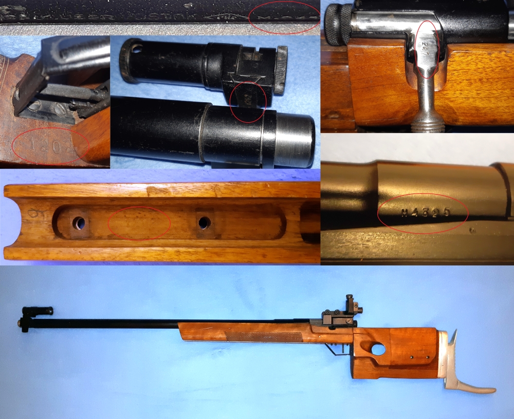

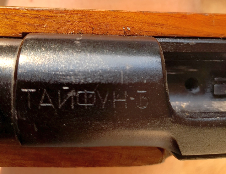

I wonder if there are Colleagues who might have knowledge about Soviet Typhoon-3 rifle [ Тайфун-3 ]?
According to quite limited Russian web sources Typhoon-3 rifles were produced from 1969 till 1979 and only 130 rifles in total were manufactured. A pair of rimfire and centrefire rifles were designed - Typhoon-1 in 7,62x54r and Typhoon-3 in .22 LR. They were suposed to be used by top level sport shooters in USSR - it was not the rifle for recerational shooting at sport clubs for amateurs.
I happen to acquire a Typhoon-3 rifle, unfortunately without original documents, manual, factory accessories - there is even no story to buy- no info about the rifle's past, where was used, by whom, how it get to Poland - nothing.
When looking at the rifle, it turned out that it has mismatched serial numbers - receiver and bolt have M247 serial number, while the handguard and stock have "1202", the base of the front sight is also marked with s/n "1202" (?!), while the rearsight has s/n "235" - so it seems that it is a Frankenstein assembled from 3-4 different rifle parts :cry:
The beast is so rare that despite those faults I decided to buy it anyway.
What I would like to know? First - it there were only 130 rifles produced how my rifle can have s/n M 247? How do they numbered the rifles? There is no manufacture date stamped but I guess my rifle should be from the late production period. In UK there is a Typhoon-3 rifle with s/n M 060. Was there an export version of Typhoon-3? My rifle is marked on the top of the receiver "MADE IN USSR VOSTOK <ГИС> M247" - if only top Soviet shooters were to get that rifles why bother to mark it in English? What about the stock serial number - it should match the rifle - mine has a "huge" serial number 1202 - what was the pattern in stock markings for Typhoon-3?

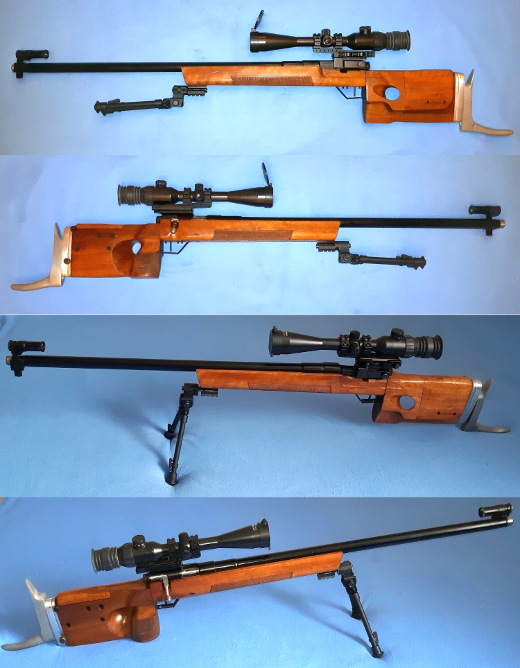

Here is my Typhoon/Frankenstein :
I'll be grateful for any info concerning Typhoon-3 production batches, markings etc.

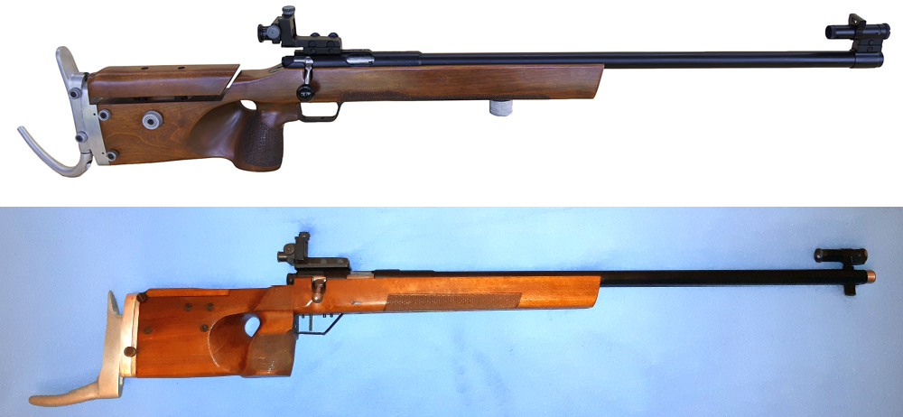

What you have may be a Ural 5-1
This excerpt from Rifles of the World:

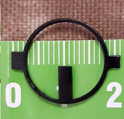

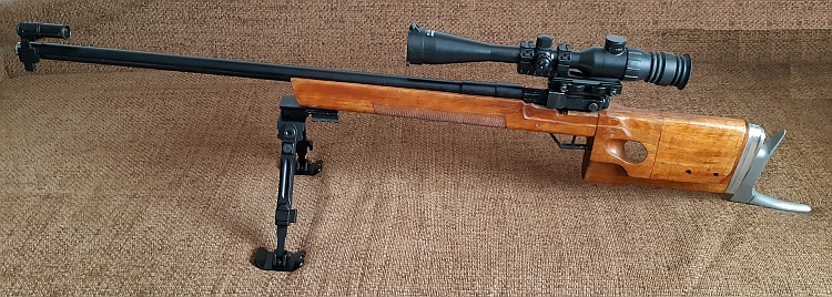

Haven't been to the range yet. I'm looking forward to it, but first I have to finish the formalities with registering the gun. I've ordered the new set of inserts for the front sight - a copy of Vostok set with diameter 16,60mm. Right now I have only one insert - the one which was already installed in the front sight - I guess that is 2,6 or even 2,8
Once I got the whole set of inserts to try I'll take my Typhoon to the range.

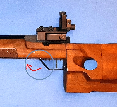

I guess that you are perfectly aware that Typhoon rifles have so called "set trigger" - after setting, just a delicate brush of the trigger is enough. I have to adapt to it to avoid situation when I shot too soon :)
The front part of the trigger guard is a trigger set lever - first the shooter must push it forward to set the trigger. Then a gentle touch and rifle fires.

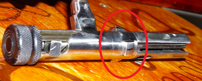

As for the bolt - for the rimfire Typhoon-3 the bolt has 3 lugs.

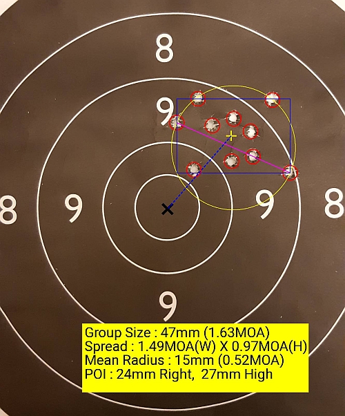

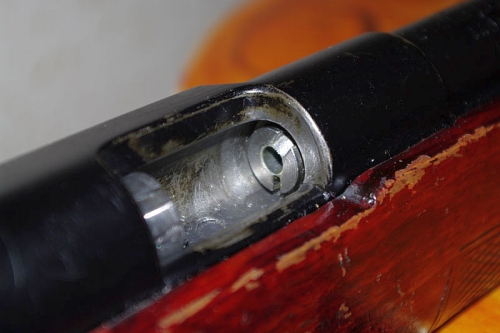

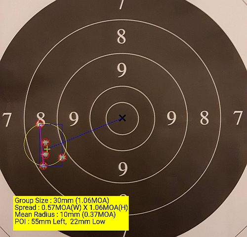

I took it to the range today and have to admit that I'm somehow disappointed - by my performance and by Typhoon's performance, by accessories, by ammo. I expected better results - despite a "budget" ammo - I thought that such thick barrel will manage with popular munition. It seems not to be the case. I more or less zeroed the scope at 100m, doing so, I encountered problems with the set trigger - after 5-6 shots it did not engage properly. Perhaps it was set by previous owner too light, too sensitive - I'm not used to set triggers and that's why I had problem with it and several unexpected misfire. That made me narvous. Second problem was with hook butt plate - my first experience with it and with the sitting fire position and bipod - that was not a very convenient. Chinese copy of Versa Pod was not so good - the bipod was not stable, the spacing of the bipod legs is too small and with a heavy rifle any tilt could cause a capsize.
Loading single cartridges is a nightmare - the chamber is designed without a slide or a ramp - you must place the cartridge precisely in the chamber - any bevel or tilt and there is no chance of correct loading.
Plus it was 30 degrees Celsius🥵
I tested Federal Champion ( 40 grain solid - 1240 fps ), American Eagle HV ( 40 grain solid ), Sieller&Bellot Standard ( 40 grs ) and SK Standard.
Distance : 100m
With 5-shots group only with Federal Champion I got close to 1 MOA:
With 10-shots group it was "huge" 1,61 MOA
Distance : 100m
Distance : 100m

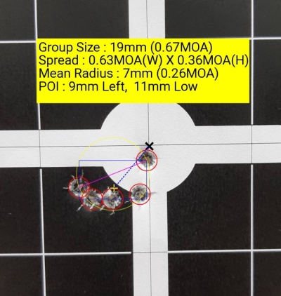

Hooray, it turns out the rifle wasn't to blame!
It's a bit of me as the shooter, the previous bipod and "plinking" ammo which led to so poor result as posted earlier.
With Eley Benchrest Precision 40g, new bipod and more careful aiming and trigger adjustment ( no missfire at all, I made the trigger a little bit less sensitive and the set trigger mechanism this time worked flawlessly ) Typhoon gave me 0,67 MOA at 100m for 5-shots group - and still there is a room for improvement - mostly for the shooter :)
