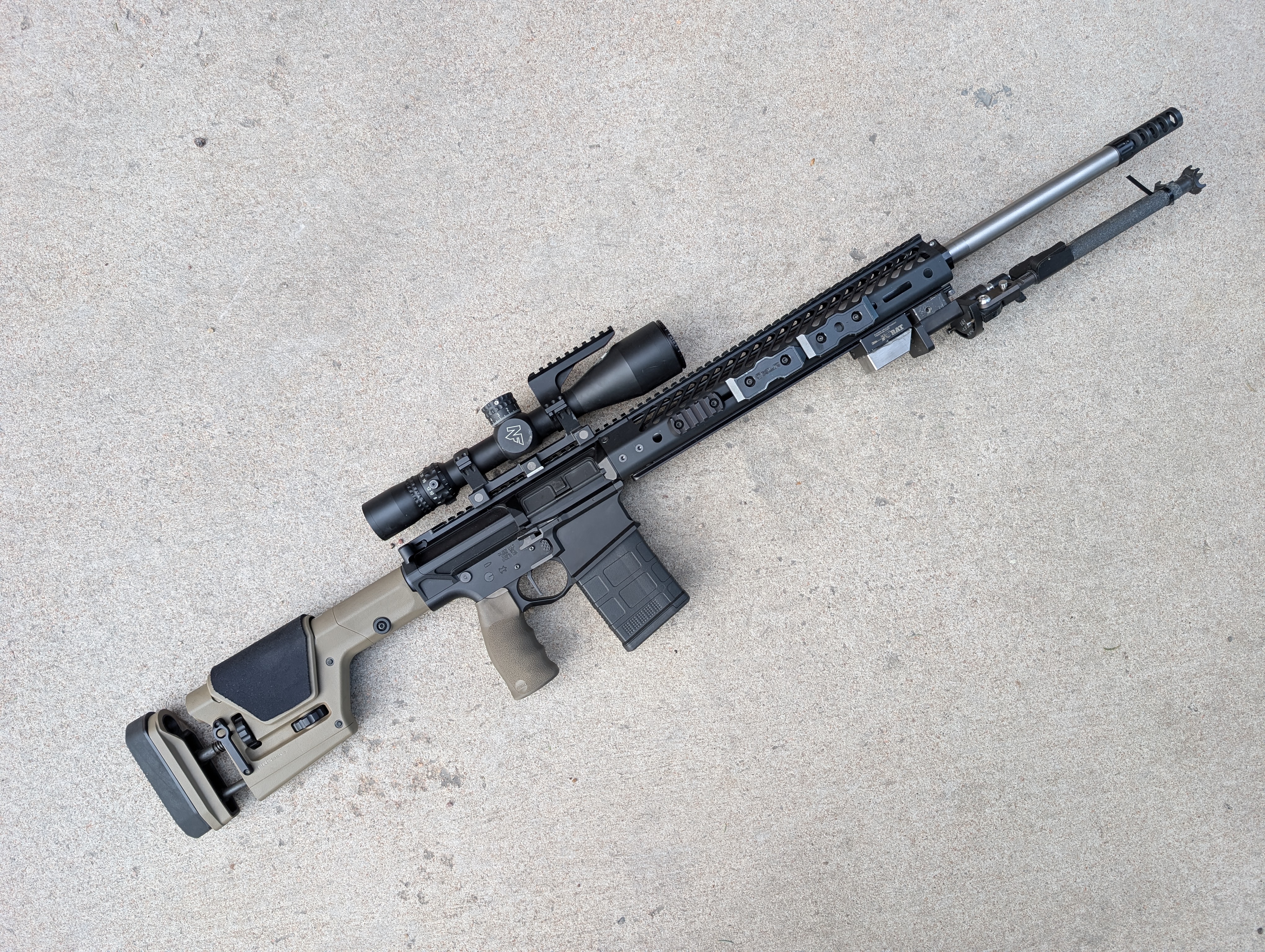

Seekins SP-10 builders kit. 24" Mullerworks as heavy as possible with a .936 fixed gas block. Journal is a friction fit. +2 length. Gas port ended up being .083" to lock back on a mag with my NRL Hunter ammo. 140 Hybrid, 39.5gr H4350 in Alpha SRP brass. JP LoMass BCG, SCS with 3 tungsten buffers, TT Diamond. Hawkins updraft in 6.5mm. 3lbs of weights added. Weighs 20lbs as pictured. It runs about 35fps slower than my 25" NRL Hunter barrel but it just crossed the 100rd mark this morning after it's first cleaning at 75rds.
The barrel extension was a challenge. I went through 4 extensions and ended up getting a prototype extension that was cut with shallow feed ramps. I'm not sure what it's original purpose was but it's what's required to feed Hybrids and ATIPs without jamming or jacking up the tip. My gunsmith softened the lugs until there were no scratches on the bullet. He also cut the port in a groove and throated it for a 2.800" coal at the lands. Dude went above and beyond.
View attachment 8690883View attachment 8690884
who did your barrel?
Is there a proprietary barrel/receiver interface on these that doesn't work precisely with standard barrel extensions from criterion/proof/etc?
