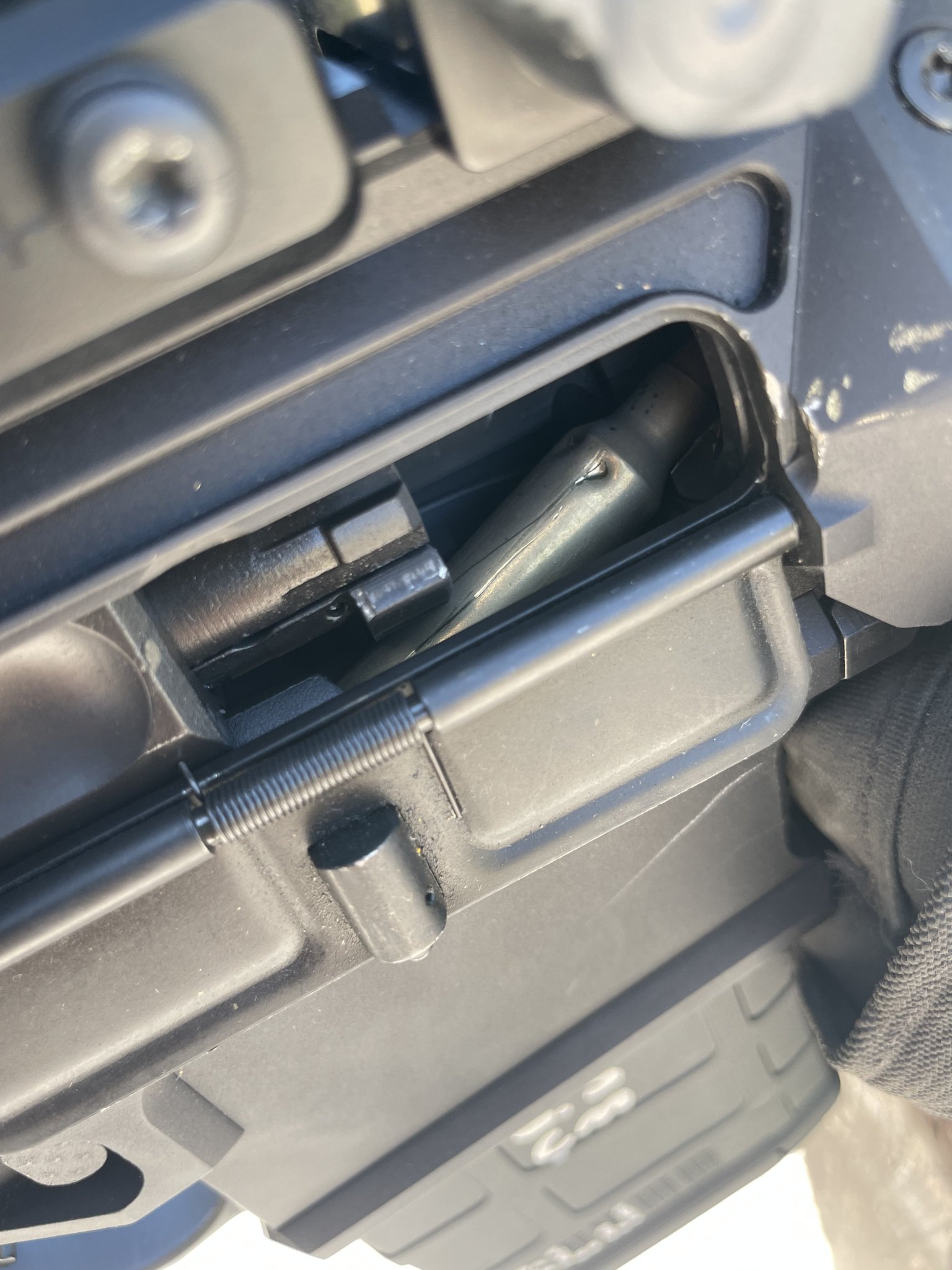

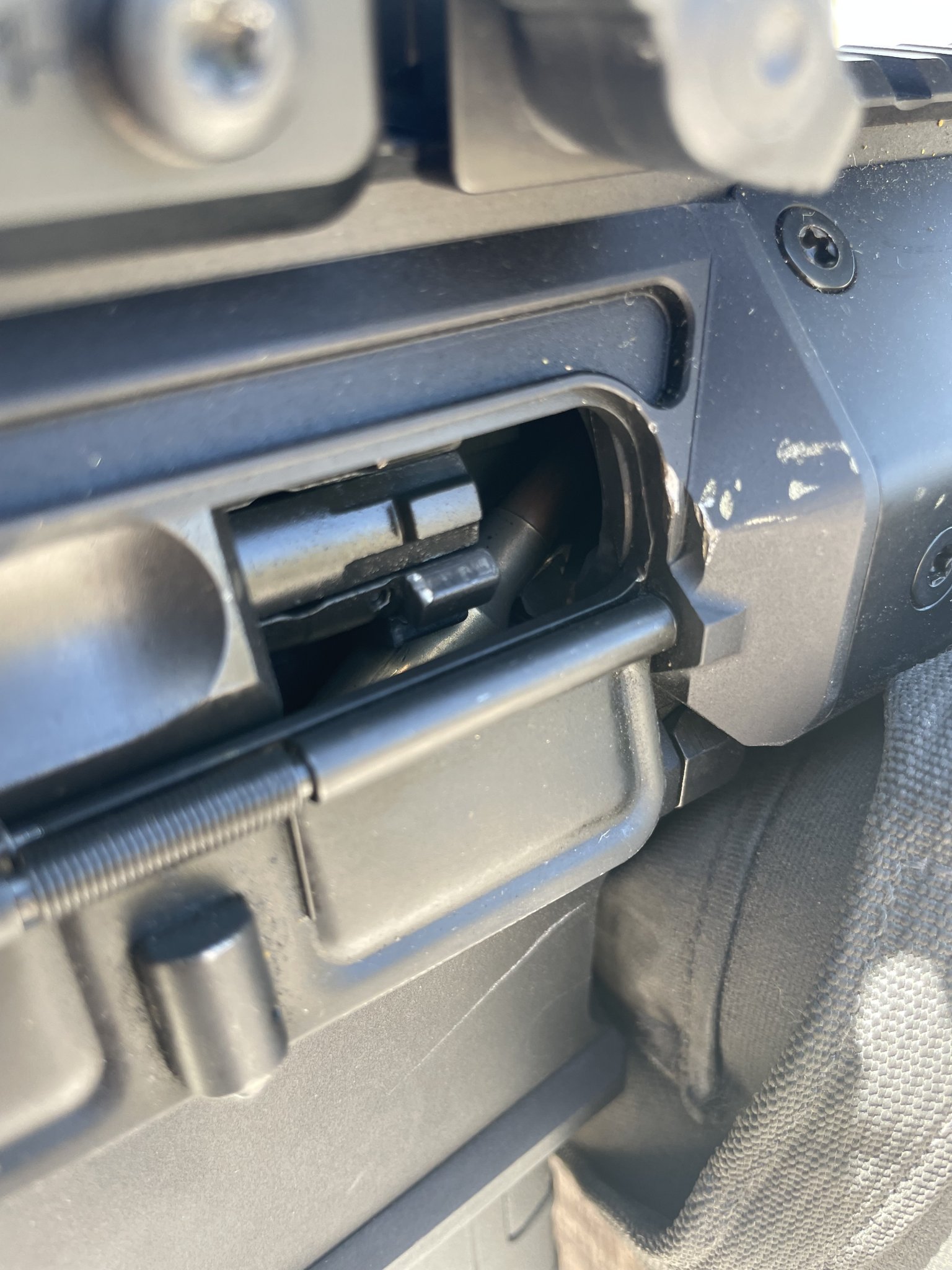

When I use p-mags (LR/SR) 10 or 20 rounders I get feeding issues. See pics below. It’s like clockwork with either sized p-mag. It will jam around the 4th-6th firing every time. However, when I use my KA mags, it feeds fine.
Just looking for feedback. The gas block has been adjusted to a reasonable level. It’s not over-pressured or under-pressured. I’d like to be able to use the 10 round p-mags for PRS matches.
I also have L7AWM mags but the SCS system does not have enough force to chamber a round when the bolt is locked back and then released. It cycles fine otherwise but requires more gas than my KA mags for chambering rounds. I think the L7AMW spring applies too much upward force against the round and the lips. Also tried it with the heavy buffer and full mass BCG and the L7AWM mags just seem to have too much to feed a round.

The bolt is cycling faster than the mags, that's the issue. The gas block may be almost closed but there's only so much it can do.

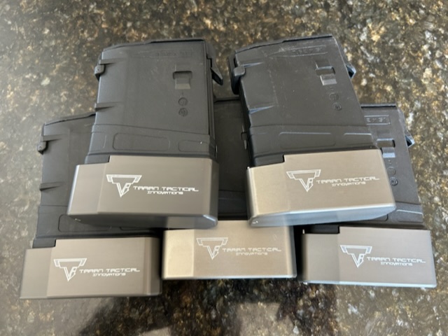

I retrofit all of my comp mags with 5 round extensions, because 2 extra rounds will often make up for a minor feeding issue without requiring a mag change. But, making the 10 round pmags run with the extensions requires a bit of work with a file. And, I wouldn’t attempt it until and unless you get the pmags running 100%.
