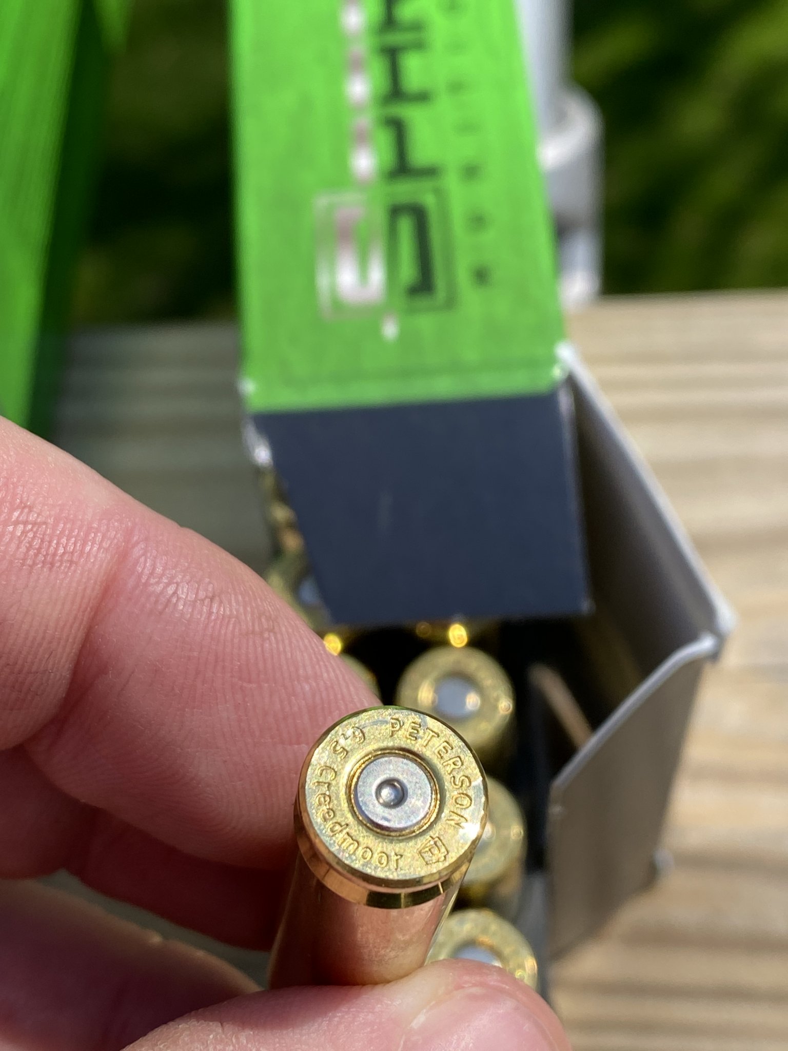

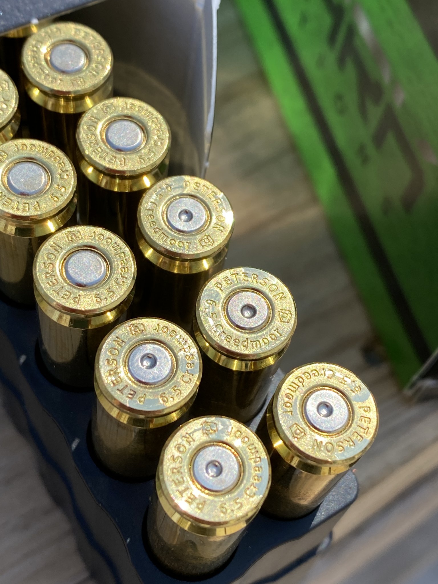

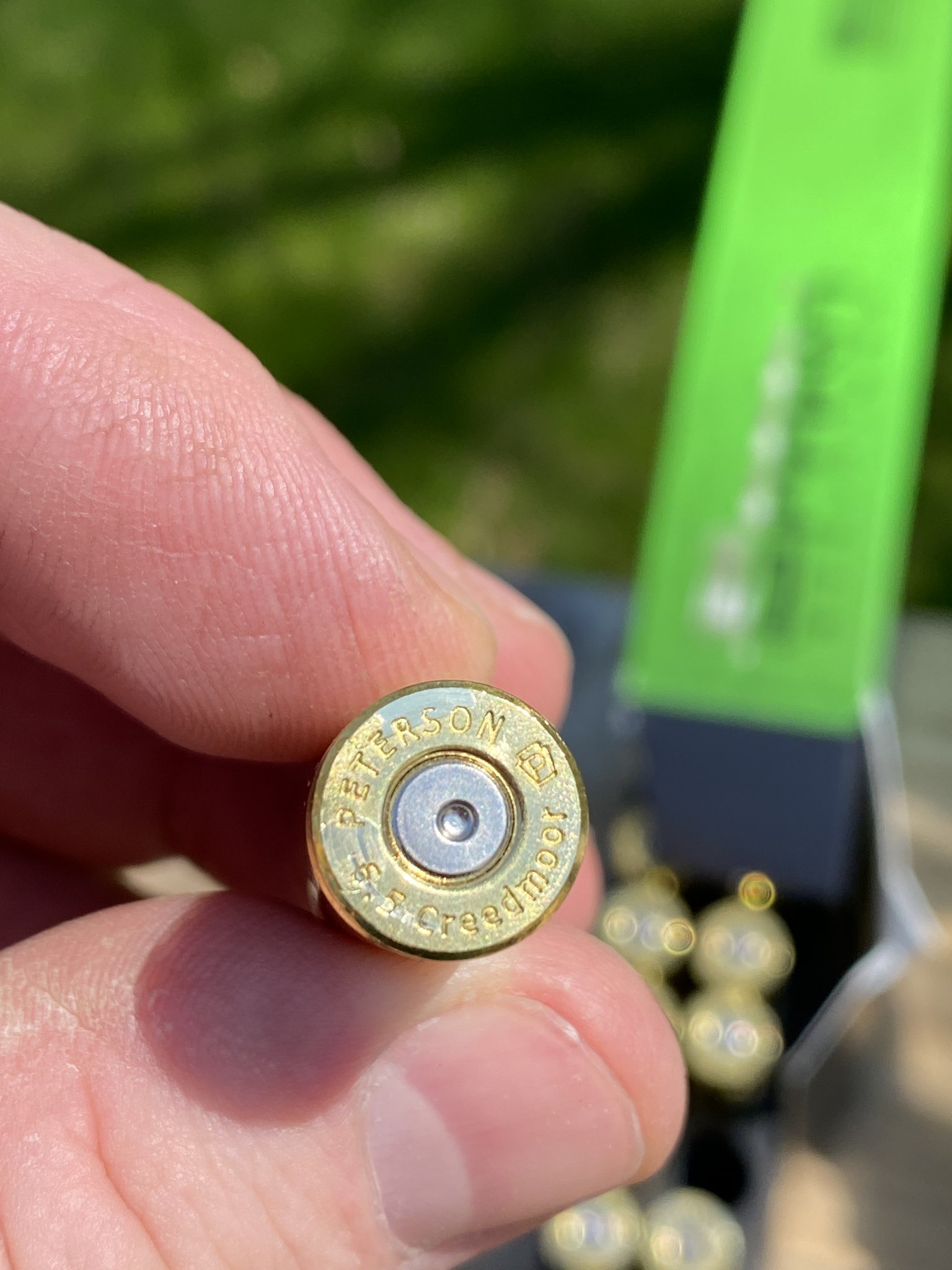

Sister company of Peterson? Believe that's where Peterson brass is made too....?
Edit-. Checked. Same contact address for both companies. Wonder if they are using Peterson brass...I didn't see brass make listed.

I've shot it in 6.5cm. Uses large primer Peterson. First batch of 200rnds in 140 ELD-M I bought last year were 2800 fps. Second batch I got last fall was 2690fps (10 rnd sample) with acceptable SD (8.6). I think it shoots good and I'd buy from them again. Stand up company that was very responsive in emails too.

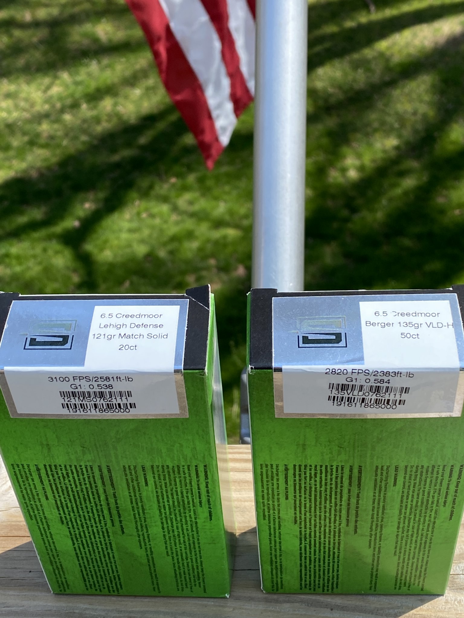

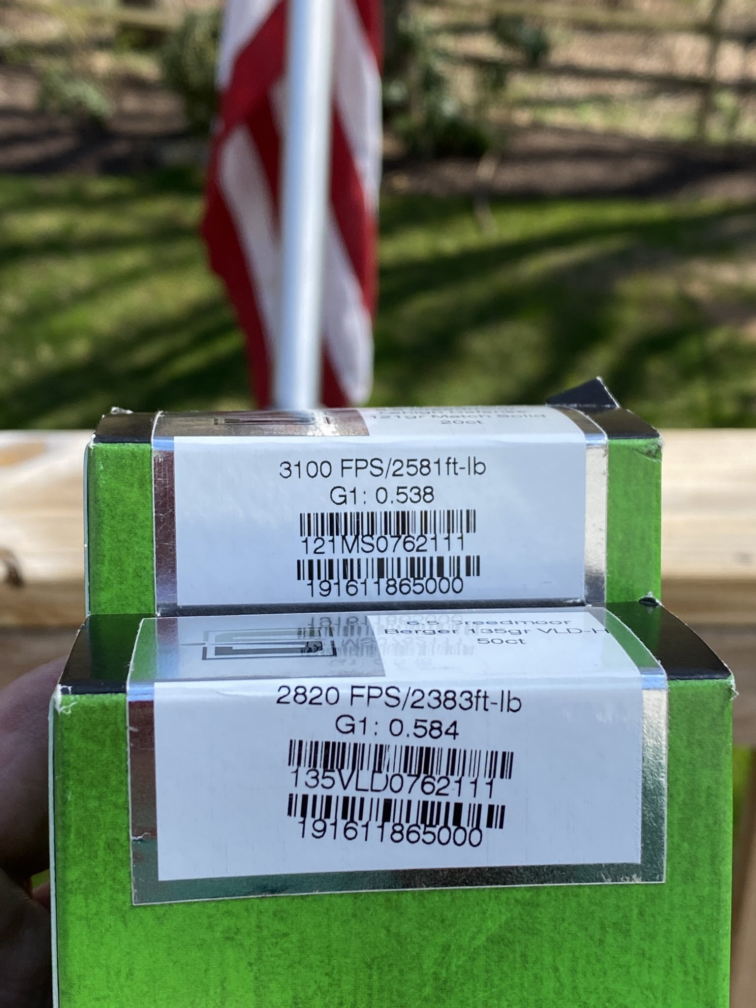

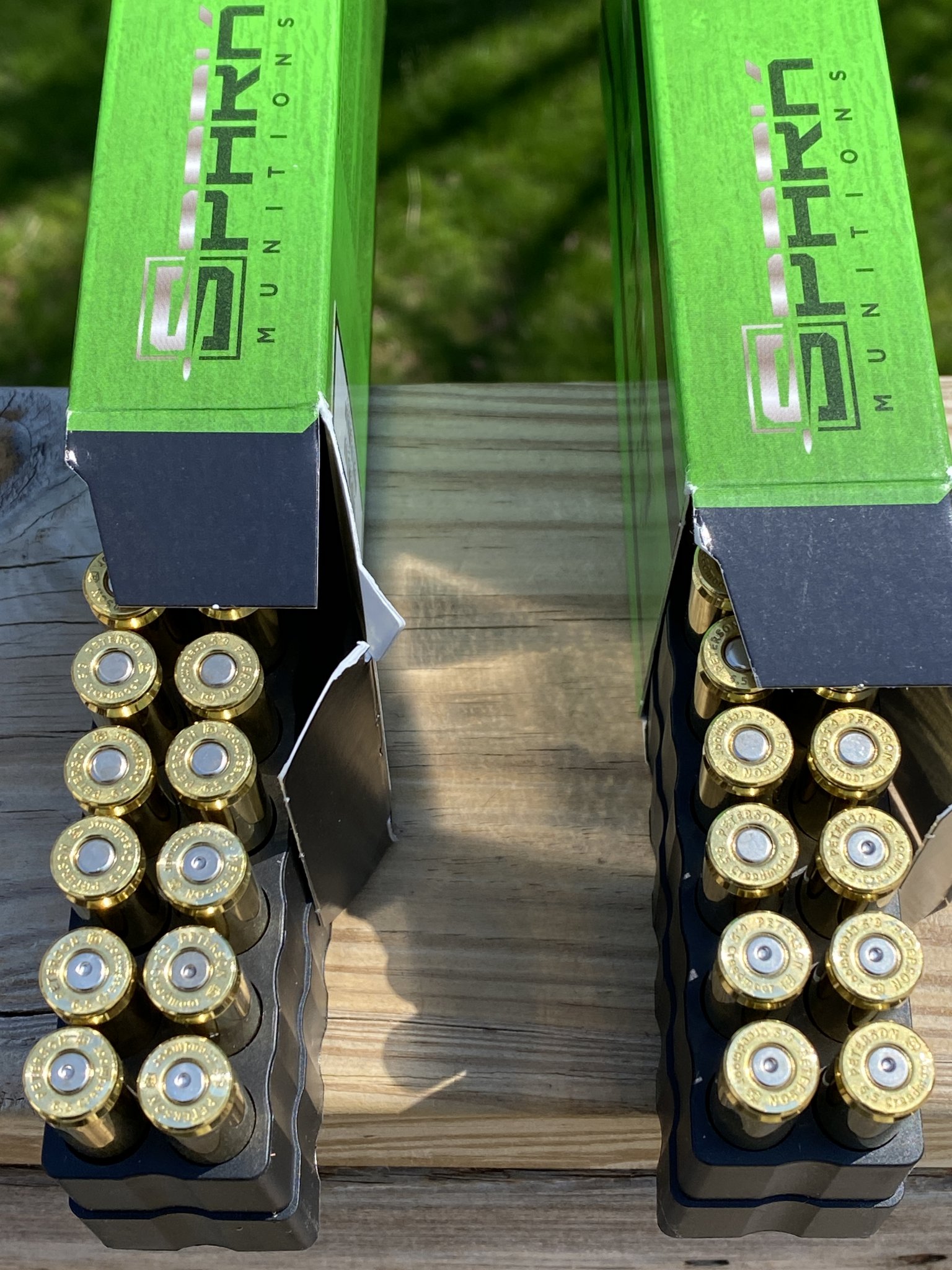

As an addition to this thread:
I was able to go out yesterday and test some sparks 65CM ammo using Berger 140 Hybrids and Lehigh 121 solids in a Tikka T3X TAC A1.
While the primers did not show signs of high pressure, the bolt was hard to operate.
As such, the Sparks ammos could not be used due to classic signs of high pressure.
The boxes absolutely show very high FPS ratings (2850 / 3100 ish, but I'll get some pics).

Please send us an email to sales@sparkmunitions.com. I can assure you that every single lot of powder and every load is tested in a pressure barrel. This way we are certain to fall within Saami specs for pressure. We stand by our products and are happy to assist. Thanks -Anthony
Wow, I don't see 140 hybrids on their website. I do see Berger 135 VLD (and my understanding is that Berger VLD are secant and not hybrid ogives).
But when I click on it and go to the description, they say that they are 135 Classic Hunters which are hybrids.
I'm guessing that their offering varies frequently depending on what components they can get???
So Yep those were 135s my mistake I think the other box of ammo I went through was a Hornady box of 140s
Yes, my friend...but even those are, I believe, mismarked. Beger doesn't make a 6.5 VLD bullet in 135. 140 gr, yes.
They do make 135 in Classic Hunter which is a hybrid.
