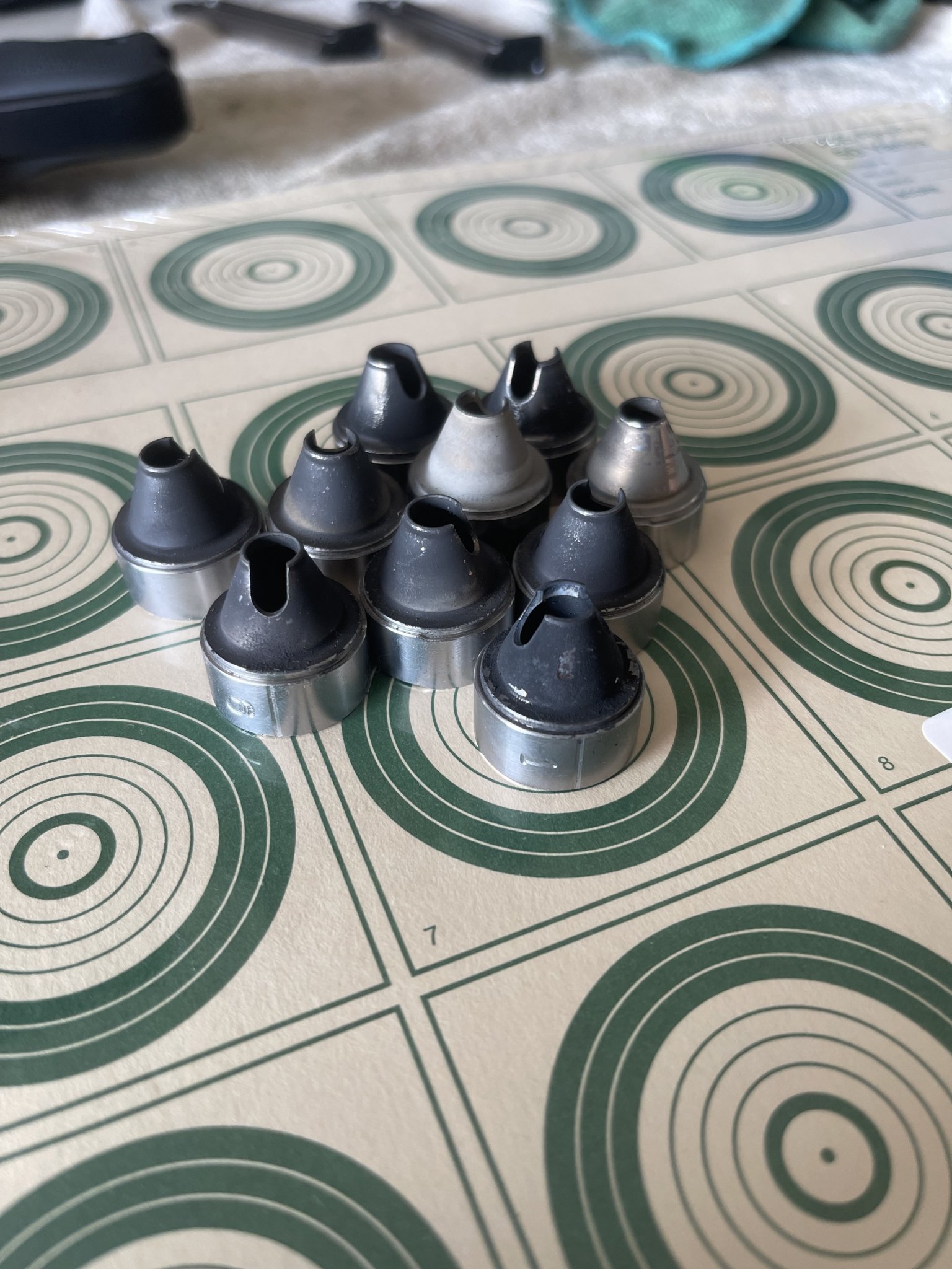

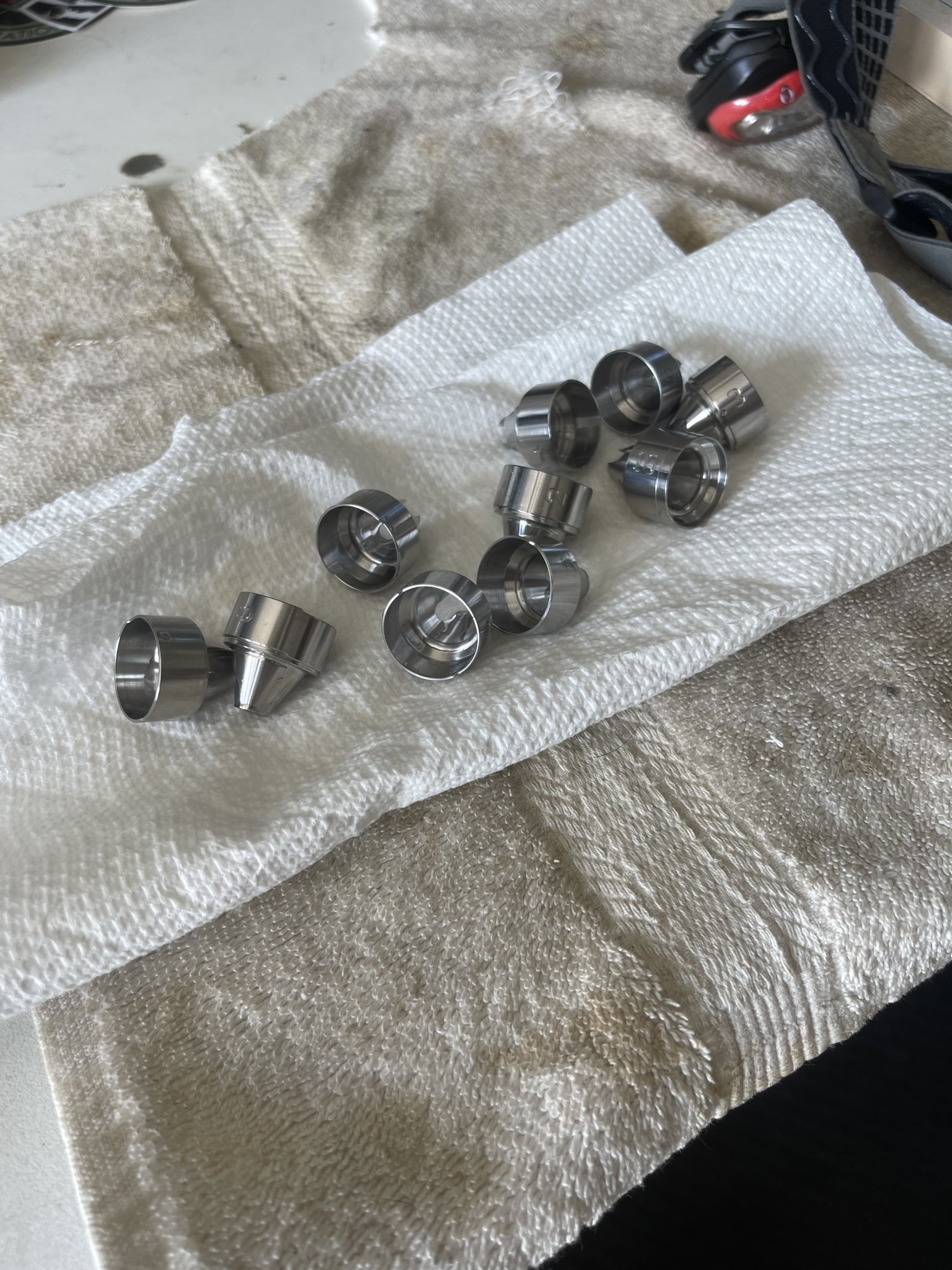

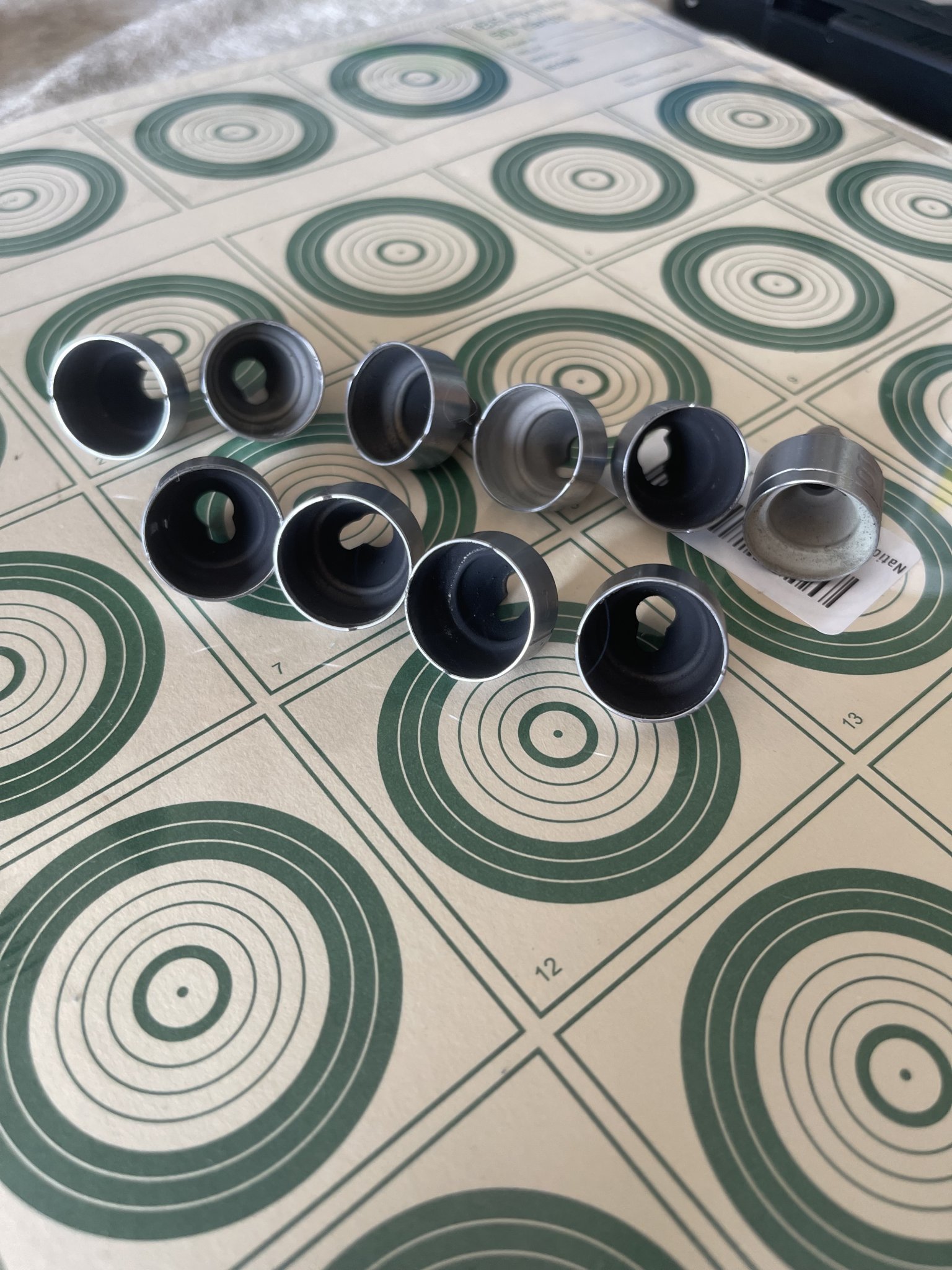

I put my TBAC on my Ruger Tactical like you have above. Man that thing is fun! 70 yard on a 6” steel plate and was able to get 7-9 hits out of 10 shots regularly. Be an awesome Varmint setup. That’s with cheap federal Walmart bulk ammo. And it sounds like a nail gun
Need to get some simple Green and run the baffles through the first ultrasonic cleaning

Use CLR... Better than Simple Green and Purple Power. I've tried all 3.
CLR soak for them for about an hour, then scrub with a stainless brush, green scotch brite pad, and hot water, and the carbon will literally rub off, and they'll look brand new. My Obsidian 45 baffles literally look like they've never been fired. They haven't been that clean since it was brand new.
I suppose you could also use a 3:1 ratio with CLR in the ultrasonic, and it will most likely do just as good of a job without having to scrub by hand.

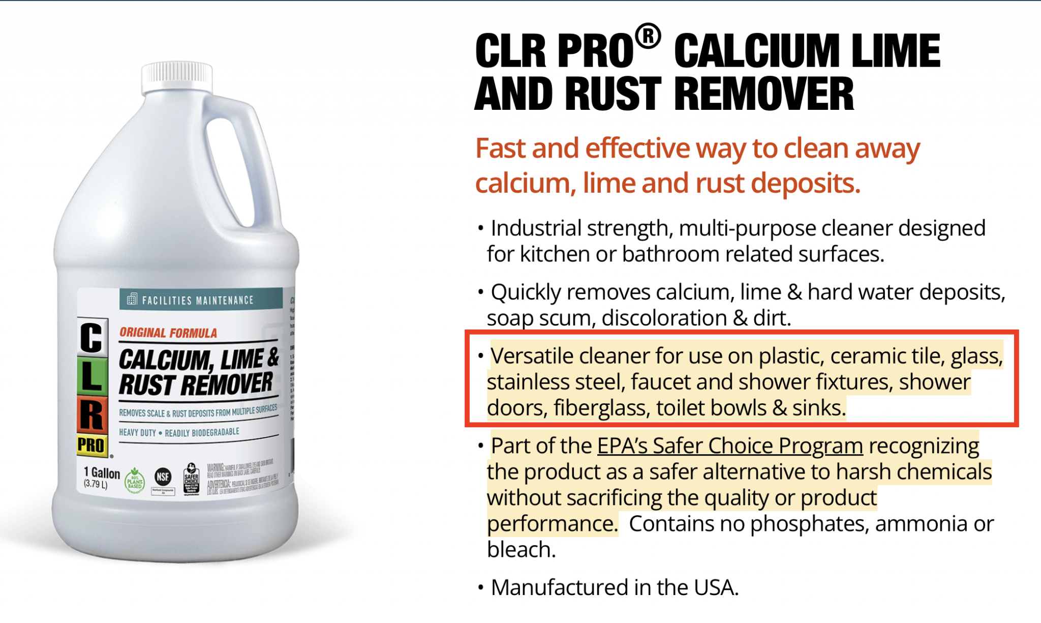

Don't know the difference between CL-4 and PRO, but I bought the PRO stuff, and it works amazing. I even ultrasonic cleaned one of my OCL Hydrogen cans in CLR (3:1 ratio) with hot water (3 parts water : 1 part CLR Pro), and it knocked over a 1/2 oz of hardened carbon deposits out of my can from shooting .300 BLK subs. It had around 2,500 rounds on that can, it was CAKED! Now it looks nearly brand new inside. You'll never get ALL the carbon out, but I got it down to 9.5 oz in weight (9.3 new). So I'm satisfied with the results.
CLR Pro (1 Gallon)

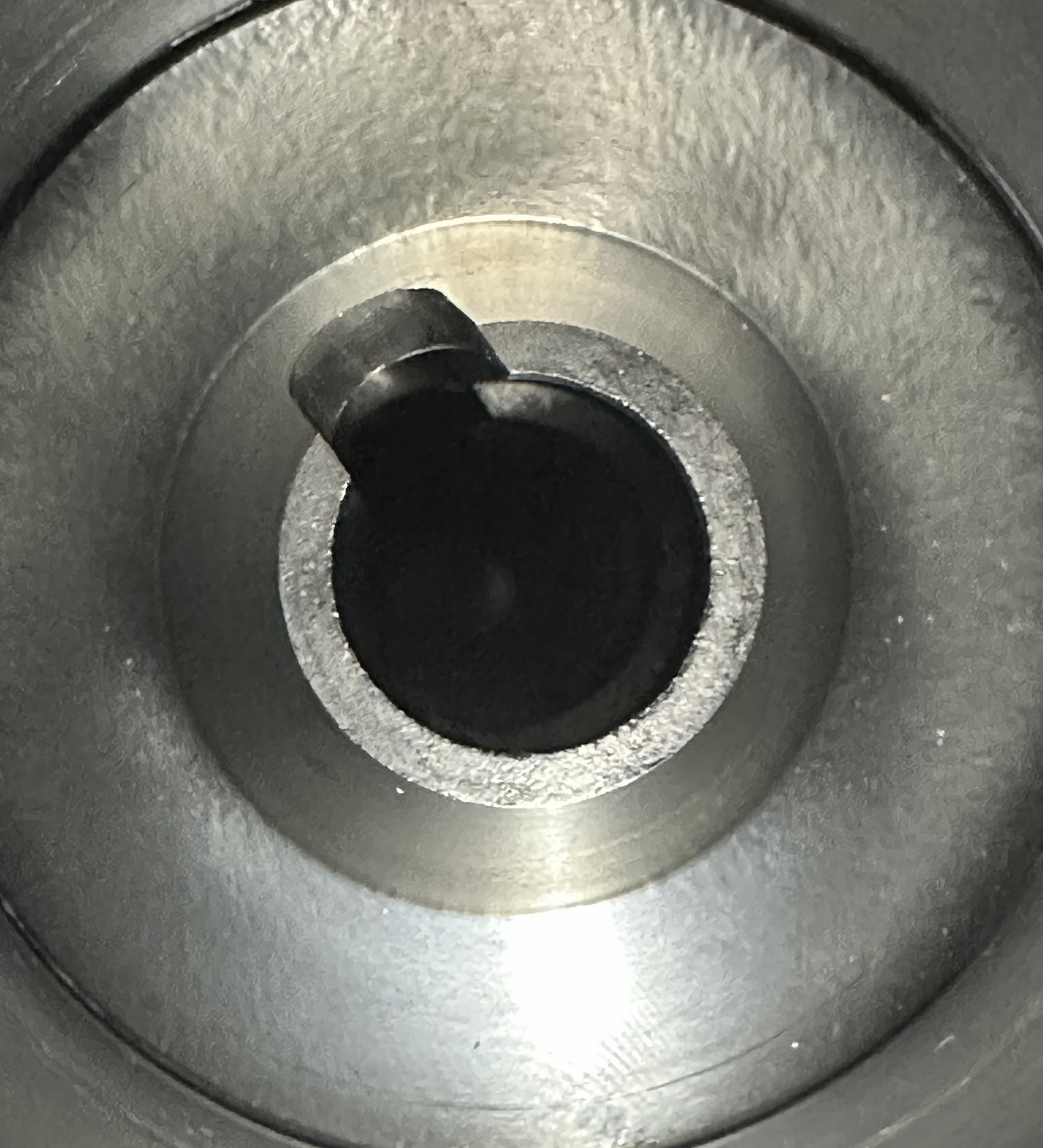

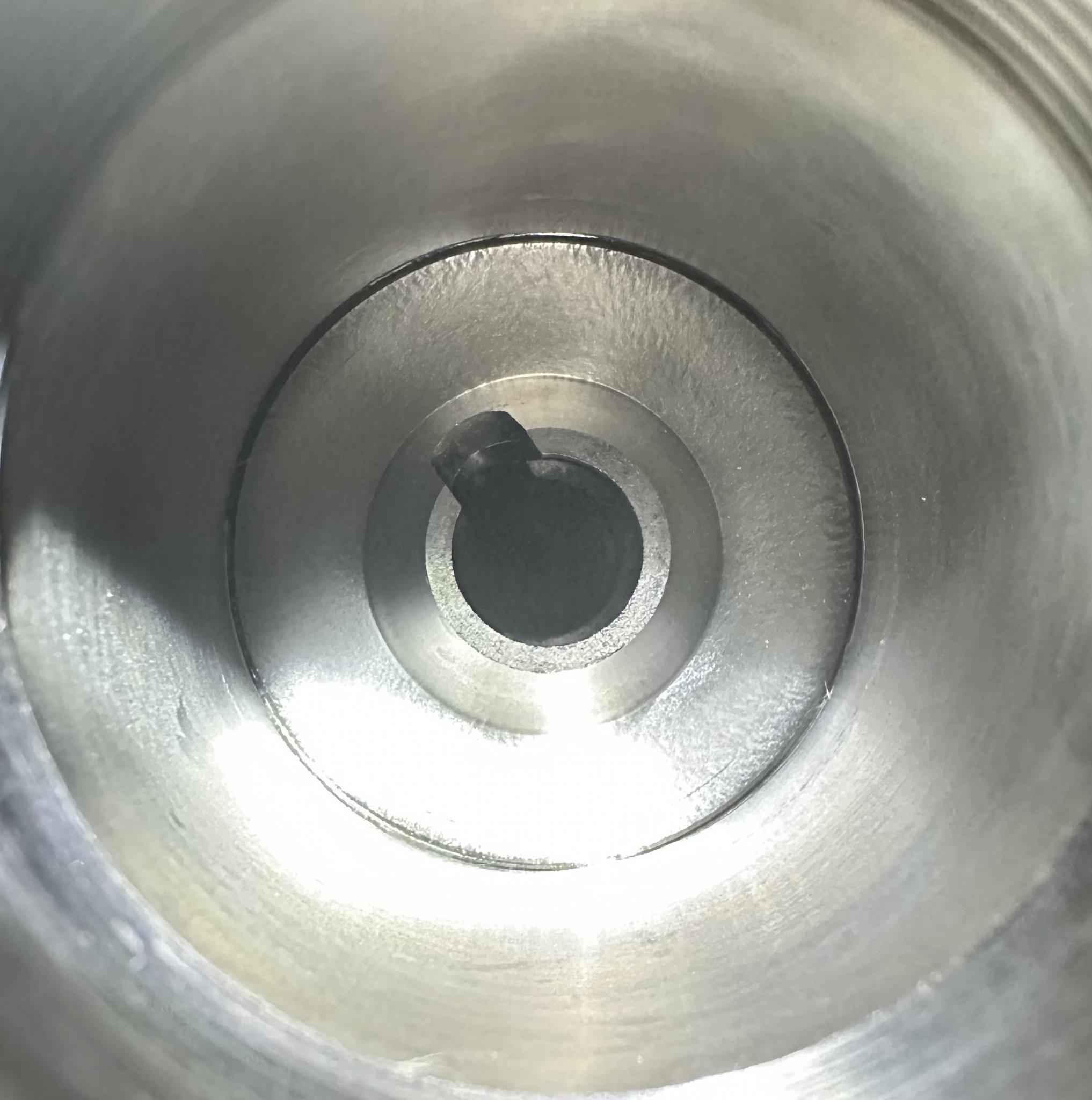

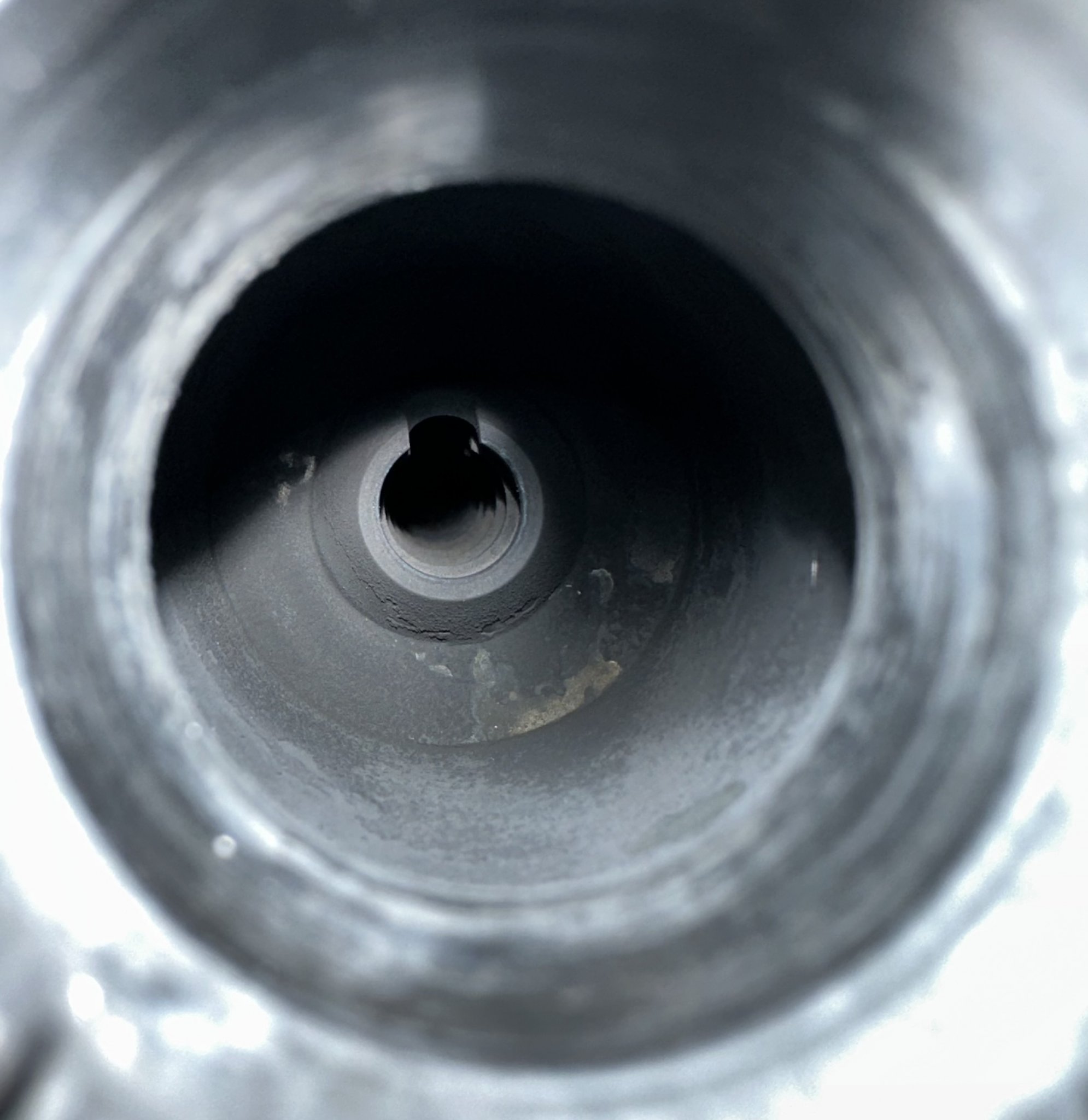

Otter Creek Labs Hydrogen-S 7.62 blast chamber before and after…
After ~2,500 rounds of various cartridges from .223, .300 BLK subs & supers, .260 Rem, 7mm-08, .280 AI, 7 RemMag, etc… The blast baffle still looks nearly new, with minimal pitting…. The OCL cans are legit.
View attachment 8182879View attachment 8182878
Straight clr for the stainless TBAC baffles?

Yup... That's what I did with my Obsidian 45 baffles (17-4 stainless). Soaked in straight CLR (undiluted) for about an hour. Then removed them, one by one, rubbed them with the scotch brite pad, and rinsed in hot water. If there were any tough deposits, the stainless brush knocked them right off. Then rinsed again, and dried with a rag and let them sit on a paper towel to air dry while I finished the rest of them. Reassembled using some C5-A copper anti-seize on all the threads of the can and o-rings, and she's like new.
I remember seeing some reports from TBAC on here about not using clr on the stainless baffles of the takedown. I’m sure a 15-30 minute soak won’t hurt though.
I have mine tore apart. Going to pick up something to try. Just haven’t decided what yet
Here is a copy/pasted response from TBAC I got back in December when asking about clr on my TBAC ultra 9 and takedown 22
“Good on the 9. You can shake it up a little. CLR on the stainless is not good. You can soak them in it for a few minutes and use a brush. Simple green Or any good carbon cleaner.”

That's odd they would say that... It didn't hurt the cerakote finish on my OCL can, and it was completely submerged in the 3:1 mixture for 90 minutes in an ultrasonic cleaner. I would figure it would destroy the finish, long before it would harm bare 17-4 stainless steel. But that's just my opinion.
Straight off the website... This is the stuff I use...

Also, just a heads-up, baffle #10 is a 2-piece. That little short piece on the end is the 11th baffle. It’s just kind of a bitch to separate them when caked and dirty. Might want to pull it apart and make sure it’s clean in there before reassembly.

Awesome catch. Thank you! Just got it apart and cleaned up
