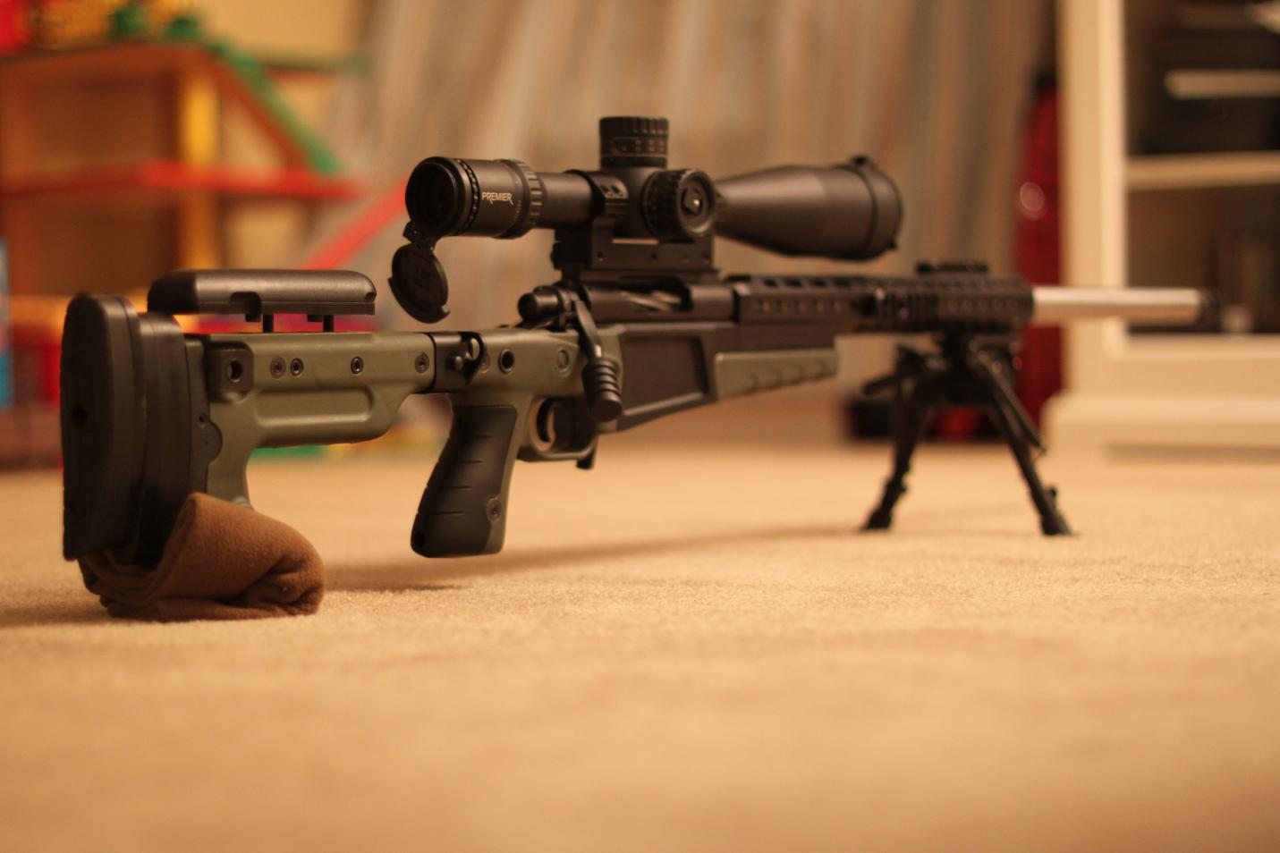

    No sales crap going on here. But wanted to convey that Marc at Spartan builds hammers from Valhalla :) Just got my .260 from him and the thing is awesome.
    Ok here we go. Most of the components I had already and Marc re-barreled/put it together.
    .260 Bartlin barrel 24", I don't know profile but lets just call it FAT ASS!, or super heavy. 1:8

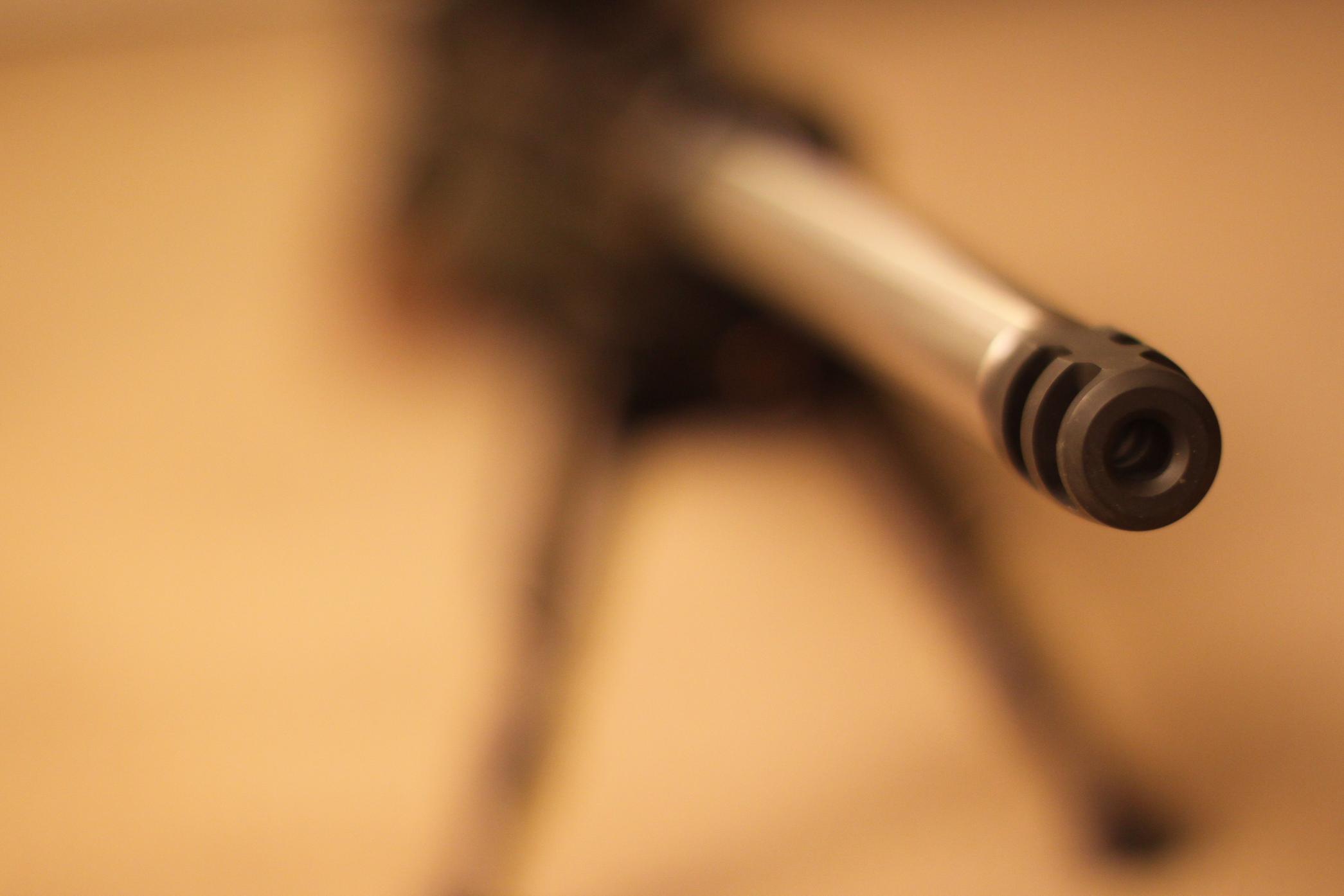

    Badger, Micro FTE. Now was gonna go with a RAD break but it had not come in yet but Marc had this one around, works really great

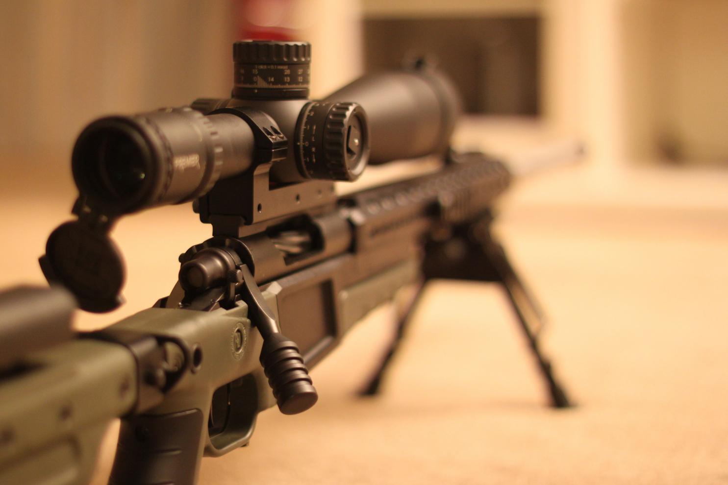

    Stiller action
    Huber Trigger 2.5lb
    AICS AX, nice adjustability, great stock for the price. AICS adjustable butt plate.
    AI 18MOA 34MM scope mount
    Premier 25 Gen2XR

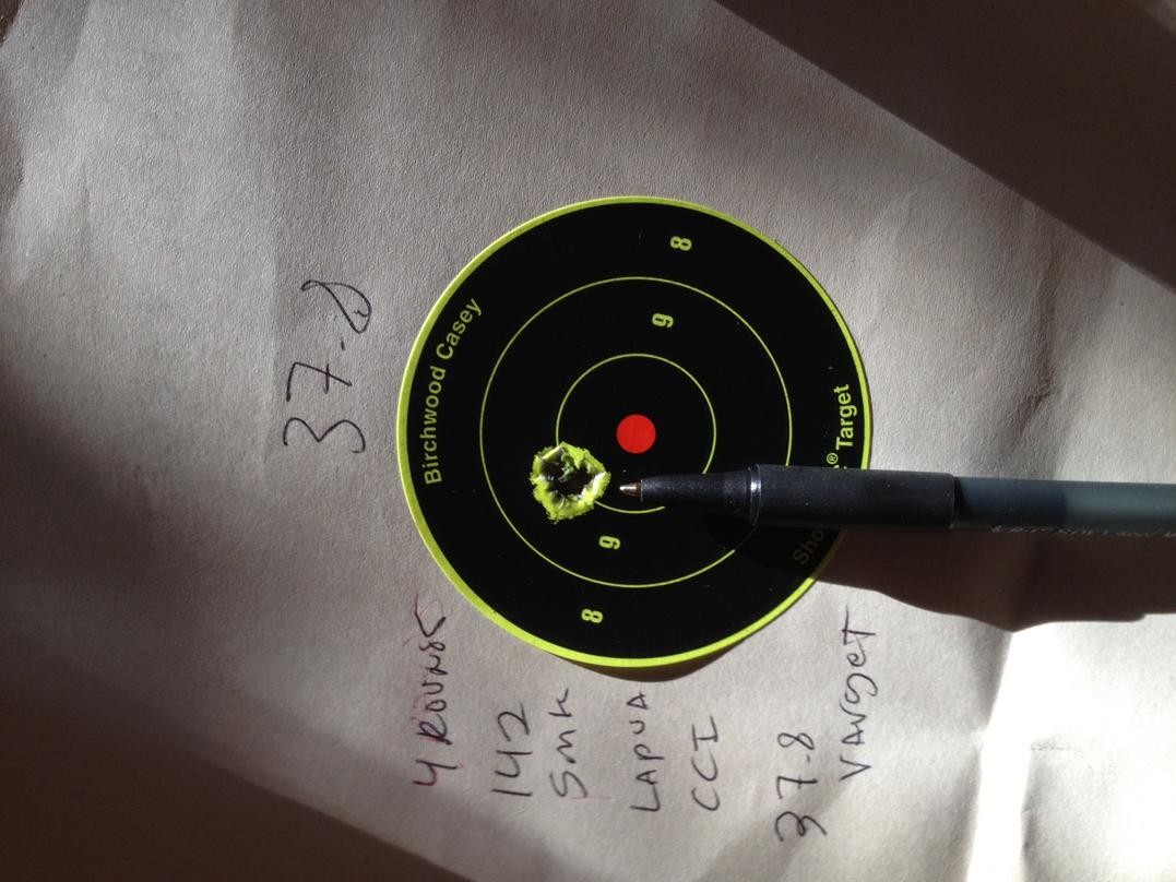

    That group was 4 rounds, I ran out otherwise would have gone for 5. That group was a 0.18 but that was the best obviously. Many groups are around .22-.35. I did have a shitty load in there at some point that was spraying 1.5in but when this thing is dialed load wise it runs ver well. Could you call it a 1/4 MOA gun. Well I would Like too but that is unrealistic I think. Is it a 1/2 MOA gun, I would be willing to put money on that.
    142gr SMK
    Lapua Brass
    CCI large rifle
    37.8 GR Varget
    2.840 OAL
    Ogive ????? ordered .264 comparator but not in yet
    2721 FPS MV Average
    7 FPS Standard Deviation
