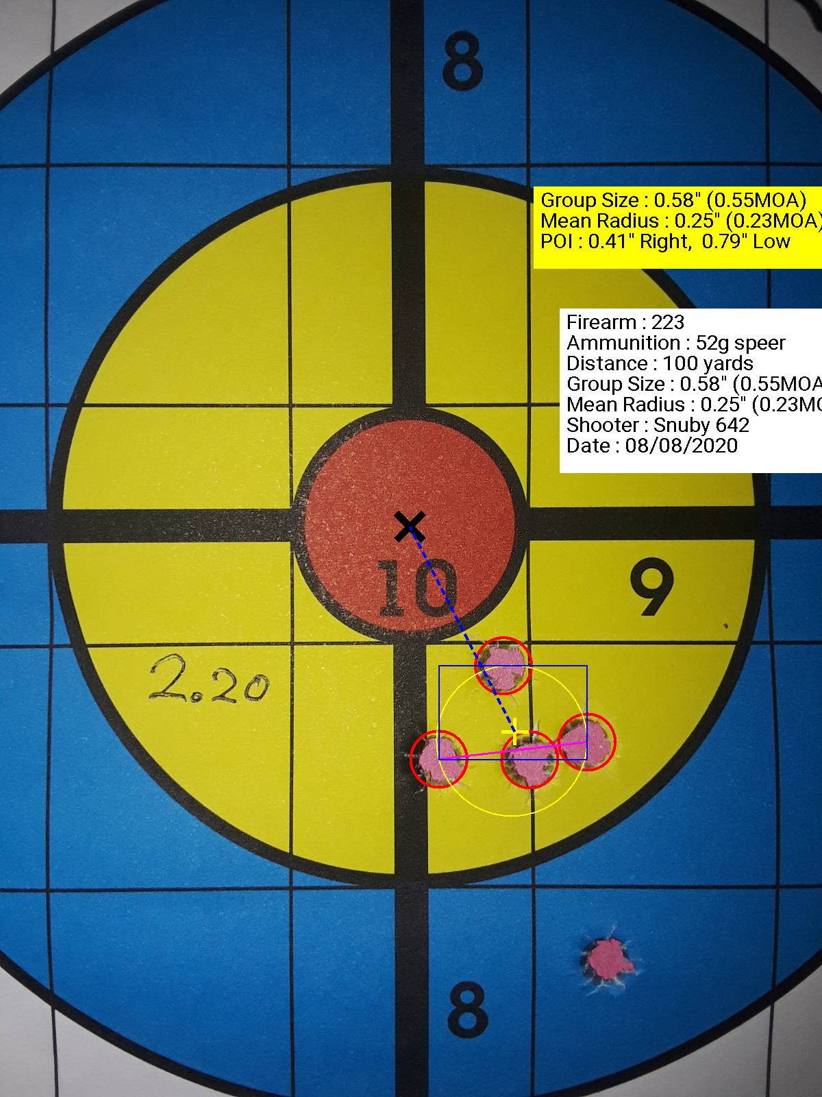

    It started out a random range brass attempt, changed to headstamp sorted.
    Moving coal from 2.200 to 2.220 improved group but 2.225 - 2.250 in 0.005 incraments did little else.
    At 2.250 I got vertical string.
    These were shot with a warm to very warm barrel as if plinking but way short of mag dumps.
    I think for economy not a bad load for short range ar.
