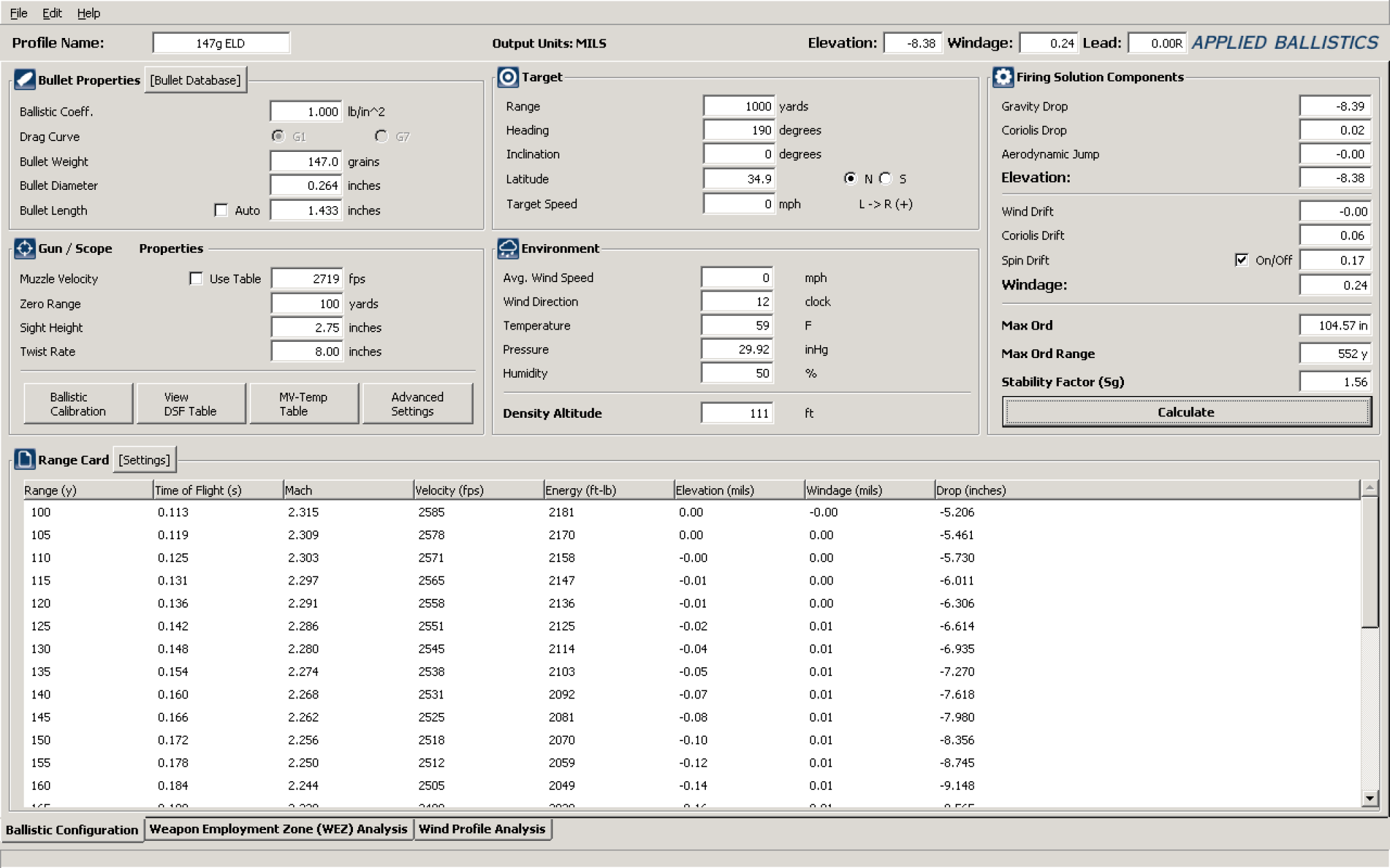

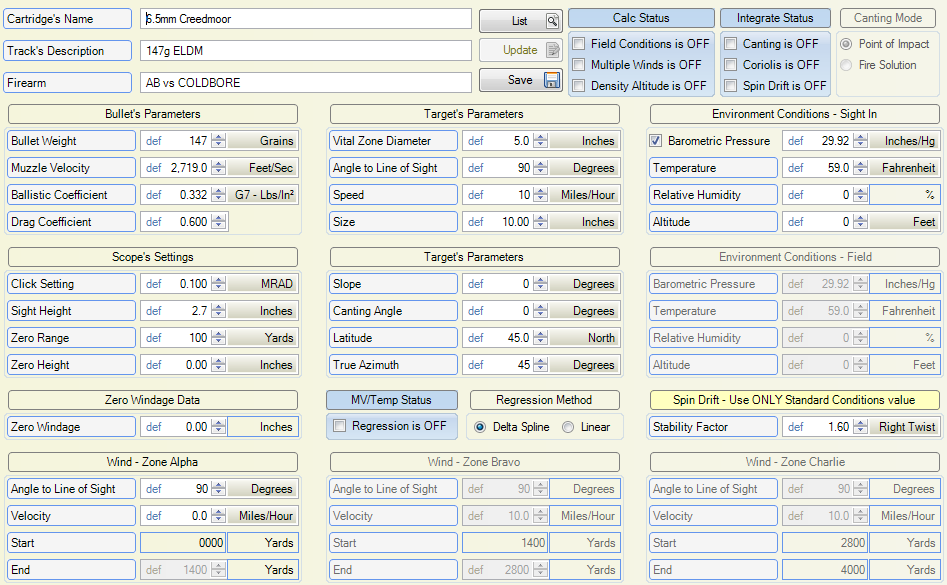

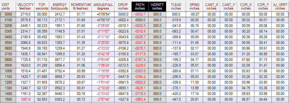

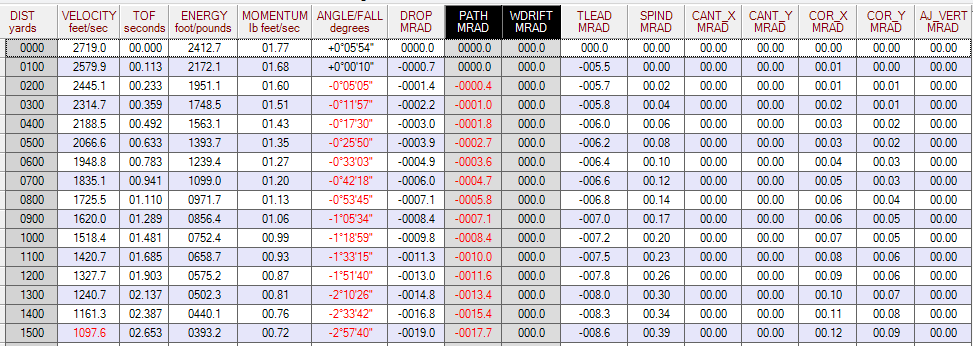

According to the AB solver SD for the 147g ELD at 1500 yards is 19.44", at 1000 yards it's 6.12" and at 500 yards its 1.08".
I have shot to 1,000 several times in calm conditions and the SD calculation AB is giving was spot on.

I noticed your ballistic coefficient is set to 1 .
Is that normal?
Will ab run on an Android phone?
I'm using AB's custom curve that's why it shows 1.0. Out to 1,308 yards, which is as far as I've shot, the elevation hold is dead on with the custom curve.
The screenshot I posted is from AB's desktop version of their app which works on Windoz or Apple. Looks like they've got an app for Android:
