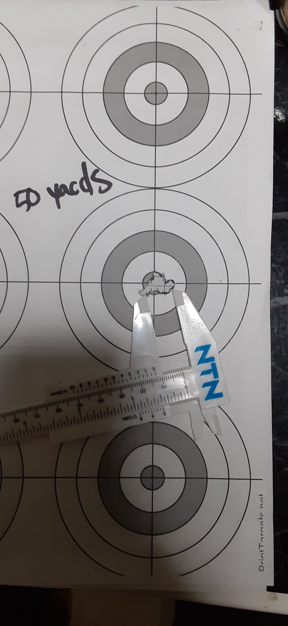

Hi
I am fairly new to precision rimfire.
Tikka T1x. Arken sh4. Sk match ammo.
50 yard zero. Area 419 20moa rail. Arken rings
I am grouping well at both 50 and 100 yards. My point of impact is dead on at 50 and punching one hole. At 100 yards I am my point of impact is .1 mil right of point of aim. Is this a normal amount of spin drift?
The range I shoot at has large berms along the side and gets almost no cross wind. Testing has been on multiple days at very calm weather no perceived wind.
I am just wondering if this would be a normal amount or if I should be looking at my scope mount or other setup issues.
I use this for prs rimfire matches

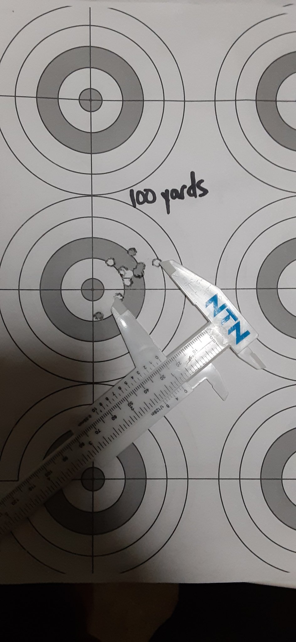

50 yard and 100 yard targets. 10 round groups
I would say the horizontal stringing is my skill deficit and the vertical is more indicative of what the rifle is capable of. On the 100 yard group I have ignored the bottom flyer in my measurement because I slapped the trigger and I knew it right away. Still doesn't change the center. Still 3/4 to 1 inch right at 100.
I can accept this but I will continue to investigate. How would I accurately measure the more center and scope tube to see if they are parallel?
