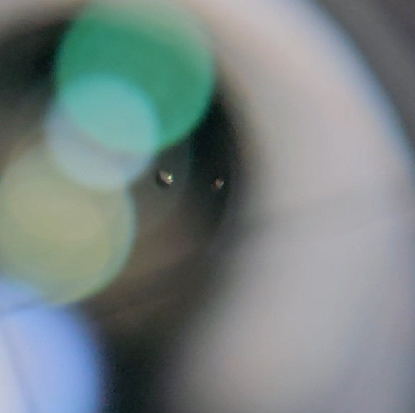

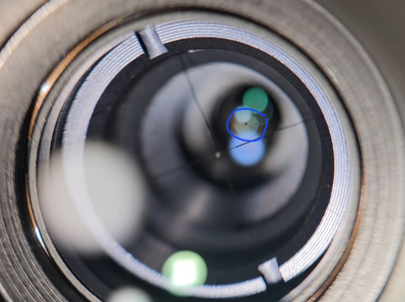

I picked up a Leopold VX-5HD, and I took it out for the second time this morning. After the day was done, I noticed something new. When I zoomed out, I noticed spots in the sight picture. I figured I'd clean the objective lens, and it'd be all good. Of course, it couldn't be that simple. After further investigation, it appears the spots are on the same plane in the scope as the reticle. The spots we're not there before shooting, and are only visible in the 3x-~5.5x out of 15 powers. There are a total of 7 spots, I could only really get a picture of 2.
My question here is do I need to send this in for warranty replacement? Or is it something that will go away?

My guess is grease spatters from the erector mechanism, so probably won't go away. S&B had a few with this problem when they tried to switch to a lighter-weight grease for better performance in sub-zero temps. In warmer temps it is too thin and will splatter when the turret is cranked. I was "lucky" enough to get one. It's only visible in the lower magnifications (under 10-12x on a 5-25 PMII). Since I'm usually above that it doesn't bother me. But the barrel on that rifle has a high round count and when it comes time to re-barrel I'll send it back for them to fix it under warranty.
