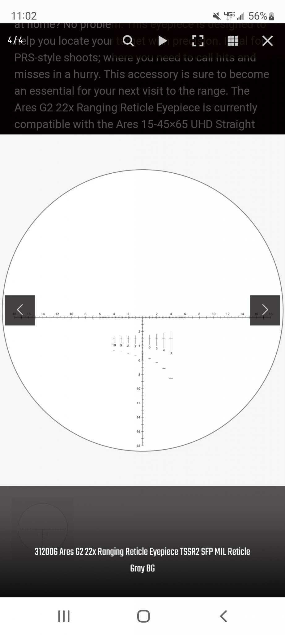

    So I am looking at getting a spotter with reticle, I'm giving the tract toric a real hard look. Their reticle is like so
    other spotters like the Lmss2 have this style
    shopping
    So my question is when using a spotter for elr with the open reticle do you see the splash and try to extrapolate the correction? And with the bottom reticle do you overlay over the target for a more exact correction?
