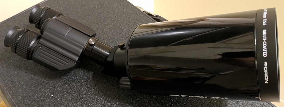

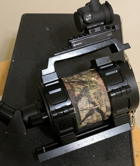

I'm upgrading my spotter with a binoviewer, rings and an MRO finder:
I'm not sure how wide angle it is and magnification is hard to calculate due to the Barlow but I'm thinking about getting some 20mm focal length eyepieces with 70° apparent field of view which will hopefully work well at 1,000 yards+.
The rings still need some work to fit and an ARCA rail instead of Vixen.
This on a gimbal mount (Whimberly copy) is a nice low fatigue setup that is easy to balance and aim.
A couple notes: you need an erecting prism or else your images will be a combination of flipped and/or reversed and I can't tell you where to get a scope like mine. It's a 90mm Maksutov Cassegrain with 500mm focal length, Chinese, sold under several brands but only available used now as far as I know. Other Maksutov Cassegrain scopes are available but most with much longer focal lengths and longer tubes (less portable). My binoviewer is an Arcturus, I'm using the 1.85x Barlow and I also got a Lacerta T2 hybrid erecting prism for it (not shown, highly recommended). The rings are Explore Scientific brand made for a 102mm refractor but fit my scope perfect after removing the felt padding that was lining the rings (the adhesive removal sucked).
