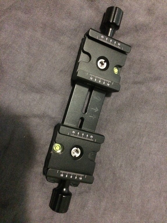

I got lotsa compliments and people asking me if they could take pictures of/did I sell the spotting scope and LRF tripod mount that I was using this past weekend at the Snipershide Team Cup. I figured I'd put up some pics and details on how to make this pretty useful and super simple adapter. Basically it's a 6" ARCA (male) plate that I attached 2 (female) ARCA receivers to. I have a tripod adapter for my Kilo 2000 that a friend of mine 3D printed that has a male ARCA dovetail on it and I put another male ARCA plate on my spotter. I then lined them up so that when I got on target with the LRF, I could transition to the spotter and already be on target. It's not an absolute co-witness but it's enough to get you on target and works for me. The nice thing is that with all the ARCA plates nicely torqued down, you can take the whole thing apart and pack the LRF, spotter and adapter separately then reattach them and maintain co-witness. Here's some pics:

Yup, good setup. I haven't done the side by side, but it's a good idea. I have created some odd setups using generic Picatinny rails, Arca rails, Arca bases, etc. I just got a new rail today, am gonna try to get a laser pointer/illuminator on one of my setups, need more rail space.

Glad you found your part and it worked out well. Nice setup indeed.
I was looking at a similar solution but yours is FAR better than the cheap side by side solution I was looking at. You can get a bar with two 1/4-20 studs about a foot long where the studs can move closer or father apart. Basically same thing you did but MUCH simpler.

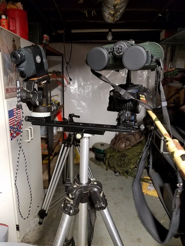

I'm going to try a slightly different approach using a Nodal rail, leveling base and an Arca style clamp. The Nodal rail has a built in Arca clamp, then the leveling base will mount to the rail and the clamp to the leveling base. Plan to use the spotting scope or binos in the Nodal clamp and LRF on the leveling base. Theory is to be able to adjust / move the LRF separate from the spotting scope or bino's
