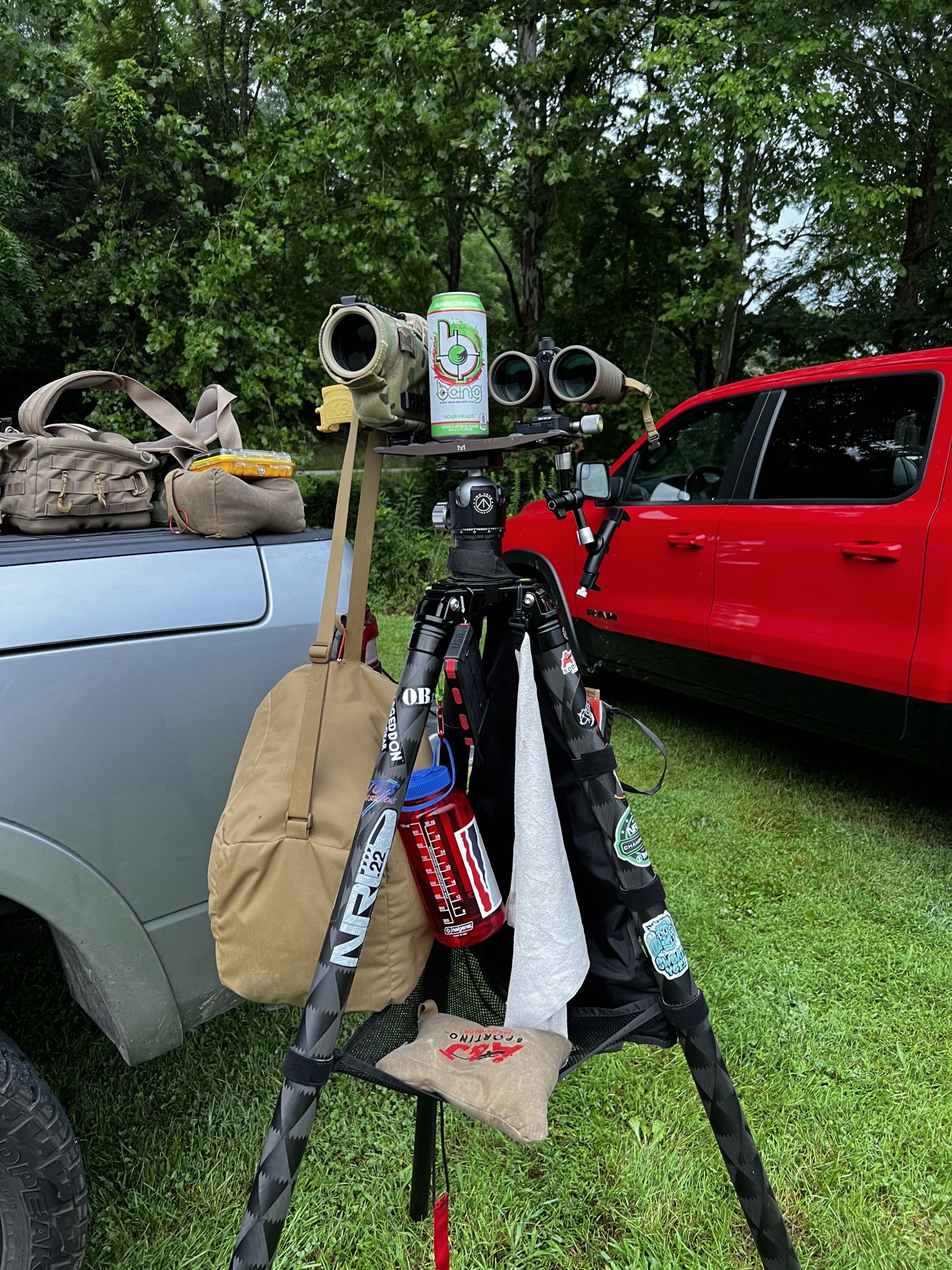

I've largely transitioned to a Swaro 15x bino for everything from long range glassing, to spotting, to RO'ing. I get way less eye fatigue, way more FOV, better depth, and I can see trace better. A reticle is nice but not necessary in all situations. I really don't pull out a spotter unless I'm making a decision about whether or not I am about to go for a hike.
