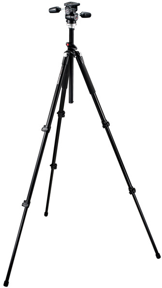

Amazon has some decent deals on Manfrotto and heads. They work just fine and some can swivel so that you can see prone. Classic stands like the Giraud Spotting Scope Stand can cost more, but offer a different options.

I have the prs medium tripod and the manfrotto 055 with 222 head. They are both good tripods but the manfrotto is a sturdier easier to use setup. The downside is that it is much heavier. What are you wanting to do with the tripod?
I have a manfrotto xprob. It's sturdy. I just got back from a class, and my only issue with it was how much ground the base covers when trying to get low. It made it difficult to get into a good spotting position next to the shooter. Running up high, though, it worked great. I have the 322RC2 head, and it works OK. It seems like my spotting moves after I release the joystick grip when I think it's in position. It's probably user error as I've never used in before.
I too use the PRS tripods (medium and small) because they are easy to pack (lightweight and VERY compact), but for a dedicated spotter that I'll be running all day for an event, etc., I go to my Manfrotto 055XPROB with a 322RC2 grip/ball head. If you don't need QUITE that heavy-duty, the 190XPROB is another good option. Furthermore, there are multiple similar tripods in the Manfrotto lineup that don't offer the horizontal center column of the XPROB series tripods which are a little lighter and cheaper...again...depends on your particular needs/wants as to what features/price point you want.
