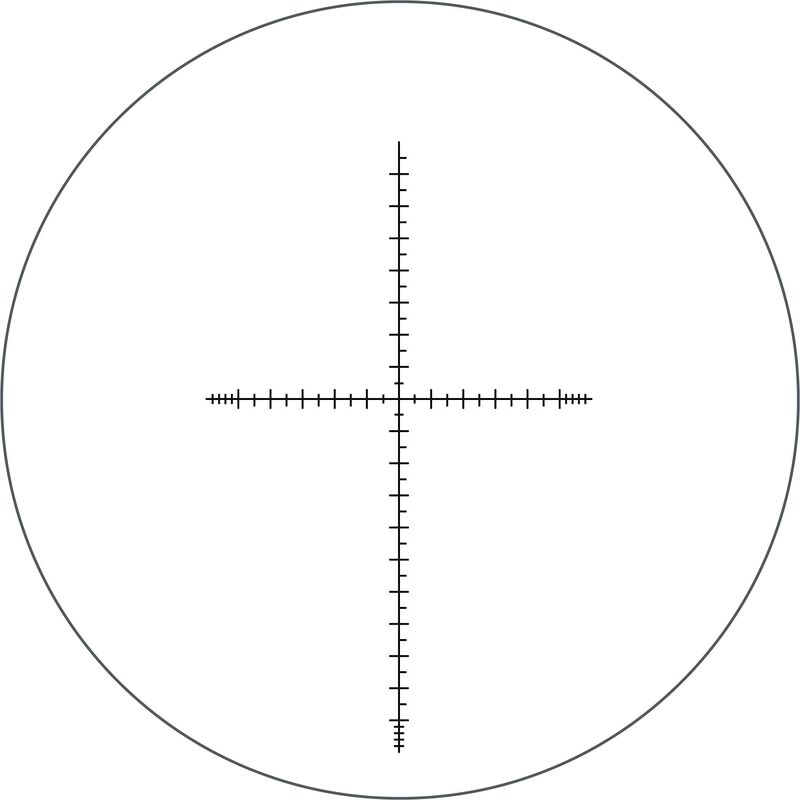

FWIW I just *had* to have a spotter with a reticle. I got the Bushnell Legend T-Series with this reticle:
For spotting at matches or with other shooters there is almost always a fixed size target that can be used to give corrections. Also there is usually more than one rifle with a mil reticle in play when spotting that can be used to spot.
What I am getting at is the reticle has not proven as useful as I thought it would be. Nice to have, doesn't really get in the way, but it doesn't come in handy that often for me. The one time I remember putting it to serious use was clocking a mover at a match before a stage. With no actual numbers on the reticle trying to count off the number of big, full mil stadia hash marks the target went by was not that easy.
Just my experience/opinion. I like having a spotter for a few things but the reticle wouldn't be a deal breaker either way.
