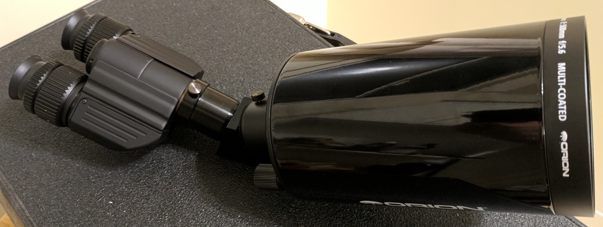

Thats what I use. The binoviewer is a new addition. It seemed to work fine at 66x with a single eyepiece.
I want to try slightly lower magnification with the binoviewer.
