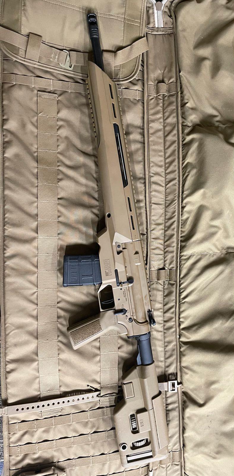

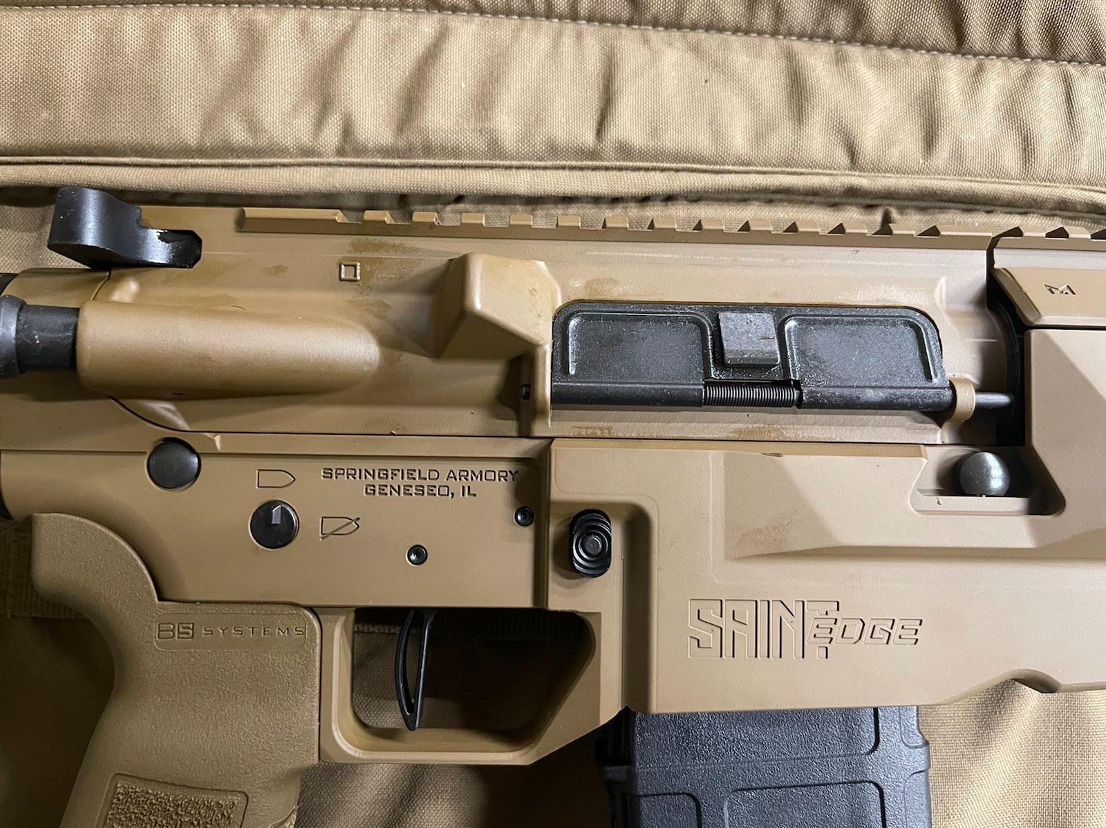

    Here is a quick review of the Saint ATC Elite from Springfield Armory.
    Why This Gun?
    I was always fascinated by the Drake Athena Chassis...and also horrified. Would this be the biggest waste of time ever or what?
    The claim to fame was that nothing touched the barrel nut at all...which is also something that some other companies now do in a lower profile and more traditional package.
    I wouldn't be here at all, but you see I have a dark secret... I like the HK91. A lot. Sexually. And an AR that shared some of the looks of the HK91 with a bit of a potential boost in functionality? Why the Fuck Not!?
    Street price was $1650. I have toilets that cost that much. I was in.
    TL-DR
    Fuck you! Read my shit. Enrich your brain!
    I mean, accuracy testing is still out on this thing, but I really like what I see.
    SA missed an opportunity with not going fluted on the barrel, and I'll probably drop a Ranier Ultra Match in there to shave off about a pound. Same thing with the barrel nut, it sucks some. Wasn't really meant for this gun.
    Every control but the trigger sucks ass and is getting a replacement.
    The chassis is machined SUPER good. And the H-250 Cerakote is a great color and fixes the problems with the upper being 7075 and the lower 6061 and looking weird.
    I will likely use this as my testbed for barrels in the future cause its easy to change shit on it, and when you swap uppers the optic is still zeroed.
    I suspect mounting stuff on its mlok interface is gonna suck badly. Badly.
    DICKS AHOY!
    First Glance
    Its a sexy little bastard. I'm gonna say I really love the colors. Well, color. The stock and grip match it as well as any gun I have seen ever.
    Bottom of the handguard has some junk in its trunk that breaks up the solid outline.
    SA's muzzle break seems pretty good actually. Like a SF one but with some compensation. Also, you can smash someones face in with authority if you place the muzzle in their mouth and then hit them in the chin with these serrations. It looks good, but WTF?
    I know...no pink right? She has her underwear on you sickos. Square forge (BAFE) standard USGI upper.

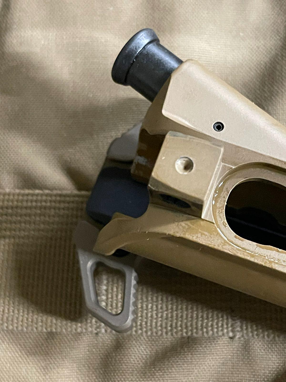

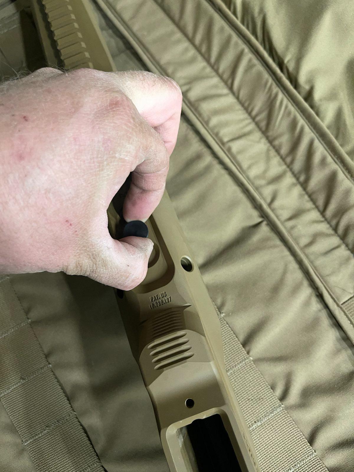

    Cocksucking USGI carry handle. I held back - you don't want to know how I really feel about these.
    Decent QD style end-late. Non-ambi safety, just in case you need to die when needing to switch hands. The castle nut is staked.

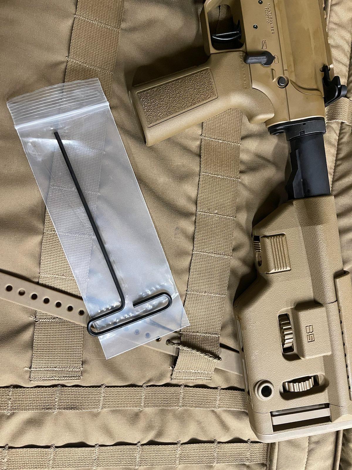

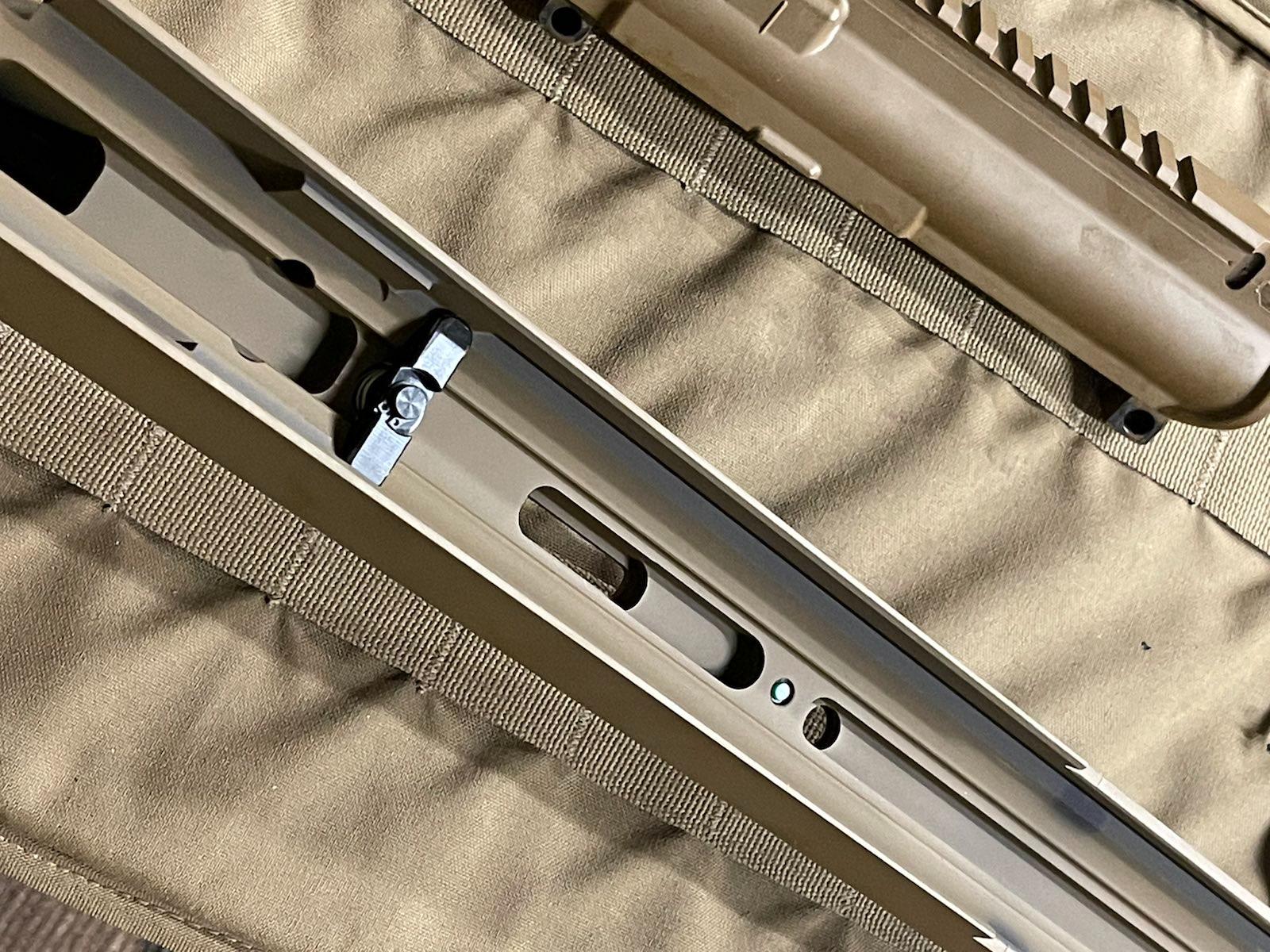

    GETTING SCREWED

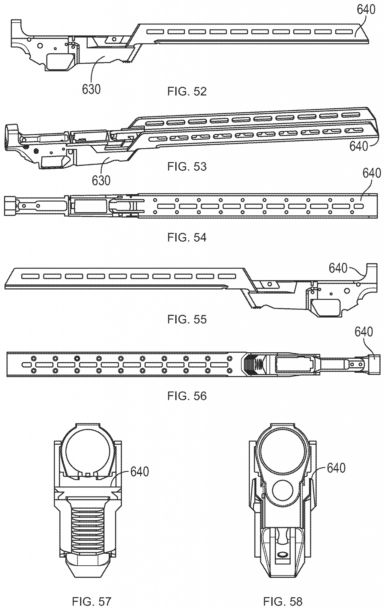

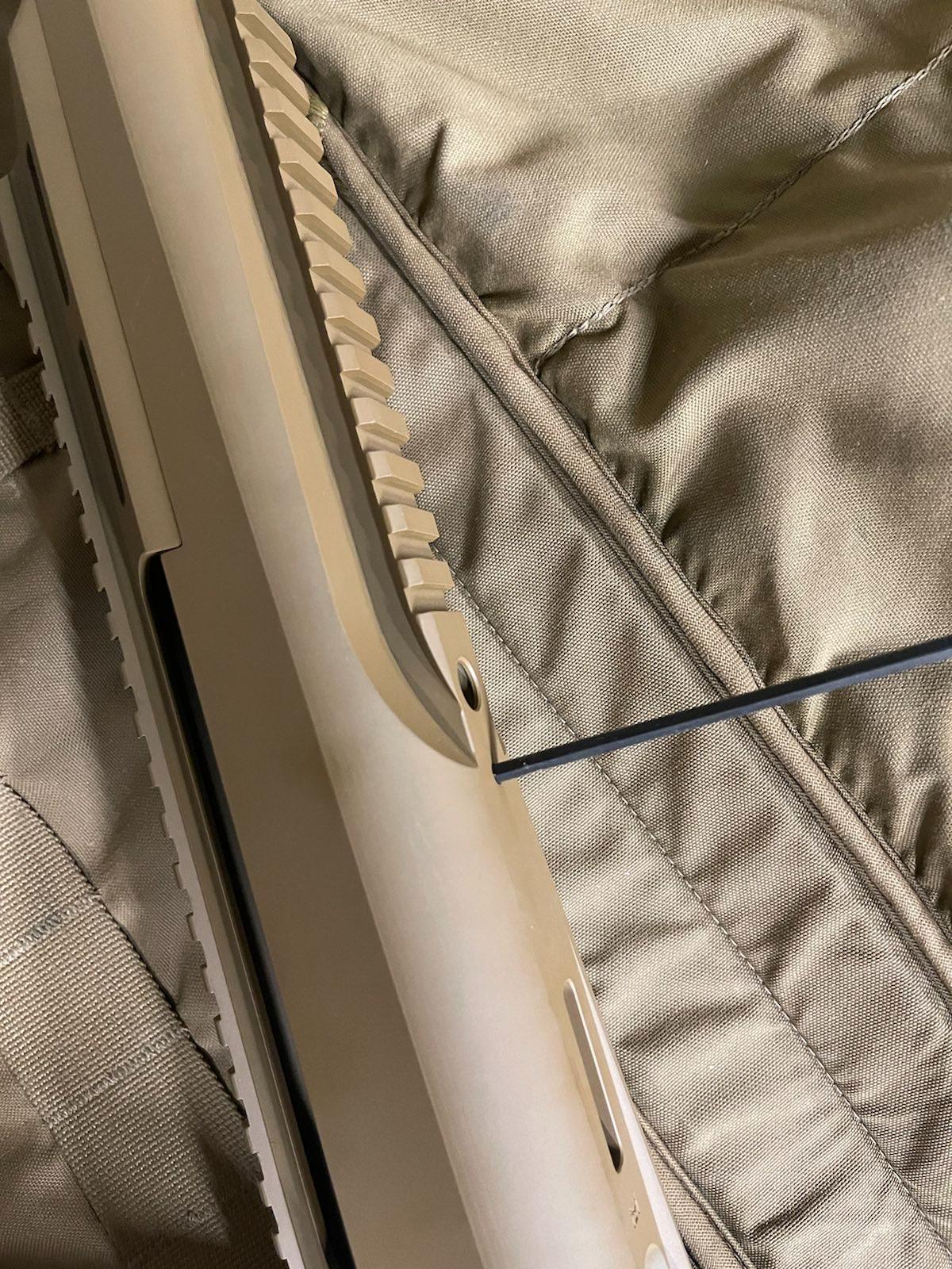

    The SA gun includes a multi-faceted locking system that holds the upper and the front rail in perfect alignment. This is the part of the technology I'll be looking at the most, as frankly it could wear out/suck badly or be perfectly fine.

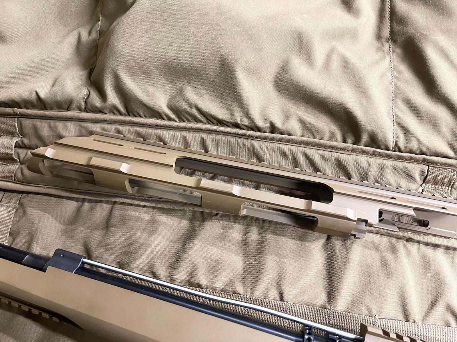

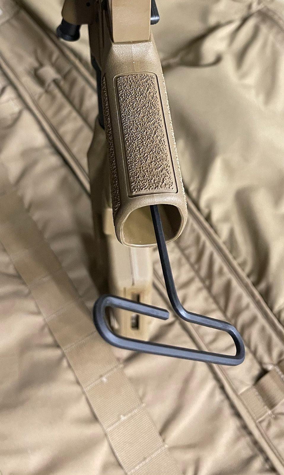

    DROP THOSE PANTIES
    Reach down and grab the SA's draw string and they come right off.

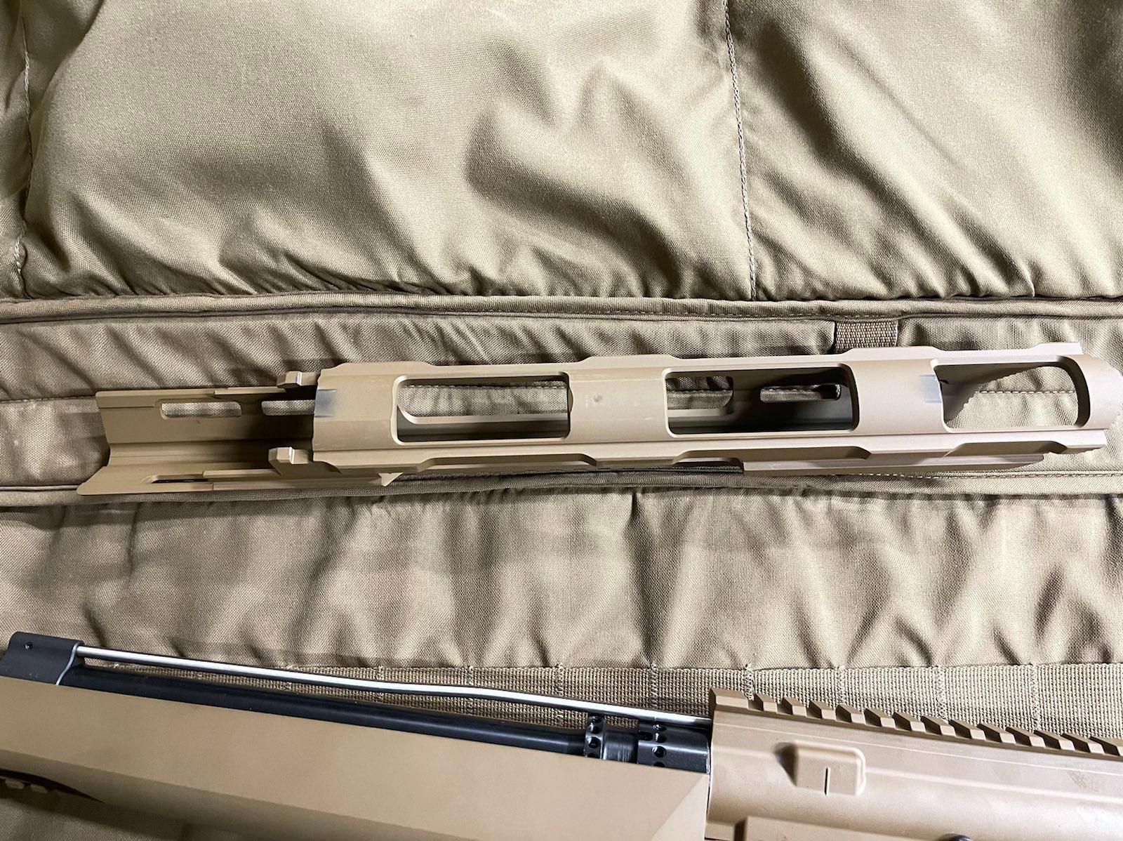

    This upper rail section thingy is a work of art.

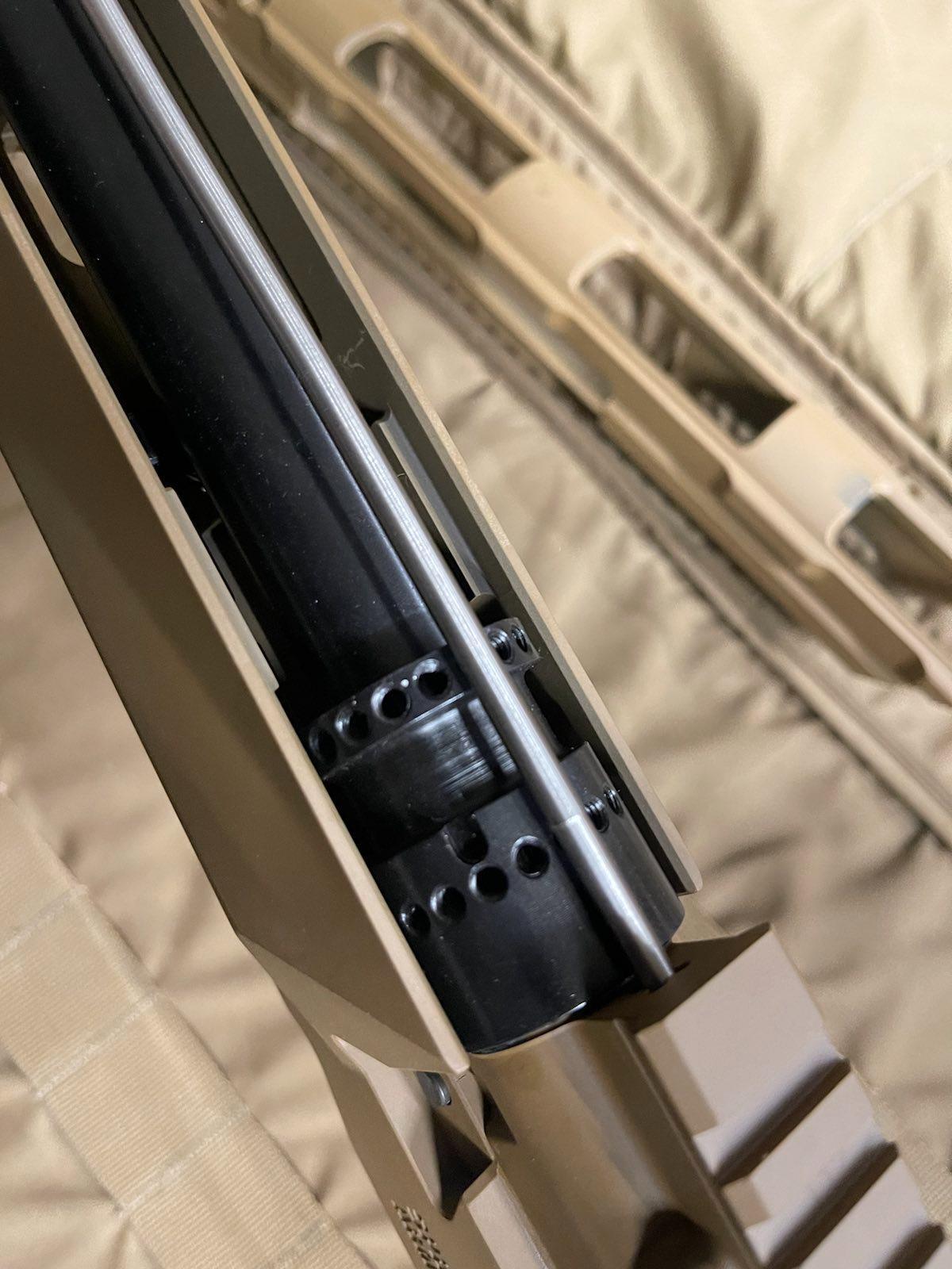

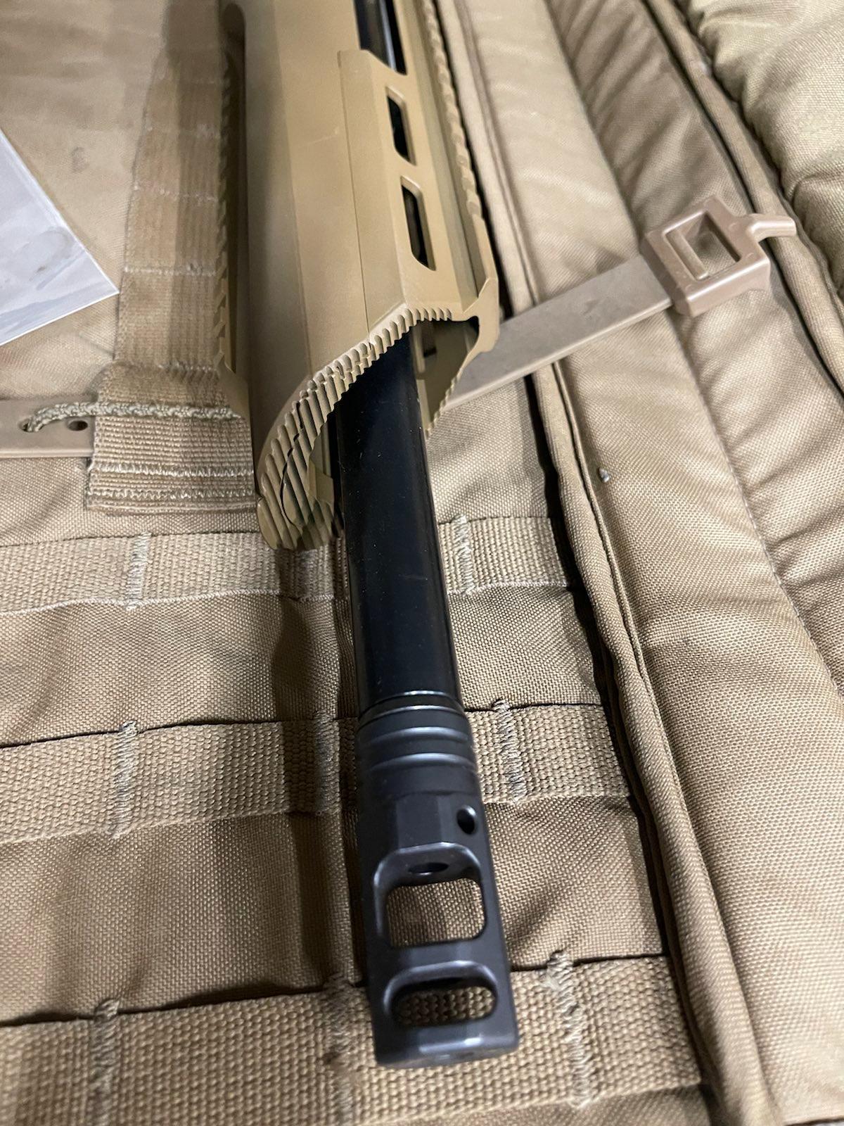

    BA Heavy Profile SPR Barrel. Jesus this chick needs to lose some weight here. Way to get your barrel nut from a bankrupt tractor factory, SA.

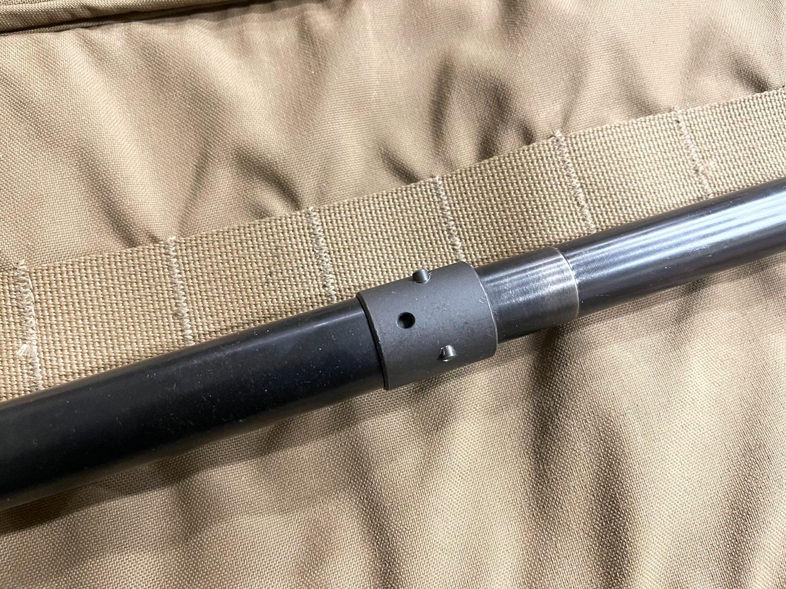

    I suspect this gas block is going to be on there. A lot. Like the nitrocarb is fucked up from the factory putting it on the first time.
    I like pinned gas blocks. Reliability usually oozes out of them.

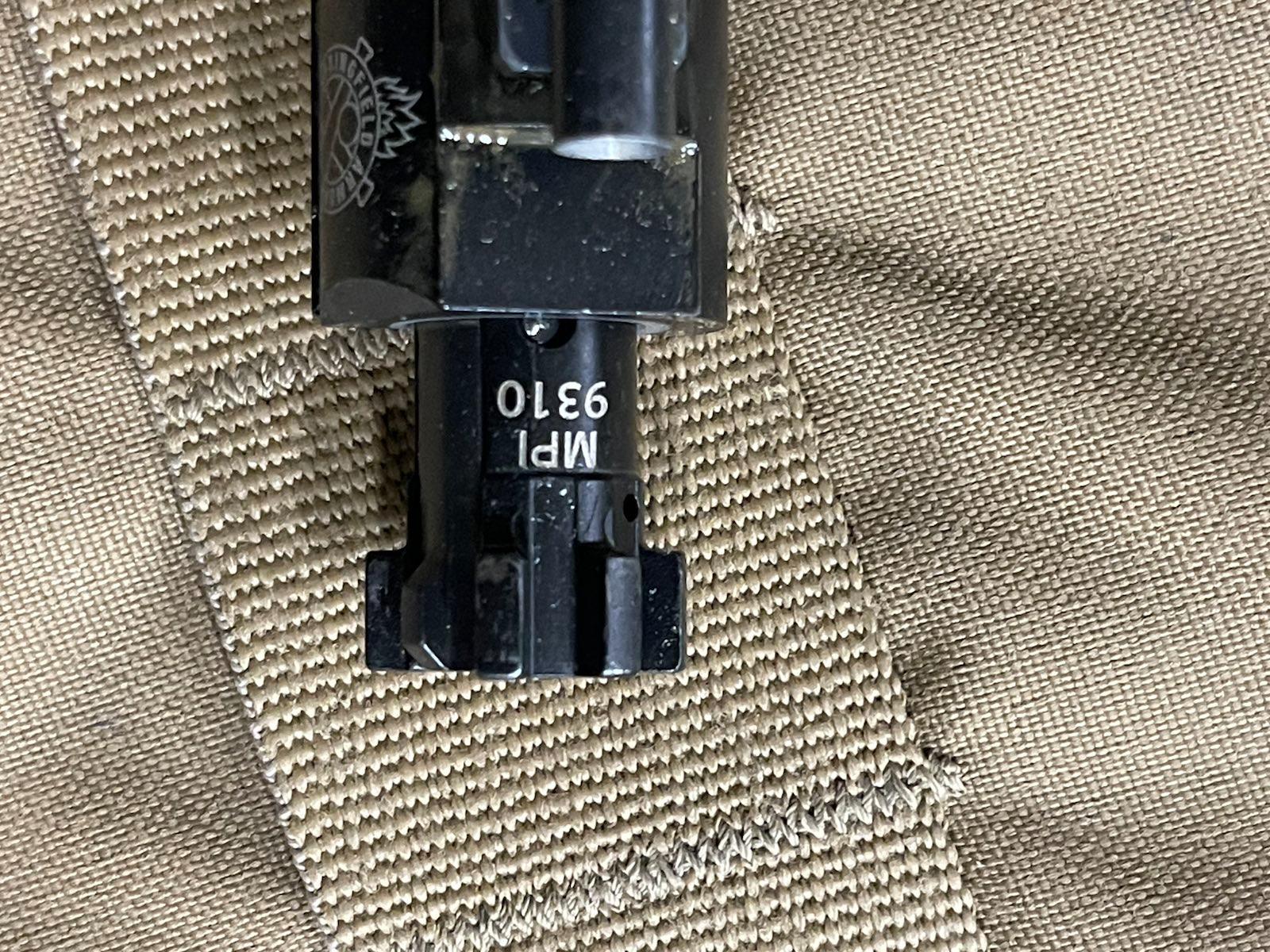

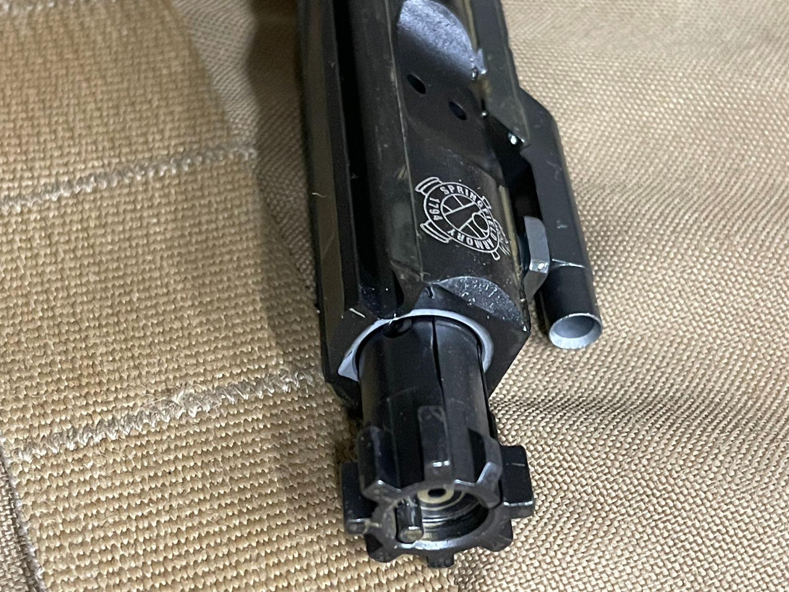

    MPI 9130 bolt doesn't suck. Nice chromed bore as well. Looks like a Nitrocarb finish and decent staking.
    Side note - how many fucking test rounds did you fire SA? I'd like to have some barrel life left you know.

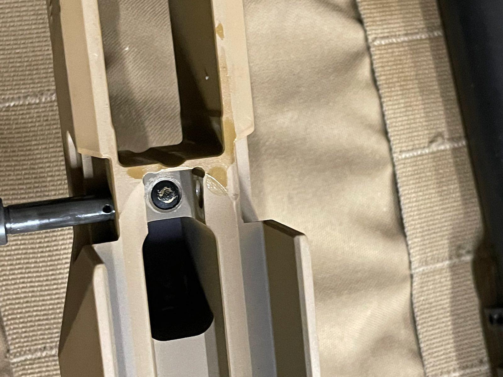

    MORE ON THE LOCATING SYSTEM

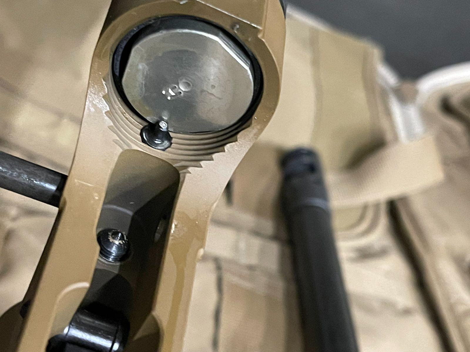

    These are part of the upper/lower/rail locating system. Man they work good too. This thing is a rock when you tighten it all.
    Check out the lock on the chassis upper rail...Its made out of depleted uranium with an outer shell of neutronium, held in place with the jack from a FMTV. It smacks of lightweight efficiency.
    If this gun works out, I'm gonna make several uppers that go in it. I'll have to duplicate these dimples, but thankfully the lower will make a perfect locating mark when you slap the undrilled upper into it and tighten.

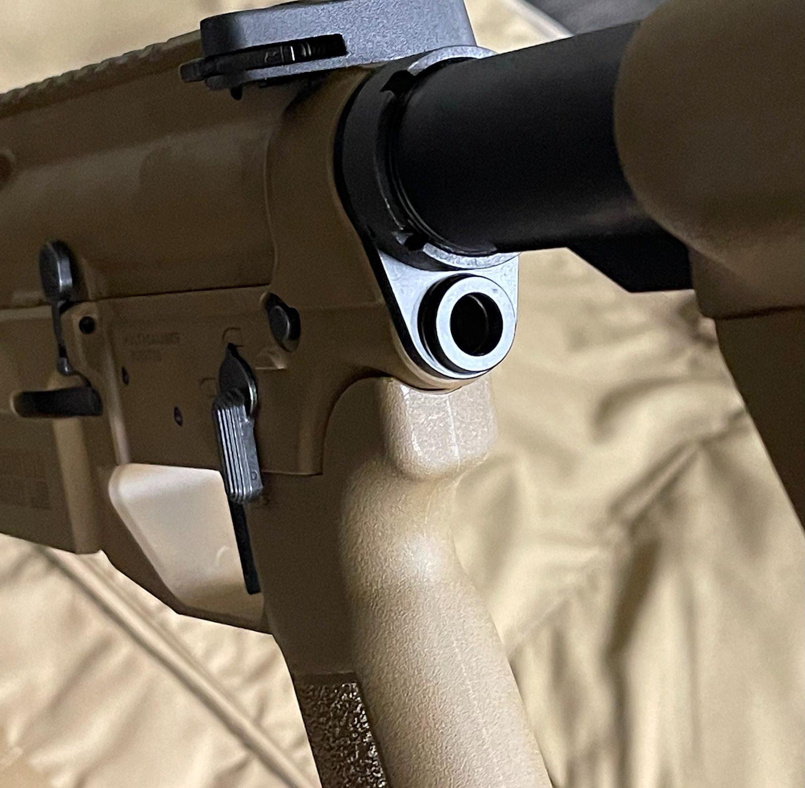

    H buffer. Runs smooth in the tube as well.

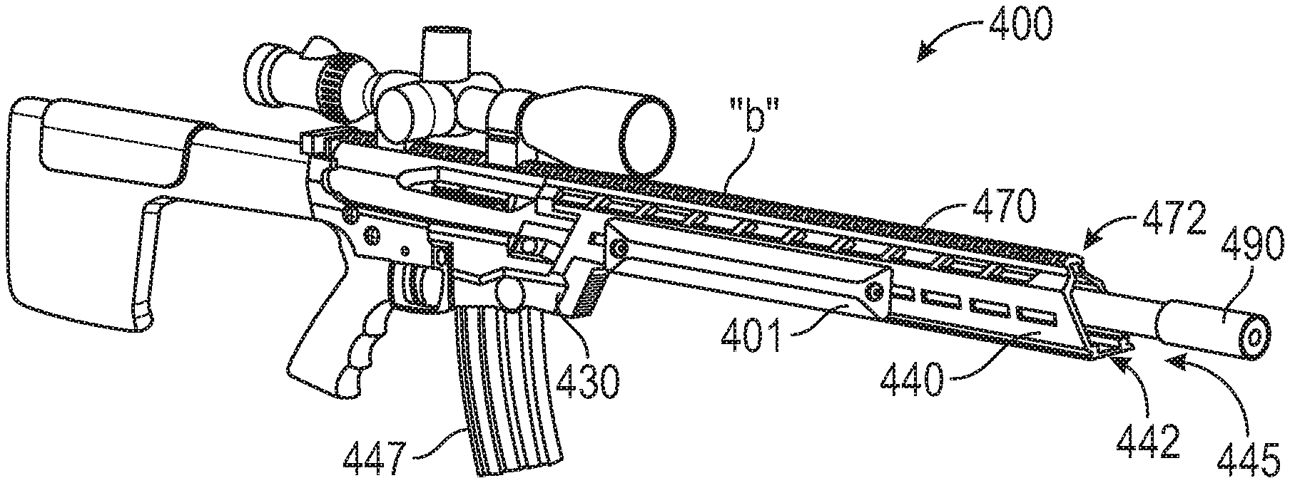

    I was a little disappointed to see the one MLOK slot on the bottom and it doesn't look like you'd be able to mount an ARCA plate on there anyway. If you wanted to mount this on a tripod it appears you'd have to go with a convoluted set up with a small pic rail and then an adapter set up to go from the pic rail to ARCA.
    Reactions: Hypervigilance
    I shot arca setups for a long time. and then I realized that there was a lot to like with the HOG saddle. Like not having to put the arca rail weight on the gun, not having to figure out which of the arca setups...blah...blah...
    I also liked the ability to transition to a nearby target even if my tripod was accidentally locked hardcore. The Hog gives you a little flex.
    I see your point for sure. I've got an ARCA set up on most of my rifles but there is something about it that's a bit annoying. I'm toying with using my game changer on top of a homemade tripod table so it'd be something a little more universal.
    Not with a RRS BTC style clamp, like the one on an Anvil-30. Those clamp to both Arca and Pic rails, so you'd only need a short section of Pic rail mounted into that m-lok slot.
    But I agree, a flat bottomed handguard with integrated Arca would be preferable.
    True and I have the BTC-Pro on my Atlas to go between the two but I was thinking more generally, not everyone is running Anvil-30's.

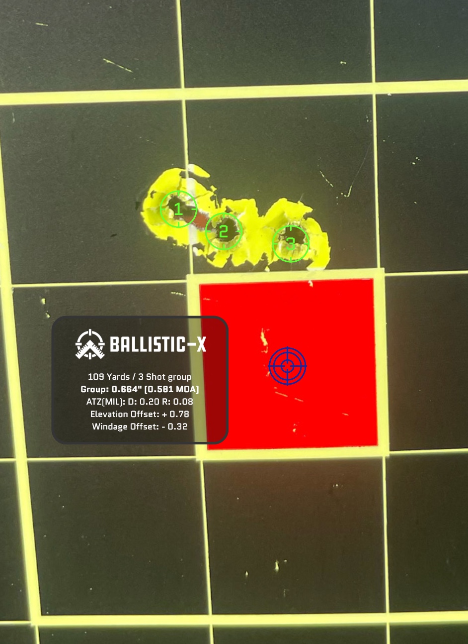

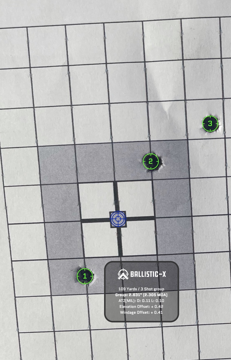

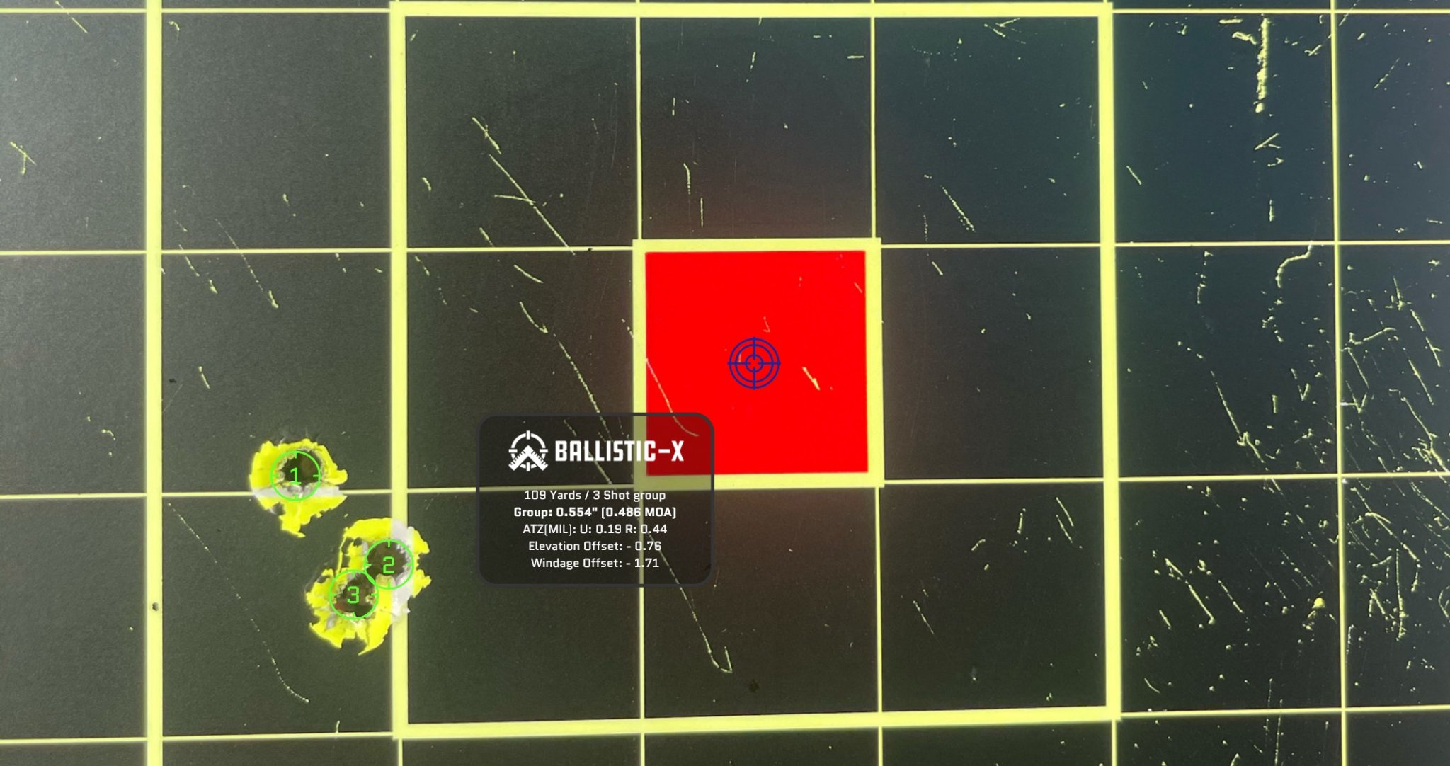

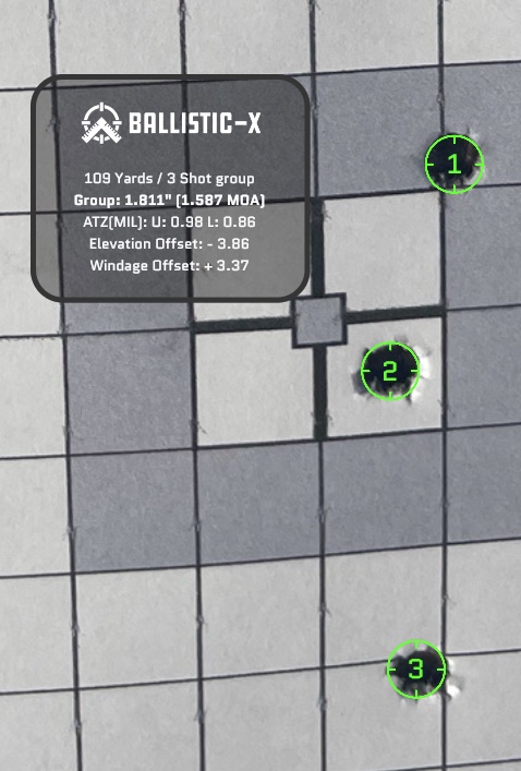

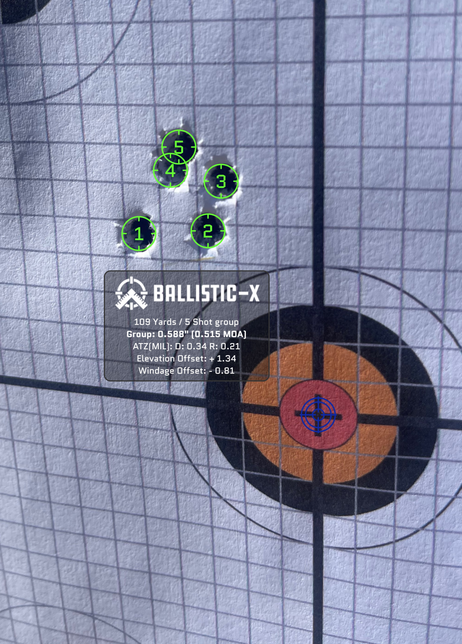

    Shot first groups. Hornady 75GR frontier - not the best results. 3" Switched to 77GR MK262, got a little better. 1.5"
    75gr Hornady 556 Superformance was the best round printing a .8 group. Second group was 1.1" at 5 shots.
    I'm not taking pics and posting them on this yet because the throat is still burnishing in. I'm going to clean and fire 10 boxes 556 ball in 40 round intervals and then go back to accuracy testing.
    I have found that most barrels in AR's want some rounds before they perform the best.
    I've never had good results with Hornady 75gr Frontier but I shot some 55gr HP and 68gr Match that did well in a few guns. SA said they've had good results with Federal 77gr GMM out of the ATC's. I have some of that and 69gr GMM that I'm going to try out when mine comes in.

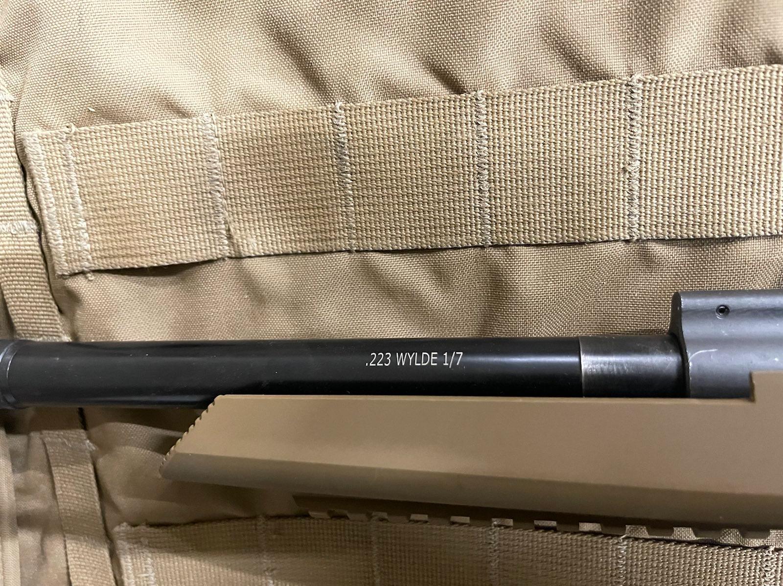

    Looking at the product page, LaRue trigger and Ballistic Advantage barrel. Guess that explains some of their availability issues recently.

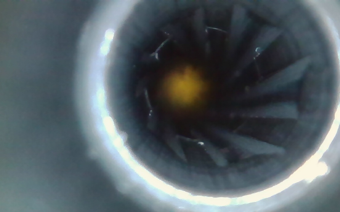

    AAAND we are now a customer support review thread for Springfield armory. Sent them image of bore and more data -they said the CS equivalent of "oh shit".
    They are sending me a prepaid fedex label to slap on a box - something I always appreciate because shipping guns is expensive and a broke gun shouldn't get more expensive than retail all of the sudden.

    It should be interesting to see how they handle the issue with the barrel. And how the gun shoots with a new barrel/upper, assuming the do right and replace it.

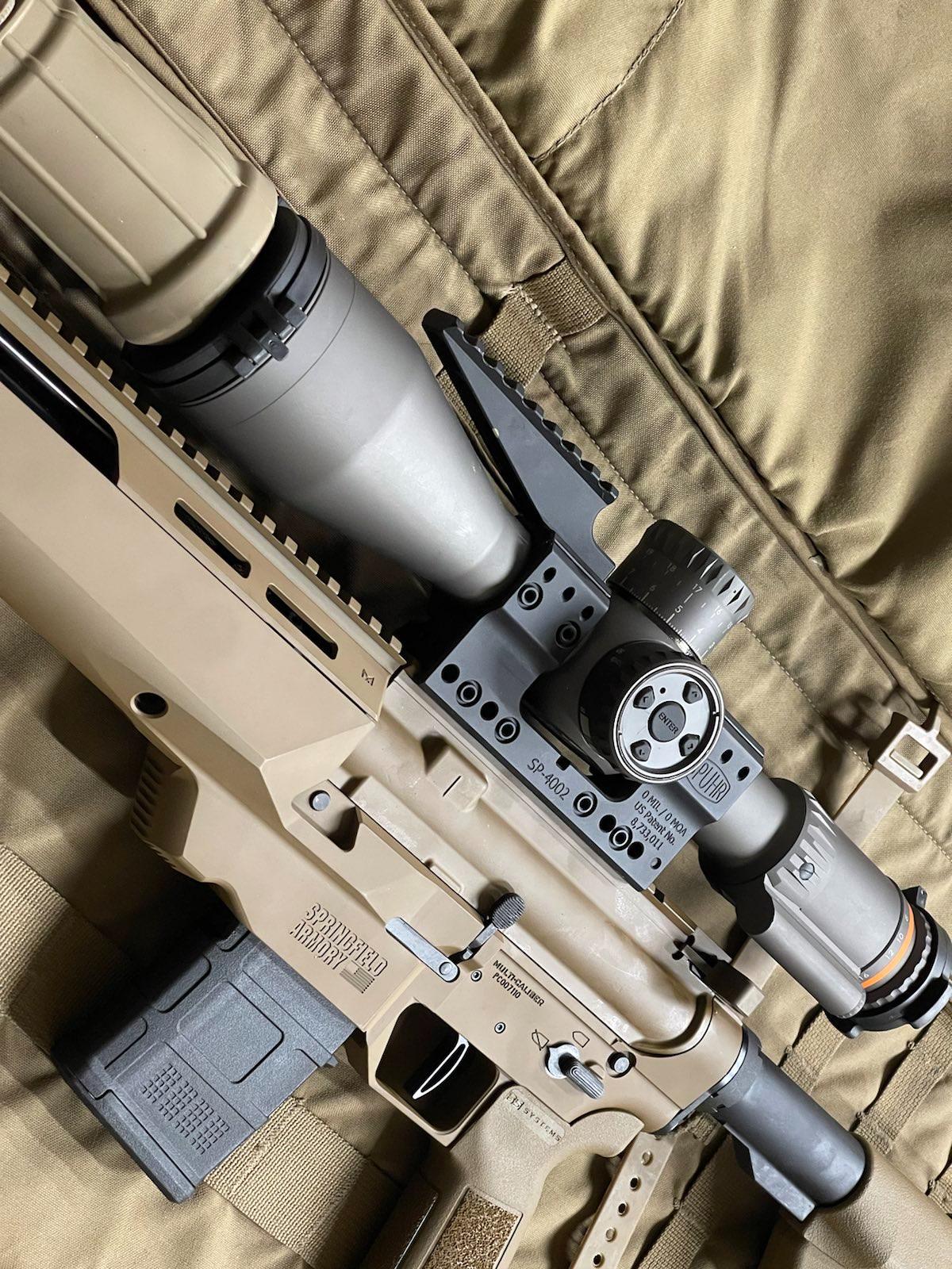

    So I am lazy - and haven't updated this stuff yet. I haven't sent my rifle back off to Springfield as I'm still dealing with CommieCron.
    I did go to mock this thing up in its final form - and I noticed something that folks should be aware of.
    You can't put a picatinny rail in the Mlok slots - it goes in but there is no room to actually put something on the rail that you install.
    Translation? You pretty much can't mount stuff you might need for night work on this gun. Not if you plan on using clip-ons. You can get a SF pro Mlok light on there and thats about it.
    Well, it's a Ballistic Advantage barrel so you kinda roll the dice on how that's going to work out I think. I don't have a bore scope to look in the chamber but it shot 69 gr FGMM at .54", .42", and .67" and 77gr at .54", .42", and 1.19" (flubbed a round), so I'm thinking it's fine.

    I decided to put a nice barrel in this setup today. The replacement from SA was never gonna shoot up to my standards. And I ordered a Craddock for my BCM mk12 which I suspect will shoot fine.
    Good news? Well, I put the BCM castle nut tool on the SA upper to remove the nut. The nut slots stripped at 106.7 ft lbs of torque on the barrel nut.
    I then made a special tool to get the nut off that had about a half inch of steel you would have to break off to get it not to turn, and I added heat from a propane torch.
    I was proud of that tool - it broke at 262 ft lbs without the barrel nut letting go. SO this upper is getting the barrel nut parted on it - because why the fuck would I ever need to get that off?
    At this point there is no way that removing that nut is safe - chances are good the threads are heavily damaged. I'm betting SA hydraulically installed this nut and damaged the piss out of the threads. My reac rod was surprisingly OK.
    Parted the barrel nut fine - then it let go.
    Upper fit to the barrel extension was "meh". Not great, but not BCM or VLTOR type fit. I took a barrel out of a BCM and had to hammer it out this week.
    Glad I'm not the only one that thought it was hella tight on there, a while back I tried taking the barrel nut off my SAINT Victor using heat and a BCM barrel nut tool and ended up fucking up the slots in the barrel nut. I don't know at what amount of of torque that occured but I eventually just said fuck it and put the handguard back on after I repaired the barrel nut.
    Went out and shot with the BCM barrel - which I had suspected sucked. Wanted to try it over here just in case - and with adjustable gas to tame the can.
    Bueno? No, Senor. No bueno.
    Finding: the BCM barrel sucks still.
    This is a 1:10 mil target. so....1.5” with the occasional 2 and 3” group.

    Also do you think is would accommodate a .875 or larger gas block?
    Well, the good idea fairy definitely blessed that chassis. SA licensed the chassis from Drake Associates so the initial design work was already done but I don't think there was anyone at SA to go..."maybe we should think about this a minute." I like the concept of the chassis but I believe it could've been made slimmer, lighter, and with more modularity then what's there now.
    In fairness though, the model I got to review shot very well (after I dropped in a 3 1/2 lb trigger) and it easily exceeded SA's accuracy guarantee. The wide, heavy forend made it pretty good off a front bag and it was comfortable in positions like traditional sitting and kneeling. So yeah it's ugly as sin but it seems to work. That being said, I'm not keeping this one, it's good but enough for me to switch from my SPR that's 2 lbs lighter and more maneuverable.
    I always loved the HK91 and this reminded me of it a lot.
    I will say this - it’s solid as hell. Nothing moves on the lower and rail. And it feels awesome as an off hand gun - if I were shooting lots of positional style stuff this would be very high on my list of modern guns.
    This week it gets to rock a Craddock for a little bit to see what it does.

    Regular pic rails don't work there because it doesn't clear the top pic rail correctly.
