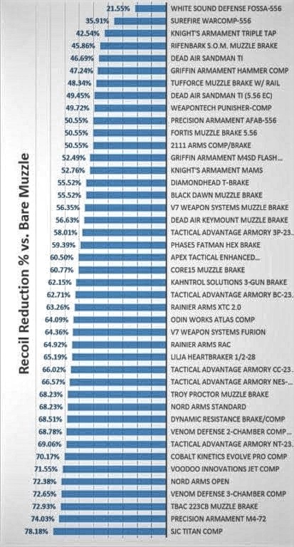

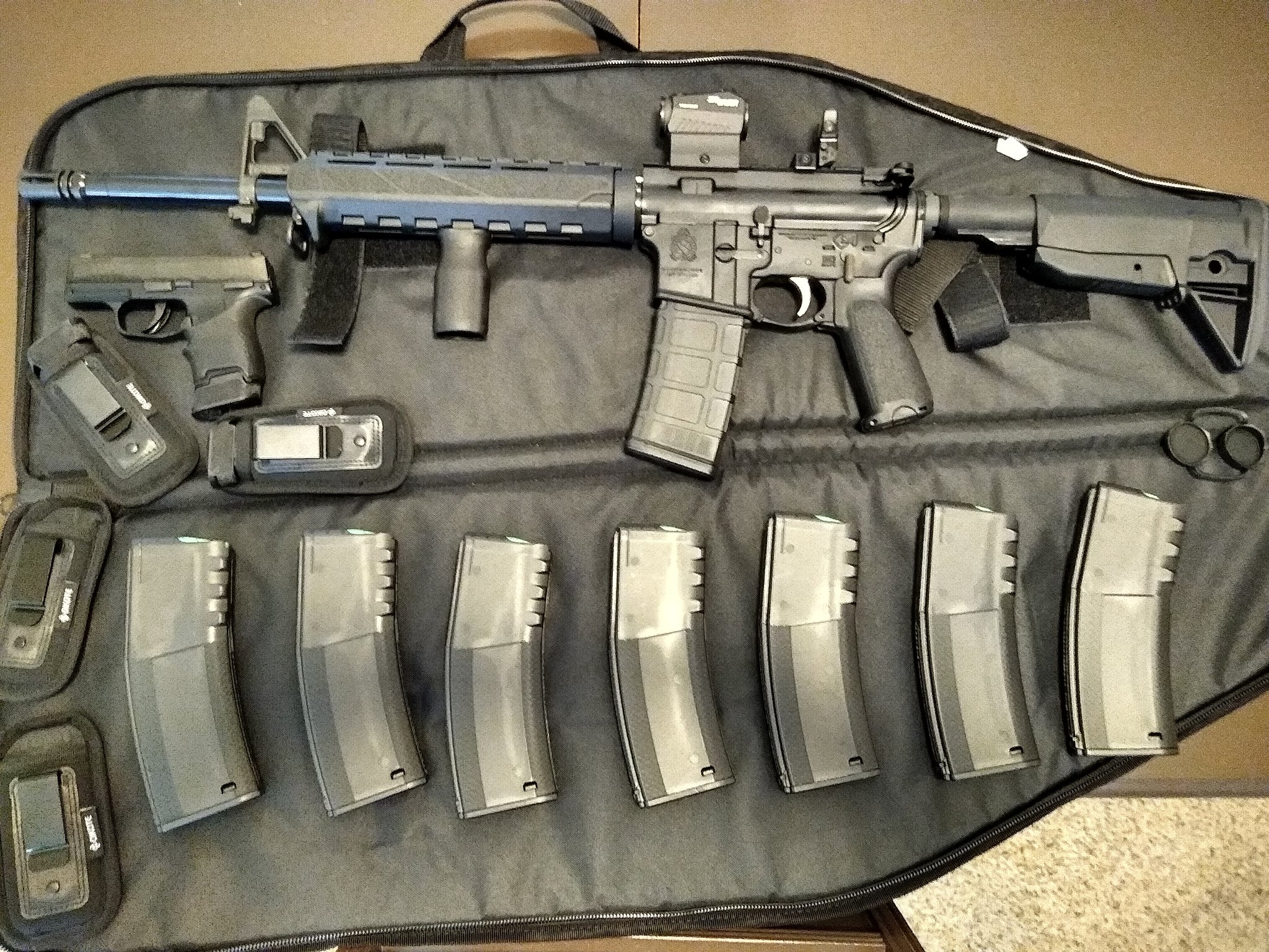

Thanks I really appreciate the links and help. Basically my intentions are to easily possess the normal platform or rifle I have with an option for long range. Right now I have a sig romeo 5 with a foregrip and standard bird cage. I'm looking to do some mods depending on future income/bonuses/covid back pay and of course my dream of having a slate pool table. Decisions decisions LoL. Again thanks for the suggestions I appreciate it. Could you also recommend any muzzle breaks for the standard 16 barrel ? Been researching and it seems the SJC Titan Comp is the best but also most violent towards those poor souls to the right and left of me and somewhat towards myself. Is there a such thing as a comp that isn't as bad on the shooter in terms of blowback ?
Any help is greatly appreciated

As for muzzle devices... for a 5.56, IMHO you don't need the "most" effective ( %) brake.
For that matter the most effective ones tend to be the most annoying ones. Any "brake" that directs ( via the baffles ) some of the blast towards you will be blasty to you as well.
try to look for ones that have "closed" bottoms.. so you don't kick up a bunch of dirt from firing prone or kneeling.
I use VG6, Lantac, and BCM "brakes" and have been very happy with the results.
NOTE there is a huge difference between flash hiding and brakes.... the A2 does both reasonably well.
This link has numerous very simple, but effective tests for comparisons...
https://www.youtube.com/results?search_query=Muzzle+brake+shoot+out+,+Jeremy+S.

If you want to shoot your AR at long range, buy a 20" barrel or upper, WOA is great. Rock River is decent as well. Don't shoot anything out of the magazine but 77s or single load 80s. An RDS is not going to be optimal for LR shooting, I'd get a scope. Muzzle brakes are for gaming unless a suppressor attaches to it. If you hate yourself and love concussion, buy an M4-72 IMO.

you might be better off buying a complete upper from WOA, they are sub MOA and free floated for under 700. As for breaks, look for breaks that will also host a suppressor or a blast forward device. I like dead air.
